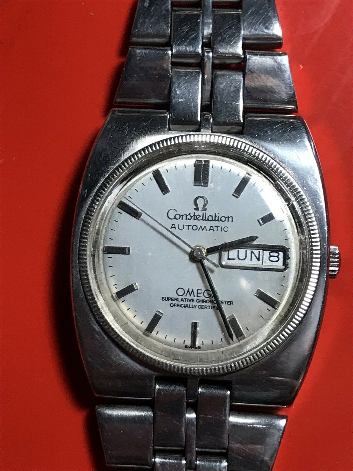

Call me crazy (and there are plenty of reasons to do that!), but this Constellation doesn't look legit. Opinions?

I think it's real, but the movement with parts of different colors looks cobbled together with parts from different watches, or it had water damage and was cleaned up unevenly, or something?
1,372
2,001

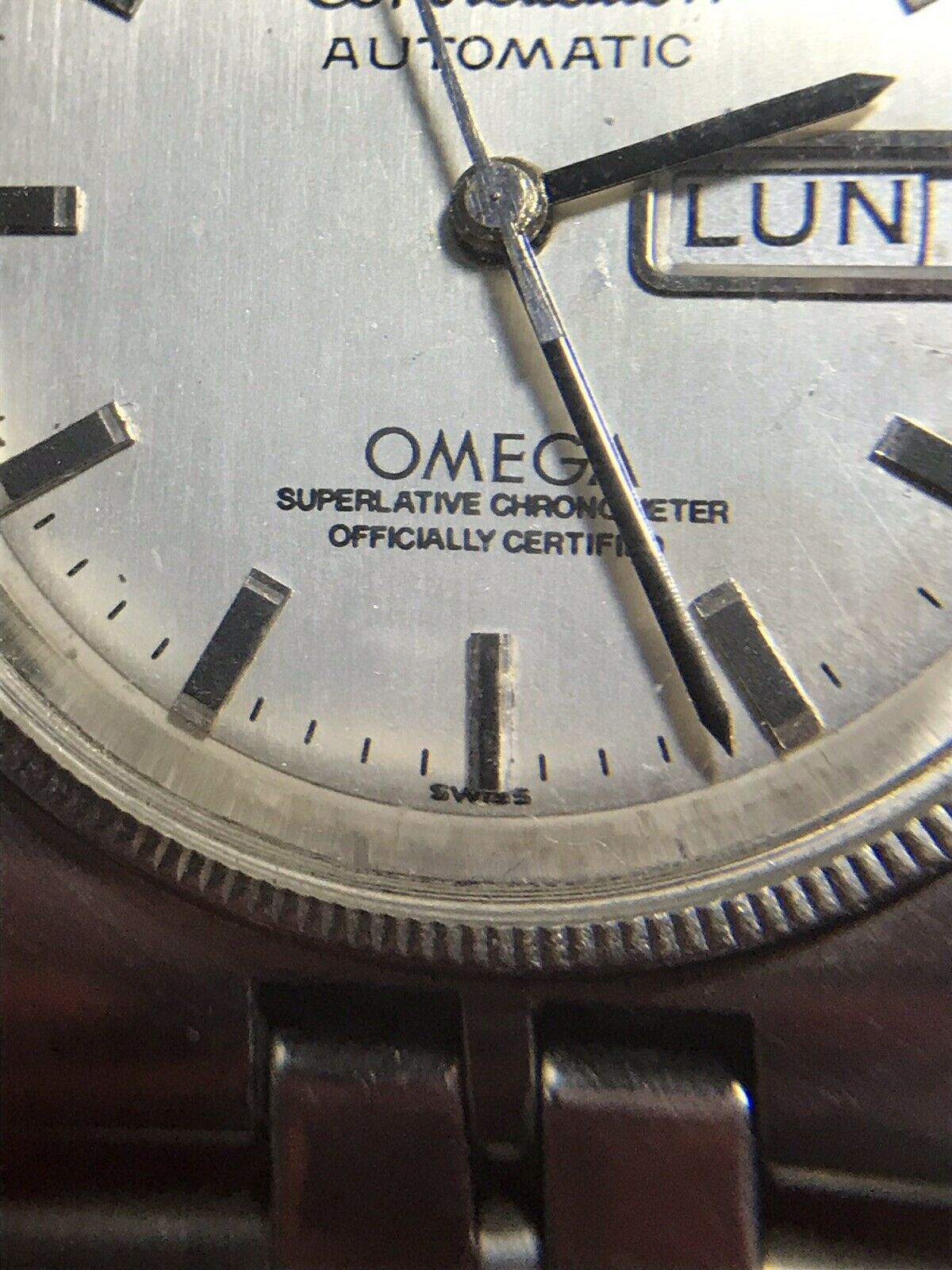

The dial seems off: fonts seem either too thick or too thin and the whole thing seems cramped. The movement I think was just taken in bad lighting.
1,325
1,872
Walk away - dial looks like a redial and not a great example all round IMO
13,493
31,814
Caliber 752 is incorrect, should be 751, dial looks horrible.
BTW, please post photos not links.
5,537
9,475
Oops -- they meant to make it a Rolex but got mixed up.
74
174
A very poor redial & the case has seen better days. There is nothing “superlative” about it and it still surprises me that anyone taking the time to do the redial would not spend the extra 30 seconds to at least get the dial config/wording right. There are much better Connies here and on the bay.
2,808
8,340
Not expecting the redial to be that ridiculous, I didn't even notice the Omegalex dial (Rolemega?).
327
441
The fonts and sizes are absurdly off, and someone got very creative with the extra wording. I feel sorry for whoever buys this.
