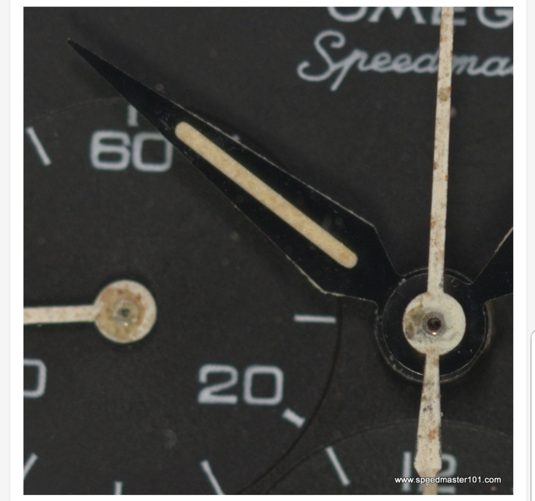

Theyre certainly not rounded like these, from speedmaster101...
Though for me, an easier tell is whether they're convex or not (along the length). Hard to say for sure in these pics. In some they look flat, in others curved.. I'd have to see better pics or in the hand to be more sure.

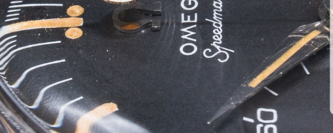

I’m not sure about the lume. It looks too consistent in colour to me.
I don't know why you guys keep on harping on the lume color.
It looks absolutely original to me.
It shows degradation and aging (black-is/mold-ish) color at some spots typical to Speedmasters of the period.
The lollipop hand lume shows a bit of sheen/glossiness which could suggest it has either been completely re-done, or stabilized at some point.
However the dial lume looks 100% to me.

Totally agree re: the aging. My concern would be that the plots started as light puke green or light yellow, whitish, and were darkened. Wouldn't affect the blackening, molding that had already occurred. May be a bit of tin hat situation, but just figured id put that out there.

Remember that these are radium.. These are the watches relumers are trying to emulate.
Those are pretty strong assumptions... 🙄

Like @ndgal says on first looks it looks ok
Funny to see how the tread drifts to guessing and believing....
to judge the lume correct you need a strong UV light which can show u traces of a possible relume job and a geiger counter.
If one is in the game for it, i am sure he knows what to check

Agree. Any real buyer for this watch will have it inspected in hand first.
When I recently bought my 2915-3 I flew up to see it in hand first with geiger counter, UV light, X20 Loupe and all...

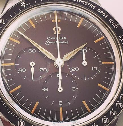

It takes no kind of genius to see the difference in the micheal e watch and this watch.

I wouldn't recognise a "good" 2998-1 if it kicked me up the arse, but I know which one is attractive to me.😕 (edited)

To me aside from the rest of what been discussed the difference in photo technique between these two makes the difference for me. The ewc watch, to me has been photographed poorly and in a poor lighting setup whereas the right hand watch is properly lit and at an angle that accentuates the dial and hand features.
Lovely watches, am definitely not in the market but would love to know what ewc are asking and finally receive...
Edit I think the lefthand watch picture has had the contrast turned way up to try and showoff the lume colouring so would be inyerintere to see it in real life/a proper sunlight photo.
2,446
7,040
This is a really interesting thread on perception of "beauty". I'm not into Speedmasters (or any chronometer) so looking at @nonuffinkbloke comparison picture the watch on left appears to me to have a dial in better condition, and closer to the watch's original appearance decades ago.The one on the right has a degraded dial (brown color). Also, the EWC watch is lit from above and below for the photographs. So the flat polished surfaces, such as the hands and logo appear black. I personally wouldn't call this lighting setup as been "poor", just different.

After reading your posts @Deafboy & @isaac.owen.nz I decided to edit my comment. Yes, I suppose attraction is a personal thing.👍...... but I'm still more drawn to Michael's watch. Maybe I've developed a bias toward brown dial Speedmasters???😕
I get the appeal for the brown/tropical dials, I've seen some incredible examples around!
For me the black on white with yellow of a good tritium dial is just perfect!
Plus the brown always reminds me of that forgettable brown car era, being a car guy.
N.b i googled brown car for a pic and apparently brown is making a comeback in car paint.
When will we learn from our mistakes!!!!!!!
