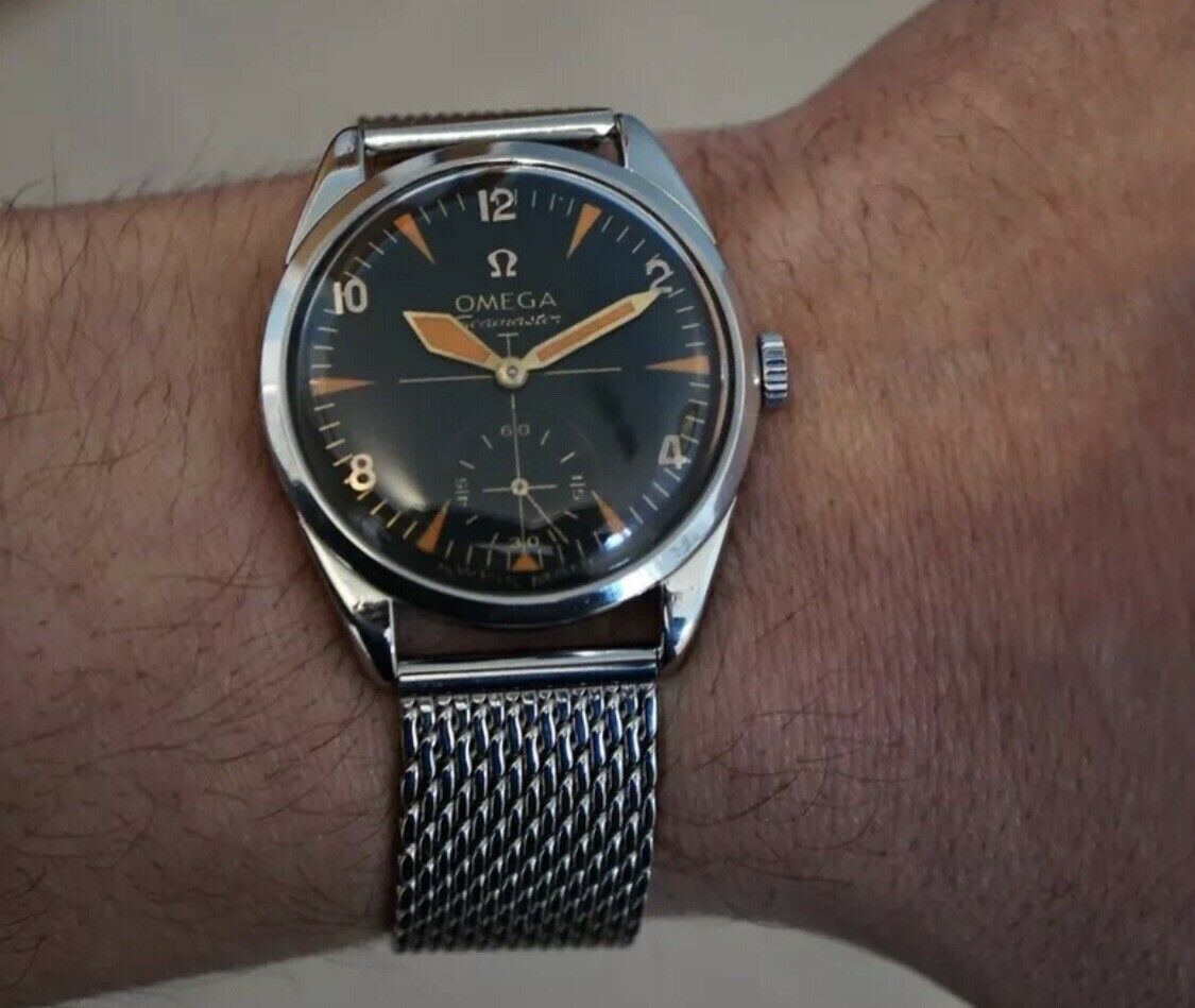

Hello all,
This is my first venture into the Omega world so go easy folks, I don't want to have to report anyone to the RSPCOO.
This Seamaster is my first purchase. Bagged on Ebay a couple of weeks back. Wanted to pay £550 but chased it up to £900 in the end.
I just loved the hands and dial, which stood out for me.
The Serial number dates it 1958, so the dial has almost certainly had work done. Nevertheless, I think it looks stunning. The mesh bracelet is after market
My question are:
Has anyone seen this dial and hands combination before or is this the creation of some Omega Frankenstein?
What kind of bracelet or strap would this have come with?
What type of presentation box would this have come with?
Shoot me down if you must, but I'm thrilled with this watch. If it falls short on authenticity it'll hurt but I think I'll get over it.

This is a fantasy watch, try and return it immediately, good luck!
13,493
31,814

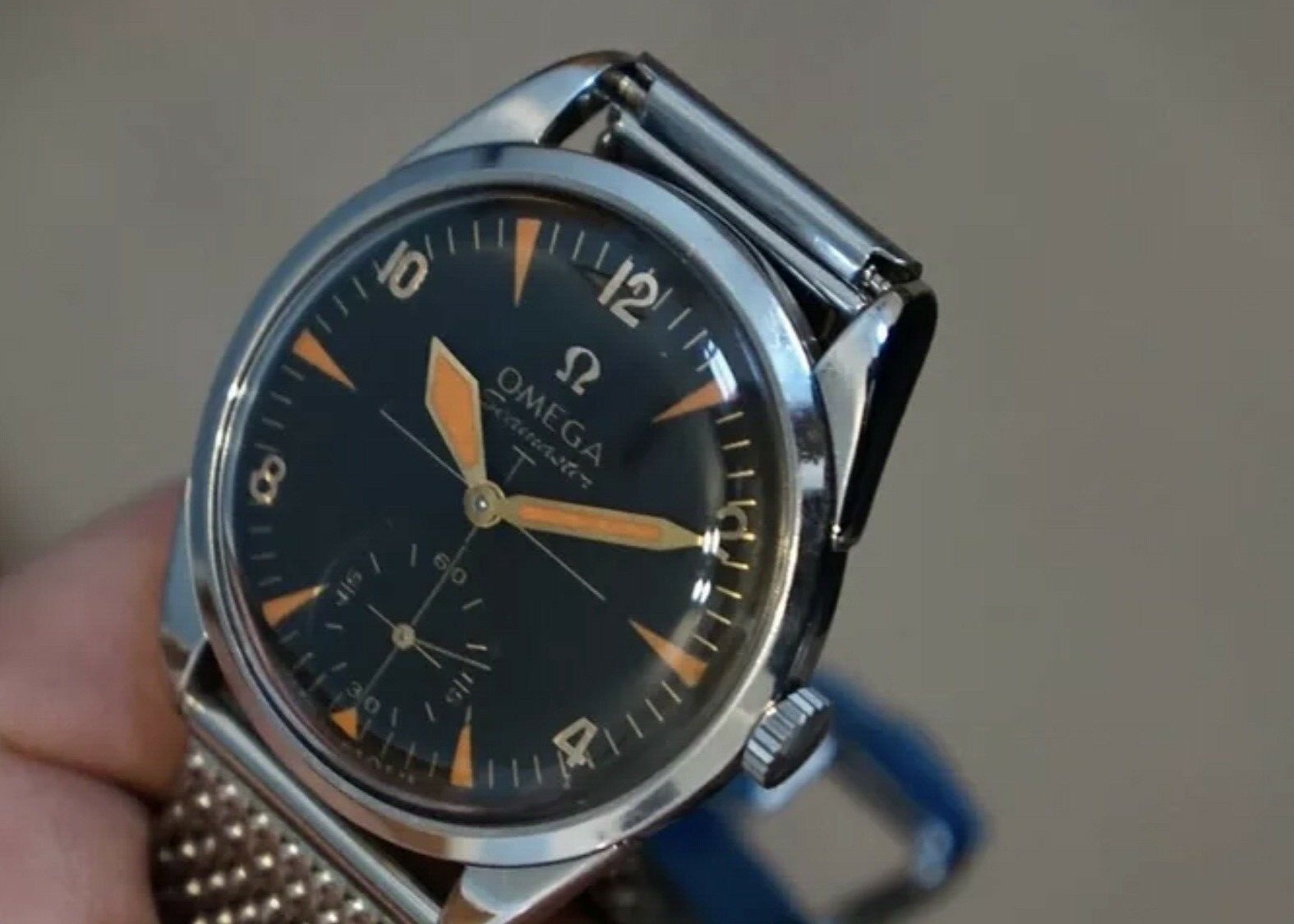

As already noted this is a just something made up by someone looking to make a quick buck on something flashy, it never was a Seamaster.
Even £550 would have been far too much to pay.

Same as above. I will return it, especially at that price.

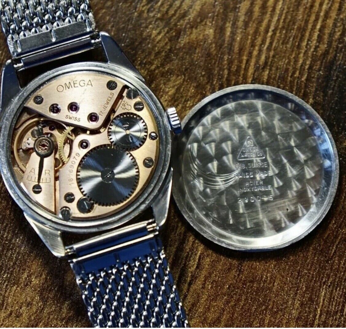

- doubtful (to say the least) redial
- overpolished case (waay overpolished)
- watch hand: not even sure they are Omegas (but I may be wrong here)
- potential issue on the movement or the whole assembly: the several marks on the caseback suggest the barrel is touching it, for quite a long time. Given the overall state of the watch, I doubt it was taken care of...
You are entitled to like it. But you paid way too much for it...
Do not even think about the correct bracelet/strap and box for it. 1/ even for the same watch in good condition it would be difficult to tell (and it won't add any value) 2/ so many things are wrong with it, the strap and box should be the least of your concern

Sellers fabricate these watches because they know they have a popular look. They are made to deceive. Unfortunately, the dial and hands have no connection to the original watch. At 200-300 GBP, maybe one could justify buying it just for the cosmetic appeal and the value of the movement/case, but 900 GBP is real money, and implies significant collectible value IMO. I would like to know how the watch was described in the auction. I am also wondering whether the bidding was legit.
