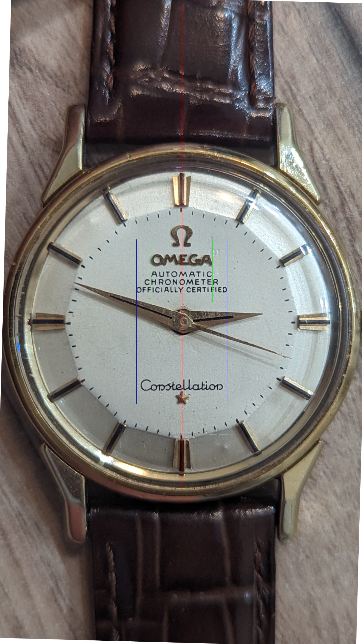

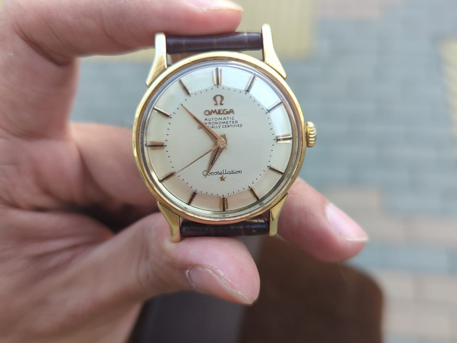

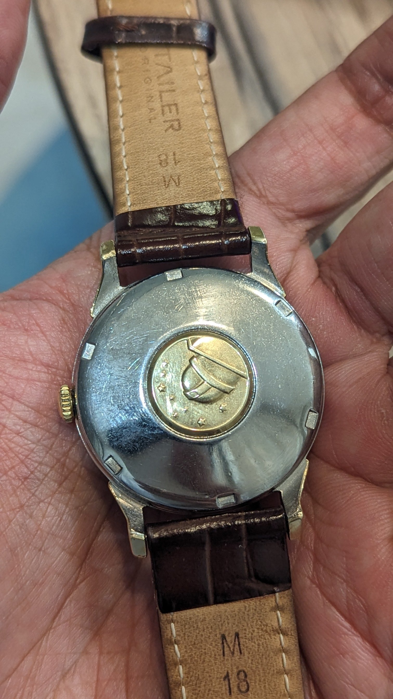

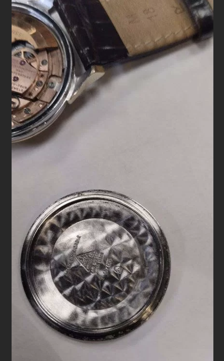

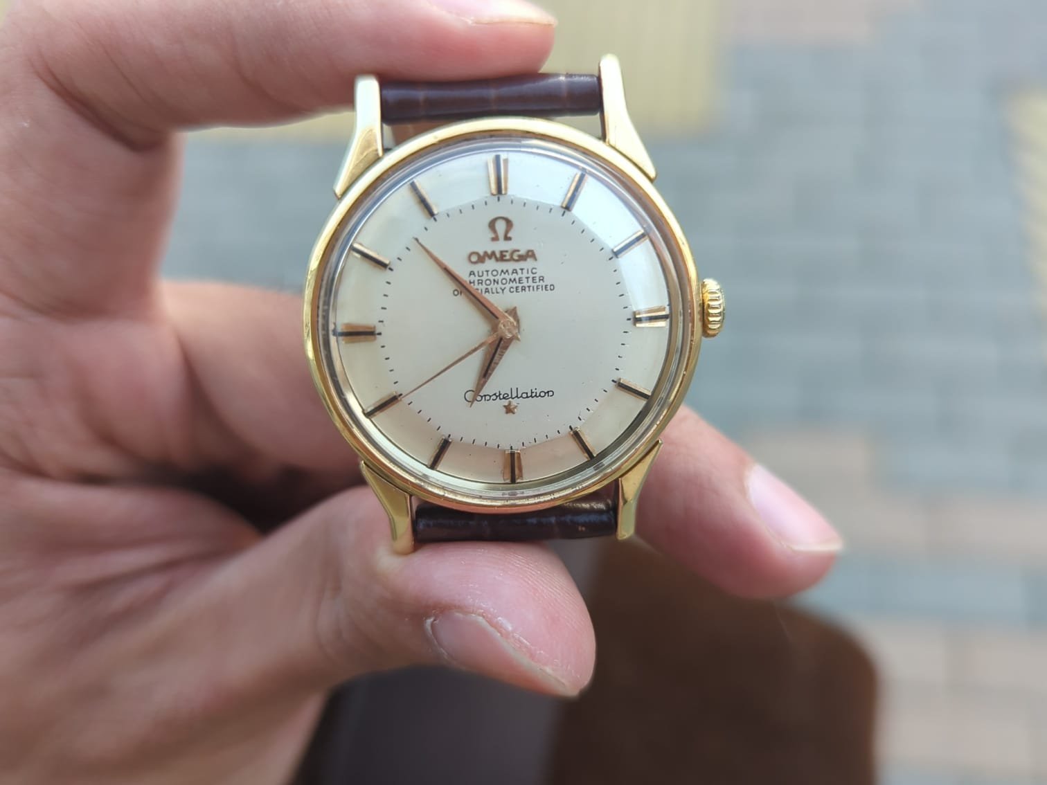

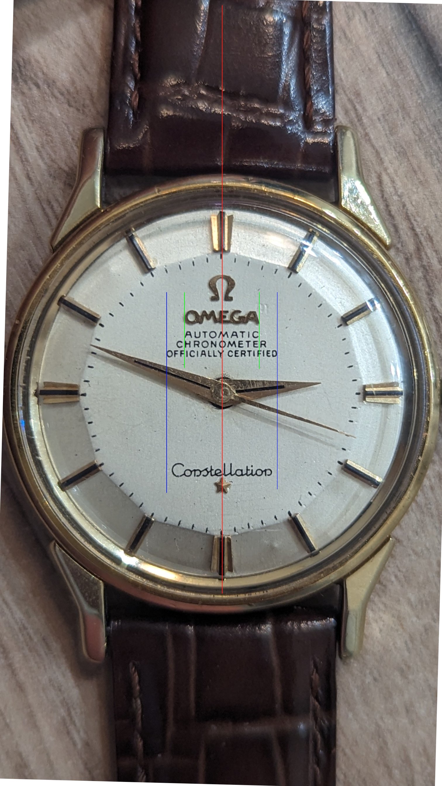

I just bought this watch from a Russian website (I know my bad) and I only had 10 mins to validate the watch at the post office before signing it off. On the quick inspection I thought it to be legit and signed it off. However, on a closer inspection in the daylight, I can see many flaws. The movement in the watch is 551.
Can you guys guide me through. I have performed the MOY test and I don't know how to interpret these results. What I have analysed so far
1. The Dial paint is almost paint like without any sign of a metallic (or sunburst) texture, however it still reflects nicely as metallic
2. Biggest Red Flag - missing Swiss Made at 6 o clock

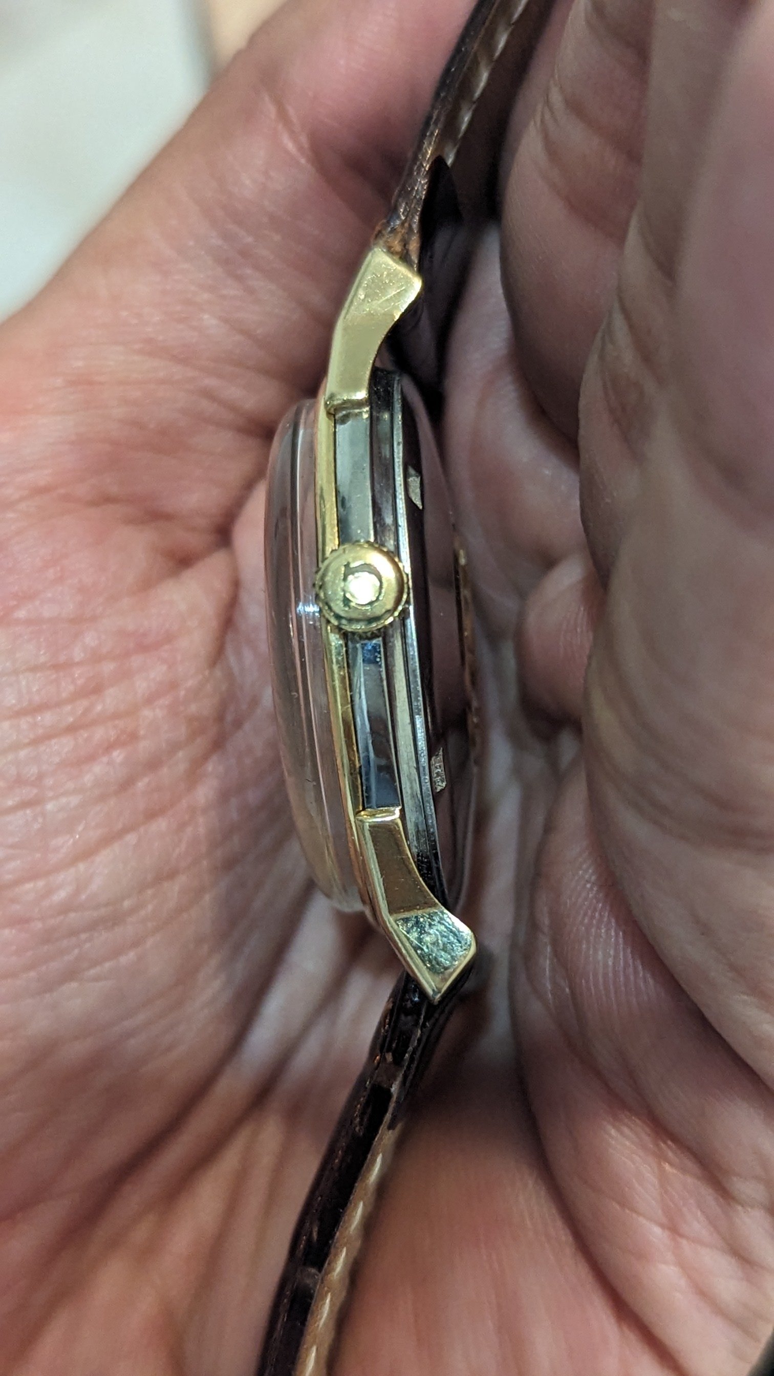

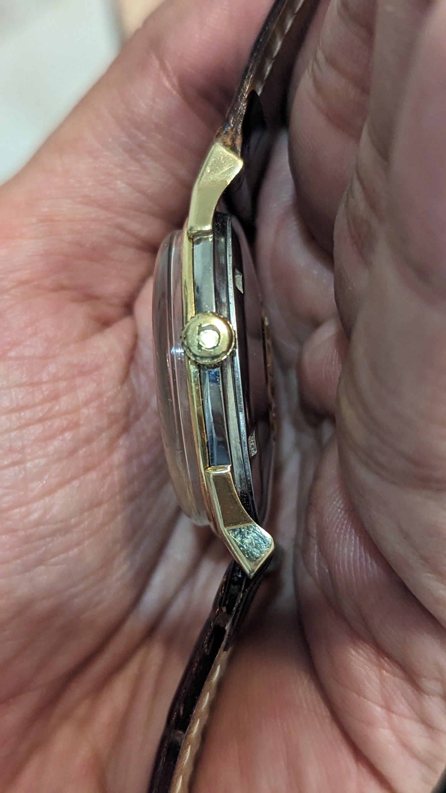

3. The crown is obviously not original and not even an omega crown, somebody carved a weird looking omega sign on it
4. The MOY test seems like passes with positioning but the typeface doesn't look quite right to me. There are no strokes on R, the F has the same length horizontal strokes. However constellation typeface matches. Everything looks printed and not embossed
5. The constellation star is too close to the lettering
6. Indexes are evenly place but the height and distance from border is slightly inconsistent
The thing is most likely i will not get the money back, the seller tricked me in telling that it was his grandfather's watch and he only wanted to sell it because he needed money, he only sold other vintage things from 1960s-1990s era and usually sold car spare parts so I assumed that he won't be able to forge a story like that, had good reviews.
I paid 750 USD for the watch. What do you think, is it a complete loss?

Minute markers are sloppy, font has no serif, no swiss made as you say. I say redial
13,674
19,043

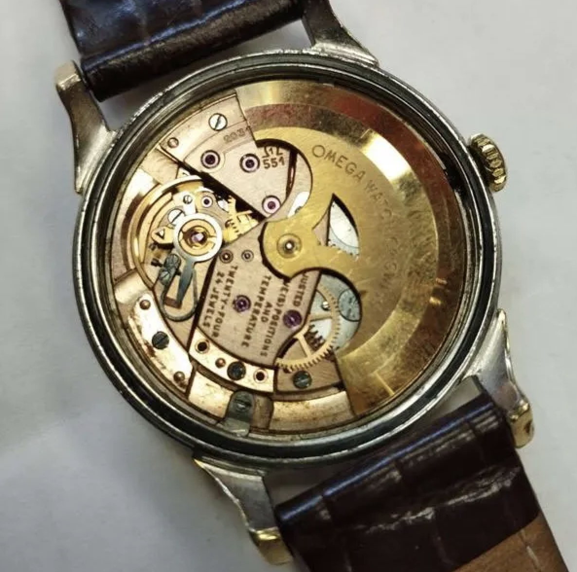

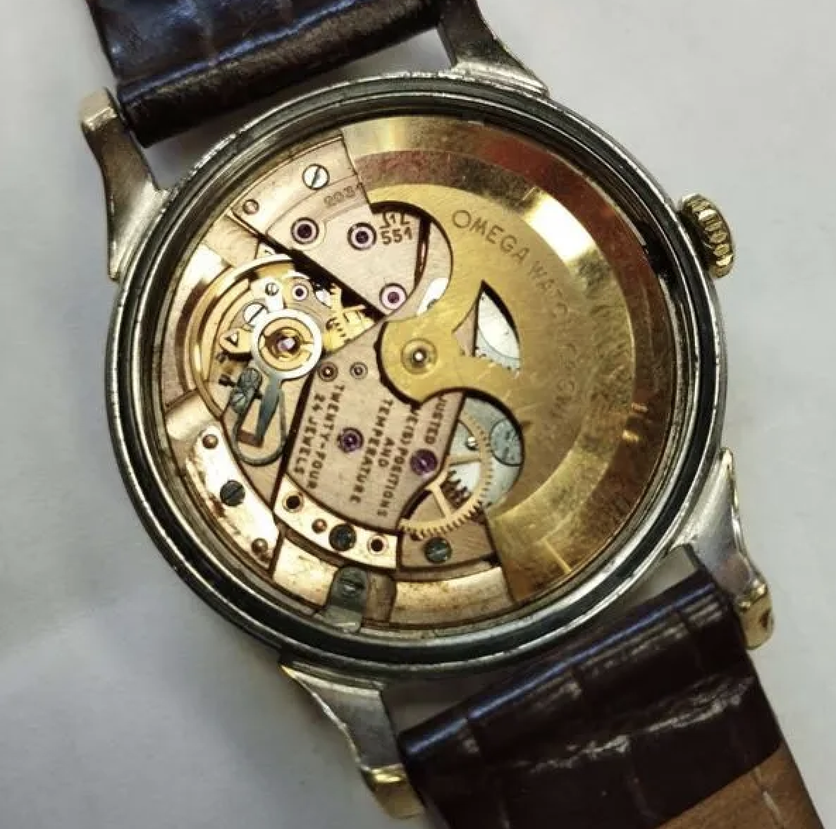

Very poor redial. Fonts not even close to correct. Movement looks tired and probably needs cleaning.

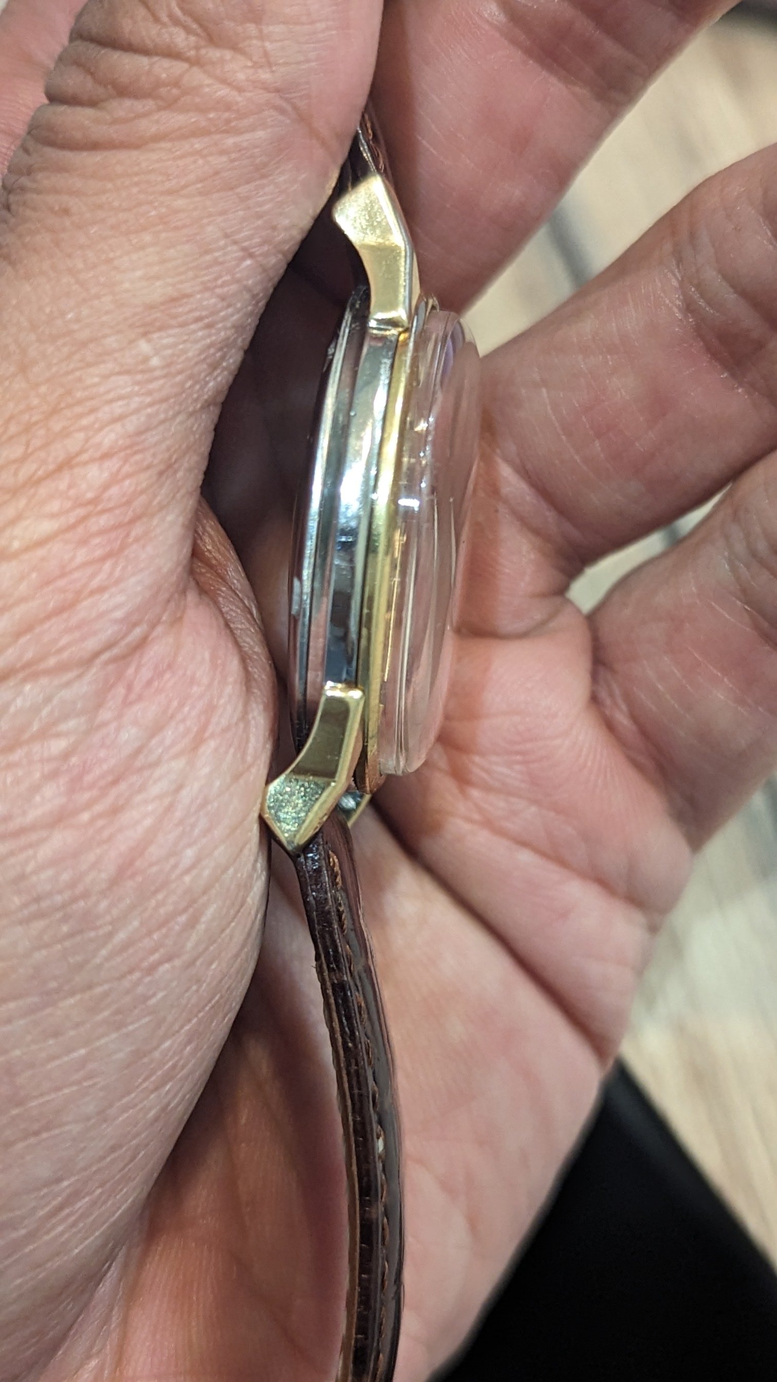

Crown is wrong and case is polished. I would make every attempt to return, but sounds like you’ve been had.
Price you paid is well below market, but not sure how much of that you can recoup.

I am trying to talk with the website as i made all the transactions and communication through it, but there is a very thin chance that they will return any money. As much as I have worn it through 10 hours, the time is only off by -3 seconds until now. I have a watchmaker who can service it (clean and re-oil) it for 50 USD. However the dial is a complete bummer.

looks like a put together watch to me, wrong crown, soft case, movement looks tired and colors are missmatched. I would ask the buyer for a return even at loss. Next time you should ask here before you make your descision. However you shouldn’t feel bad about this, we have all been there before.

Don’t feel dumb because someone else was dishonest. We all make mistakes. Tbh the font on the redial at least looks halfway decent and not done with a sharpie. Learning experience.
