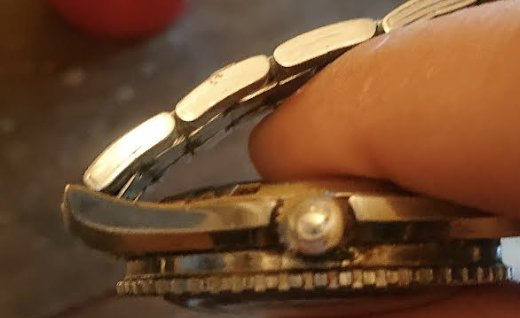

It might be an optical illusion, but that Omega crown looks like it **might** be shaped a little bit different than either the early production Niad or later screw down crowns intended for this model.
It might be a good idea to track down the part numbers for the correct Omega crowns and winding stem for this watch and do a visual comparison to see if a watchmaker installed an incorrect crown or stem at some point.
Even better -- if you have a pair of digital calipers, measure the dimensions of your crown and then compare those with the known dimensions of the correct factory crown/s for this model.
I think the original Niad crown had performance issues (it could allow water inside when the watch was immersed in shallow water), so the later screw down crown addressed this performance flaw and was part of an Omega service bulletin upgrade at some point.
You mentioned you want this watch to be water resistant again. If your existing crown is either an early Niad type or incorrect, have your watchmaker purchase a genuine Omega screw down crown intended for this model.
Keep in mind some collectors prefer the earlier Niad crowns even though they had performance issues.
Some experts here can provide you the correct part numbers if you need them...

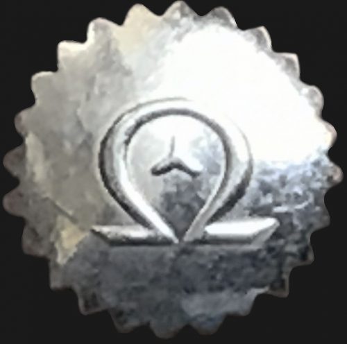

I'm growing more suspicious that someone **may** have installed the wrong Omega crown on your grandpa's Seamaster 300. The first photo below is your watch.
The second photo below shows a Niad symbol in the center of the Omega logo. (Image sourced from reference website I posted earlier)
Your photo shows the crown on your watch does not have a Niad symbol in the center of the crown that would be correct for a Niad crown. So you can rule out that this crown is a Niad crown.
Like the crown on your watch, the Omega replacement screw down crowns didn't have the Niad symbol. But your crown visually doesn't appear quite long enough to be the correct later screw down Omega replacement crown (although I could be mistaken).
The only way to tell if your crown is the correct Omega replacement screw down crown is to measure all the crown dimensions with a pair of calipers and compare those to the dimensions of the Omega factory screw down crown for this model.

Yes, the part seems like it's omega but it looks a bit off in terms of the fit. I agree that it doesn't have the niad symbol. I'll try to measure and report back but i don't think i have a pair of calipers. But presumably a jeweler would know?

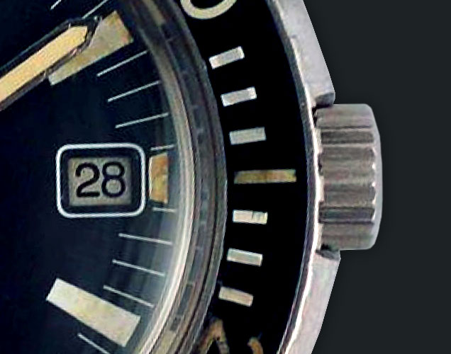

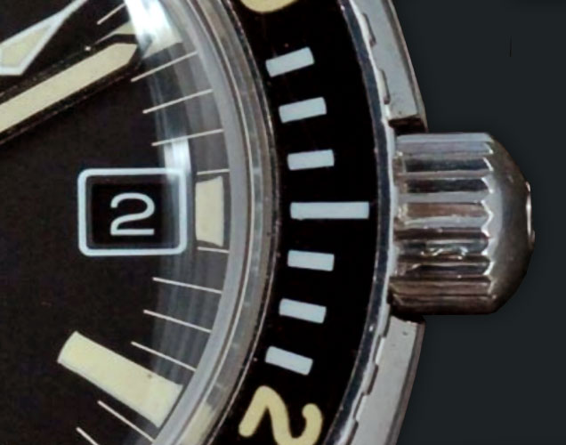

229
112
The photos below show the correct Omega short Niad crown and the longer Omega replacement screw down crown.
Note that the crown on your watch doesn't resemble either of these correct Omega factory OEM crowns. I would suspect that an independent watchmaker installed the wrong Omega crown when your grandpa had the watch serviced at some point.
