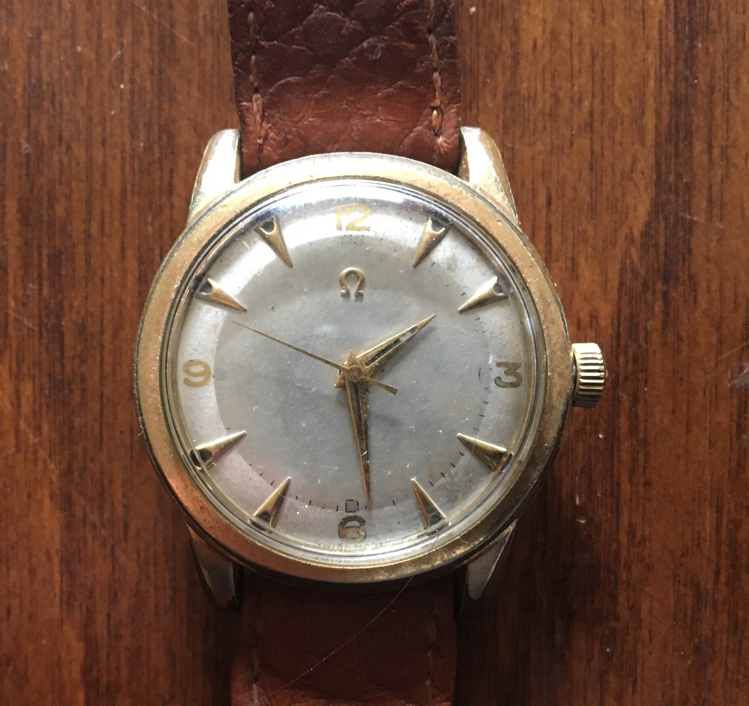

Hello

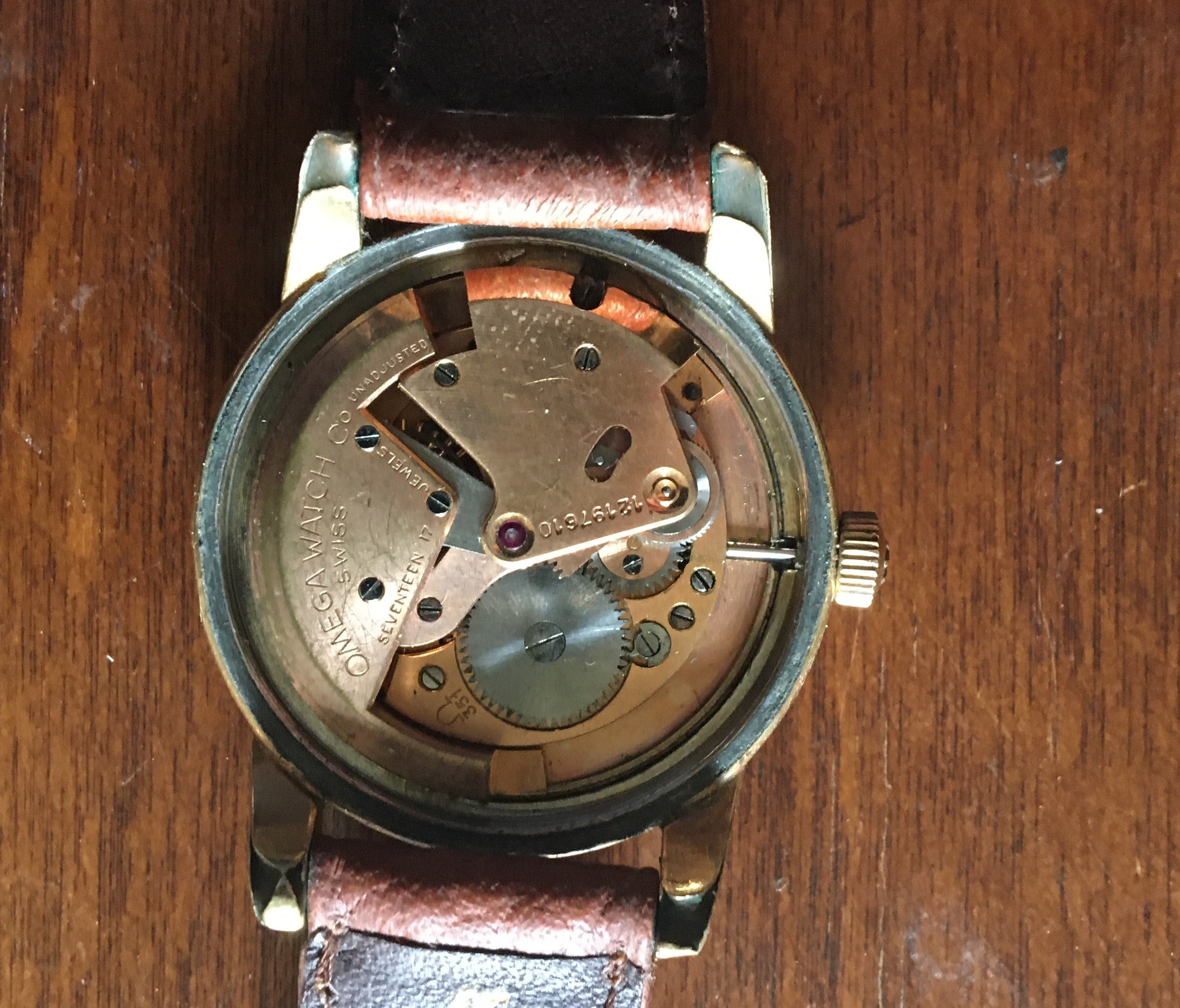

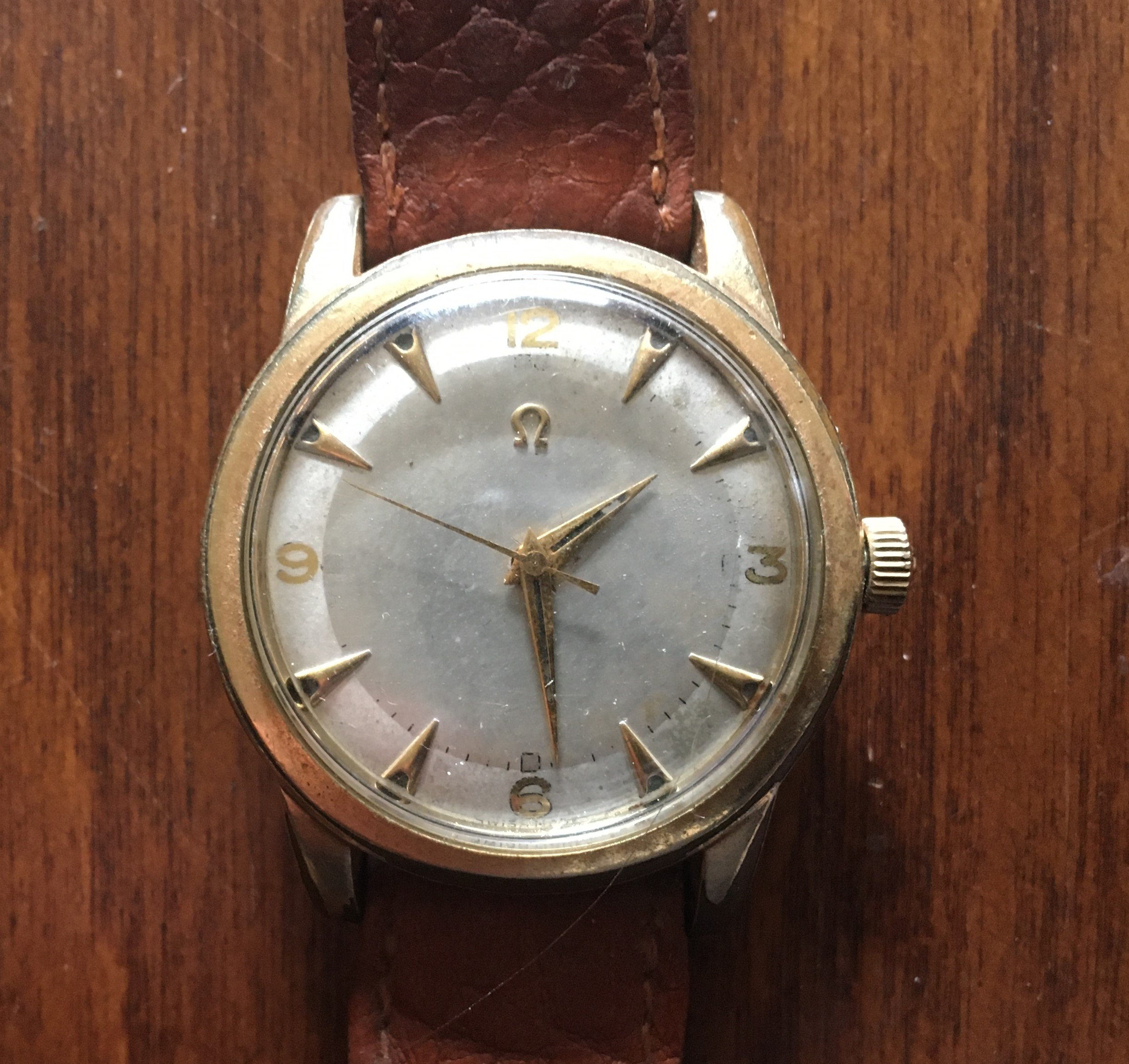

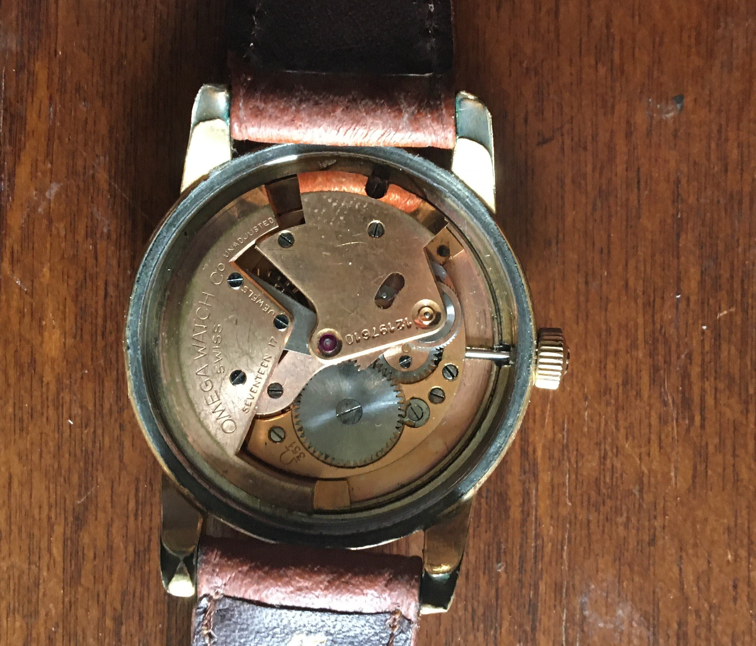

I recently purchased this from an estate sale. I am not an Omega expert. I was hoping someone could ID the model. Reference number is 12197610. 17j. I am perplexed as the dial just has the greek letter and not Omega. I am thinking it got worn away somehow, as the upper portion of the indices are gone.
Thanks much in advance
James
10,119
57,842
The number referenced in your post is the movement serial number. The case reference should be written on the inside of the case back. The dial is in very poor condition.
9,337
78,111

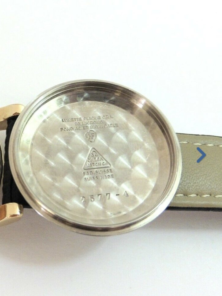

Hi James, it’s a calibre 351 from about 1950ish.

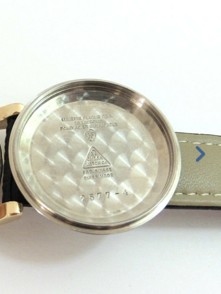

The inside of the caseback will probably give you the model and I’m guessing it’s a 2577 but you can check it out yourself.

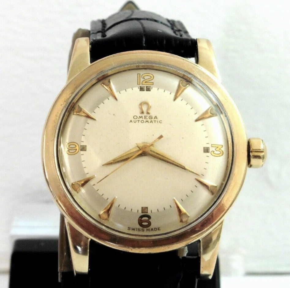

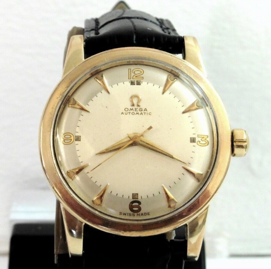

I’m reasonably confident that it once looked like this but somebody decided to clean it up with solvent and left it in the mess it is
Also, crown is an incorrect replacement.
That said, movement is probably still reliable despite 70+ years and it would make a reasonable daily wearer after a service.
Given that it’s gold capped and the dial, it isn’t worth a great deal.

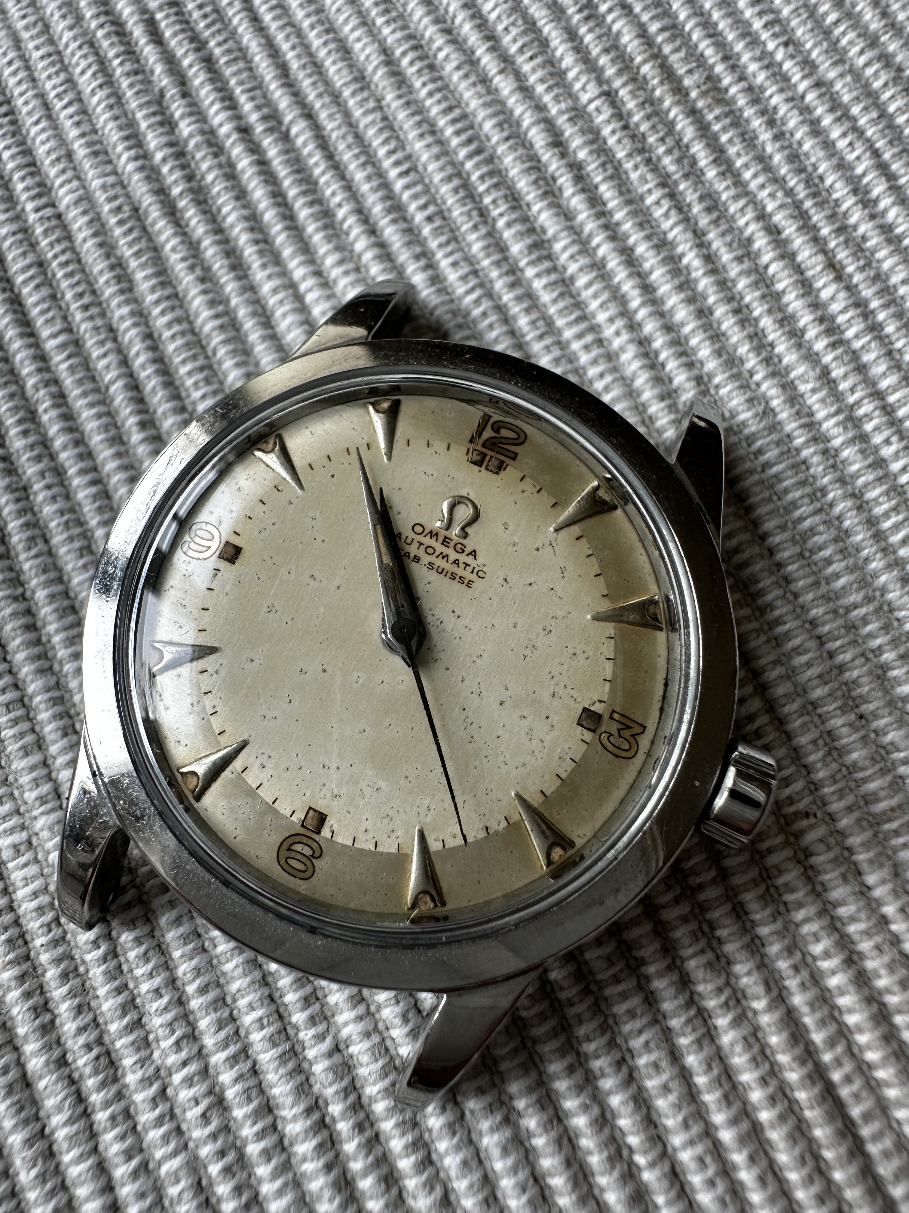

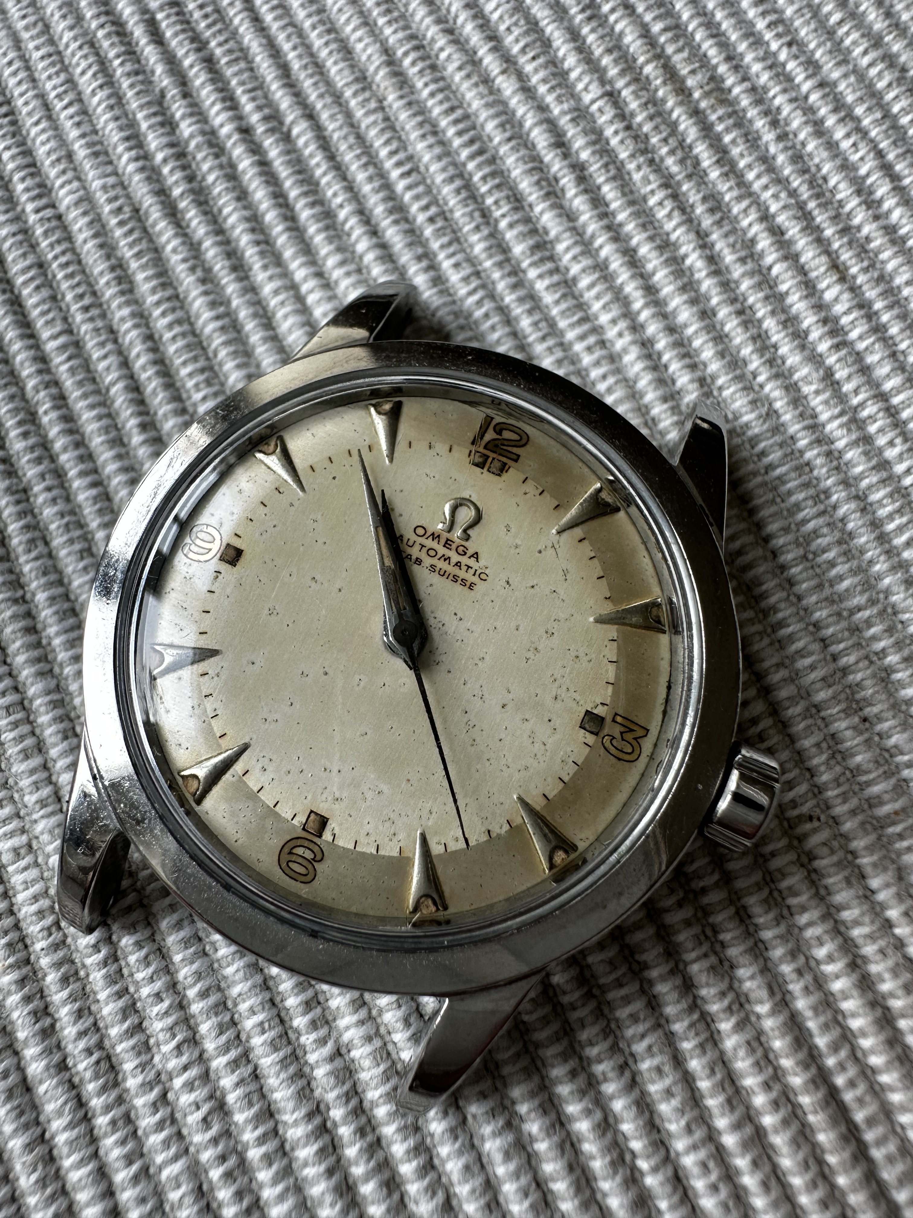

Just got the exact same dial as yours but Fab Suisse marked (destined to the French market) and with a SS case, ref 2577 (cal 351).
The number 9 on yours looks a bit funny but it probably just discoloured.

As noted above, somebody tried to clean the dial, and ruined it.
9
3
Wow, thanks so much. Yep it's a 2577. Given that I got it for $25 am quite happy to add it to my collection and wear it and not worry about it.

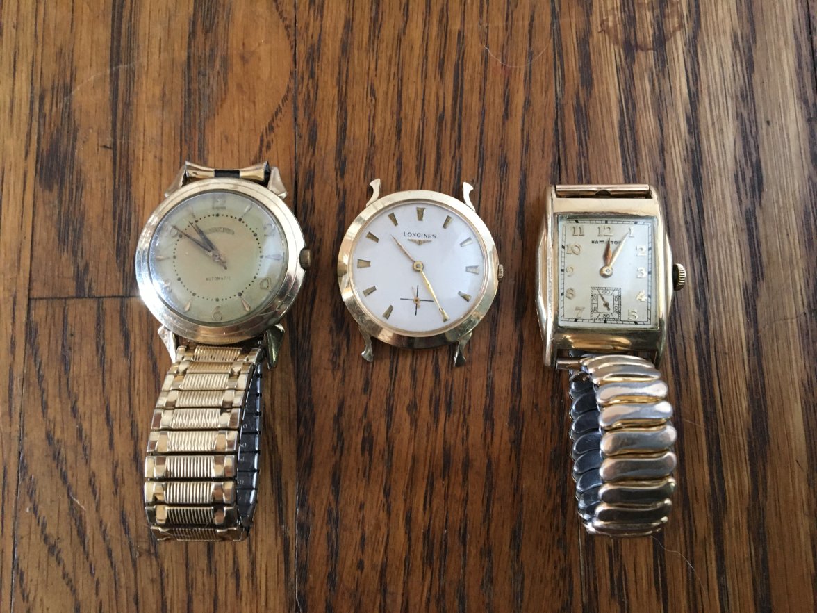

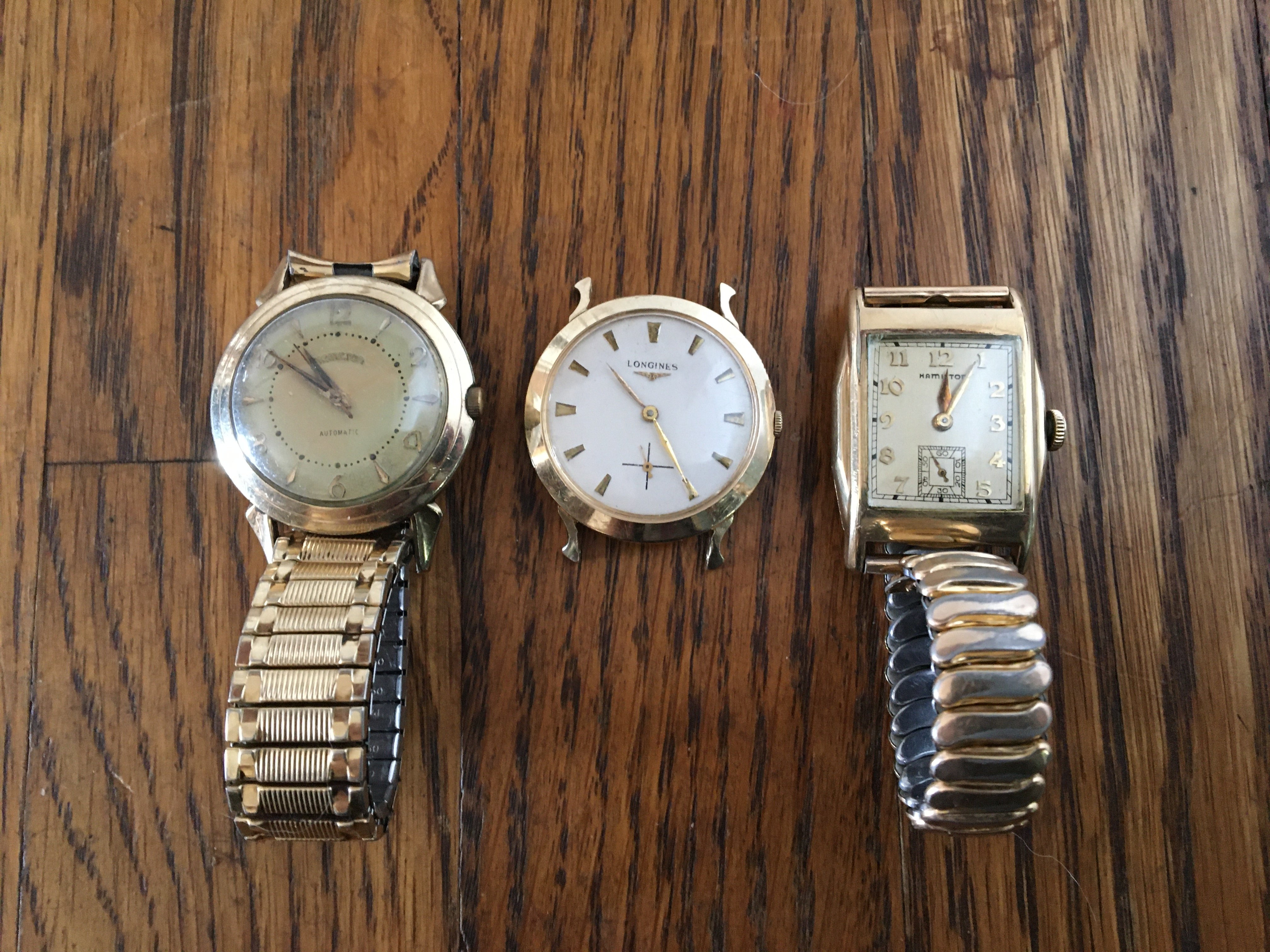

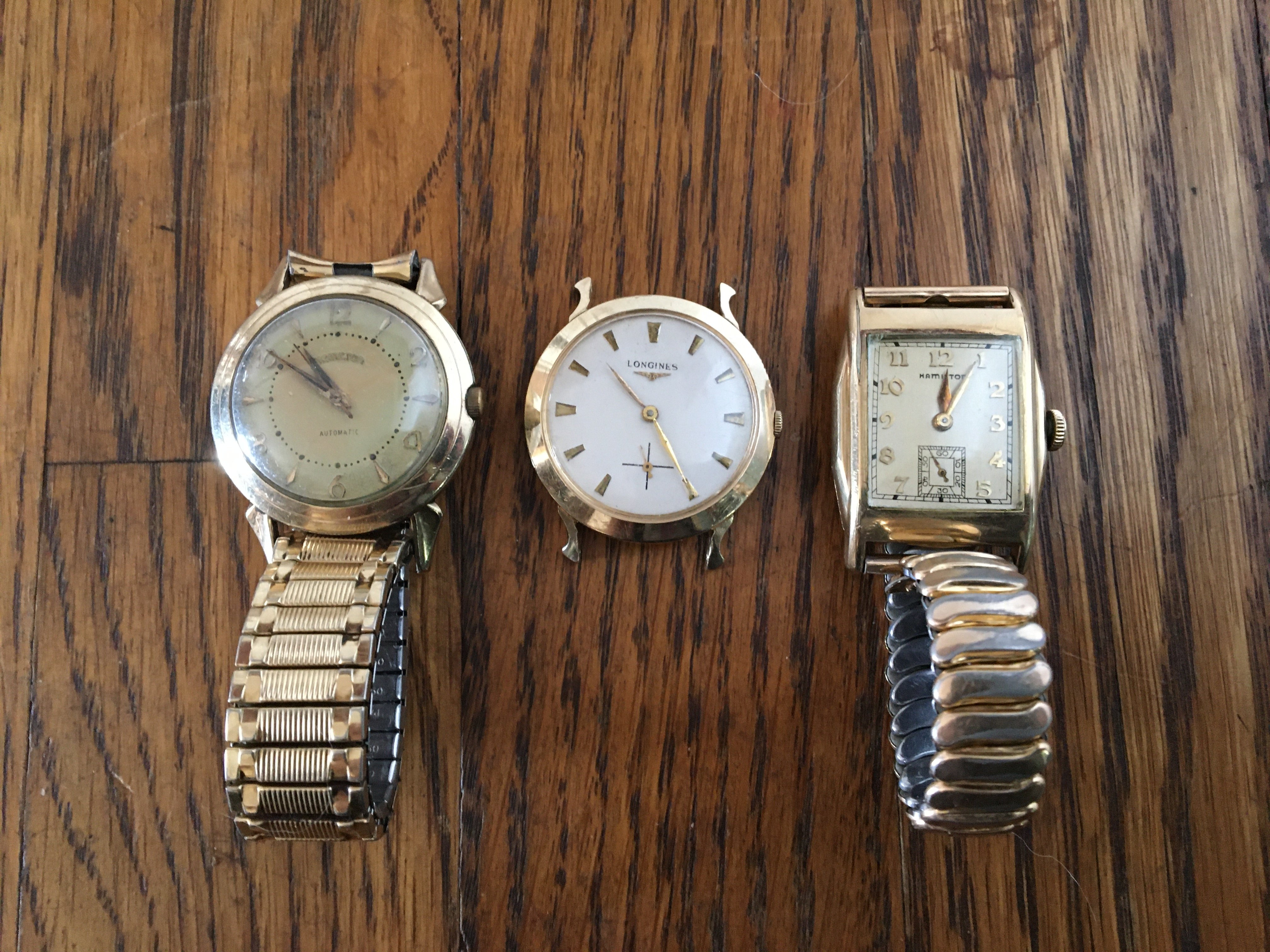

All
So here's a pic of three more of the watches I picked on for an average of $30 a piece. Longines for my collection, the Hamilton K-402 and Merritt on Ebay to defray the cost of the ones I'm keeping as well as some bands and service I had done 😀
