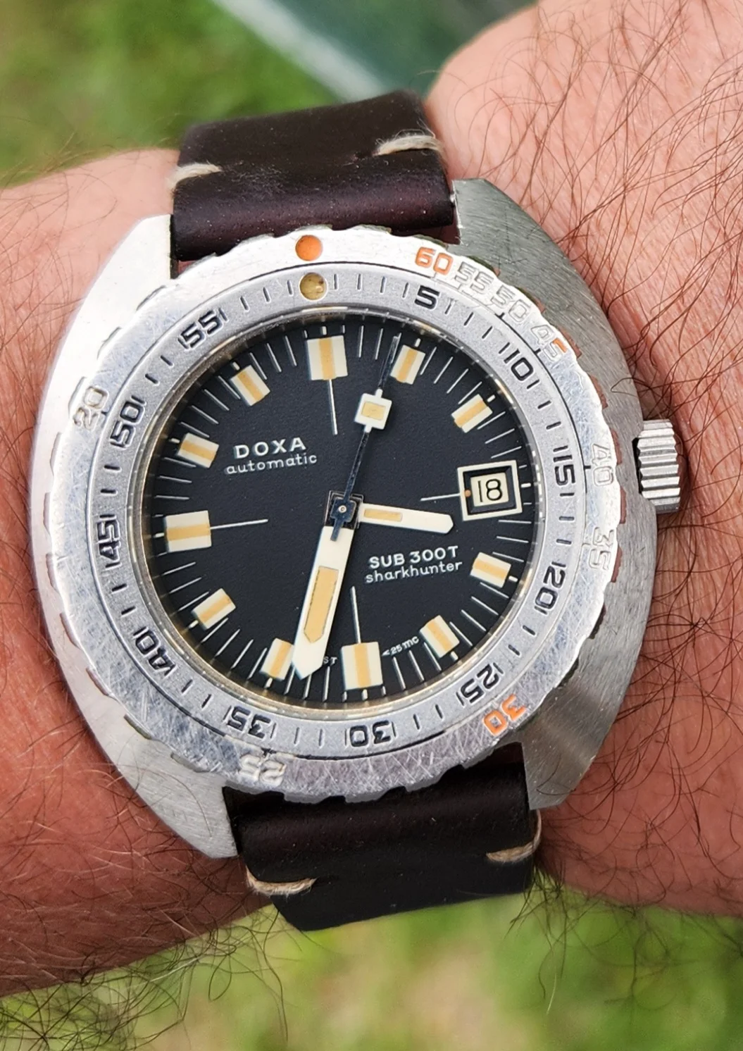

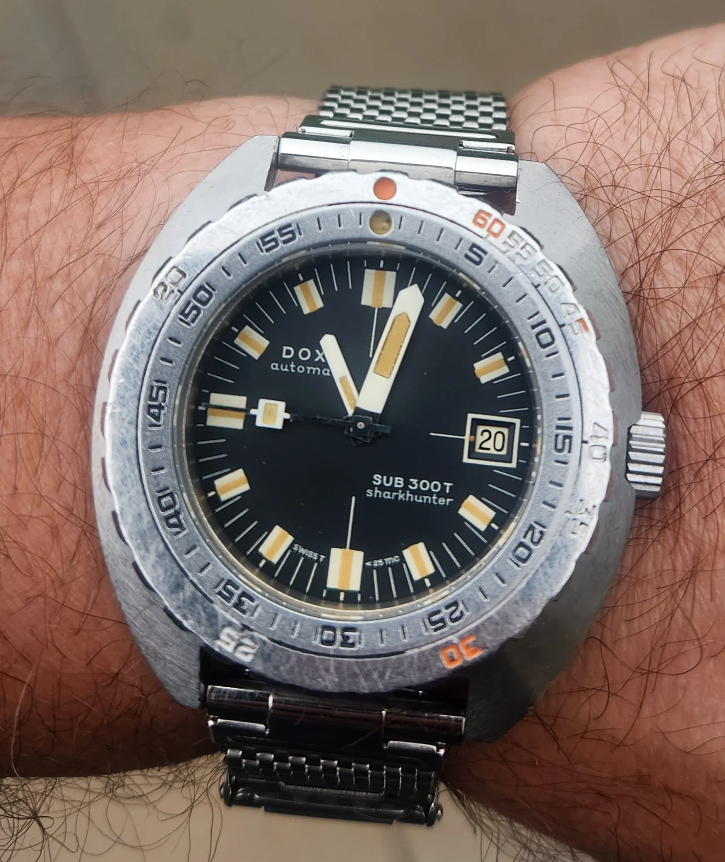

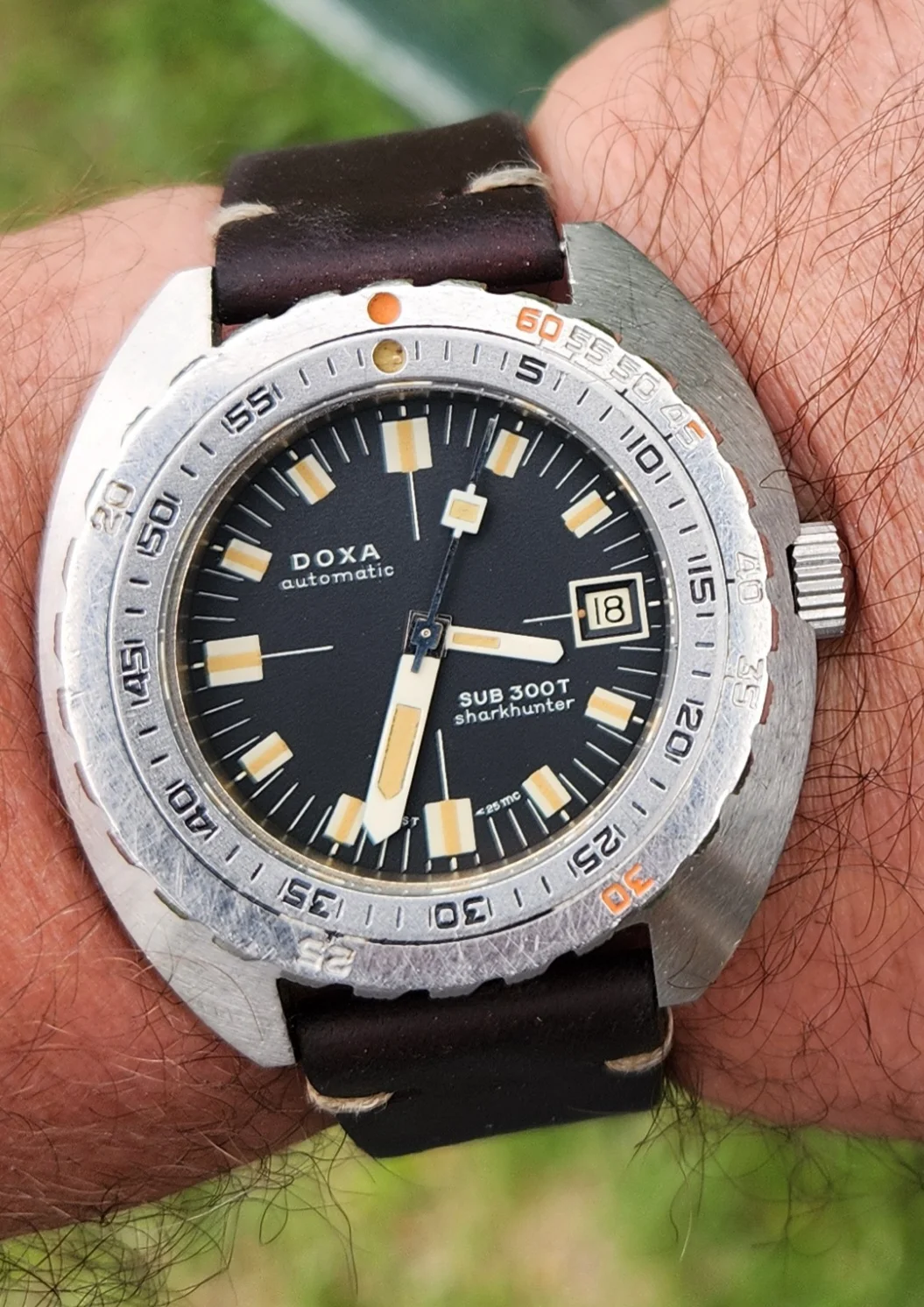

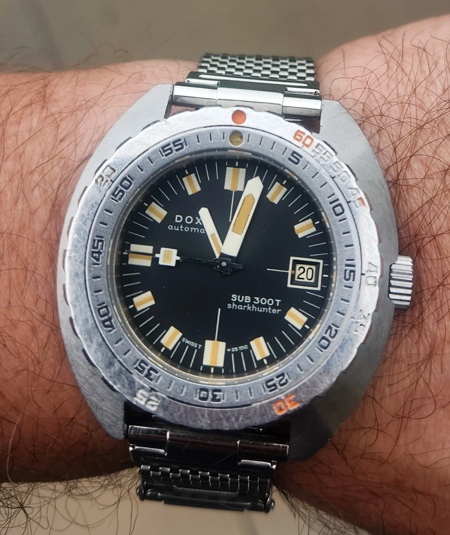

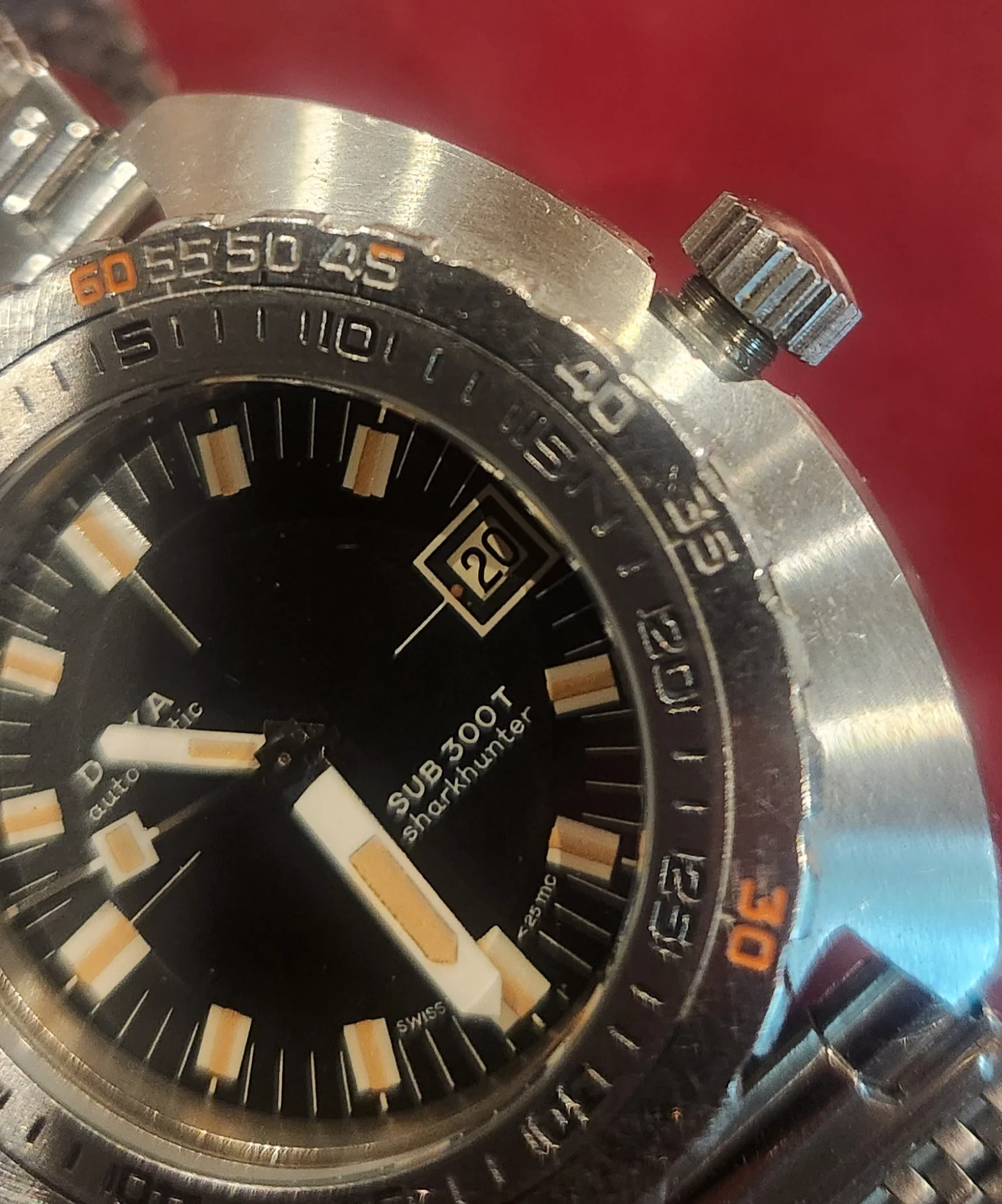

I've loved vintage Doxa Subs since I saw my first on a wrist nearly 20 years ago. Had a 750t GMT a decade ago, and in the last few years a newer 300t, but nothing pre 2000's, until now.
I enjoy learning as much as I can about the watches I own and go down all the rabbit holes I can (wife says I get obsessive).

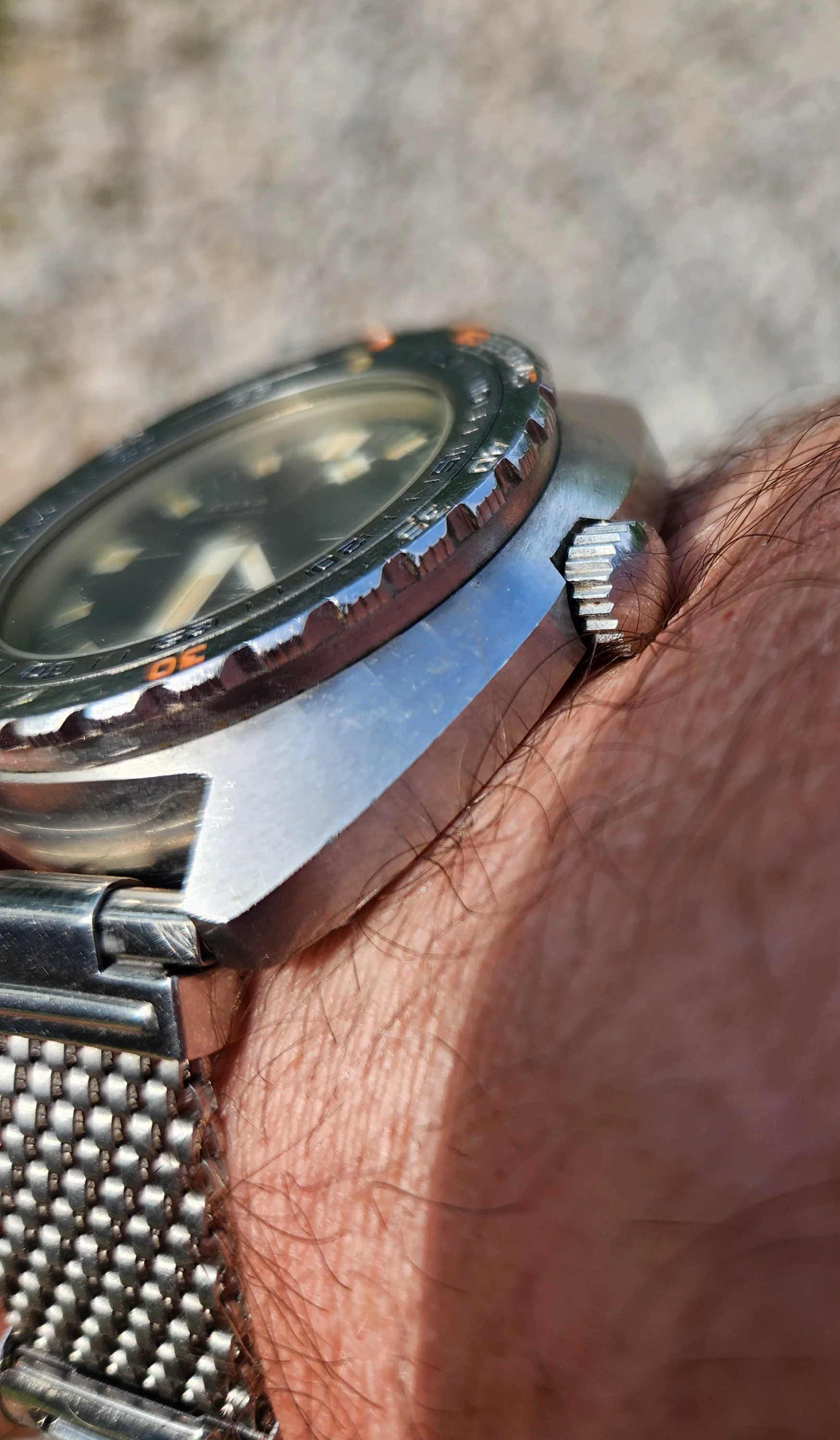

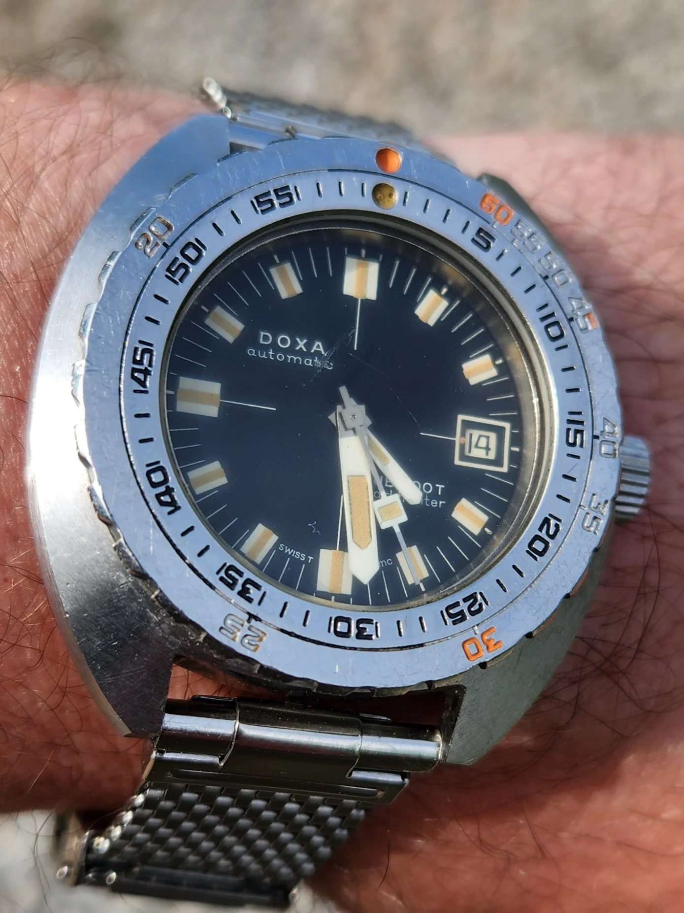

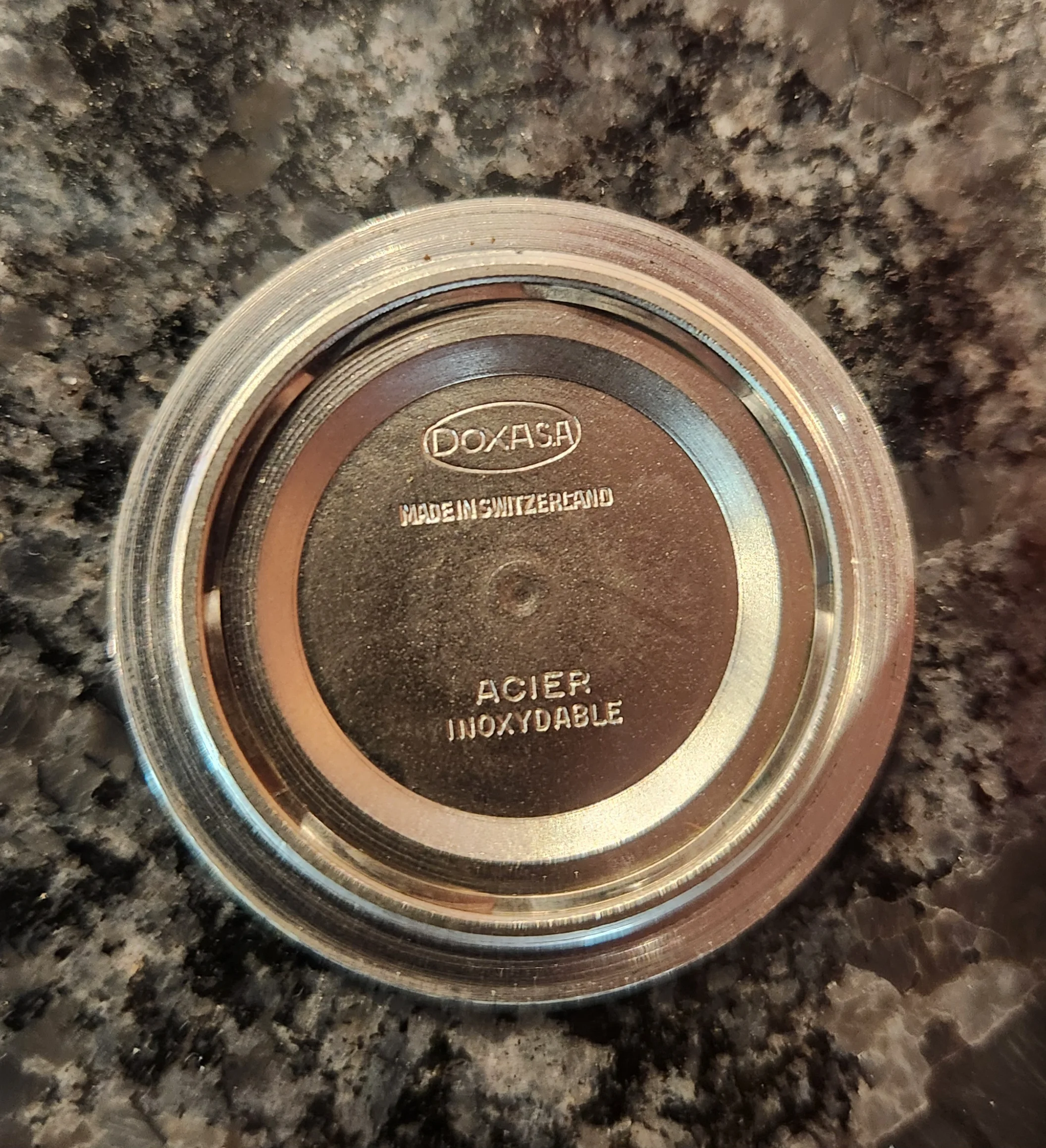

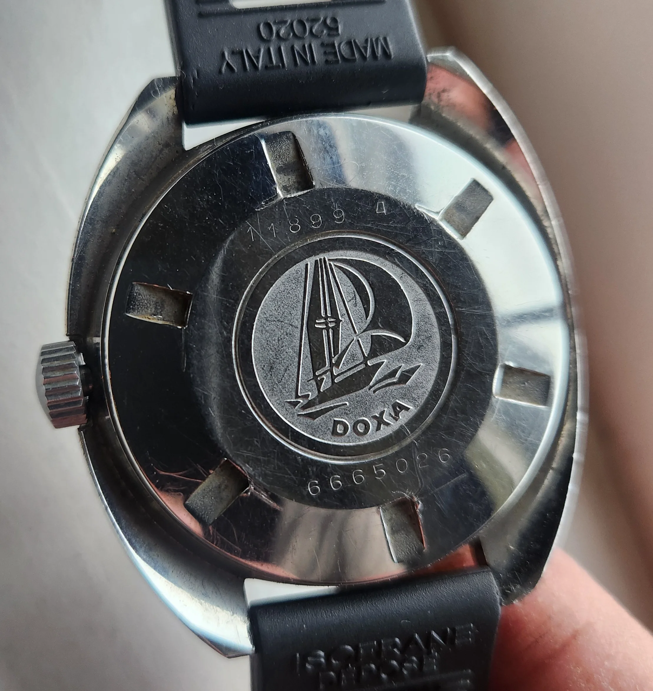

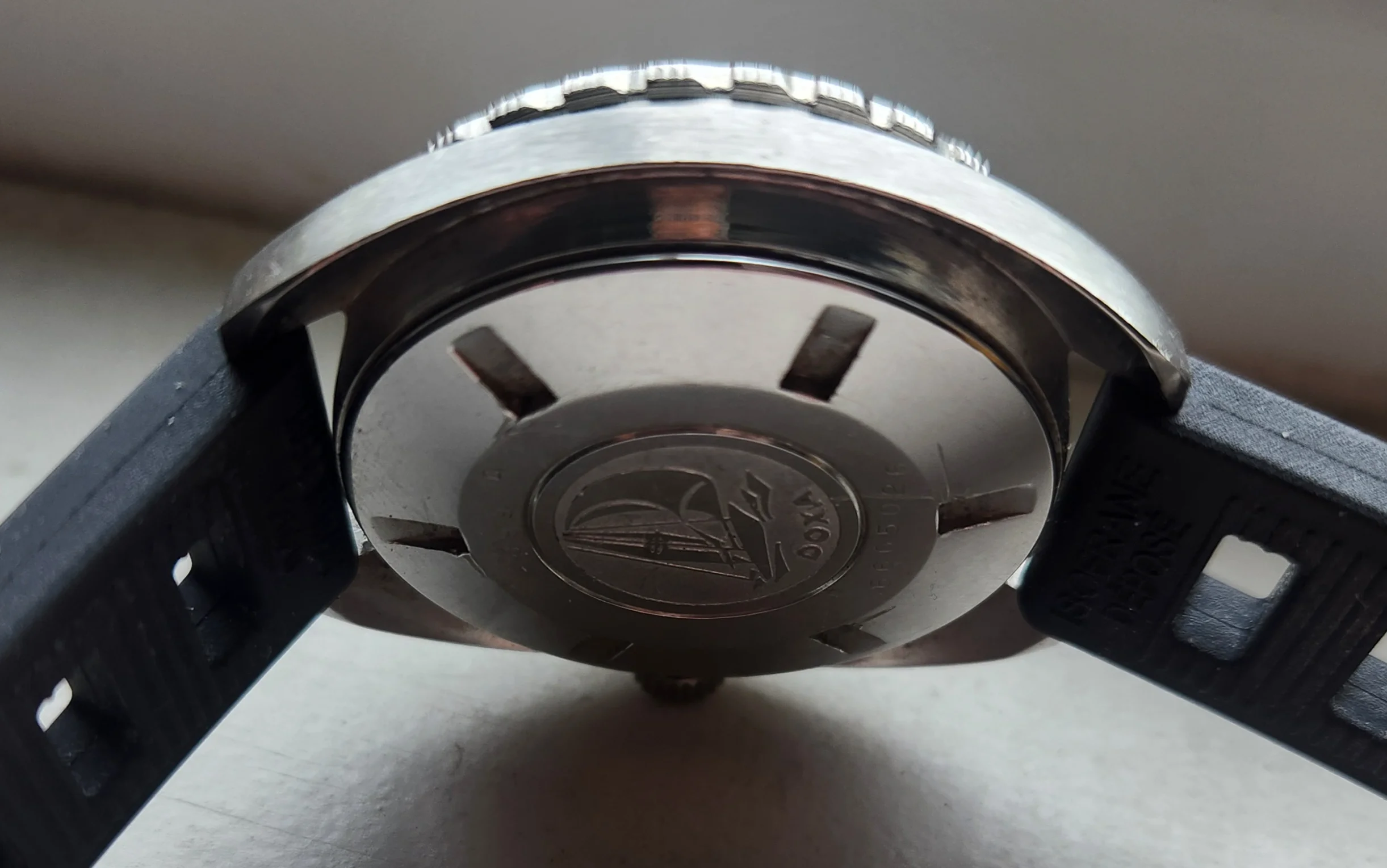

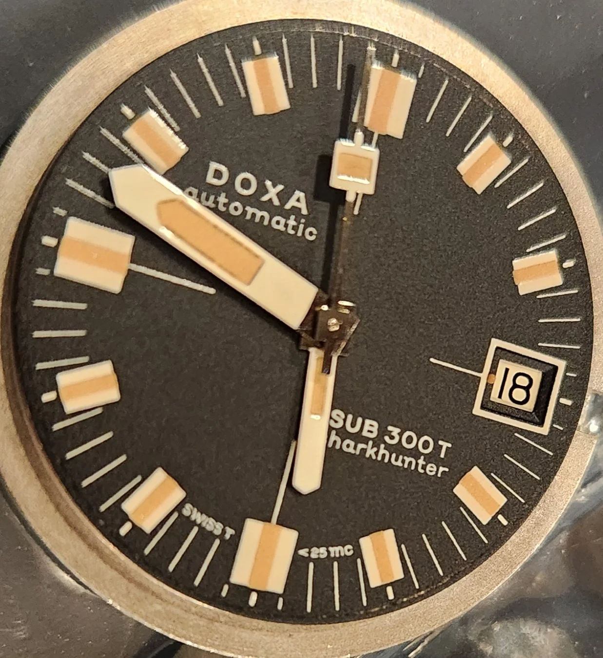

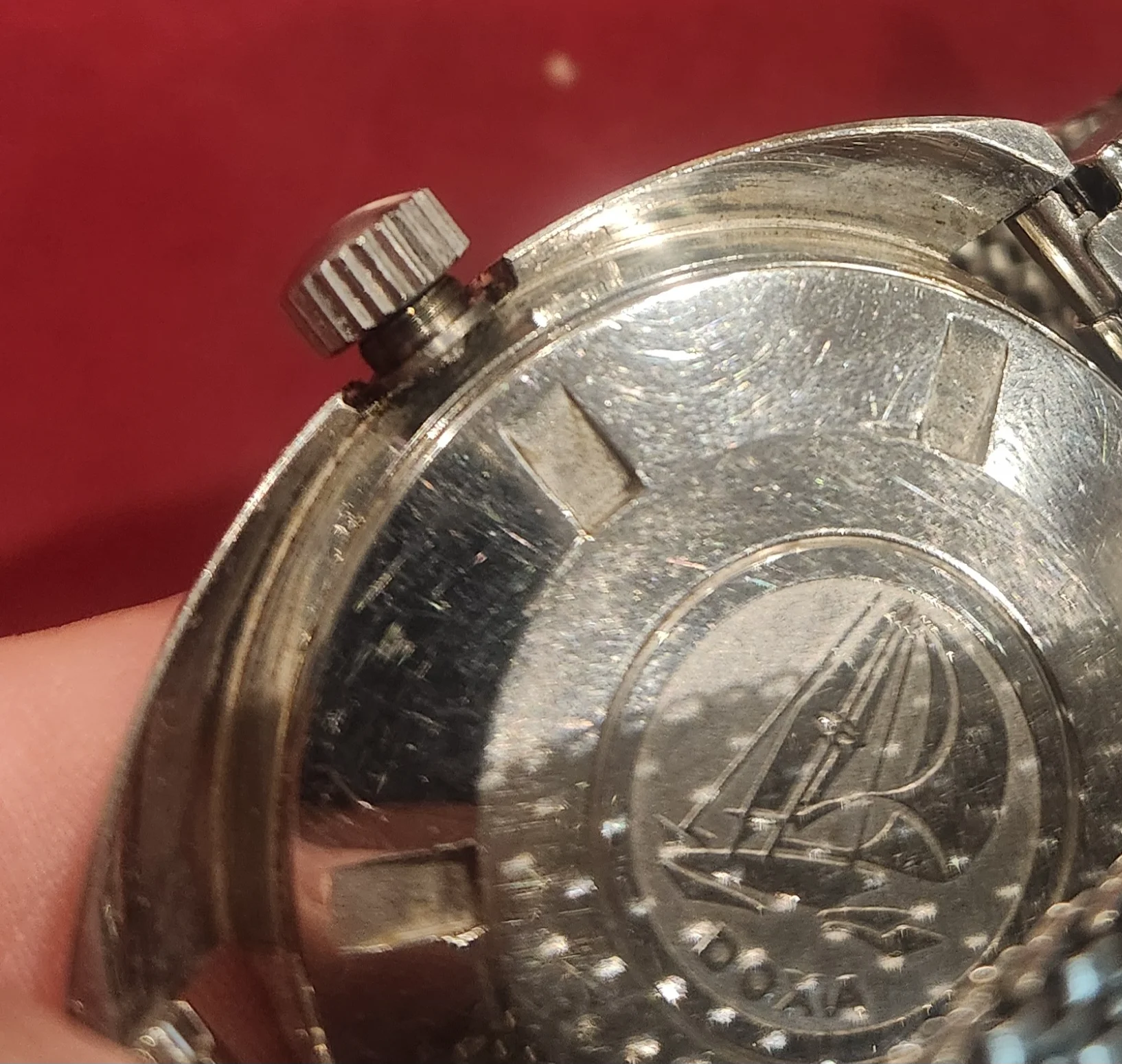

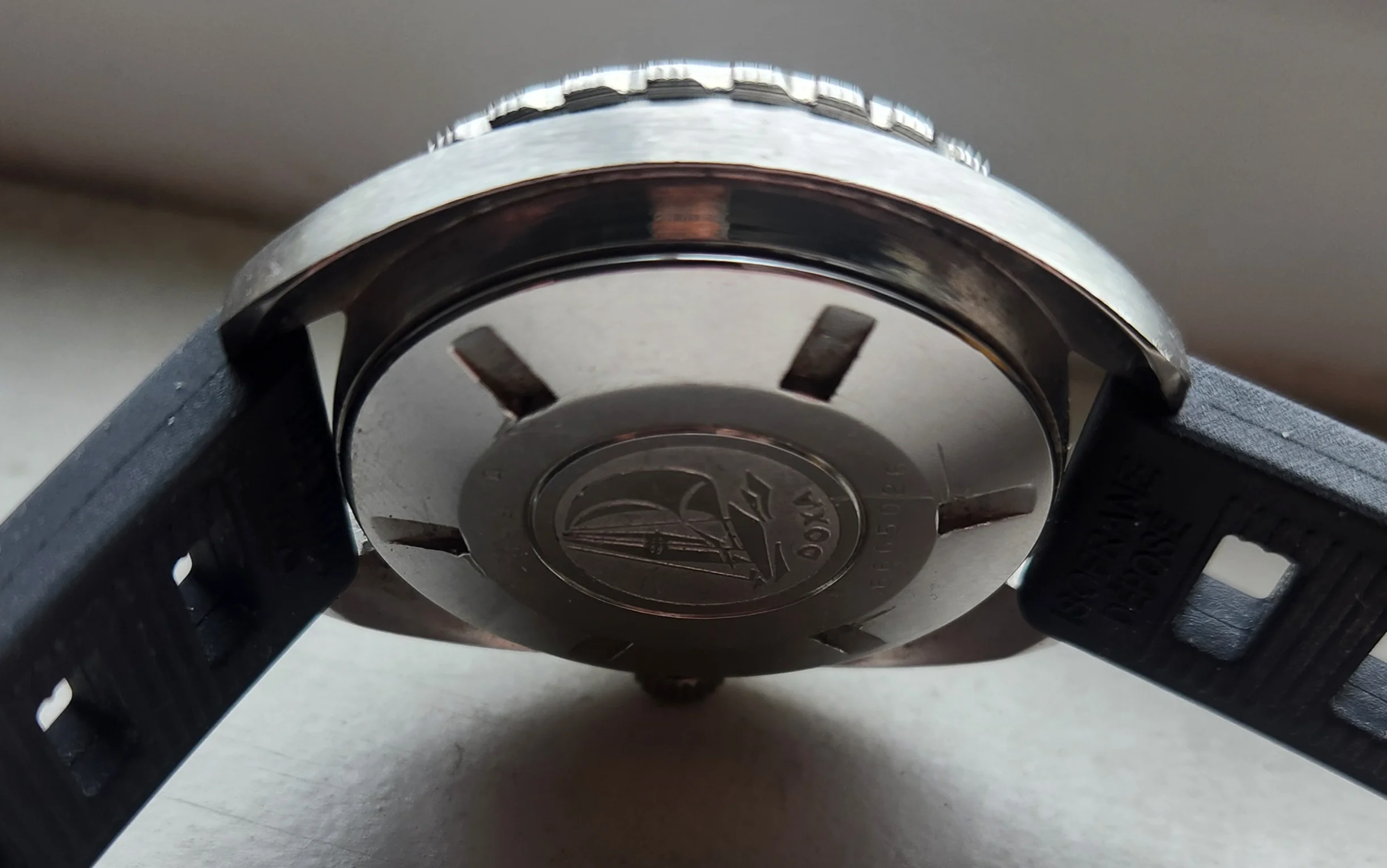

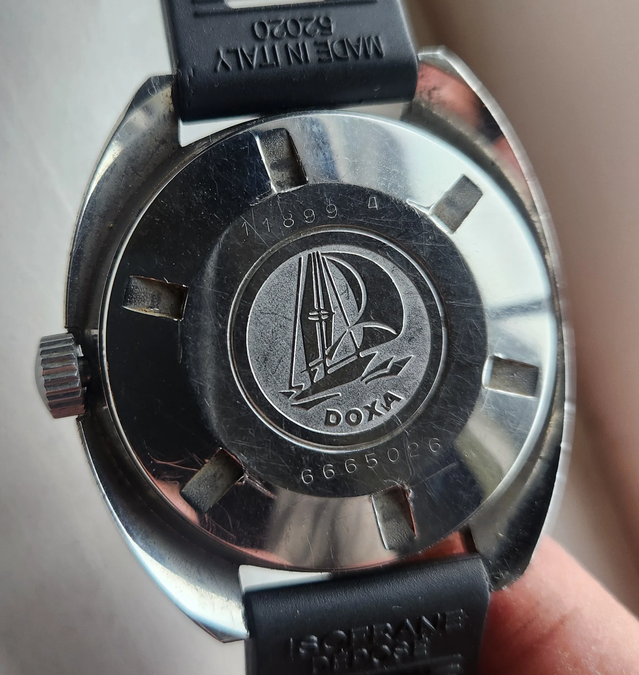

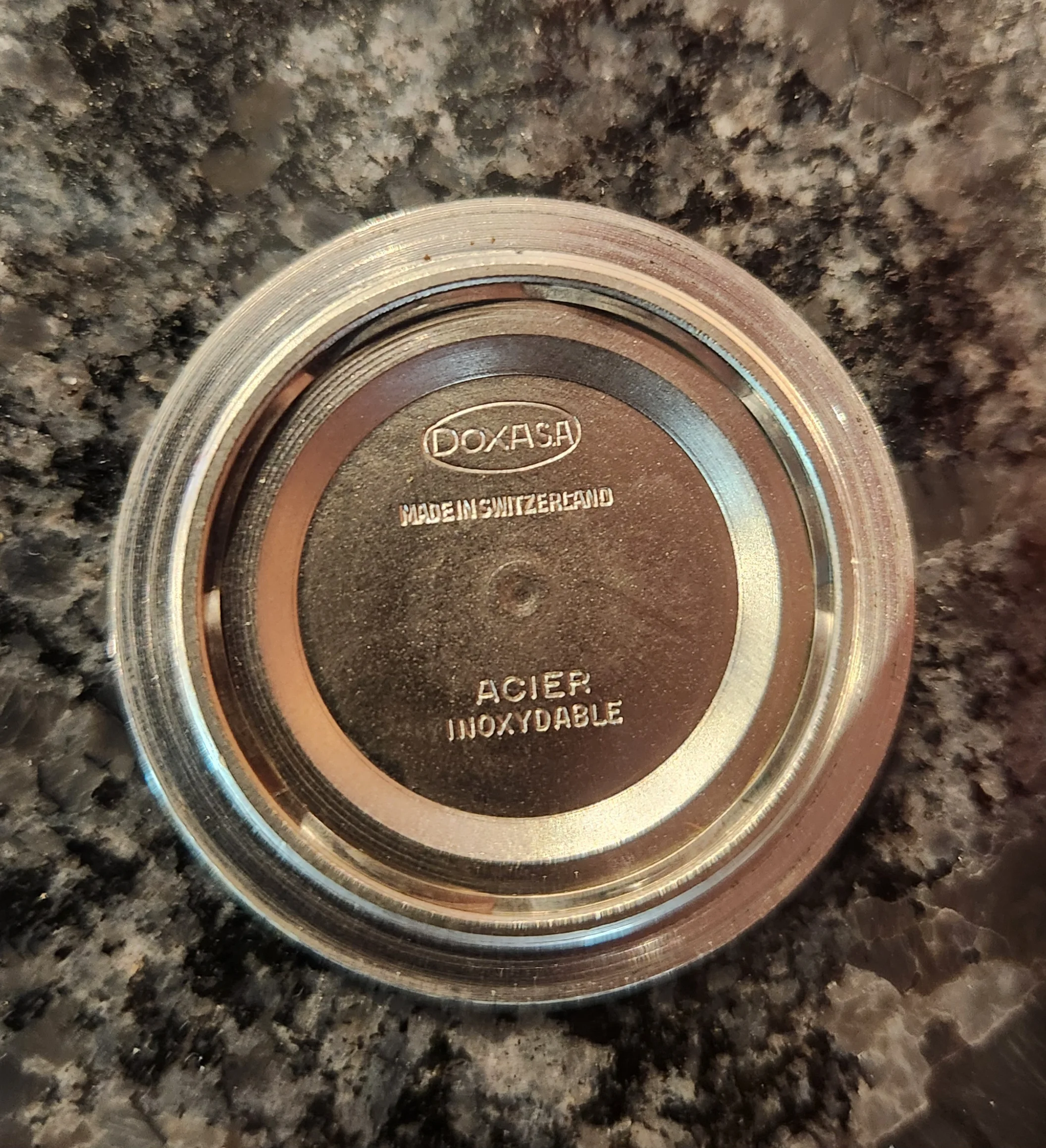

I have a general knowledge of Doxa Subs and know this Sharkhunter is "pre-Synchron" due to the lack of synchron markings on the dial and still having the Doxa logo on the caseback. But, it has what I believe is an original push-pull crown rather than the earlier screw-down crowns. The movement is the earlier version without a quickset date, but I haven't opened the case yet.
Numbering on the case back is crisp, and the case appears sharp and retains what looks like original brushed finishing. The bezel is a meters version and has minimal loss of enamel. Crystal has been hit hard and case has some dings, but most of these were used hard, put away wet, and show it.
I've seen that the first 2 numbers of the serial denote year, but I'm not sure that fits with these as most "pre-Synchron" Subs seem to have a 66 beginning to their serial. Synchron merged with Doxa in 68 or 69 depending on the source. Maybe this one is a transitional watch of sorts?
Is there an authoritative reference for vintage Doxa Subs? Have I overlooked anything that can be used to estimate a date?

That's lovely.

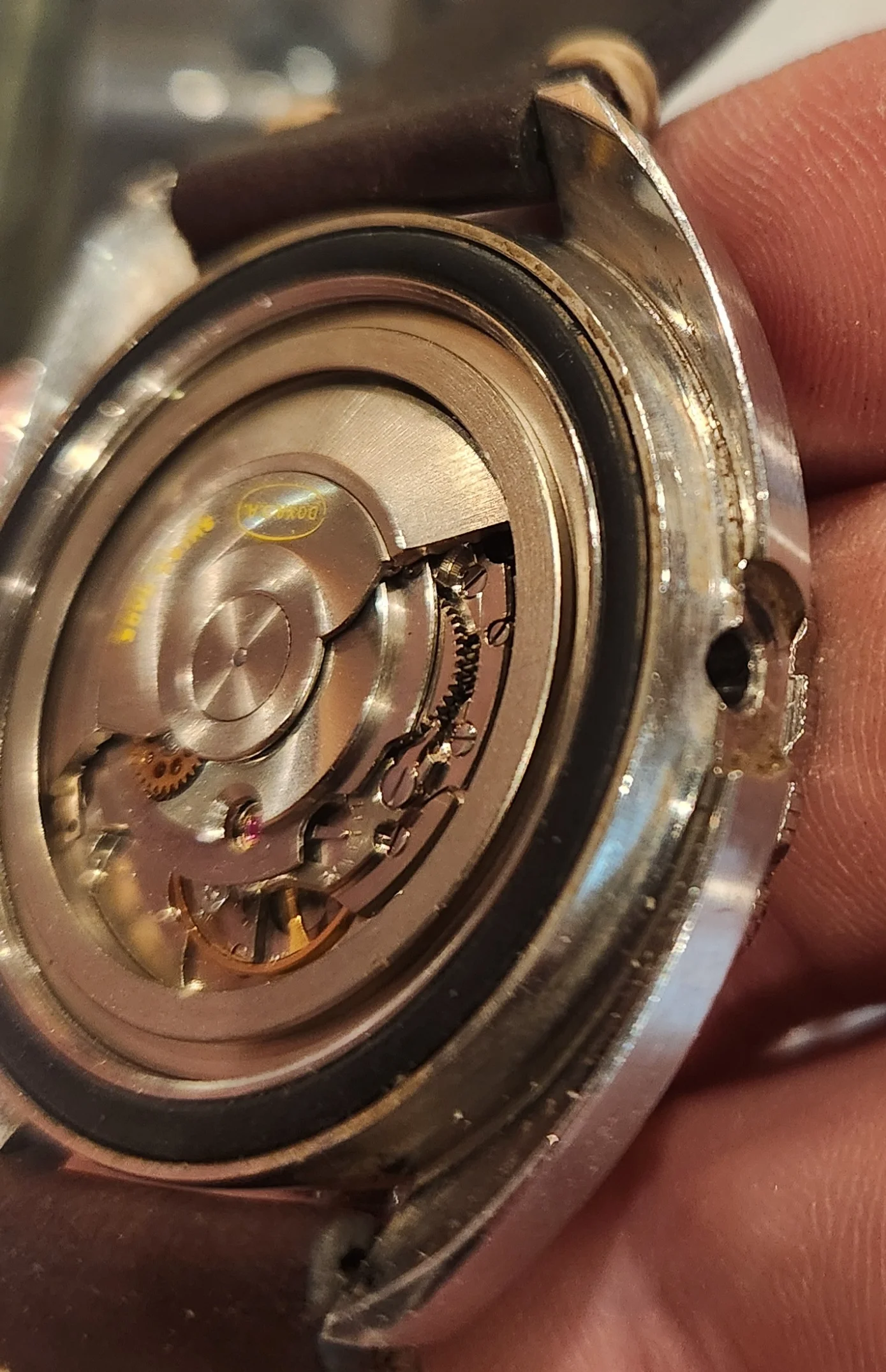

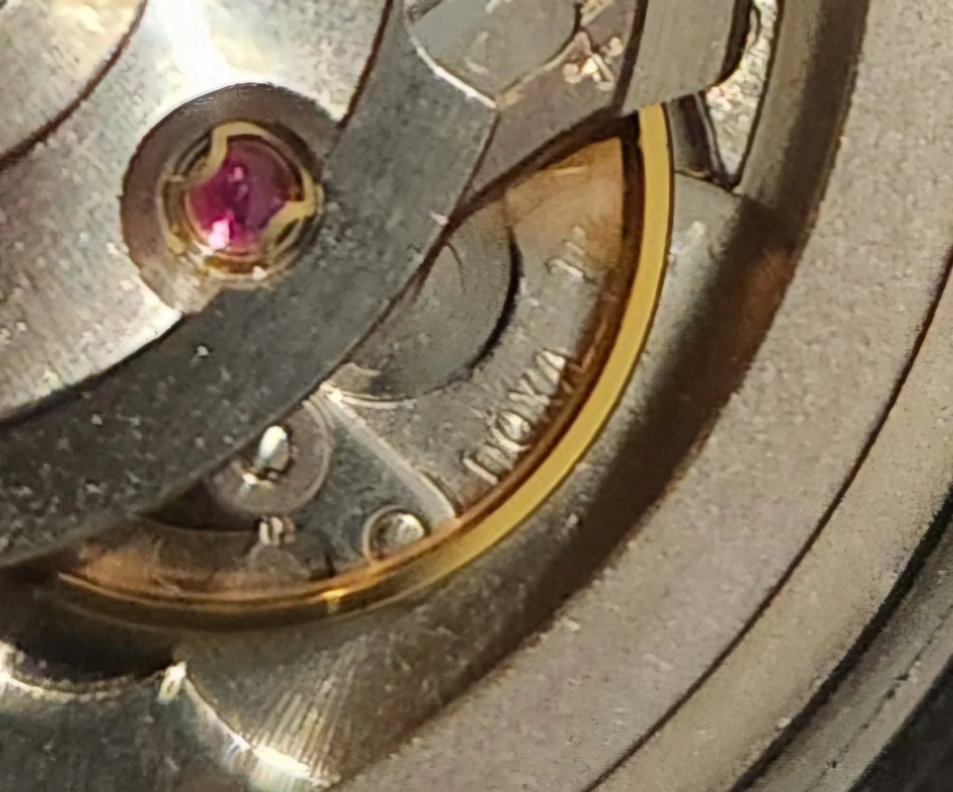

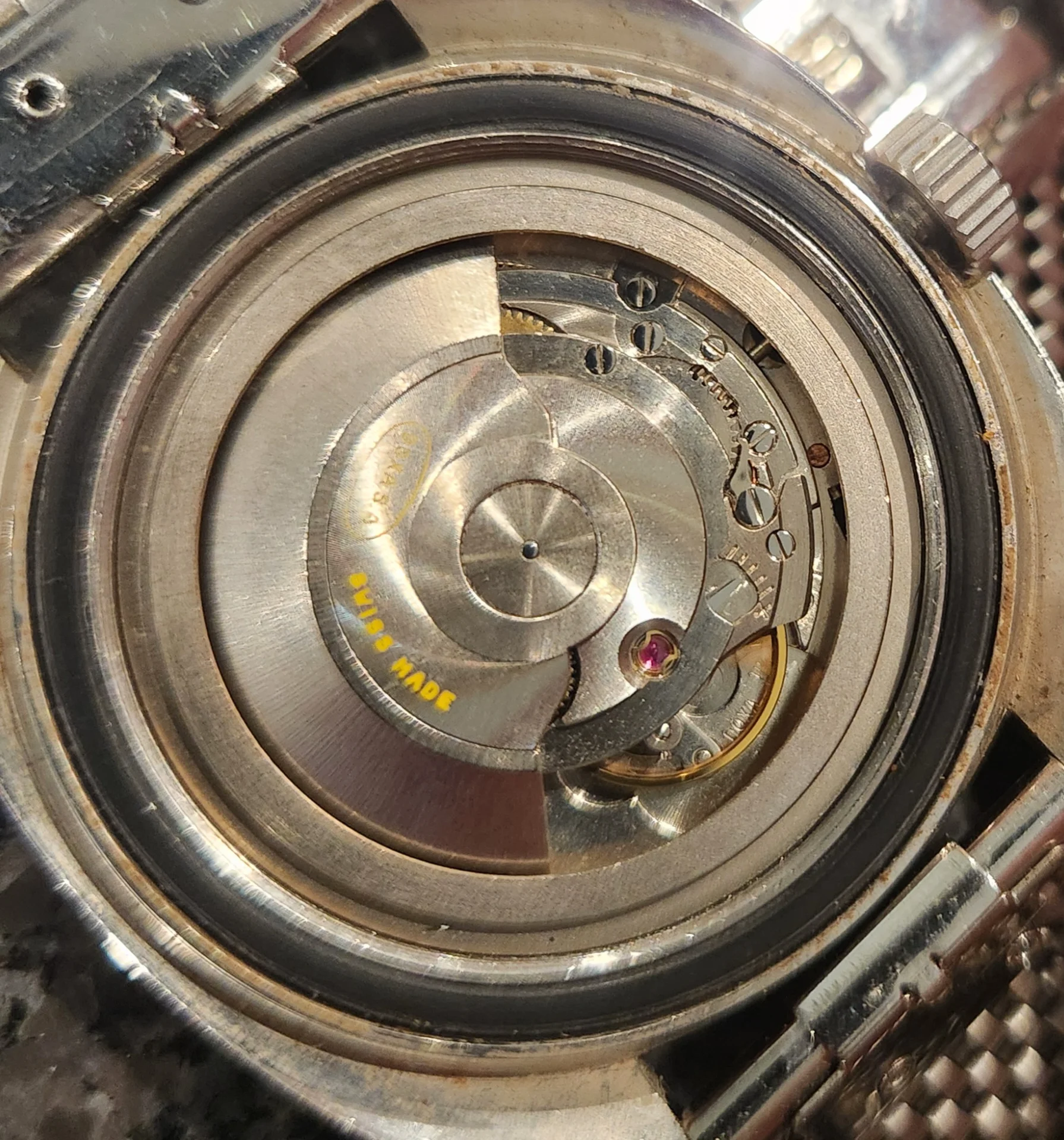

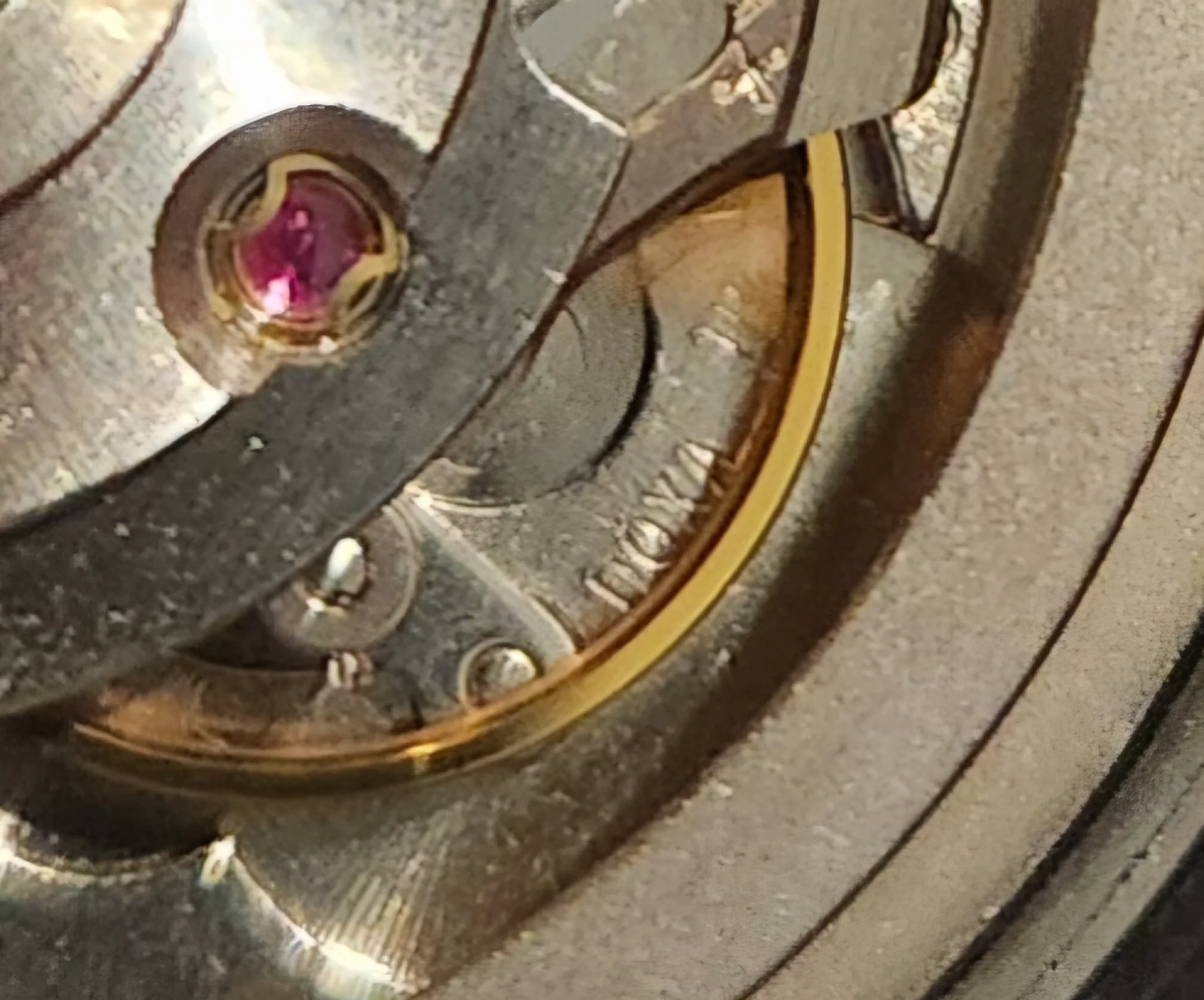

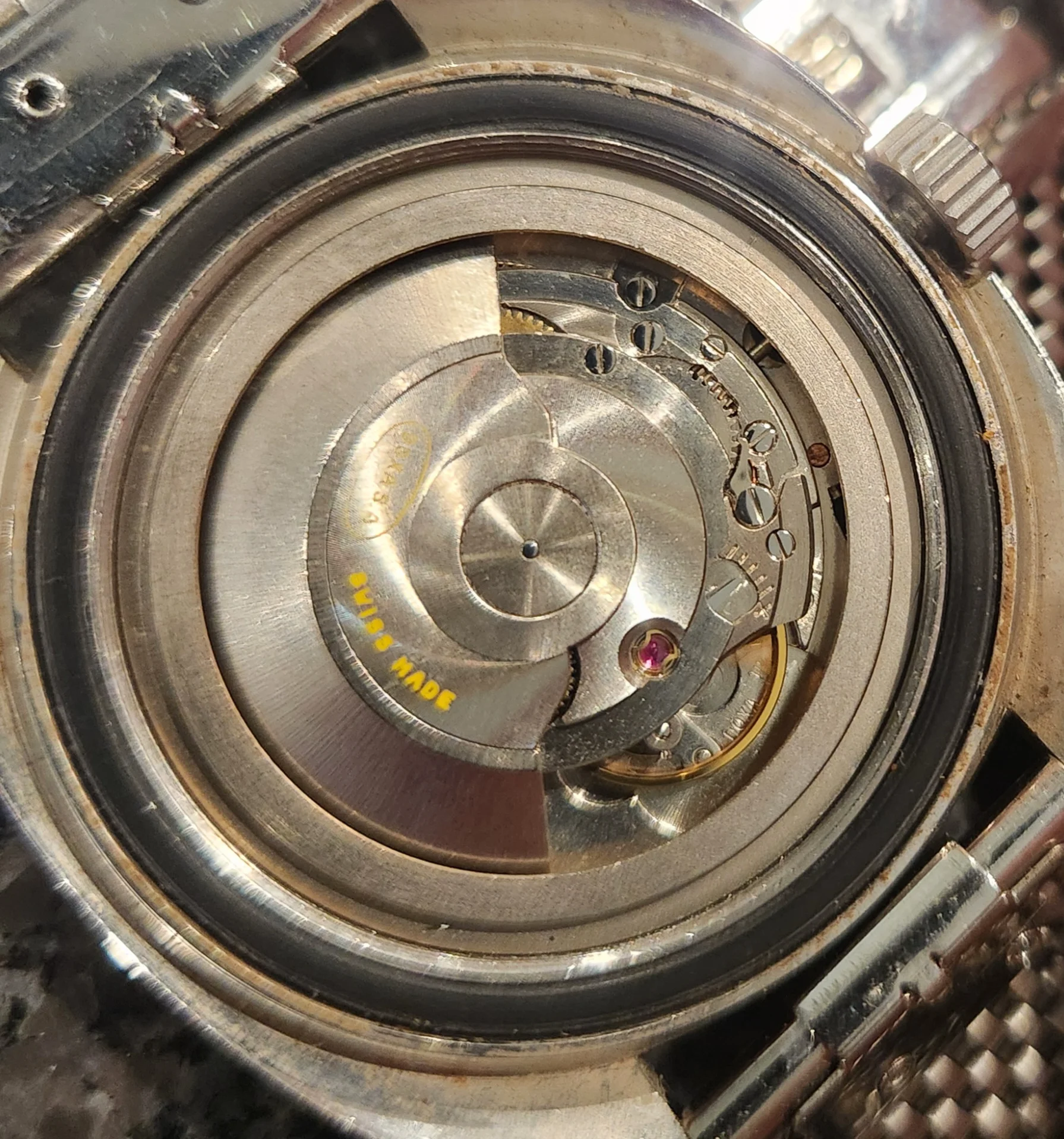

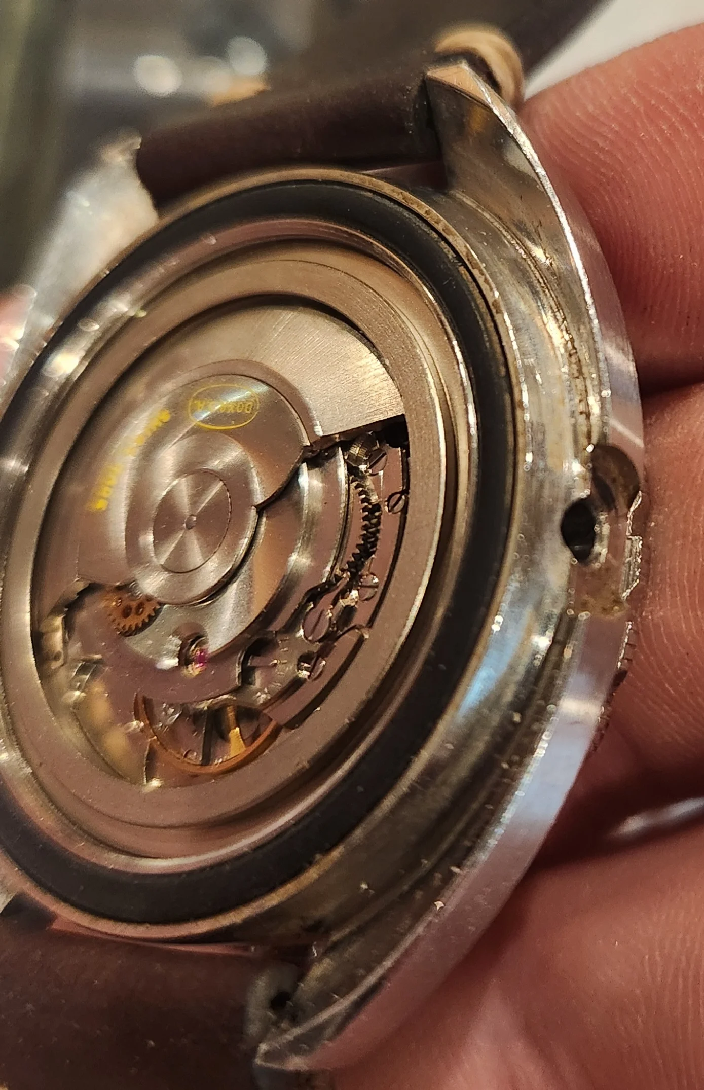

Here's a couple movement shots since I opened it up:

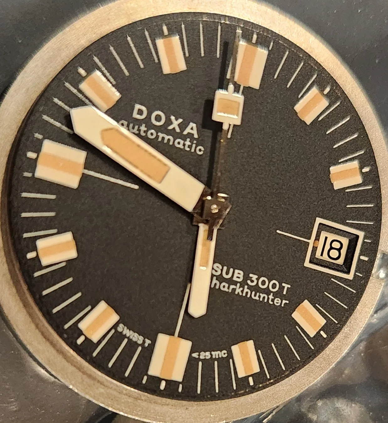

Your dial and hands really are spectacular! Where did you find this one?
227
1,420
Thanks, I don't think I could be happier with what I ended up with. It's an ebay buy all in under $1500 out of Maryland. Even has the little lume pip at the date.

That's a steal!!!
You don’t really believe that serial number could ever get worn do you? That watch has the power of Satan behind it.

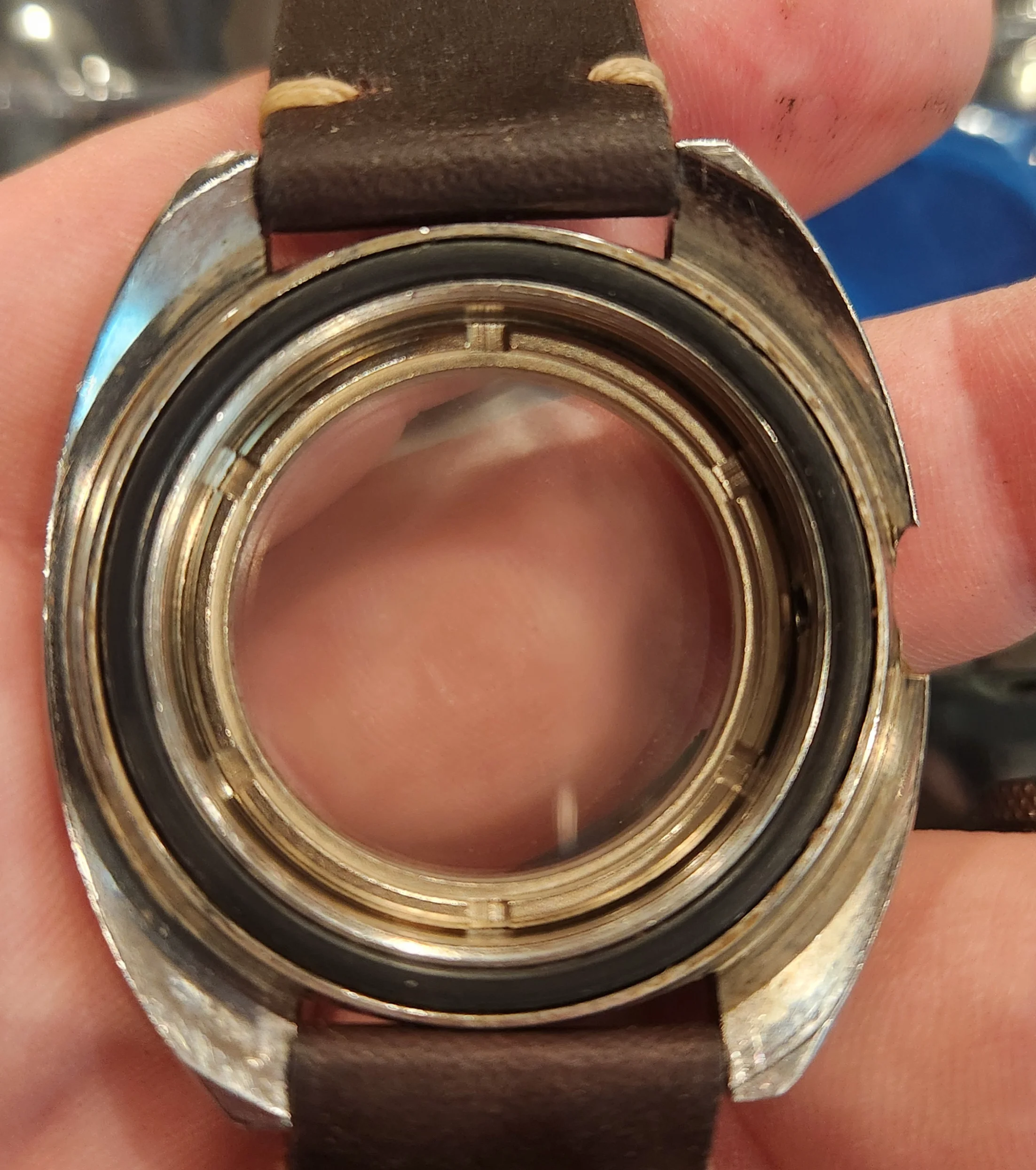

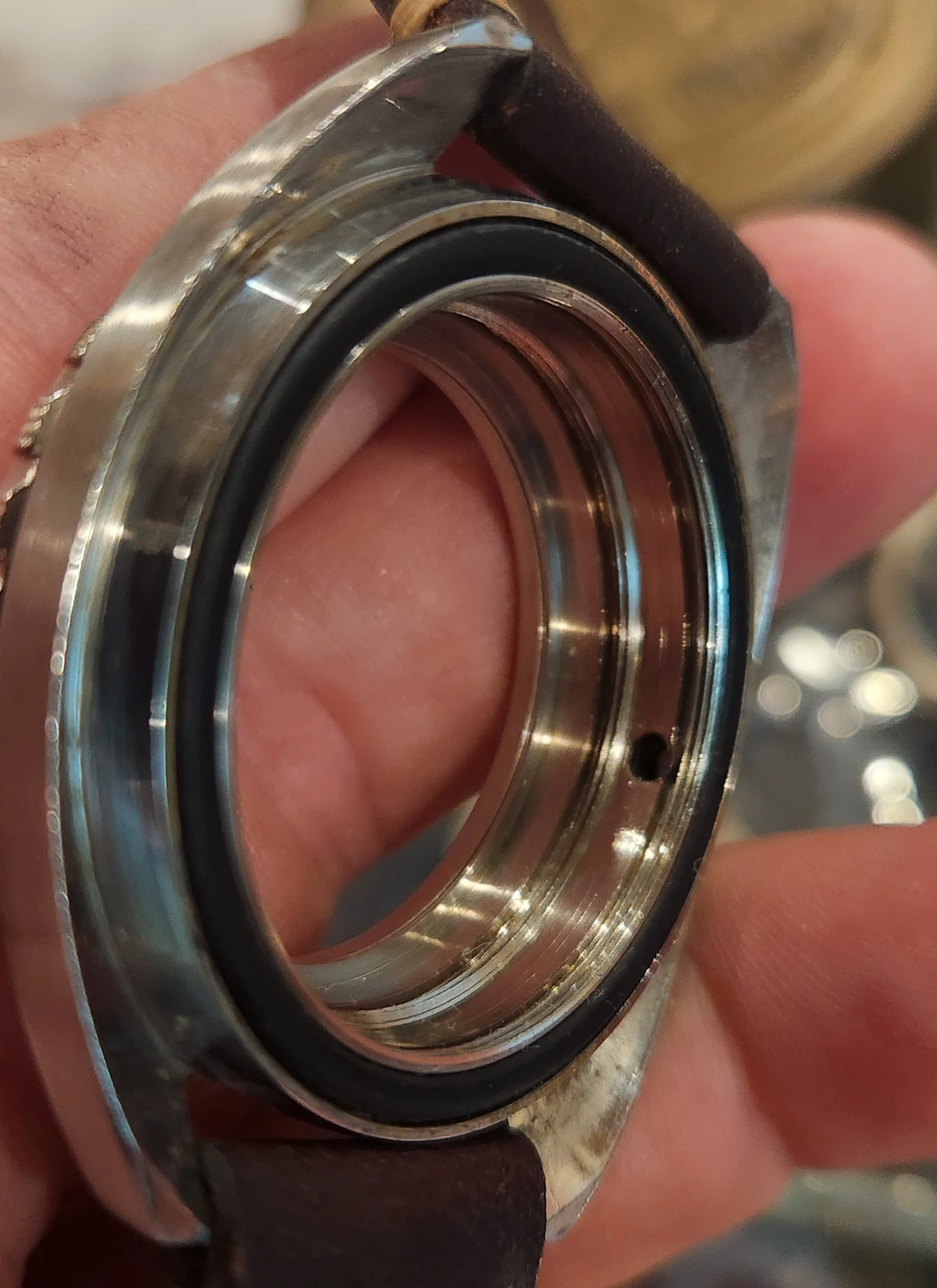

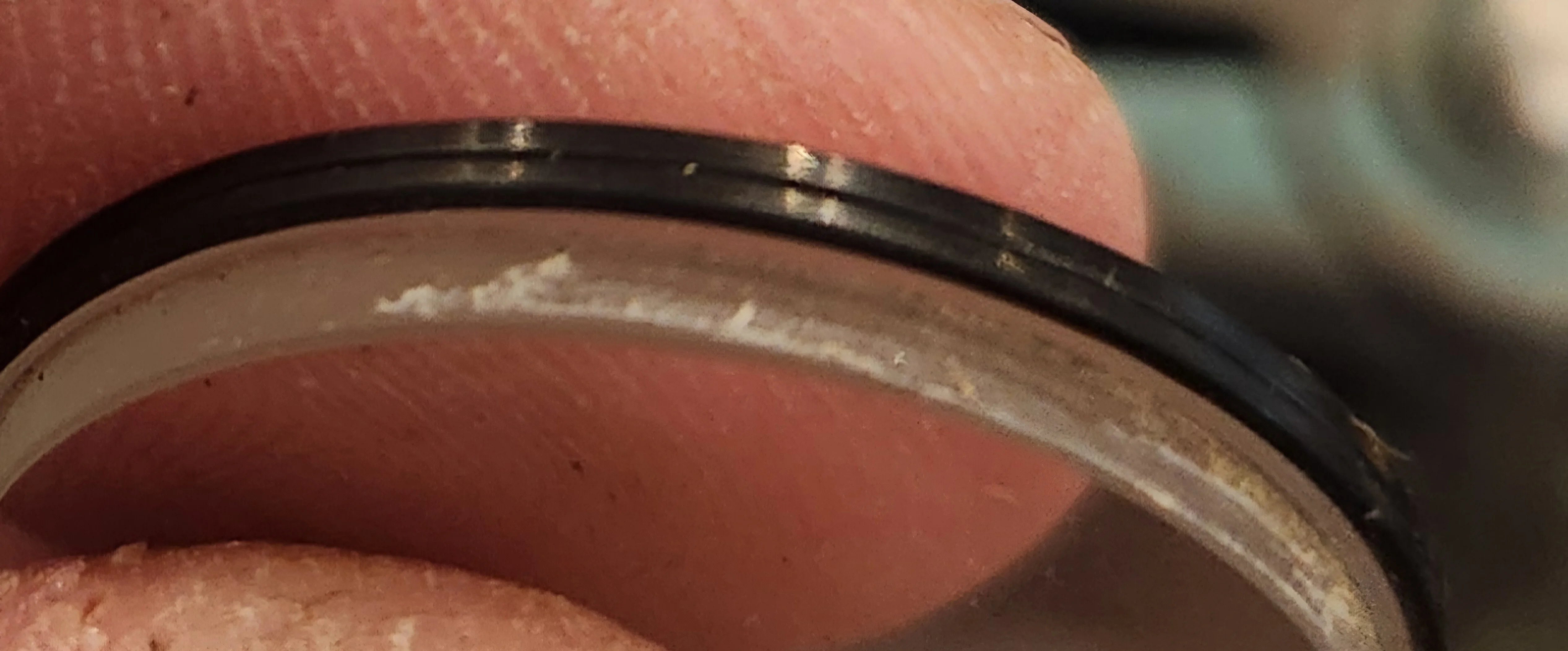

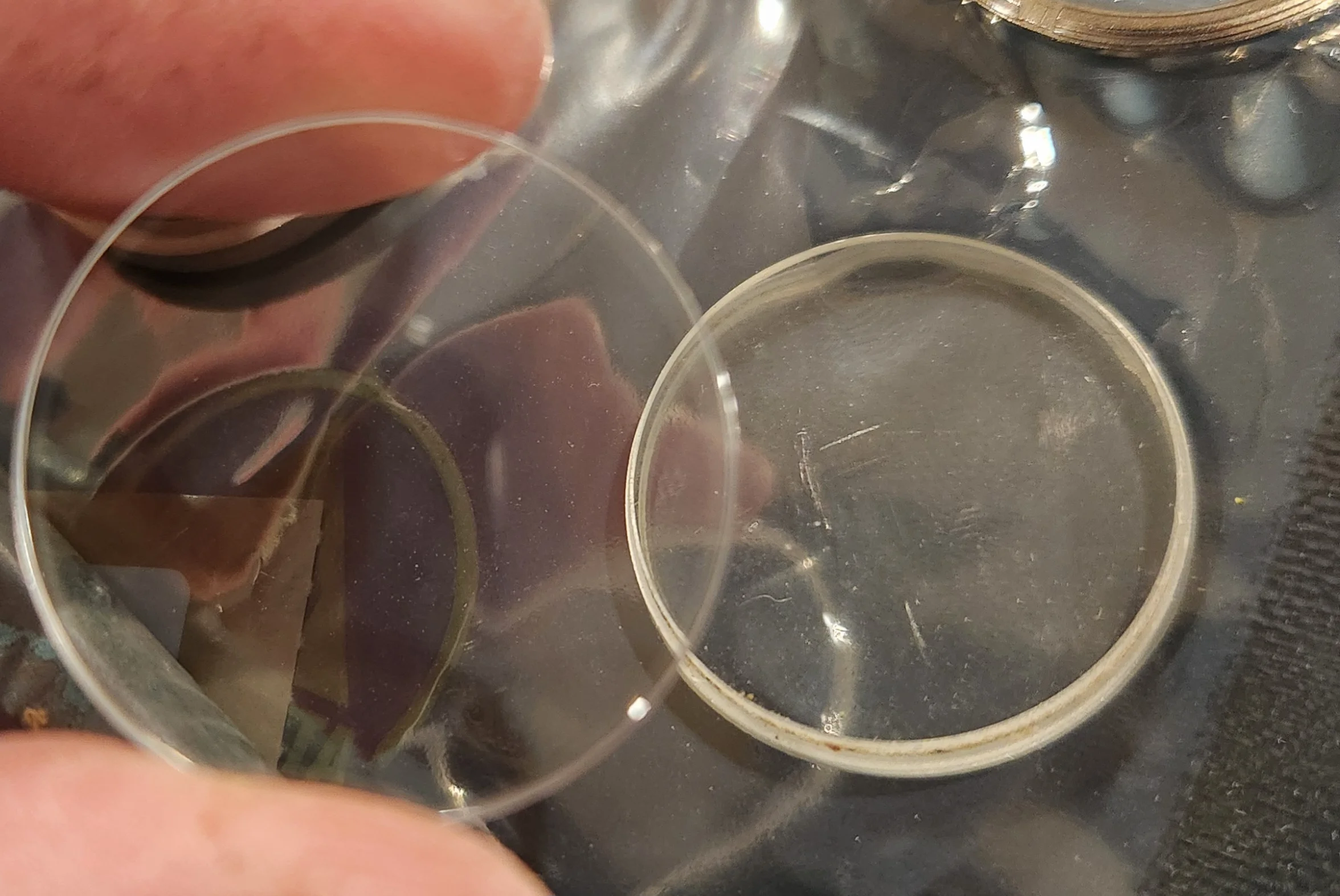

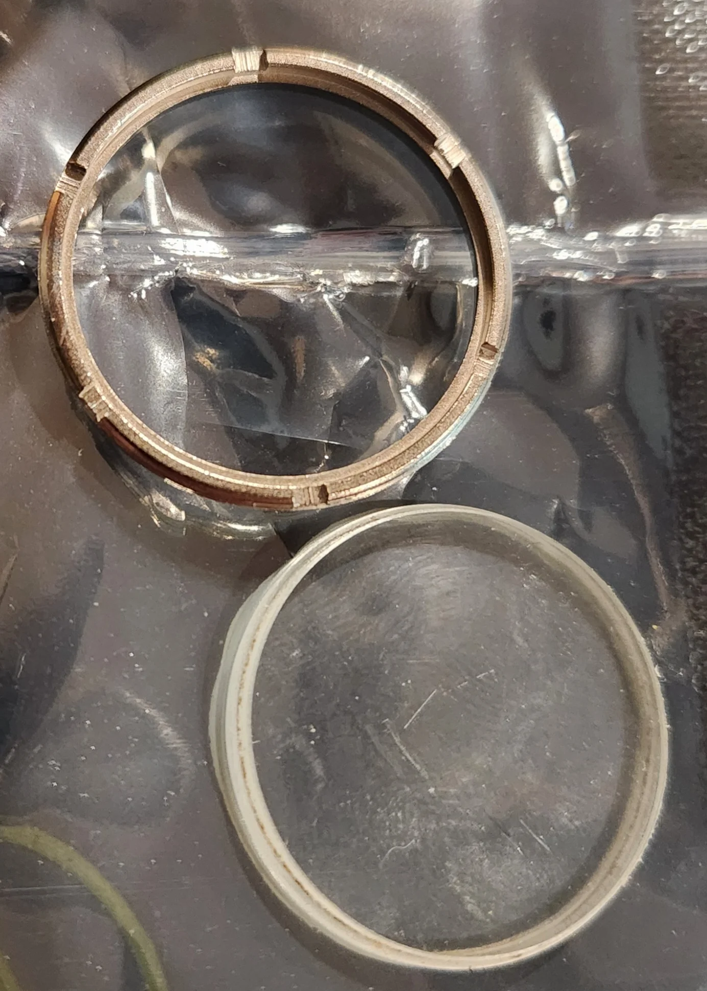

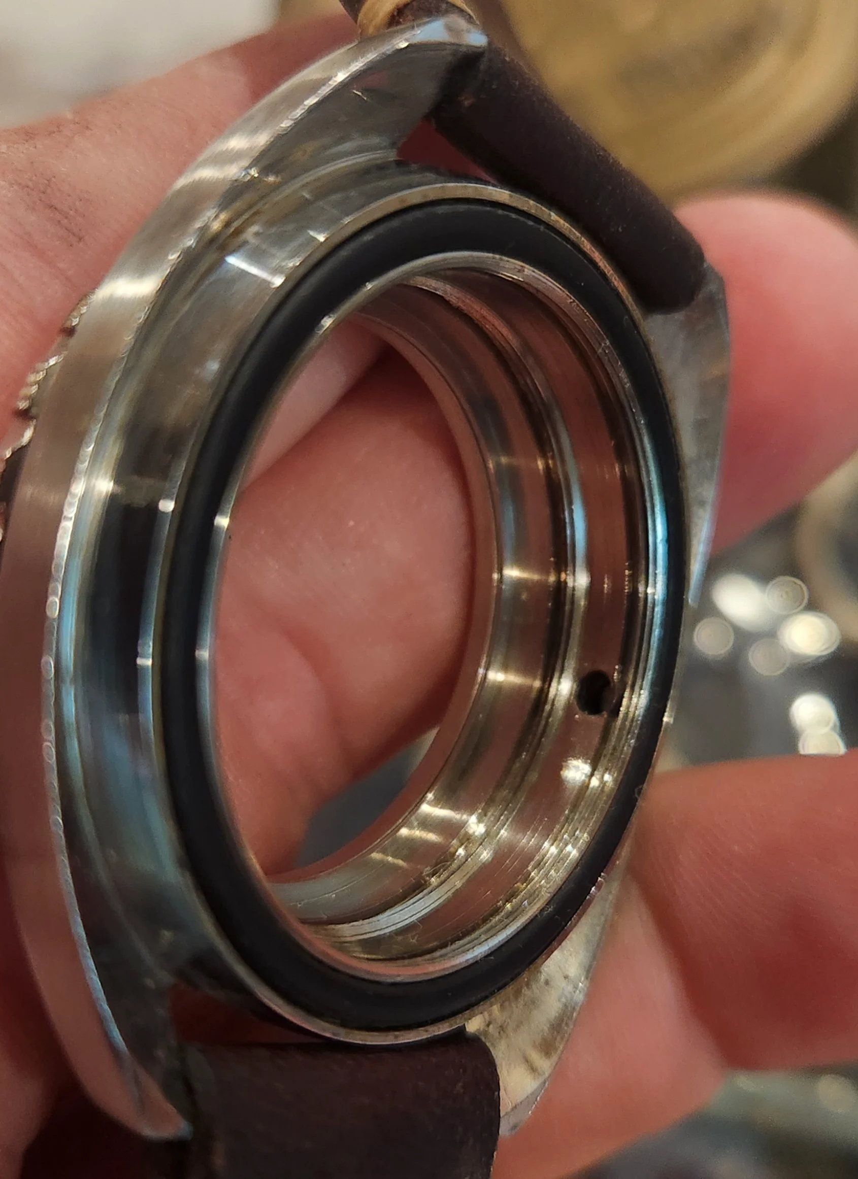

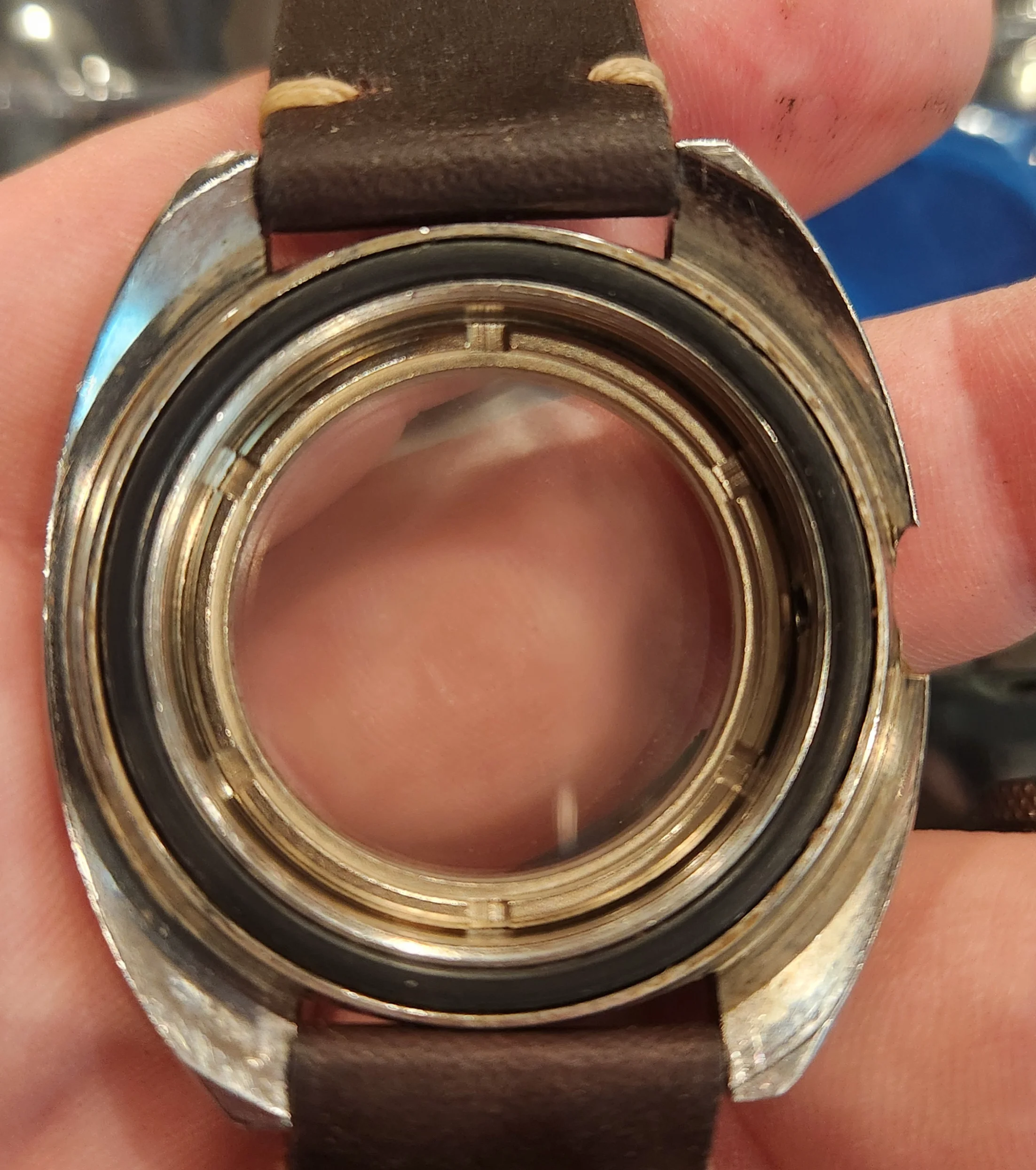

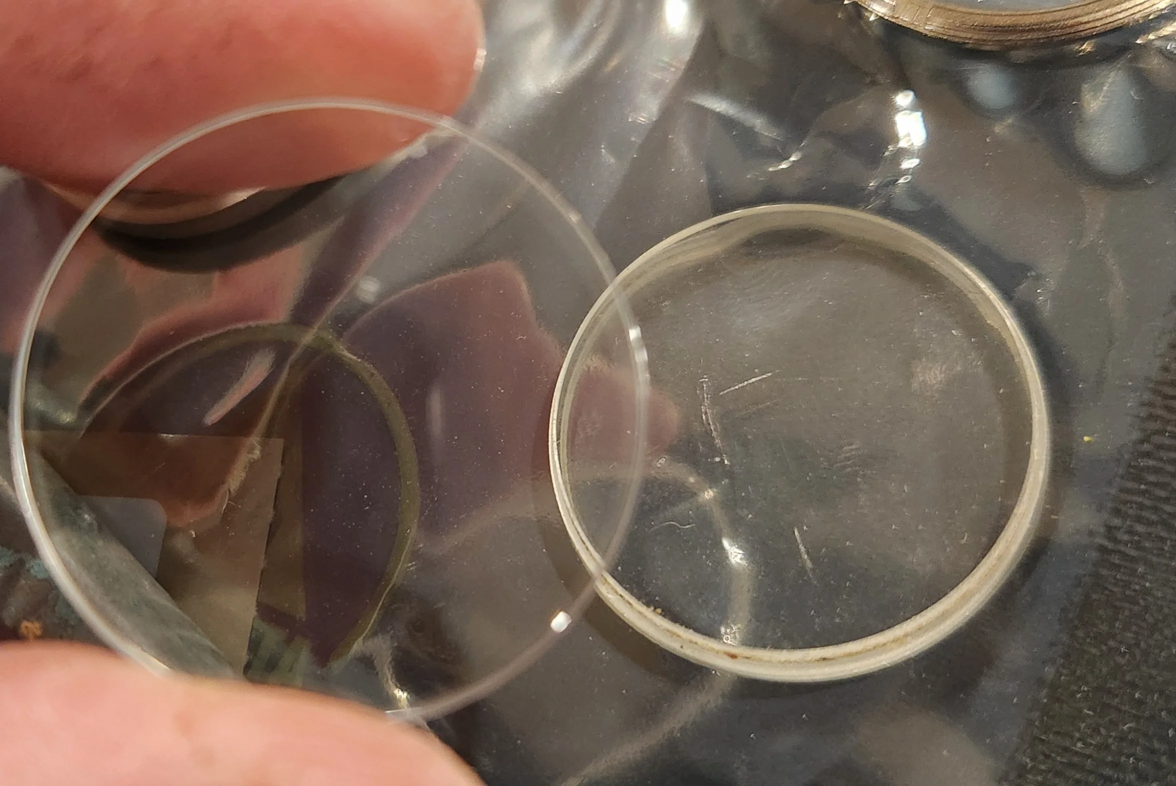

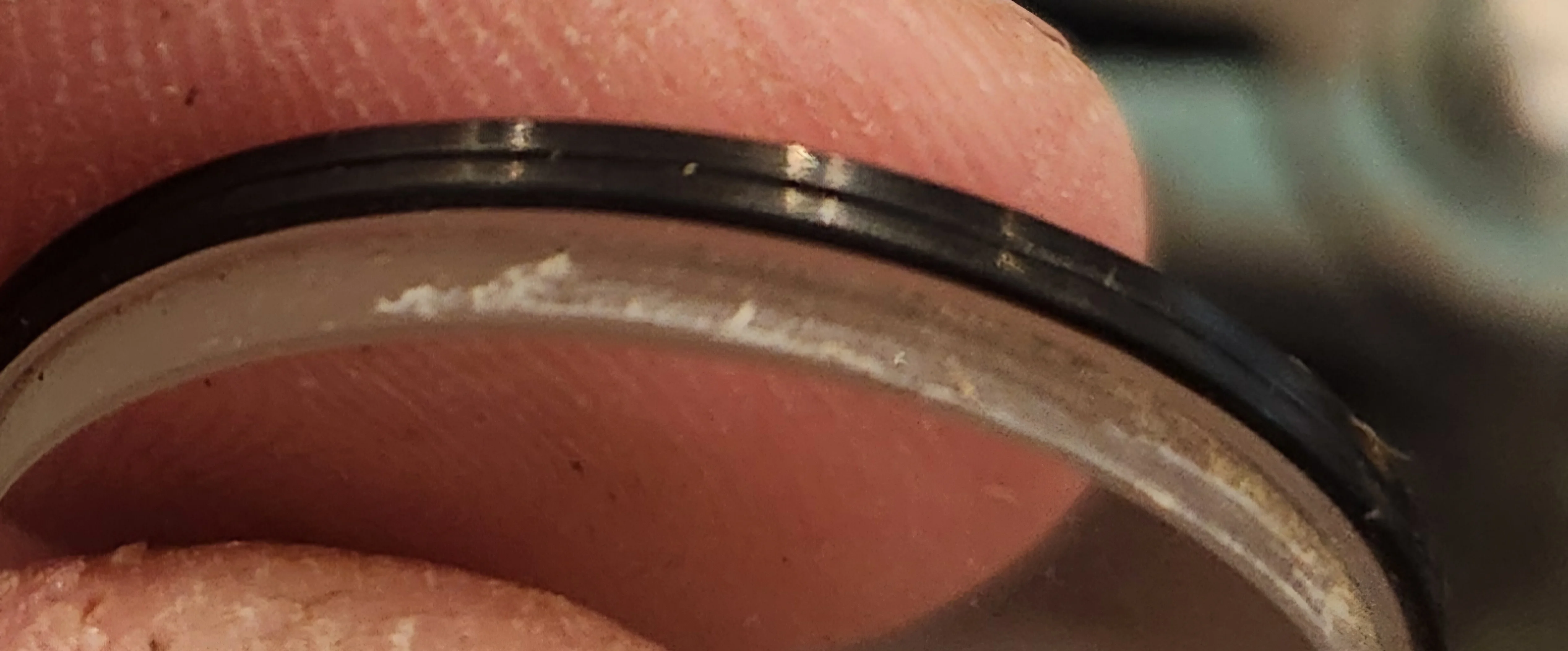

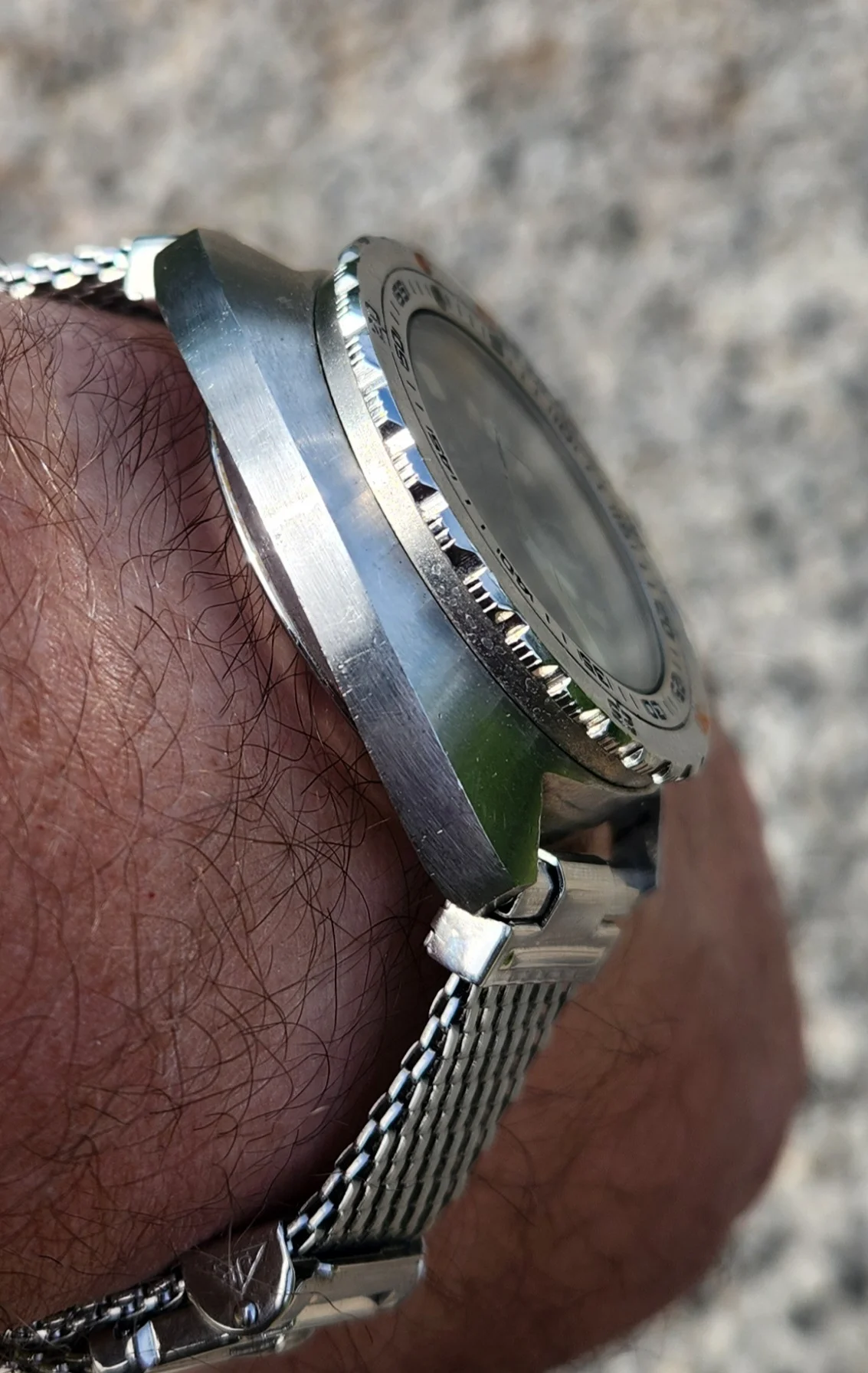

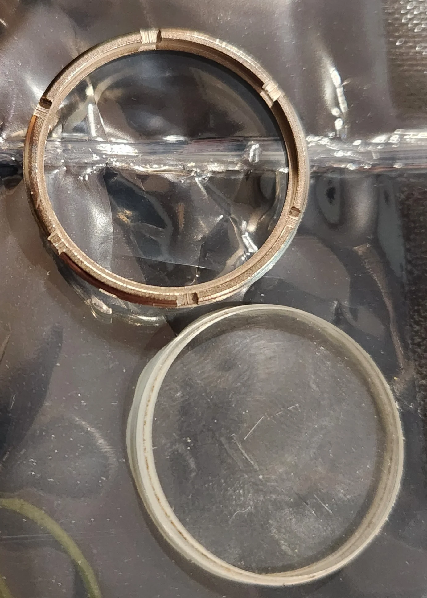

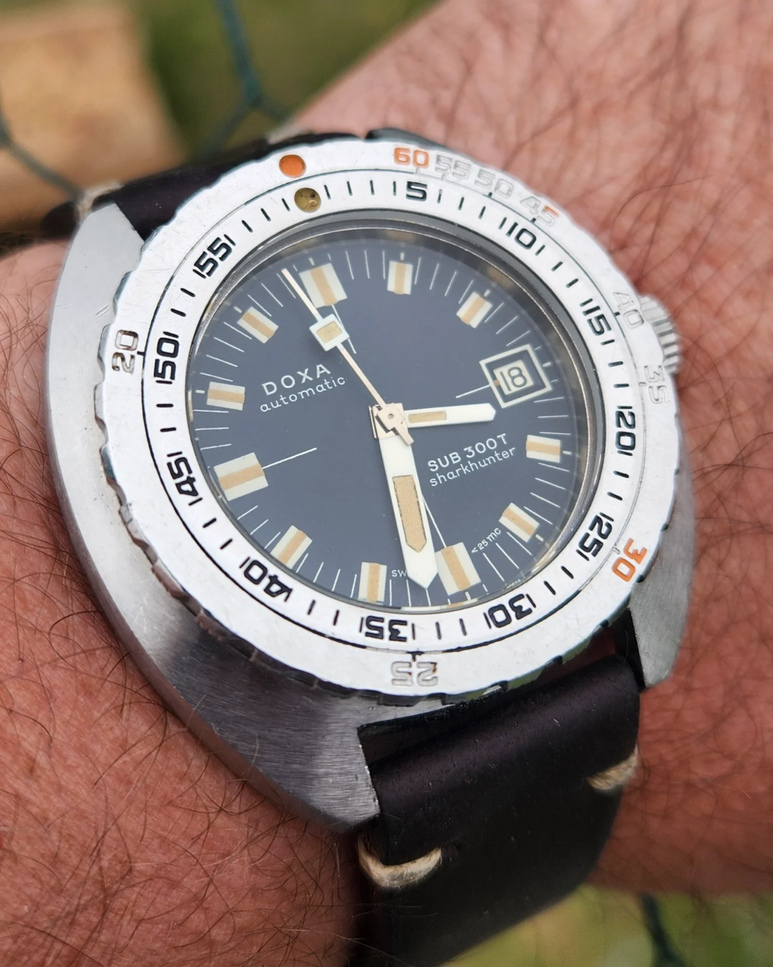

Installed a new crystal this evening. Interesting case design with a screwdown crystal retaining ring and gaskets (2) on the stepped outer edge of the crystal.
1,011
1,829

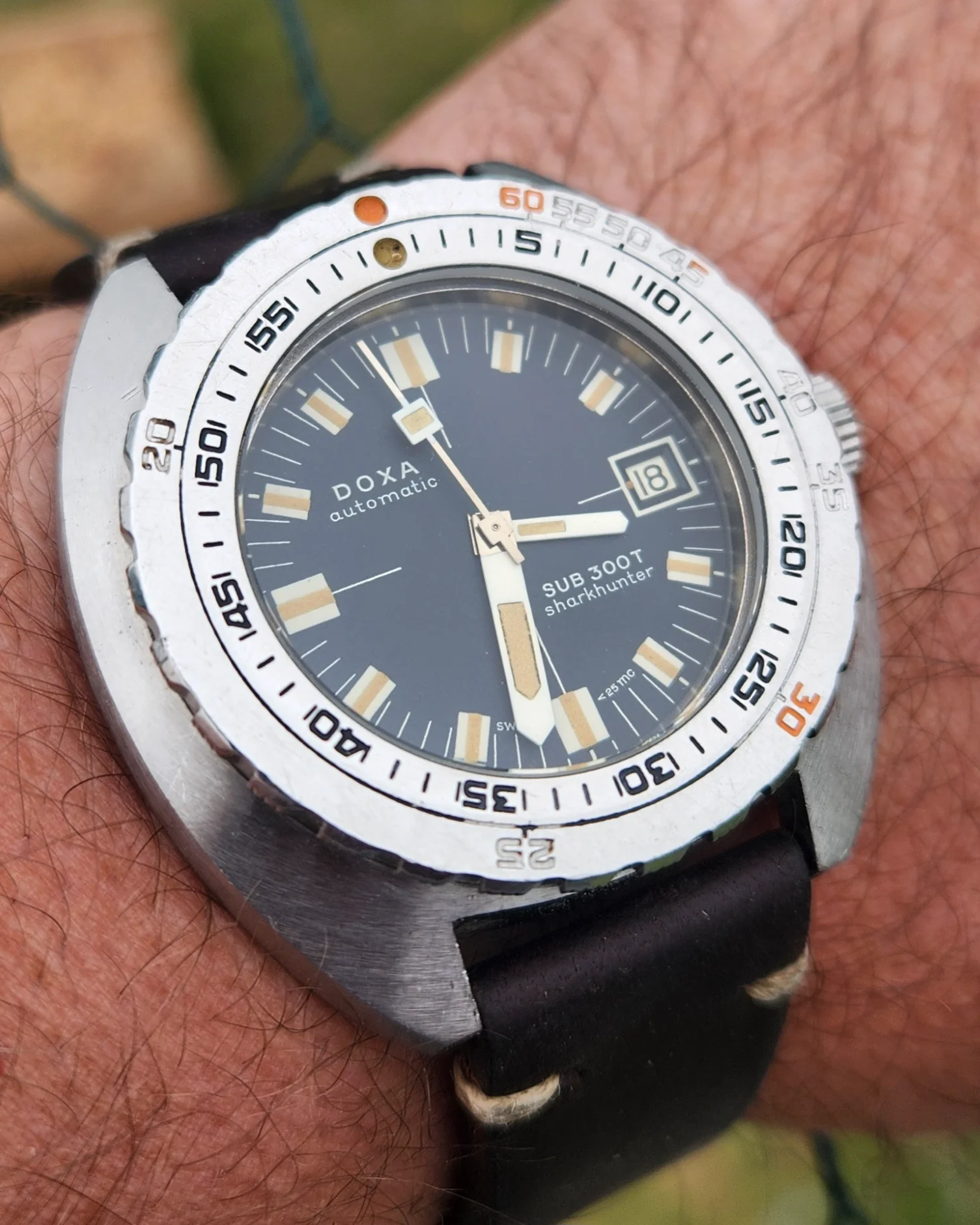

🖤🖤🖤 that's sharkhunter love!
Love everything about this.... except the leather! 😜😉🥱

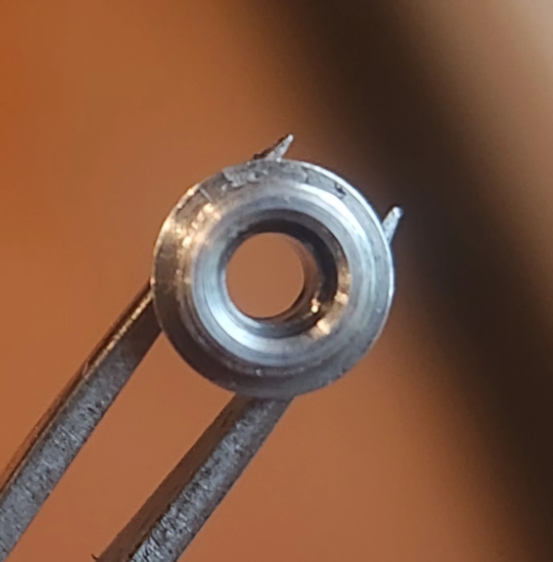

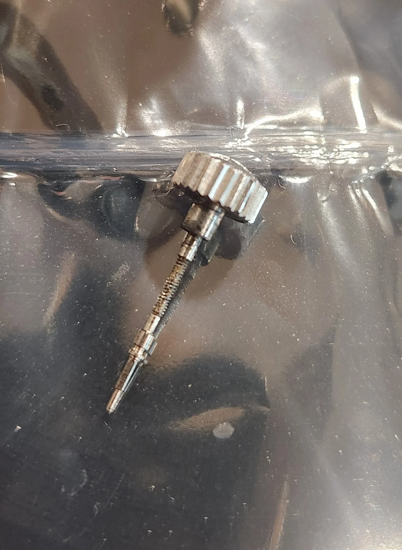

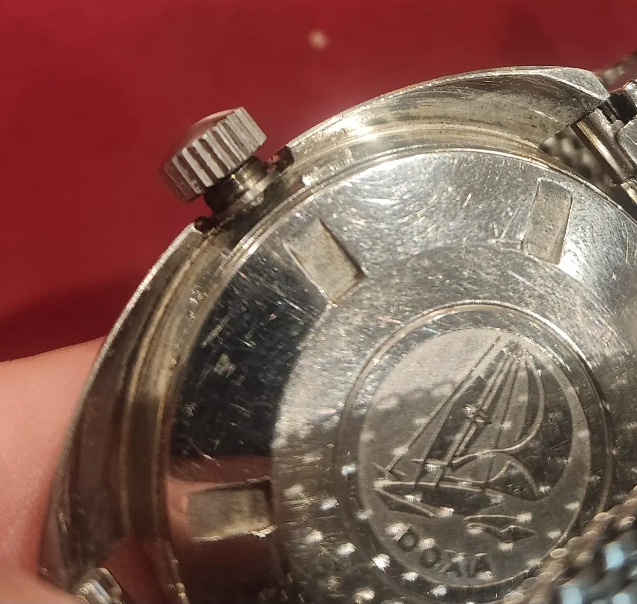

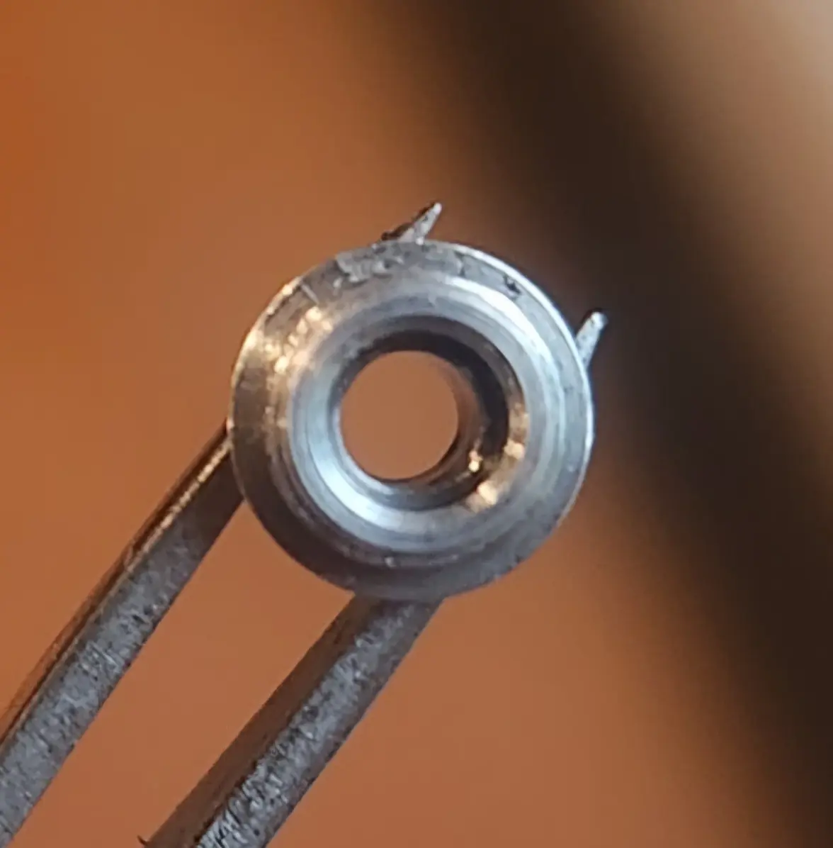

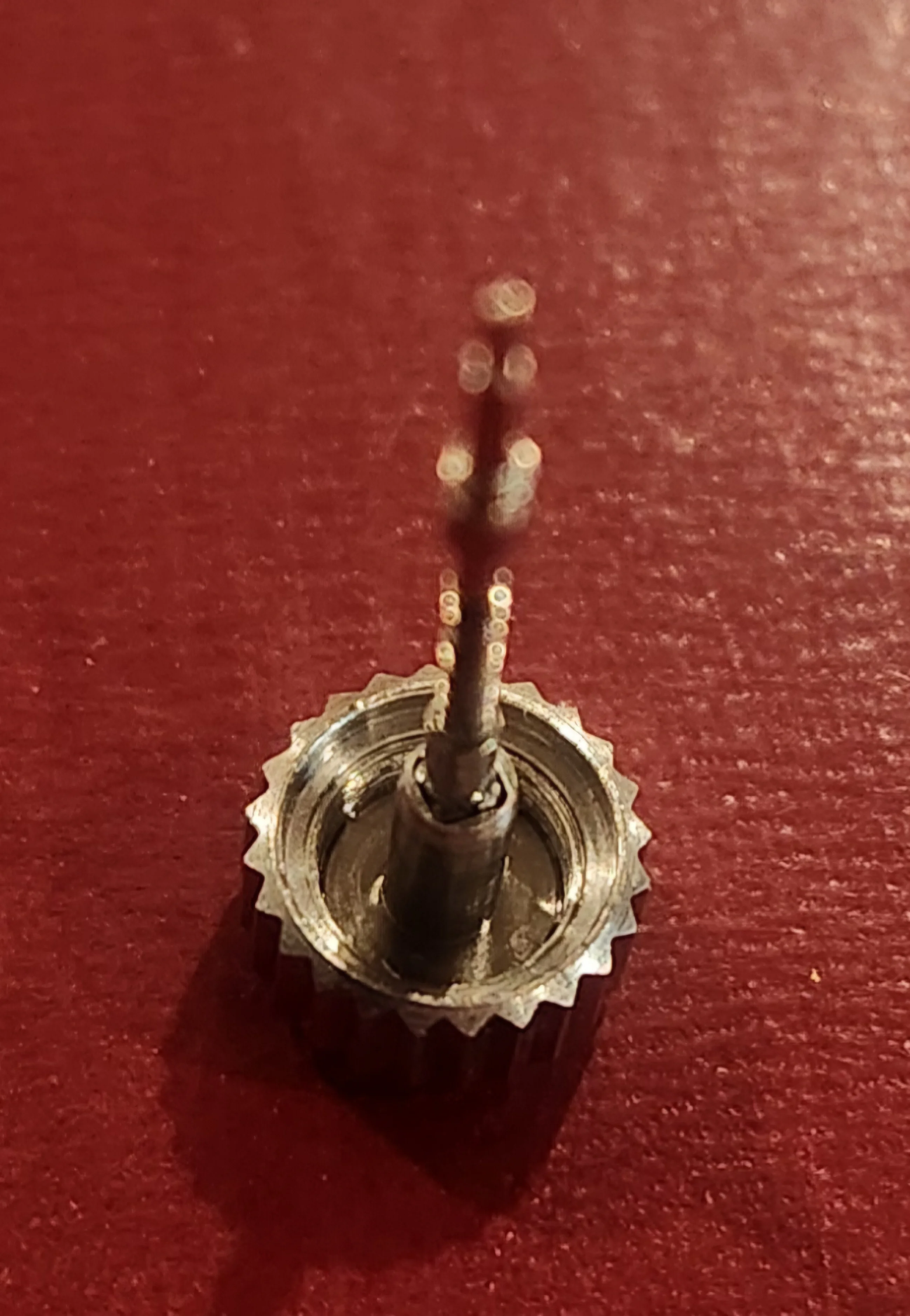

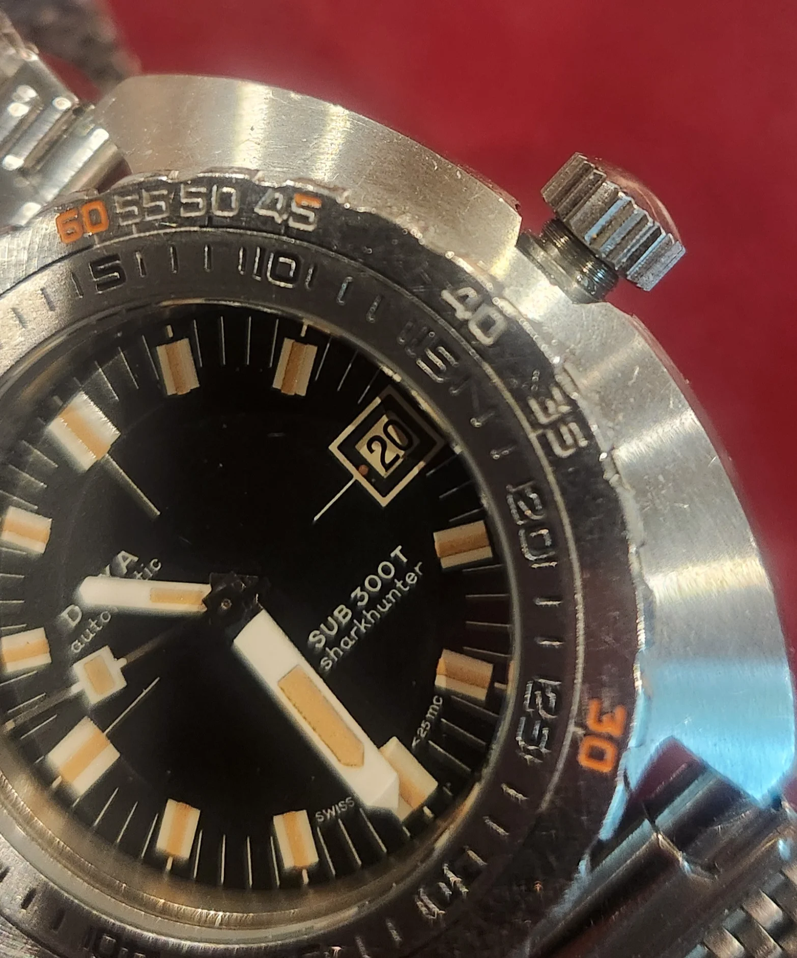

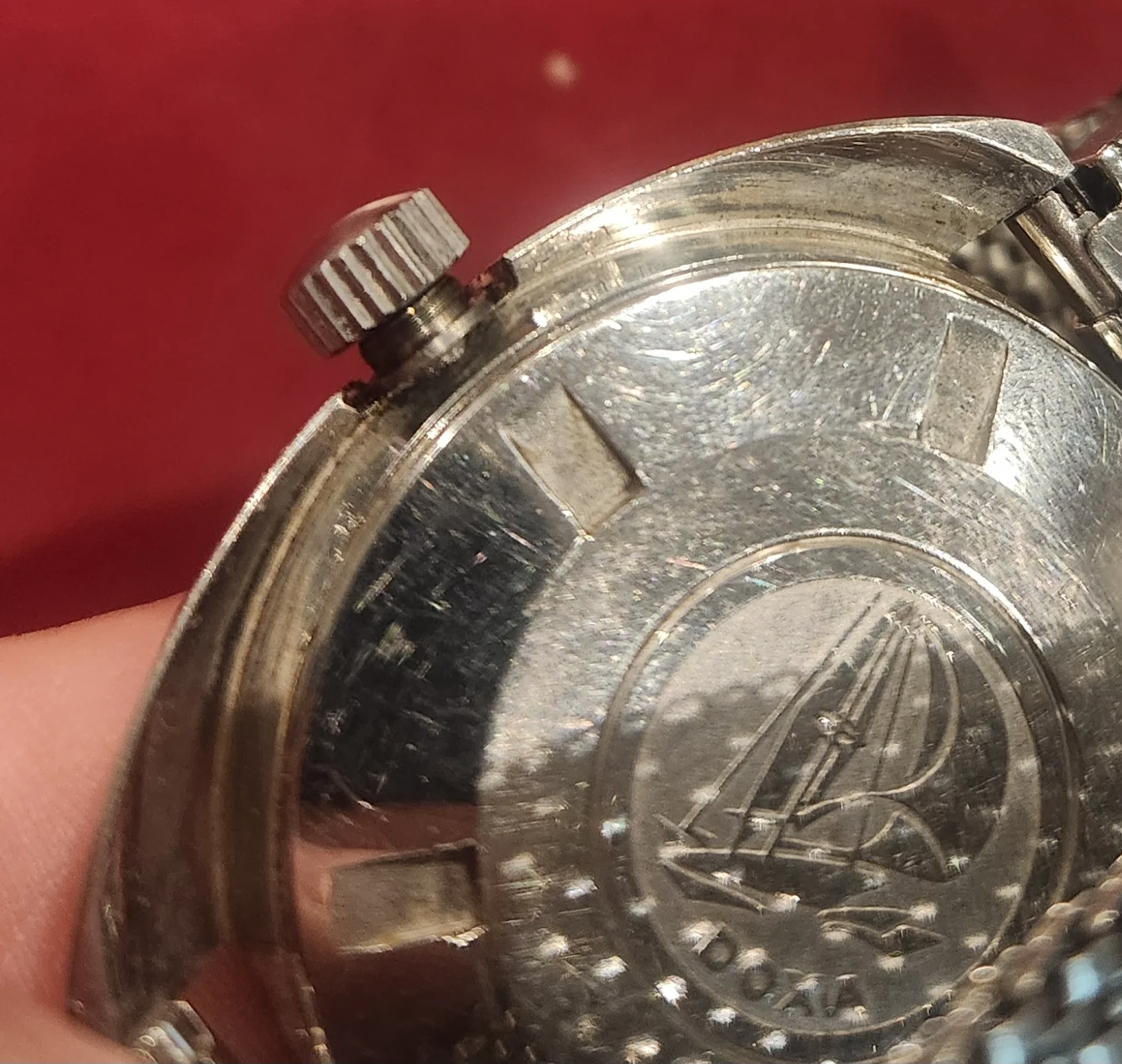

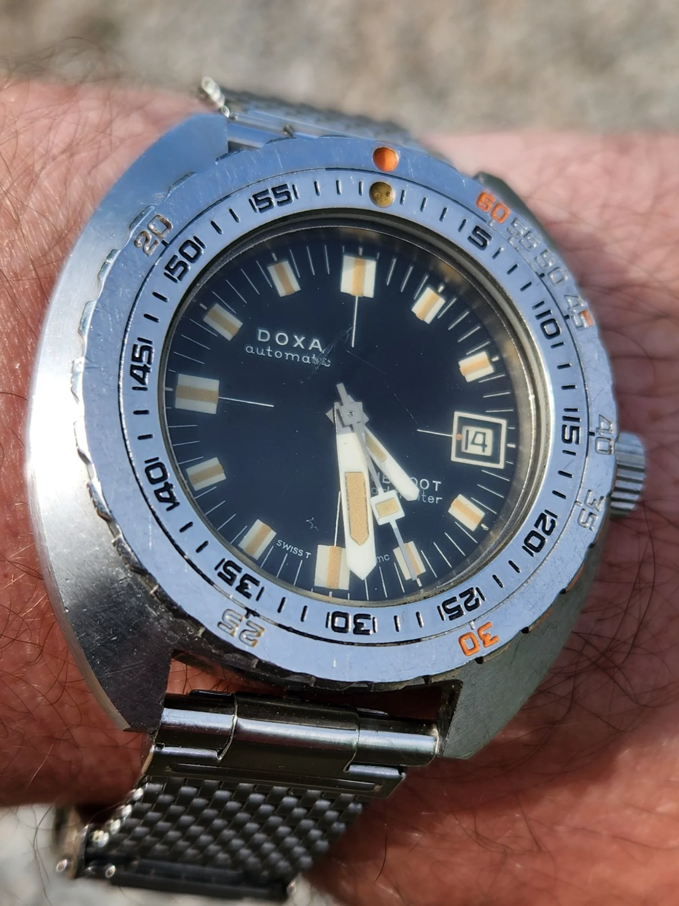

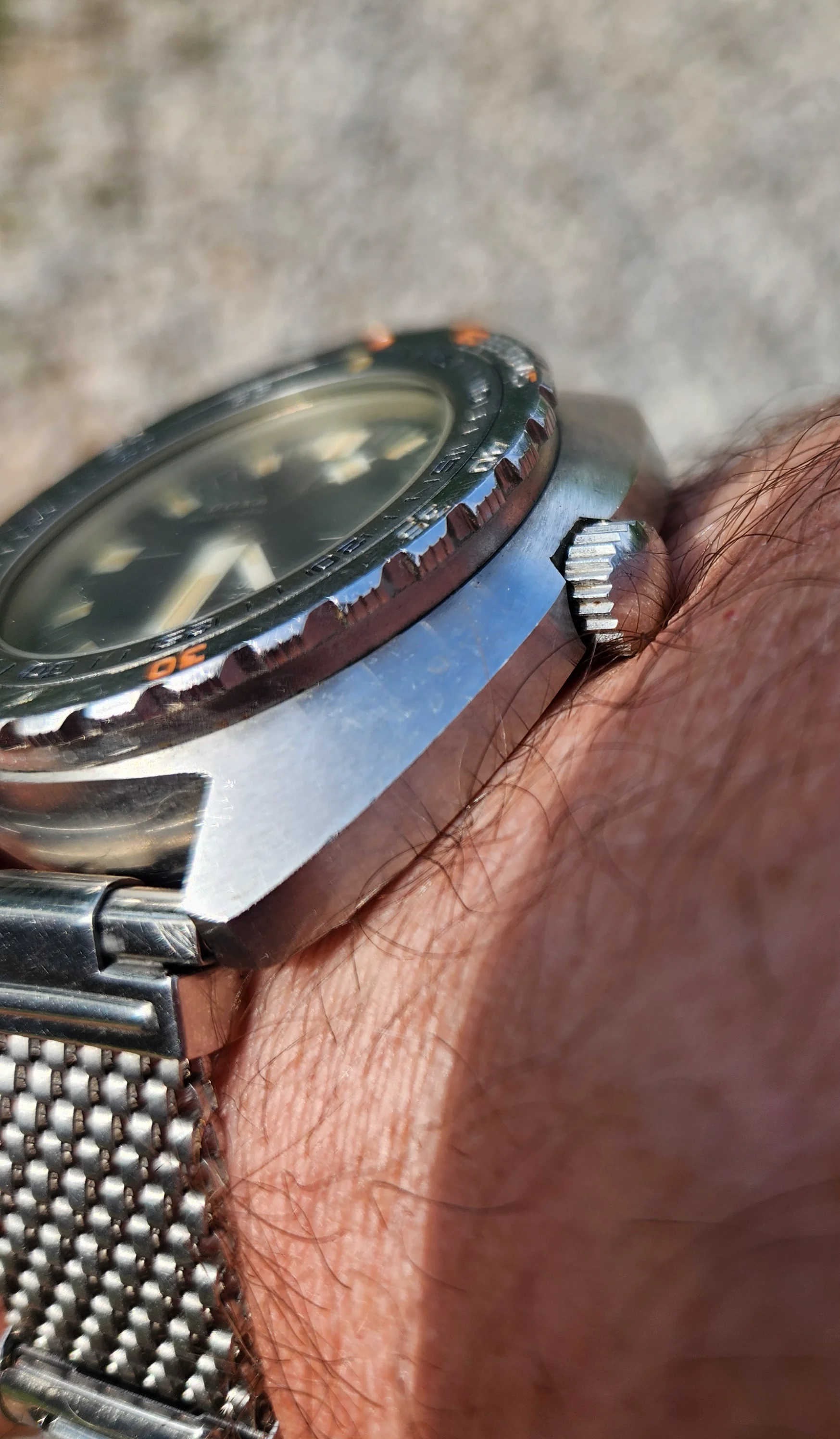

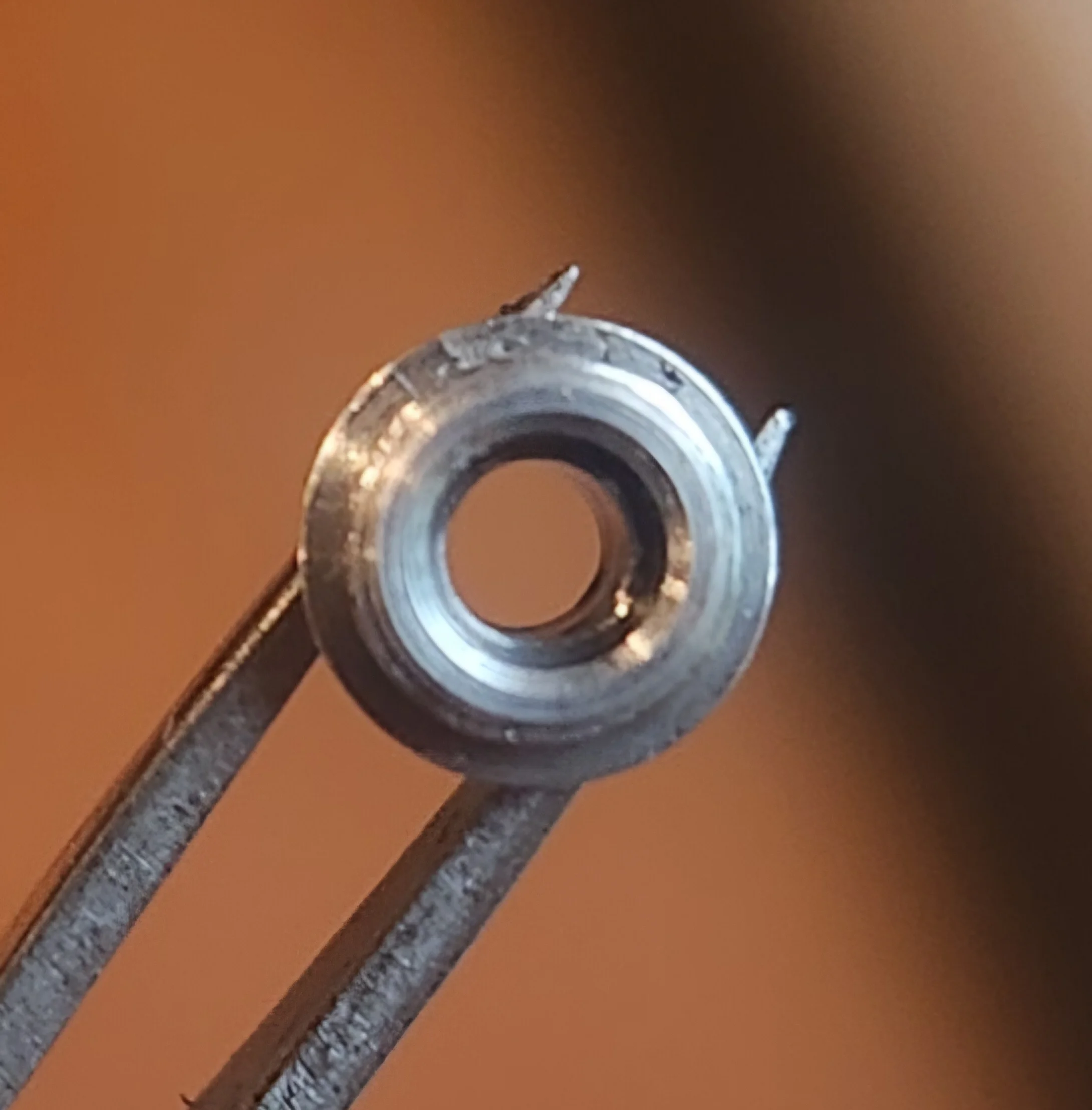

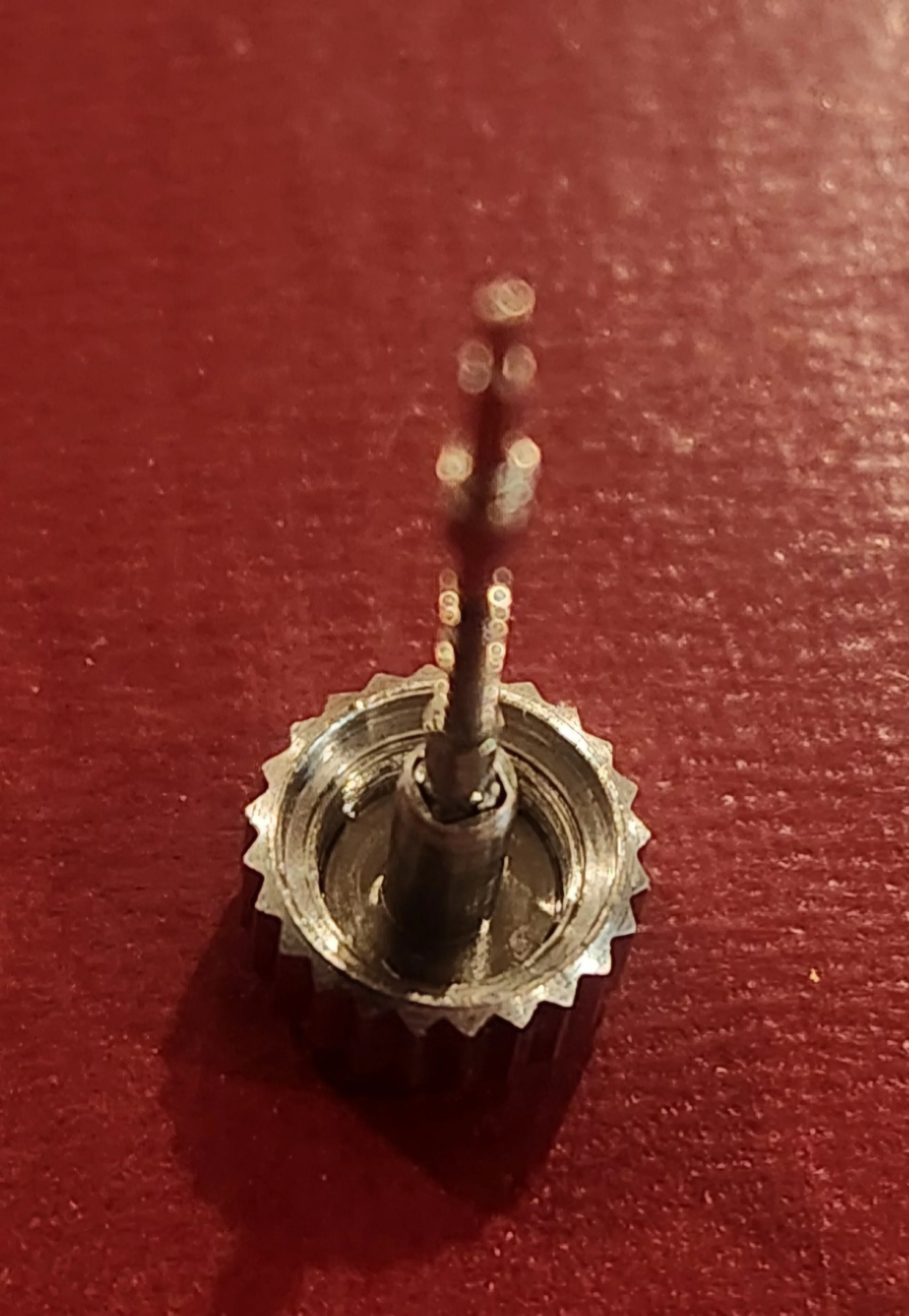

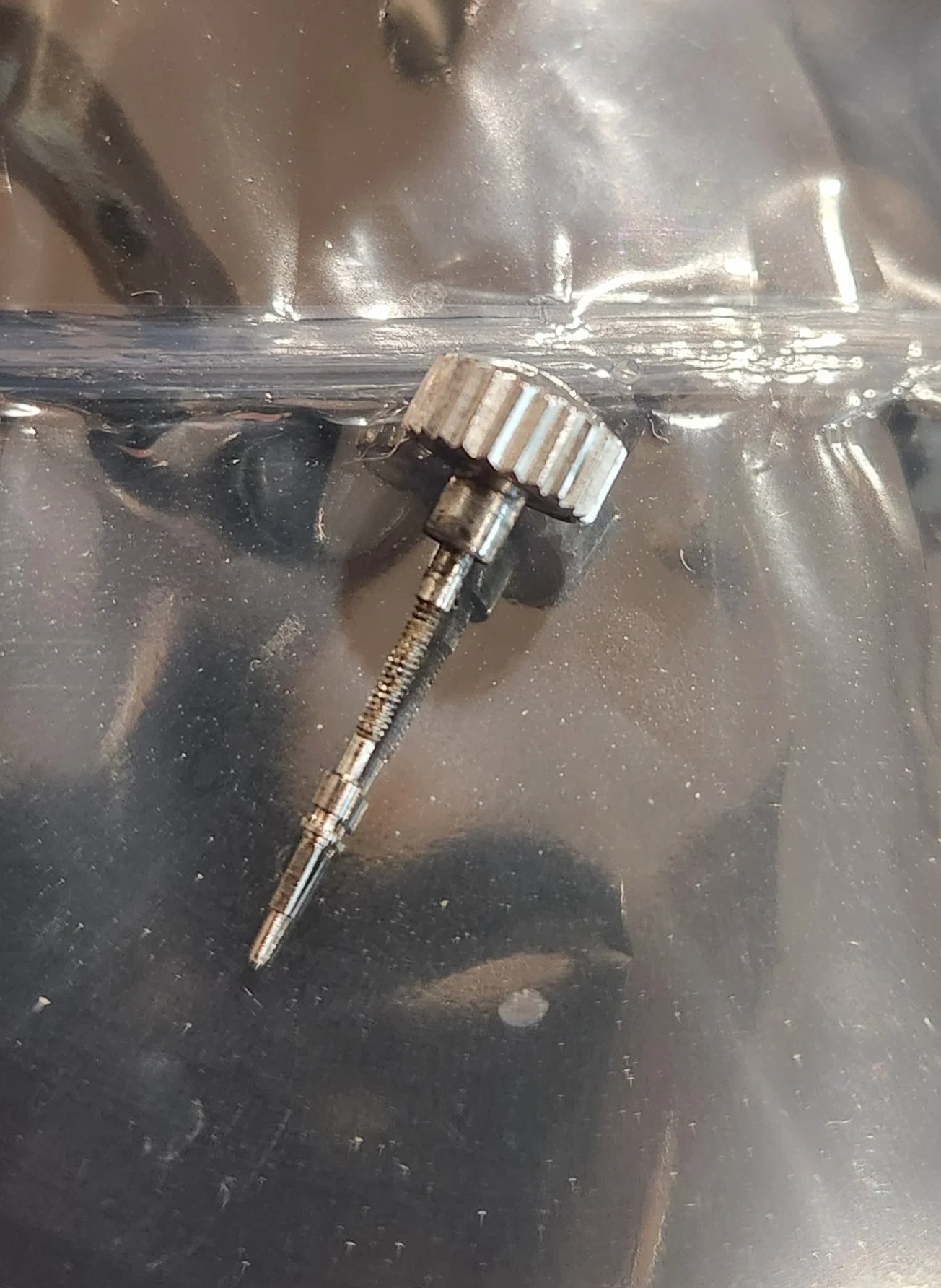

Got some good advice from everyone's favorite Dr, it's a proper first gen, and the screw down crown is fixed!
It was frozen to the press-fit tube, so with a clamp, ultrasonic, little permatex and a light thread greasing it's back proper!

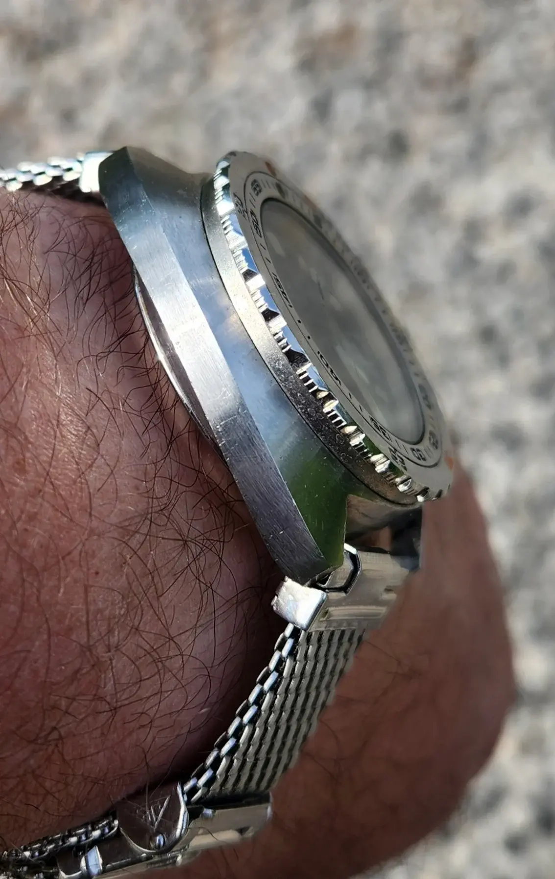

And I went back to steel from the leather just for Emeister 😀

Nice work. And thank you. 😉
So can you identify the year on these first gens?

Thanks! I don't think there's a good way to date them. Pre-Synchron makes it earlier than 1970. The Dr. seemed to think 68 was a decent estimate for this one.

How did I miss this thread?! Lovely early European model. My best guess is 1968. Congrats on a nice find. I had one very similar, and the thinner case early T wear brilliantly.
Do you know which caliber is it? Does it have quick set date setting? Thank you
