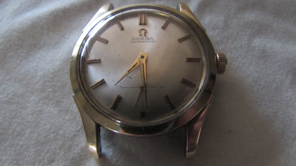

I think they do it to set the hands at 1350 and forget to push the crown back in. Then when they see the crown out in the pics they can't be bothered to take more.
I'm guilty of that 😬

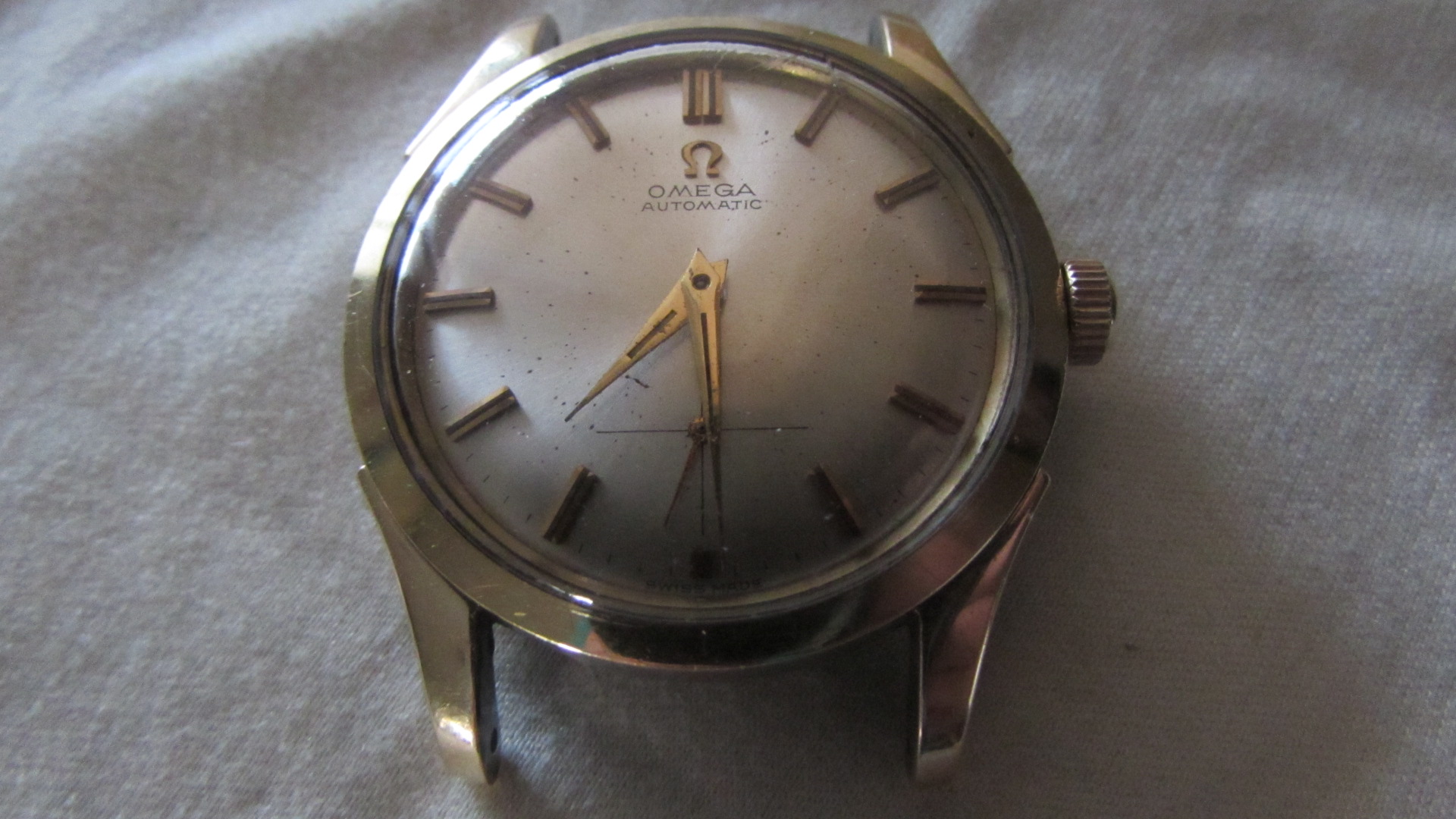

Okay guys, there's two things I need to comment on:
1) That's a bumper caliber 34x, so the dial does look like a later service replacement or a very good refinishing job with later fonts. The fonts look like they're from the 60's and bumpers were gone by the mid / late 50's. Seeing as the movement has an 11 million serial number (late 1940's), it reinforces Norm's / X350 XJR's call on the replacement dial.
2) People pull the crown out to stop the seconds hand for pictures. However, many of them don't know these older watches don't have a hacking mechanism, and therefore the second hand won't stop by pulling out the crown, because they don't have vintage experience.

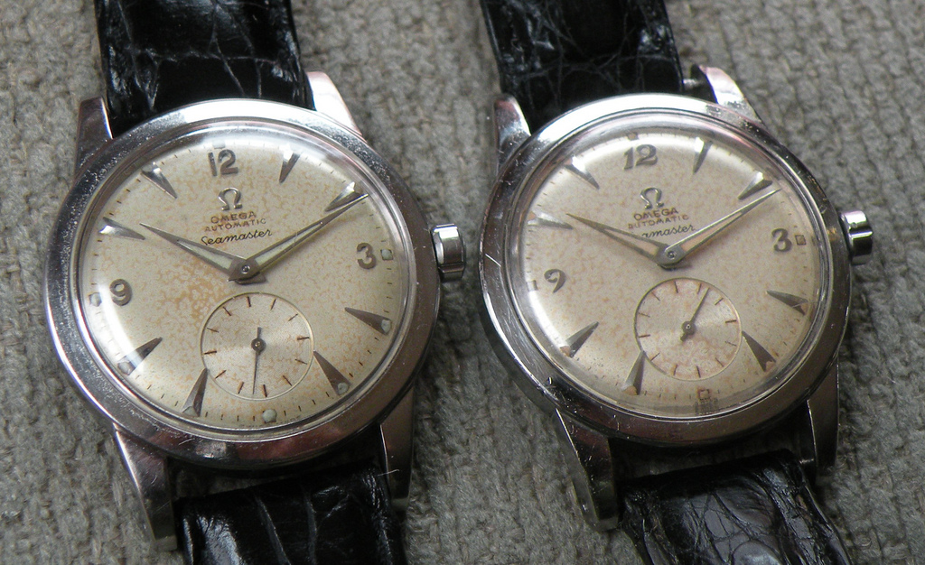

These two are 2576 but you can see one with relume and one with original lume. The prices are different.
