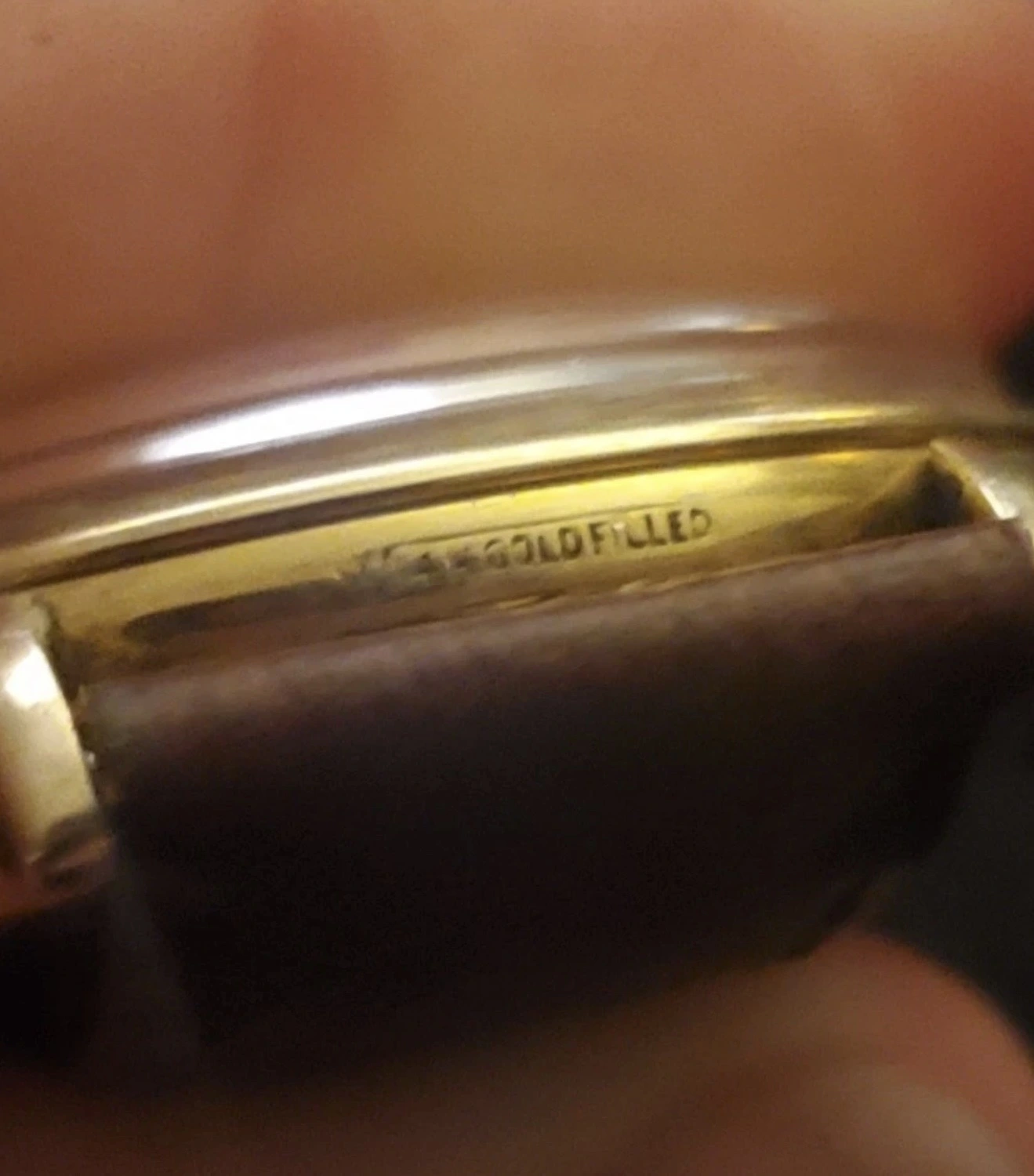

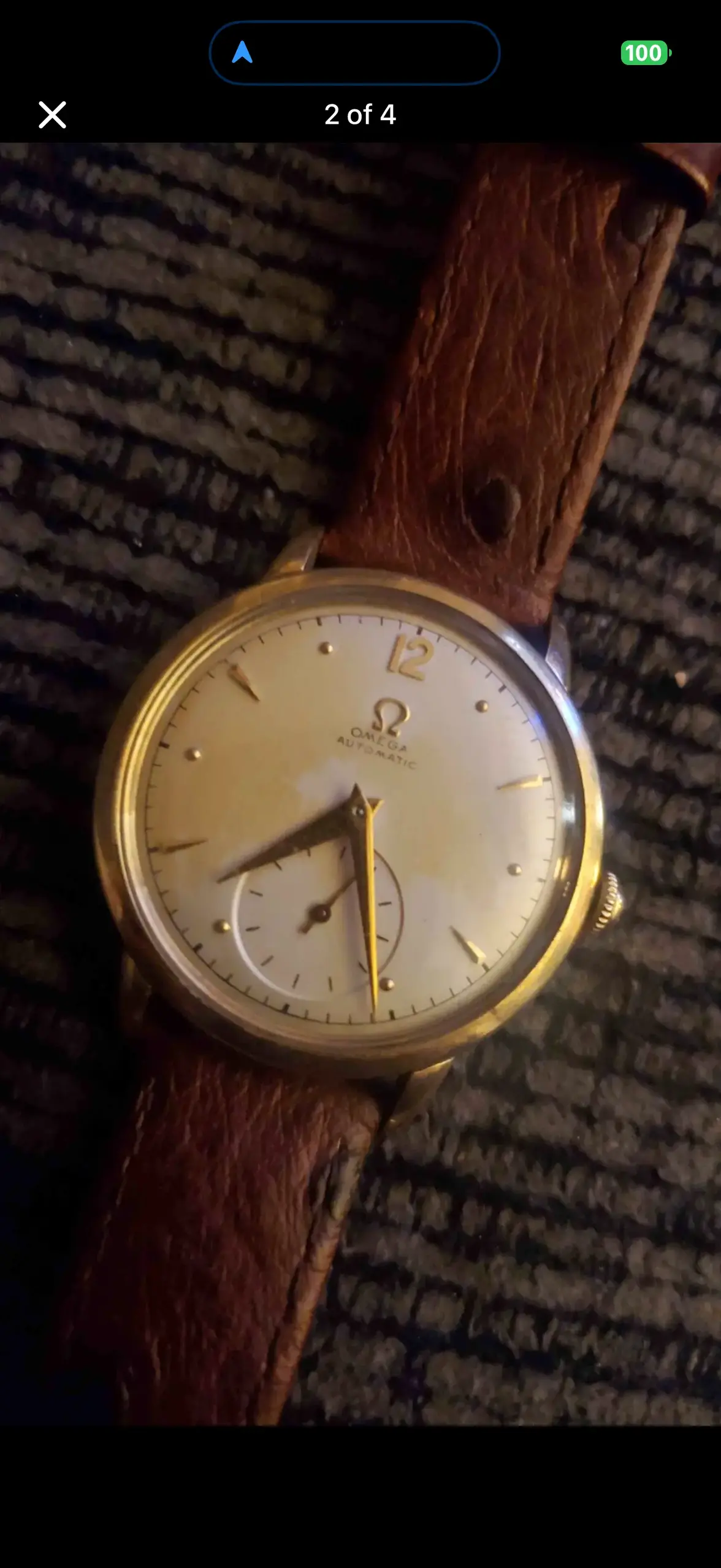

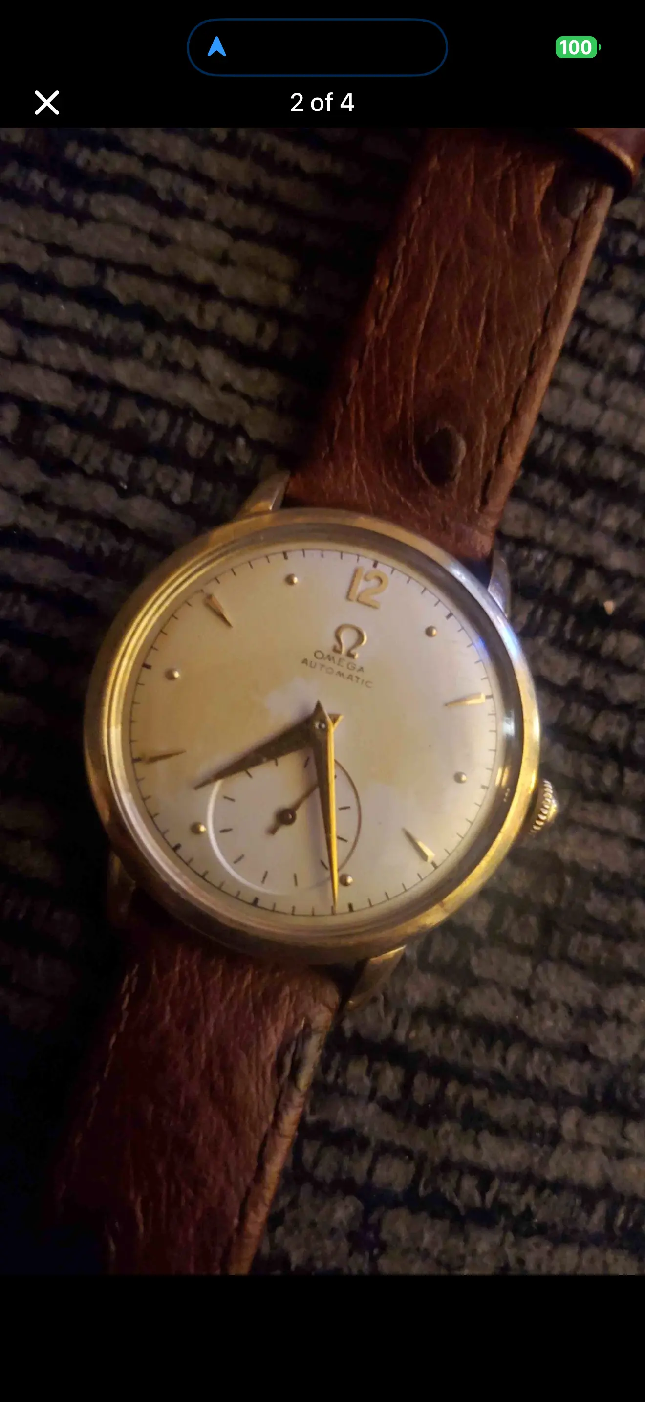

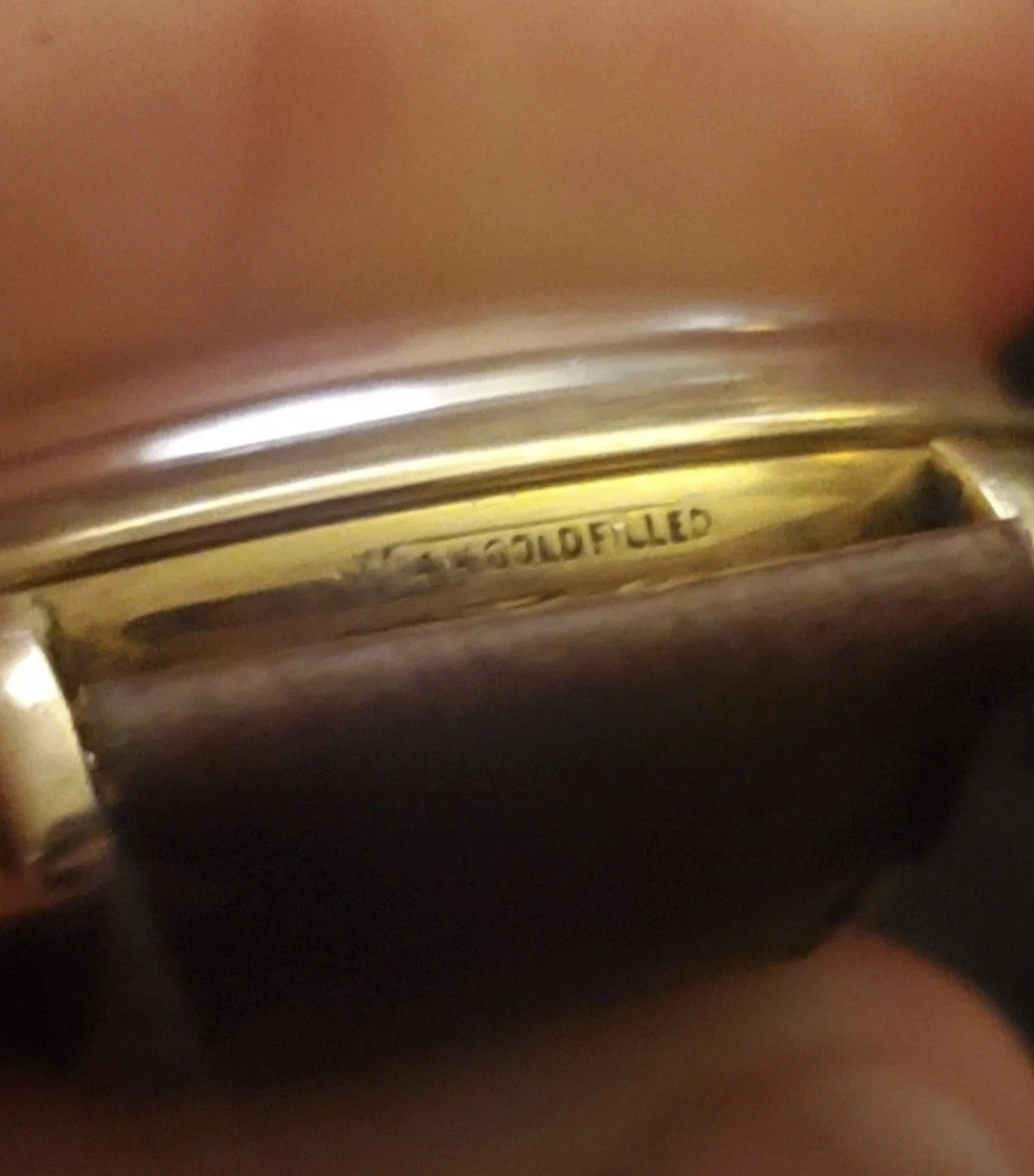

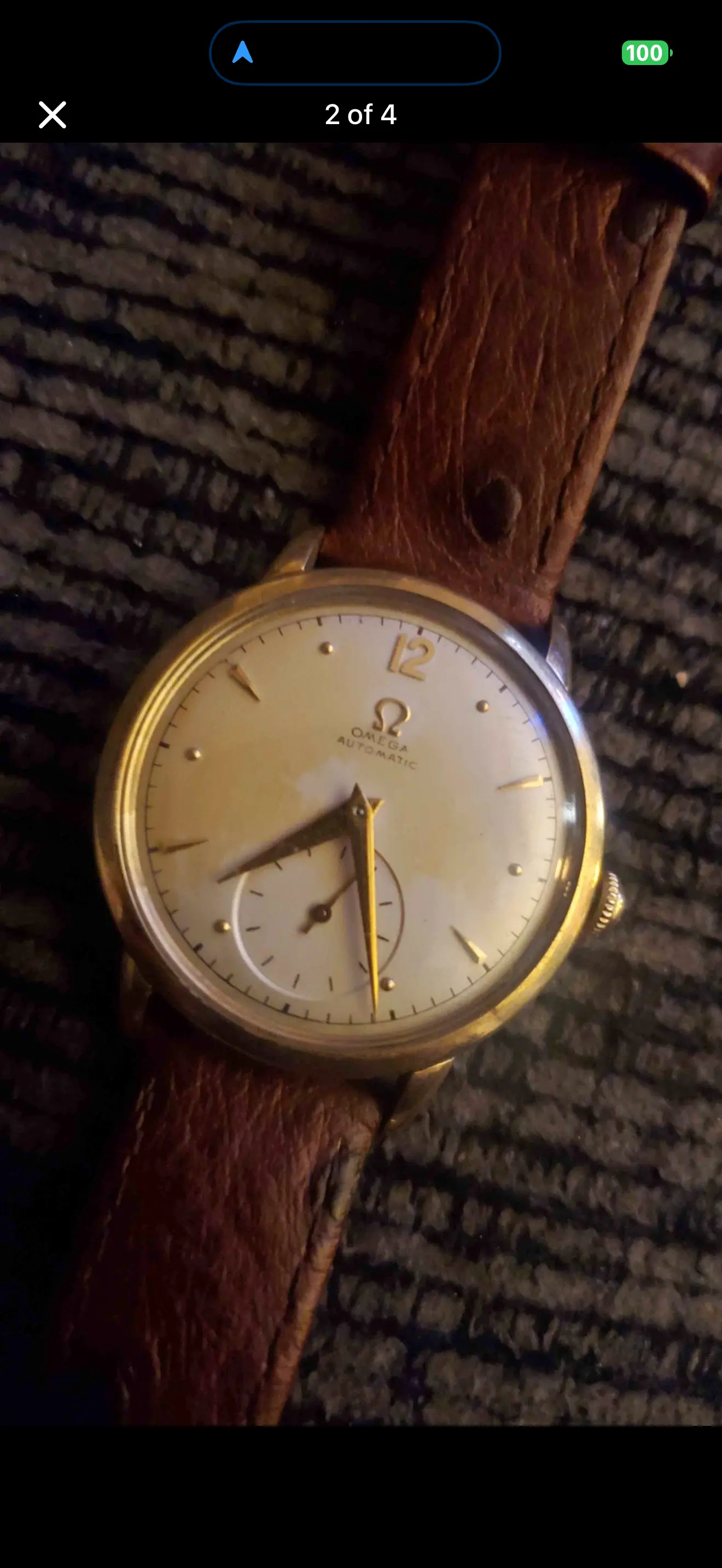

Looking at identifying this Omega. Has gold filled on the end of the watch. I'm wanting a model number and general info to see if it's worth trying to buy.

I'm curious as to the model number and possibly caliber it has. I've never looked much into omegas that are this old. Just wanting basic info. It's on FB and the seller didn't mention any details.
I was meaning by worth, is it a decent watch? Price isn't my concern.

Further, many watches of the age of the one you post have been re-painted at some stage. This significantly reduces the value of the watch, at least to a collector. I can’t say from the quality of your photo if this one has been re-dialled but I’m assuming it has been.
It’s a gold plated watch, the crown looks wrong, it probably isn’t serviced and parts may be hard to source. You don’t say if it’s running (accurately or otherwise) and a service will cost you around £150 plus parts if the actual movement is running.

The watch in question is a USA National Production watch.
The case was made by Wadsworth (under license by Omega) in the USA and the movement is likely a Swiss made Omega movement. This was done to avoid high tariffs on imported watch cases.
The case styles are different from Swiss Omega cases and are generally not listed in the various databases around the internet.
My guess is that the dial was refinished many years ago, as I do not see “Swiss” below the 6. Many collectors would not buy this watch, so do not overpay for it.
