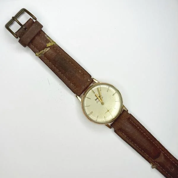

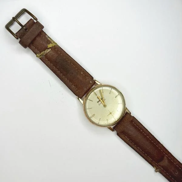

I need help checking if this omega is original
8

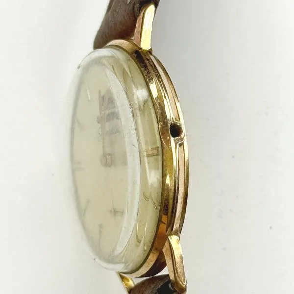

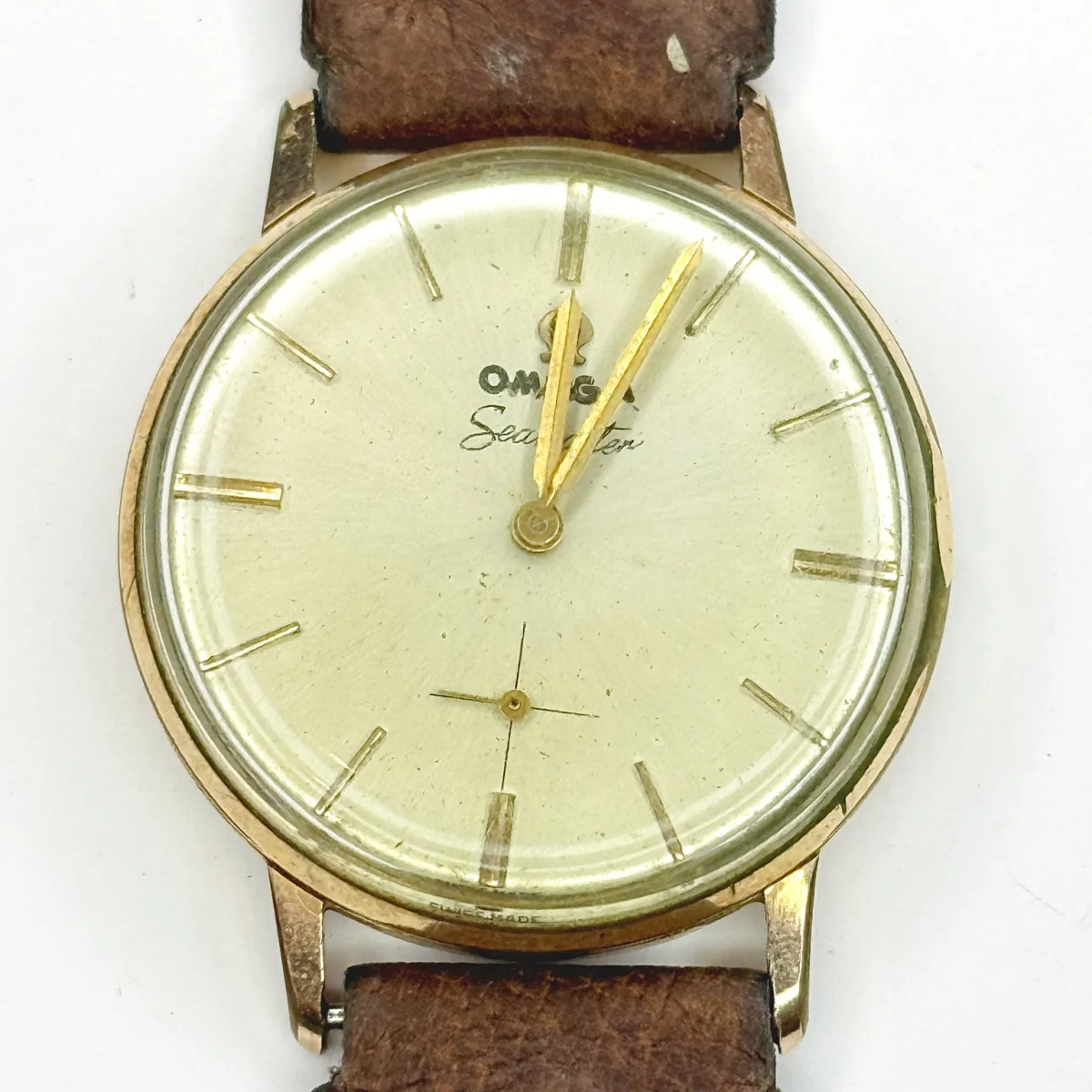

I found this Omega Seamaster at an auction, but before buying it, I need help to know if it is original, can anyone help?
718
2,107
From this auction? The watch doesn't work, no movement photo, the case is beat up, dial has been repainted by someone who recalled from memory how it should look like. If it's a gold case, it's worth whatever the scrap gold value is. I wouldn't even bother.
8
But do you think it's original? I would buy it to restore it, for that price it's very attractive
718
2,107

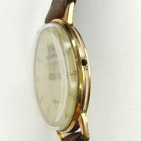

You're looking at a beat up case that's not very attractive and a movement that will need a full service. Without a photo of the movement and the case back, hard to tell what to expect. You'll also need to source a crown (probably not that hard) and a dial, the hardest. That dial is repainted, so not the original design that came with the watch.
718
2,107
It may look like so, until you need to spend $100+ for a good dial, $40-70 for a crown, and a bunch for the movement service. In my opinion this isn't a watch that's worth spending money on restoring, even if you got it for free.

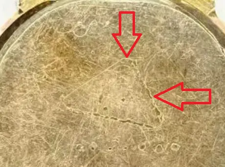

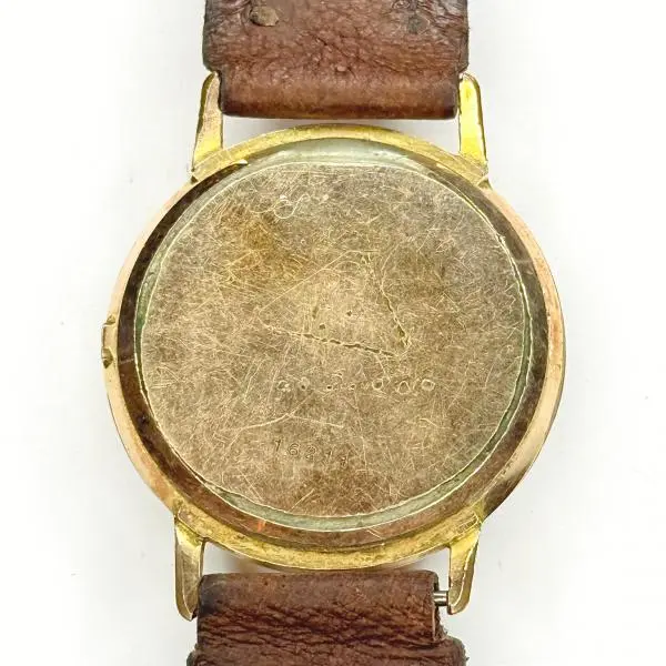

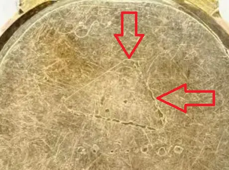

I believe it is a fake. The worn case back has the classic triangle around the Omega logo.
8

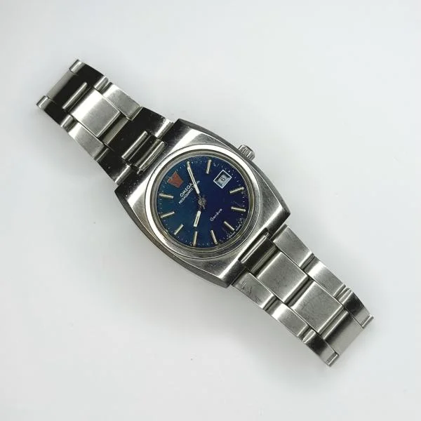

And what about this one?
8

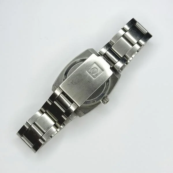

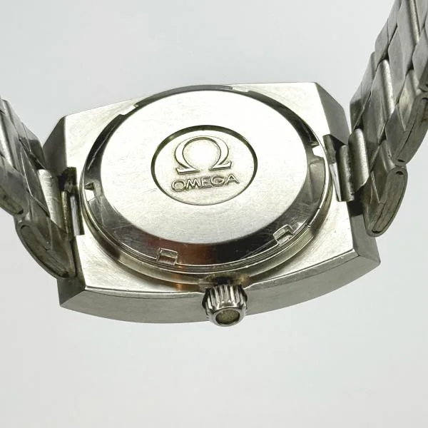

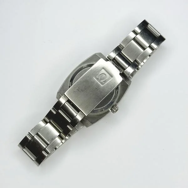

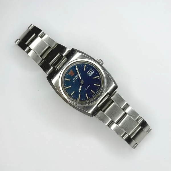

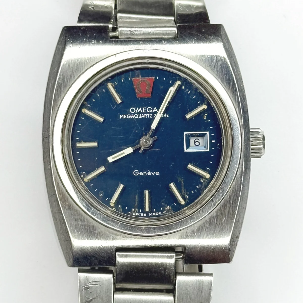

thanks, can you tell me if this bellow its also fake?
231
237
That one appears to be genuine. But it’s very different from the original watch you were asking about. This one is a quartz movement while the other is a mechanical one ( though I think it’s a fake one too). It will be better if you look around some posts in the forum and see what models you like and then hunt for one you like in good condition. In the process you will slowly learn how to spot a fake( obvious ones atleast), what to look for in the condition of the watch, its service, upkeep etc. Looking and learning about the references is half the fun. But I completely get wanting to buy the 1st “omega”. Been there, done that.

Thanks for the reply, so you think this megaquartz it's also fake?
8
The bracelet is not original to the watch.
Wow, I certainly wouldn't pay attention to that detail, but is the watch itself original in your opinion?
4,513
11,098
The watch and the bracelet are Omega, yes. They just don't belong together.
8
So the bracelet belongs to another model?
4,513
11,098
Correct. If we could see the printing on the inside of the bracelet clasp, it would help to narrow it down.

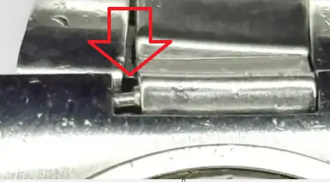

3,651
7,968
This watch has what’s called an integrated bracelet which fits properly in the case notch you can see that the bracelet you show is too small there is a gap

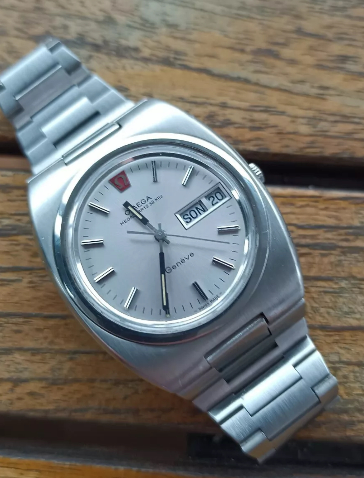

Here’s a screenshot of similar ref showing properly fitting bracelet. From eBay listing
The problem with buying watch with integrated bracelet is you need to be sure it fits as extra links are often unavailable for these. And finding entire bracelet very unlikely.

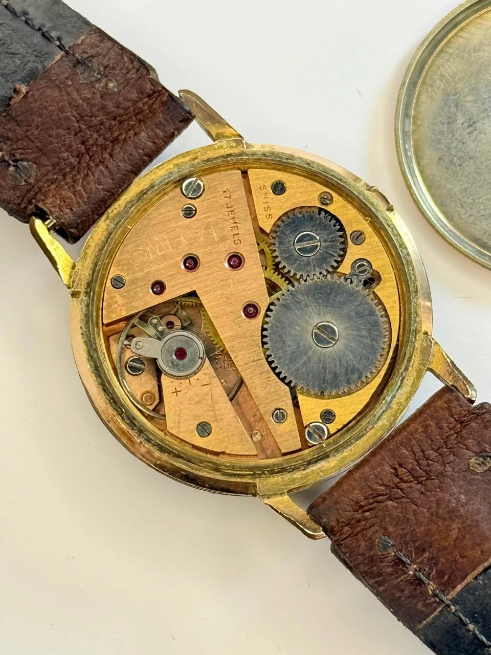

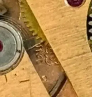

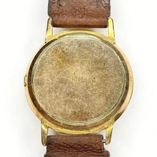

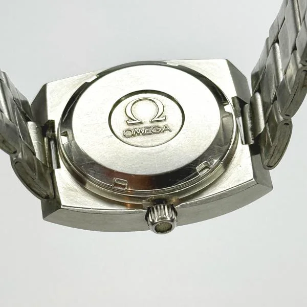

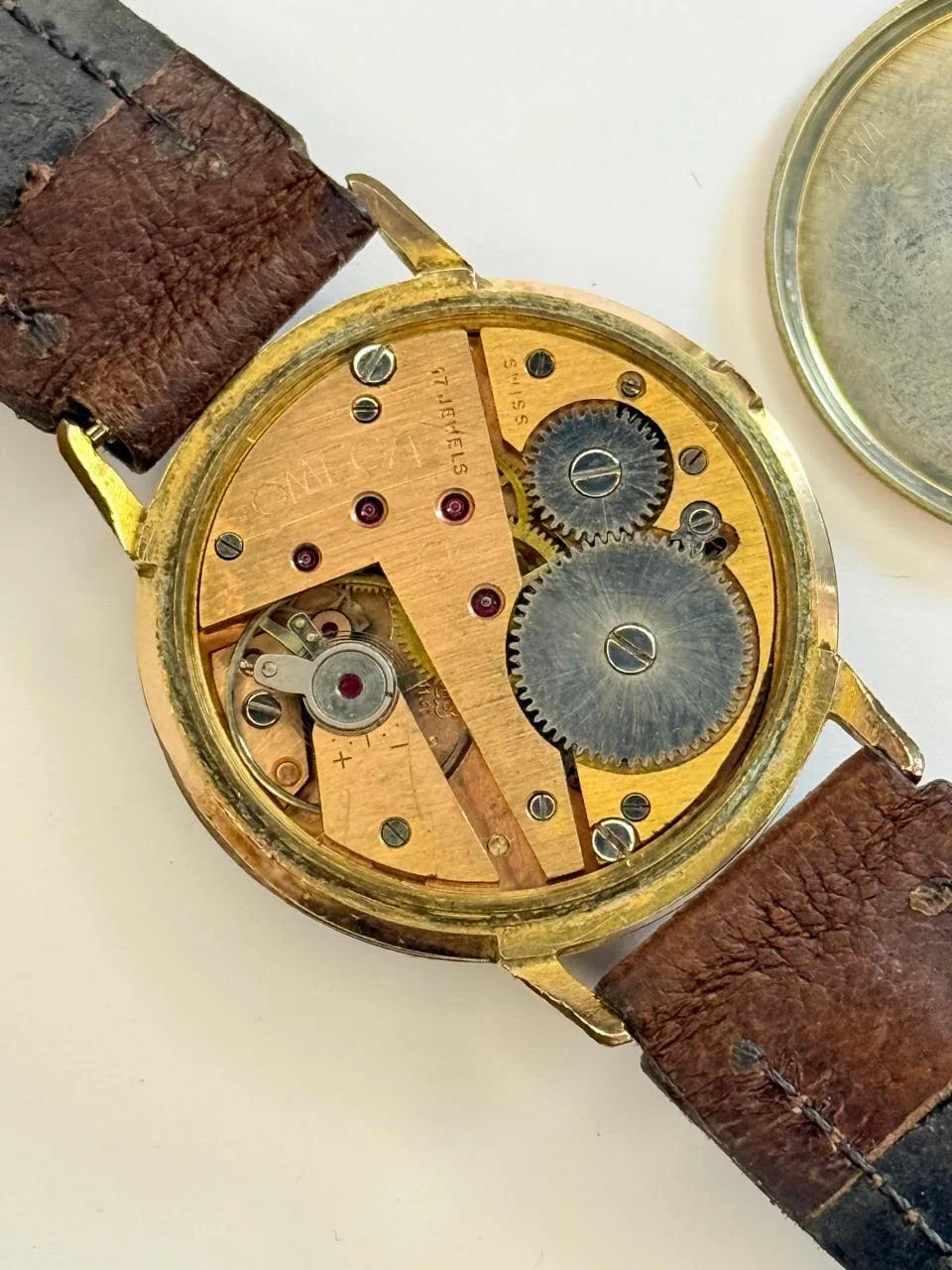

eu consegui a foto da parte traseira do primeiro relógio, é falso mesmo?
13,540
23,486
No point posting more info on this one. It’s fake.
718
2,107
Using my Google-fu, it looks like an AS 1130 movement from the 1950s. That Omega engraving was done by the owner's 5 year old. Run!
