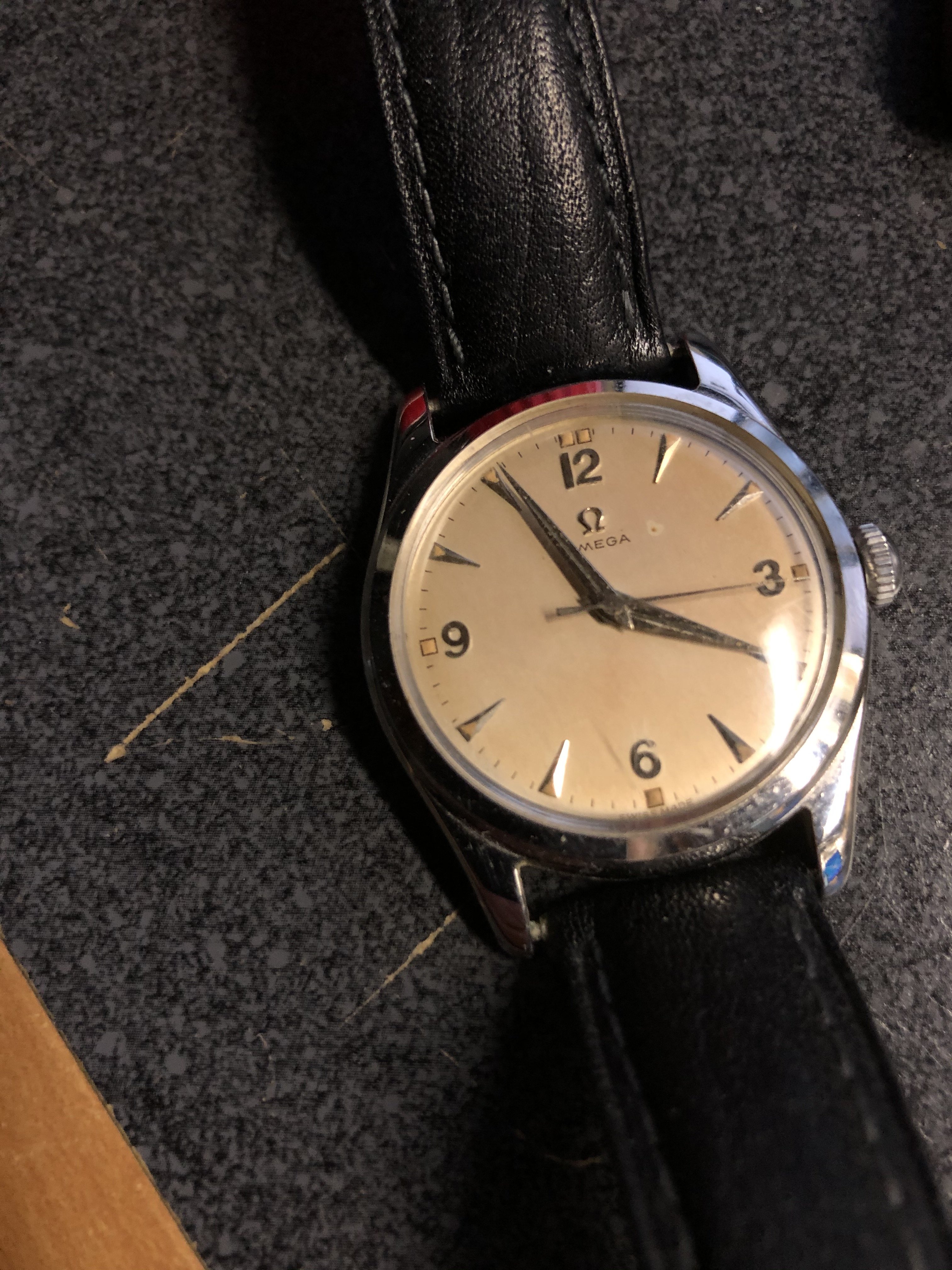

I need assistance with identifying my fathers Omega
3
3
I have taken possession of my fathers Omega that he has had for as long as I can remember. We had to move him to 24 hour nursing due to his dementia and didn't want to leave things of value that could be taken. I am interested in learning more about his watch, and this is my first step. I have already looked through a bunch of threads and have not been able to find pictures that look exactly like it. Thank you in advance for your assistance.

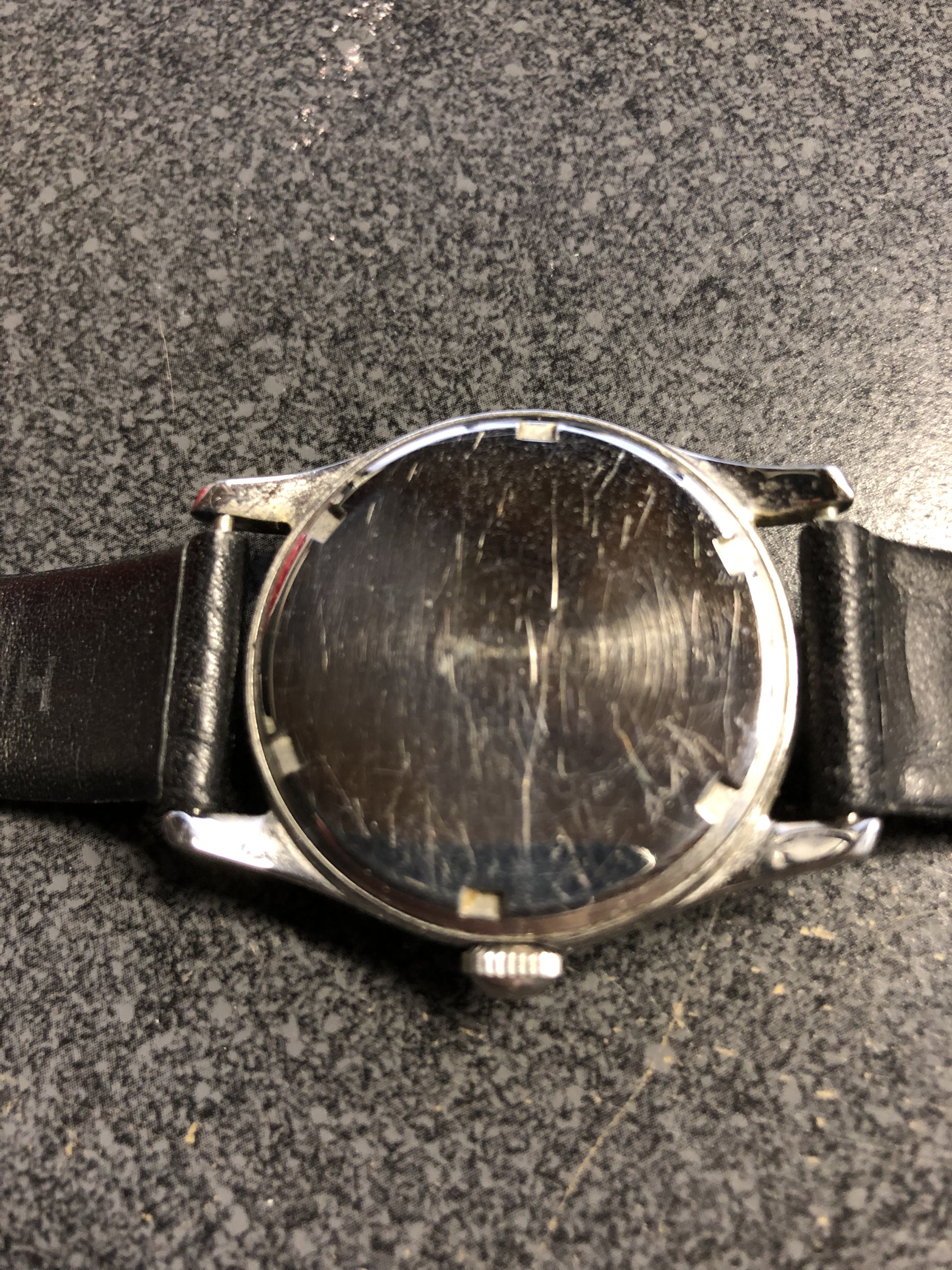

It would help a lot if you could have someone remove the case back, and upload a picture of the stampings inside the case back (don’t worry about hand scribed marks left by repair people). And also a picture of the mechanism.
3
3
I thought that might be the case. (No pun intended) I was thinking I might be able to do it myself, as I had looked at adjustable spanner wrenches online. Is this something I can do, or should leave to a professional. I am a field engineer in the AV industry and do electronics repair but this is something new.

I would take it to a watchmaker and have them do it. I cannot help you identify your father's watch, but it is a lovely piece of family history that does not need any cosmetic assistance from large scratch across the case back 😉.

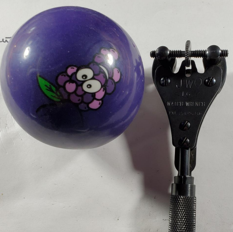

If you have a rubber ball or a KONG dog toy you can get it off with that since it screws off.
4,517
11,119
Remember that there is debris on and near the threads on the back that may fall into the movement. Watchmaker is recommended.
That said, if you still want to attempt, start with a rubber ball. I get mine at Dollar Tree. It may or may not work depending how tight it's on there or with possible corrosion. Then progress to a 3 prong case opener. DO NOT USE THE CHEAPIE 2 PRONG TYPE.

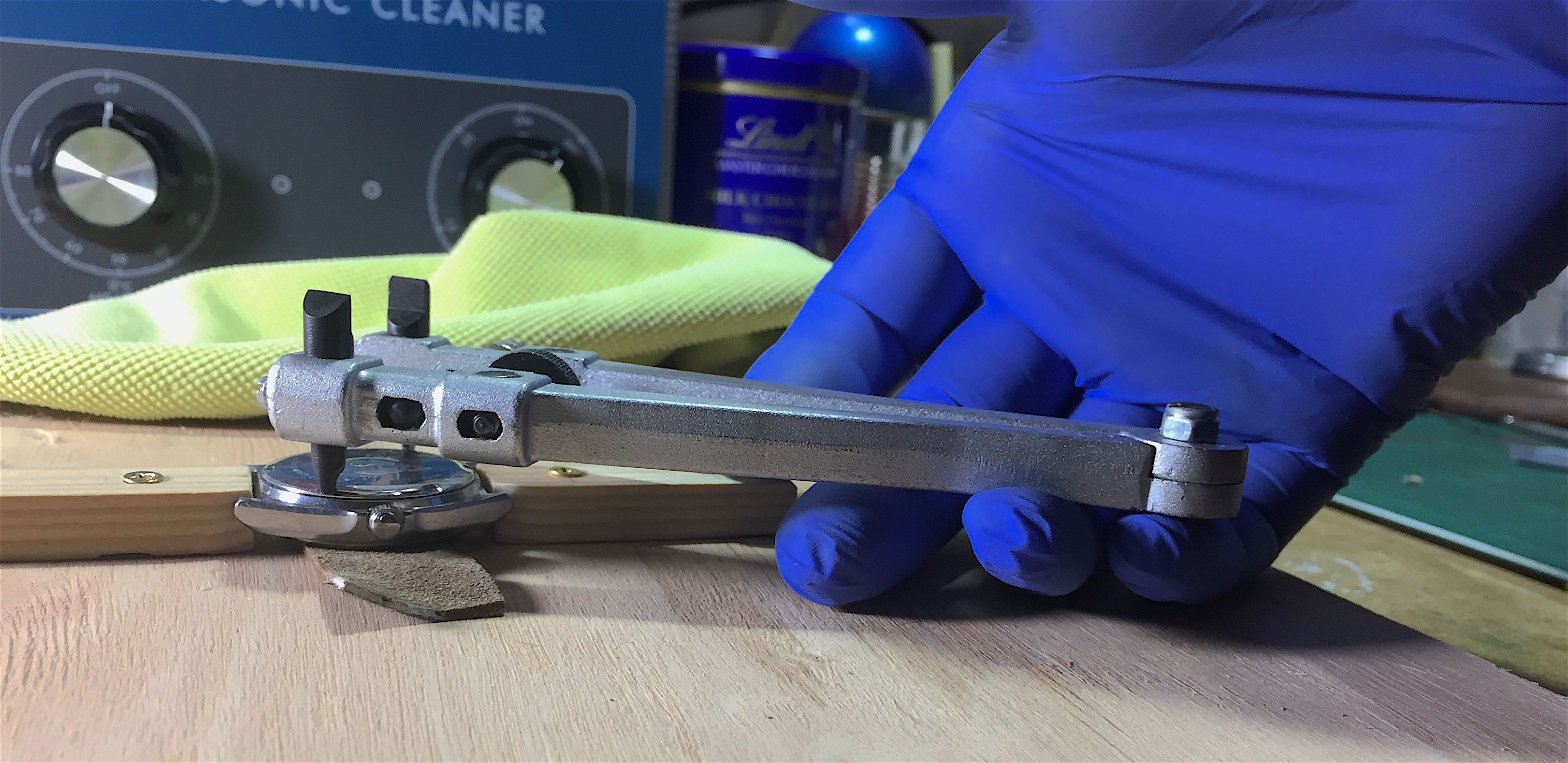

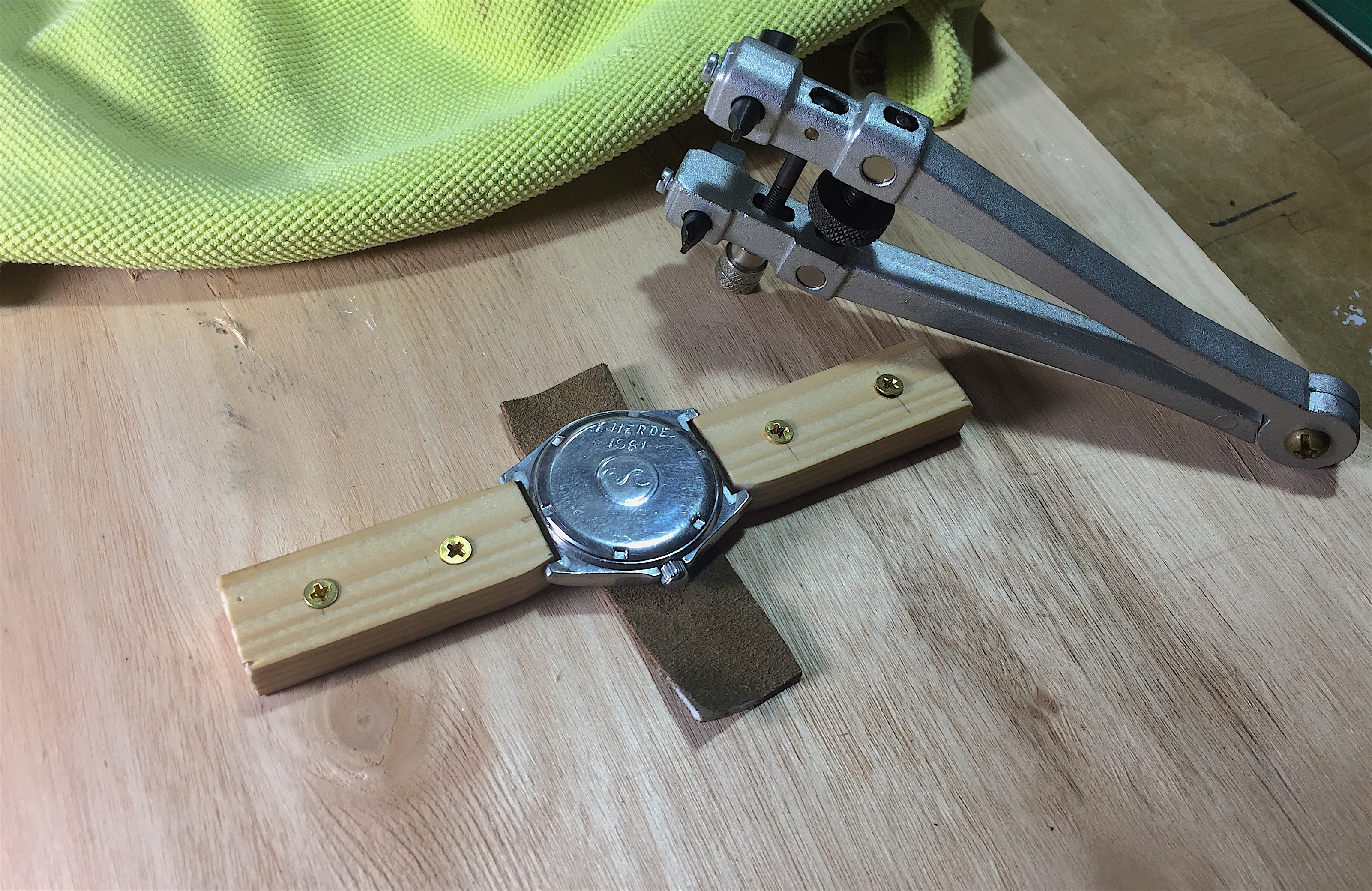

If you're going to do it yourself, use some plywood to make a case holder and sit the watch face down (protected with tape or similar) with the lugs held by wood blocks.
You can then use the surface of the plywood base to rest your hand on to maintain a level grip.
Make sure you use a soft dry toothbrush and a toothpick to clean around the case edge so you don't get crud in the movement.
18,837
39,175
Just as an example, here's one I made earlier 😉.
Here you can see how you can use the surface to keep the tool level, you can even press down on the fork end to give good pressure.
