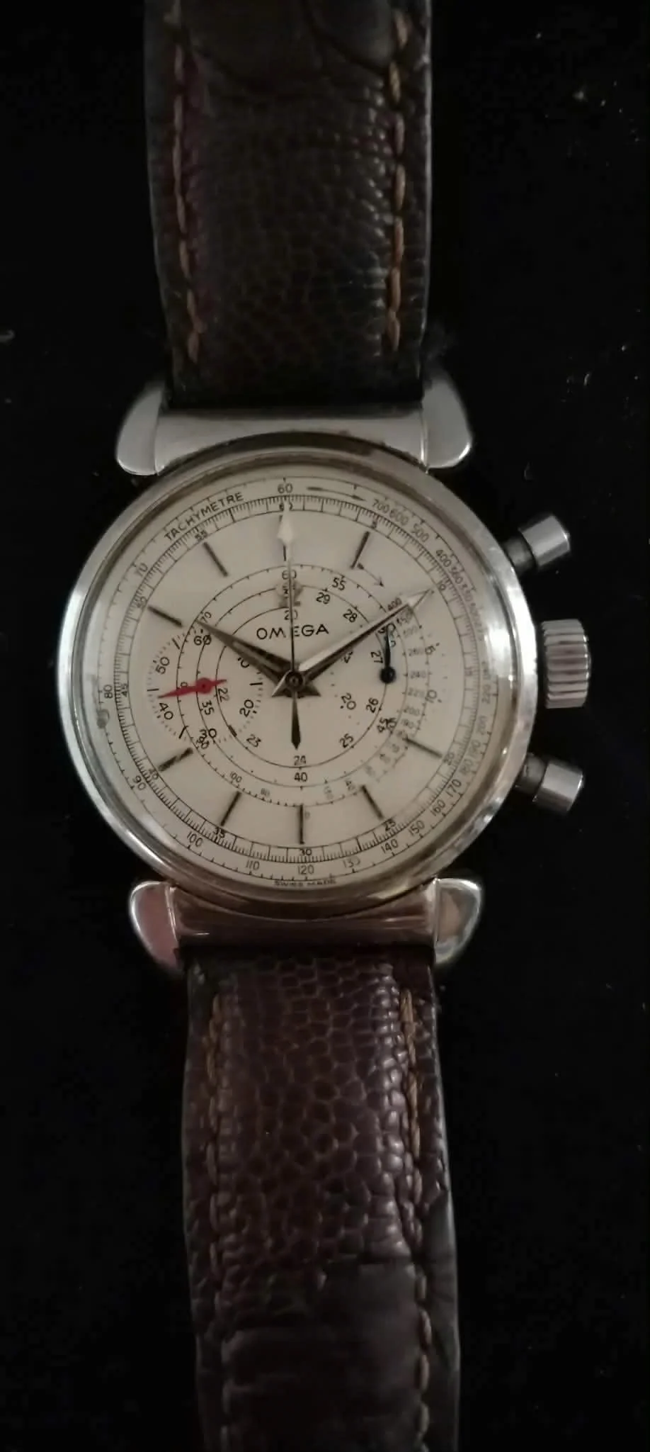

I just found this watch, legit?
Hello,

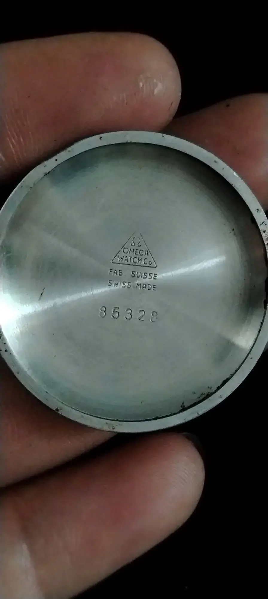

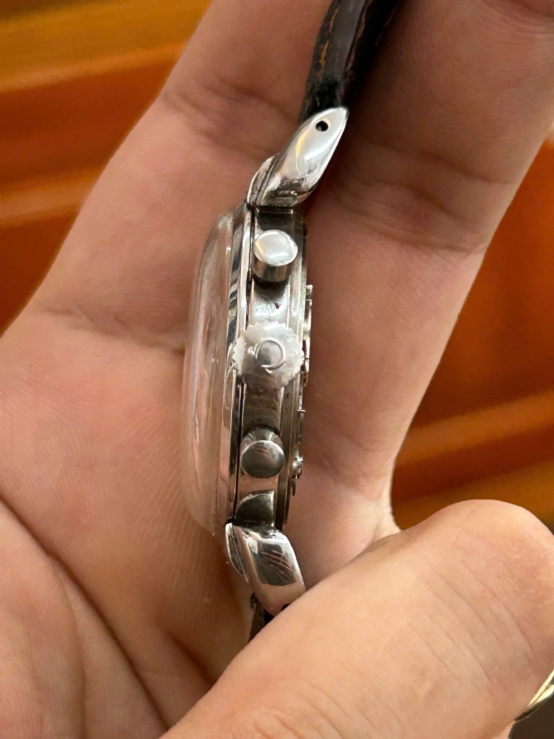

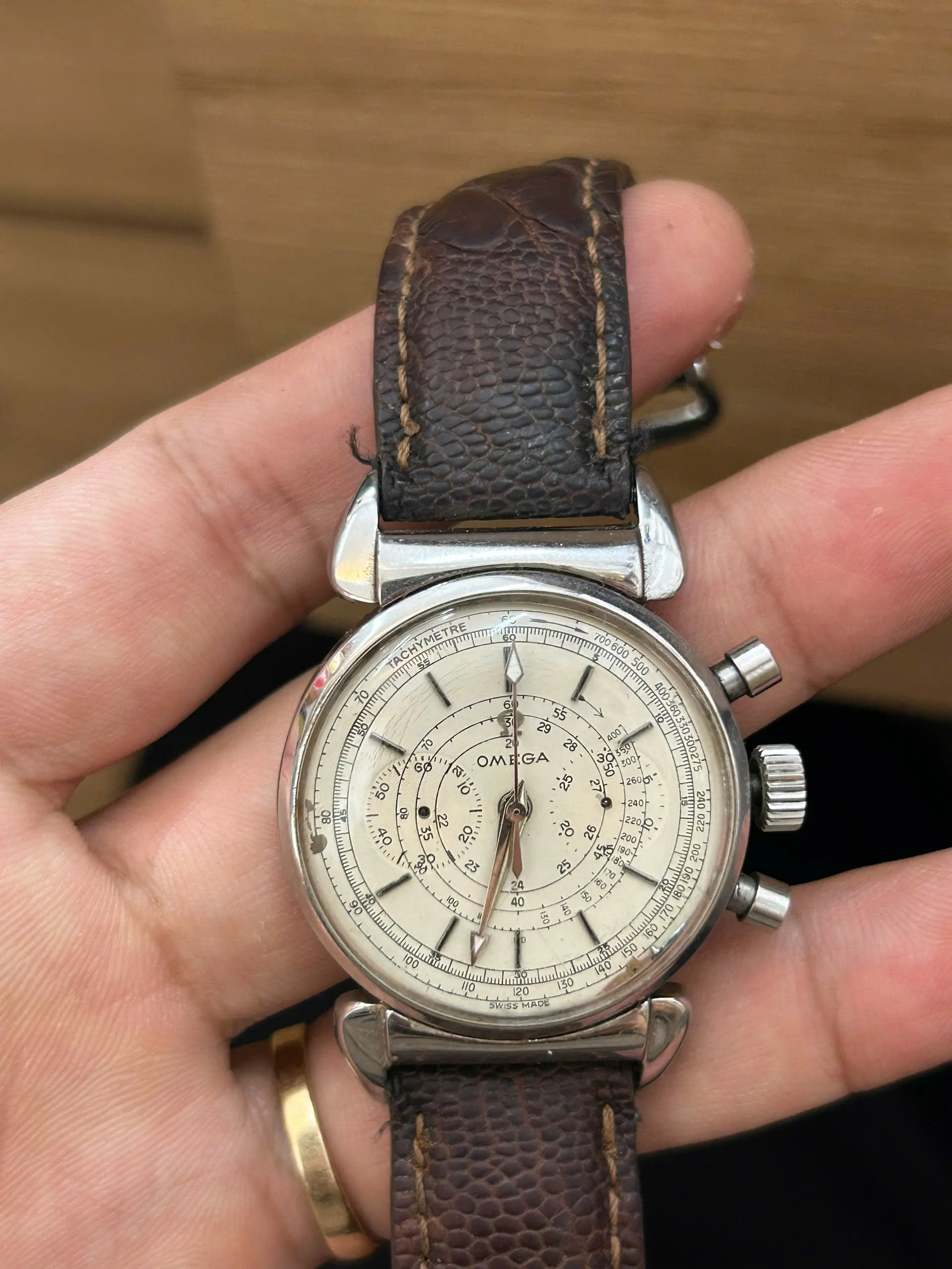

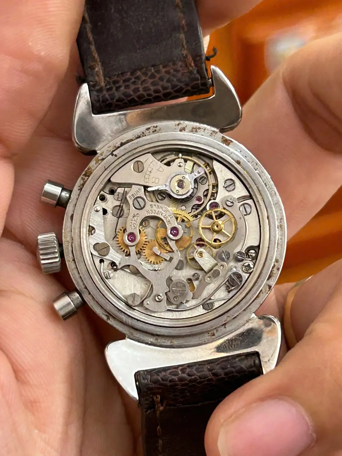

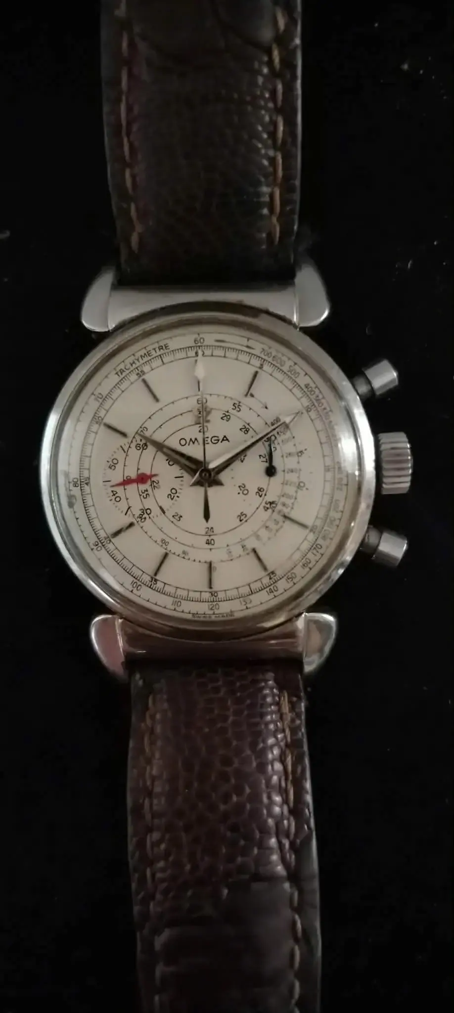

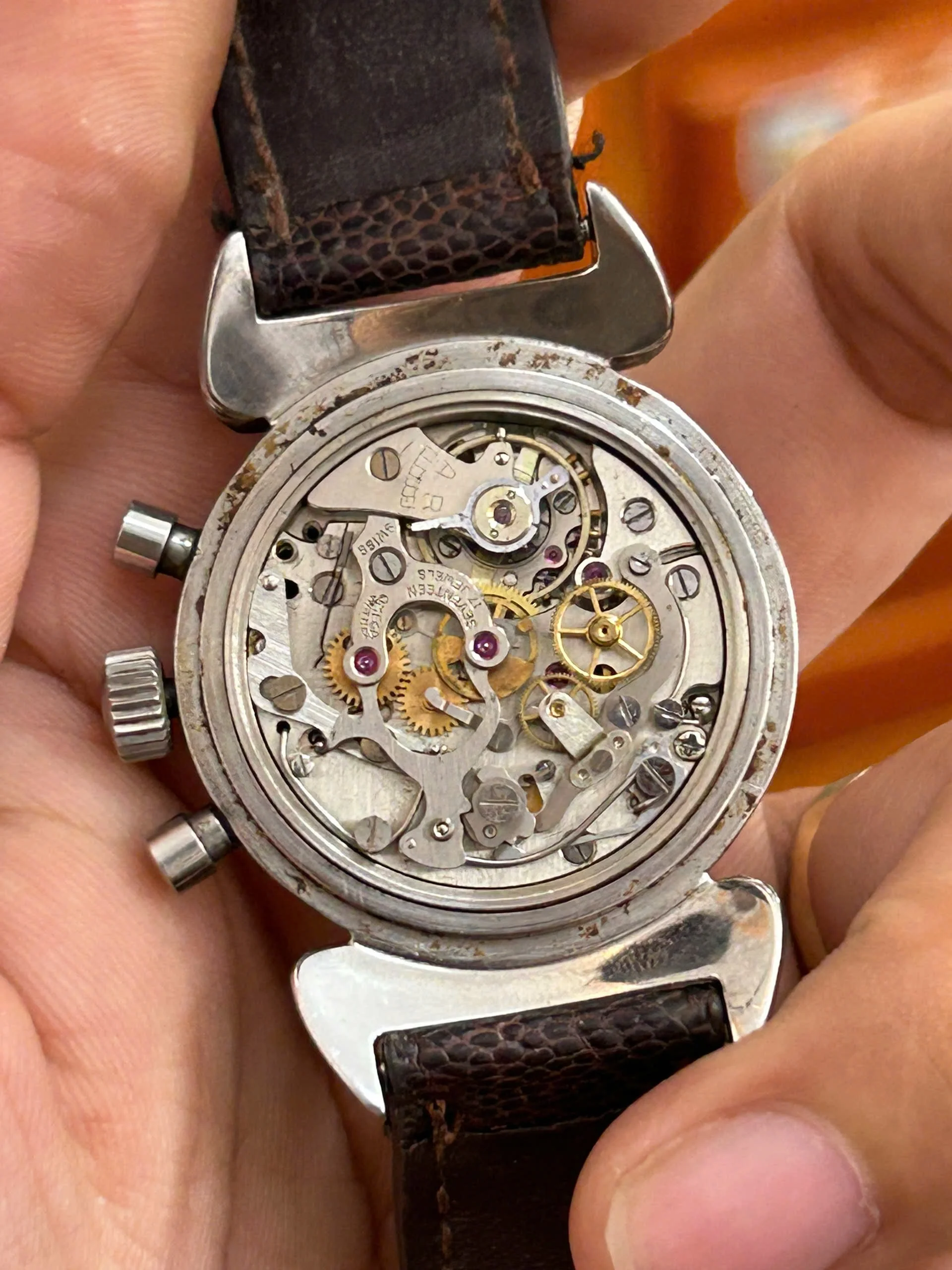

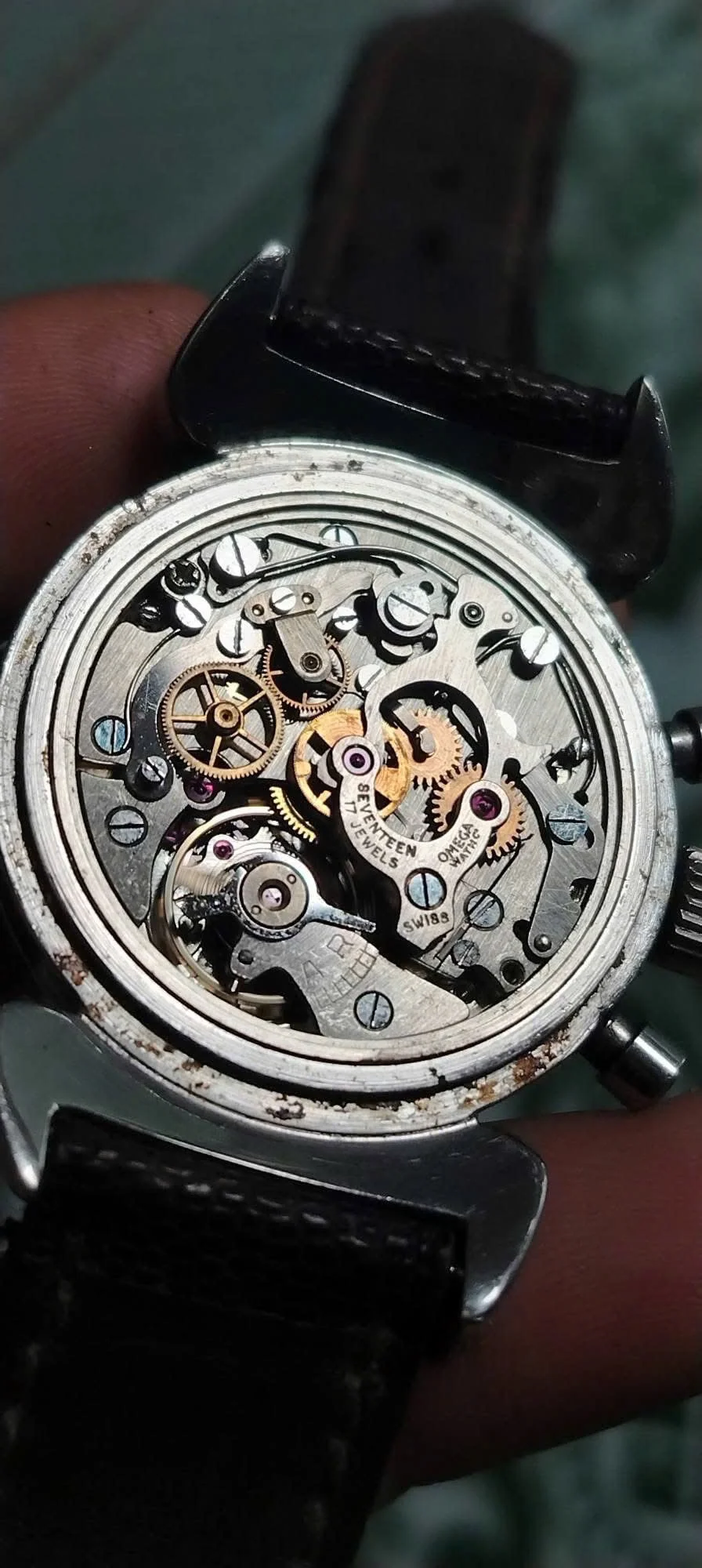

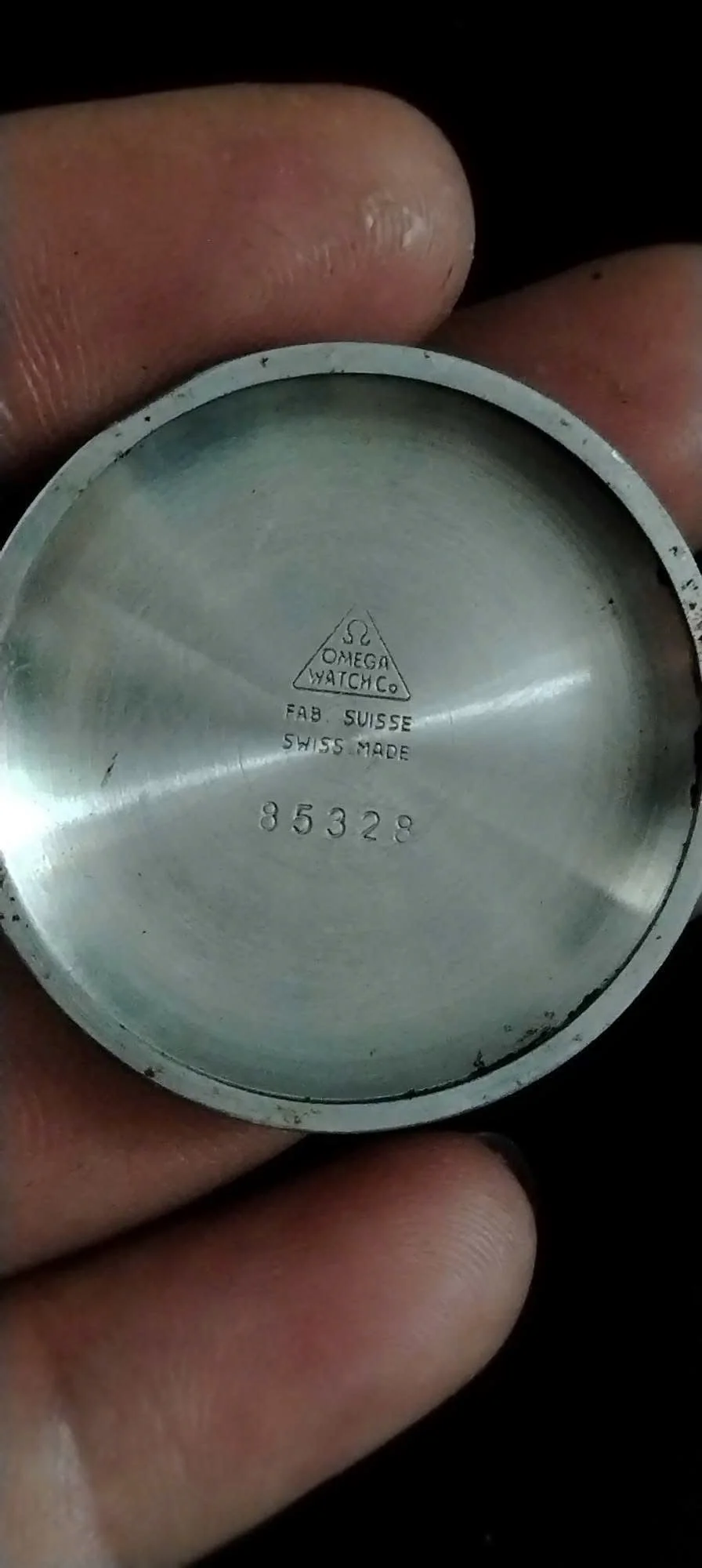

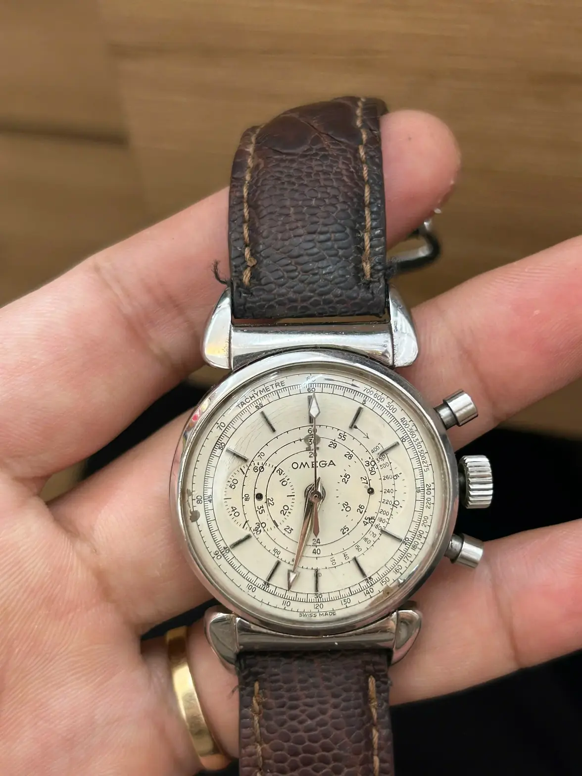

I just found this omega watch. I don't know if it is legit or not. The case, dial and caliber seems authentic, hands have been badly restaured. Not sure if Omega was using Lemania 1270 without omega marking 320/321? Any information? reference? A picture of a legitime one would be ideal. Help please!
Thanks in advance,
Filipe

Yeth, it theems tho.
A most unusual combination. I actually like the case/lugs.
34,848
39,416
The 321 / 27 CHRO C12 is Lemania 2310 based, they didn't use anything as economical as the 1270, someone has assembled some bits and tried to attach a story, hoping the cool looking lugs would get a punter to buy it
