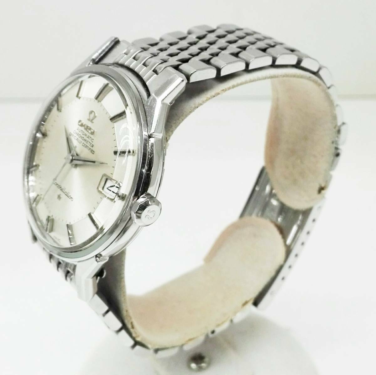

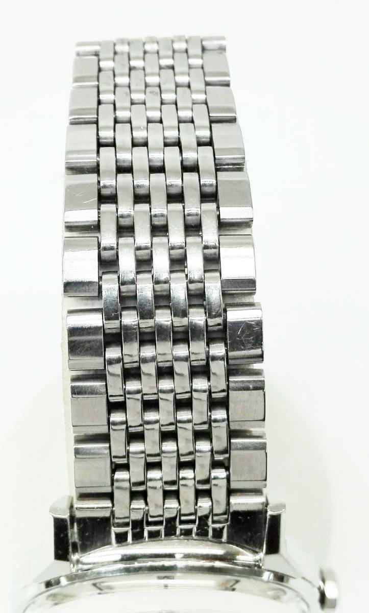

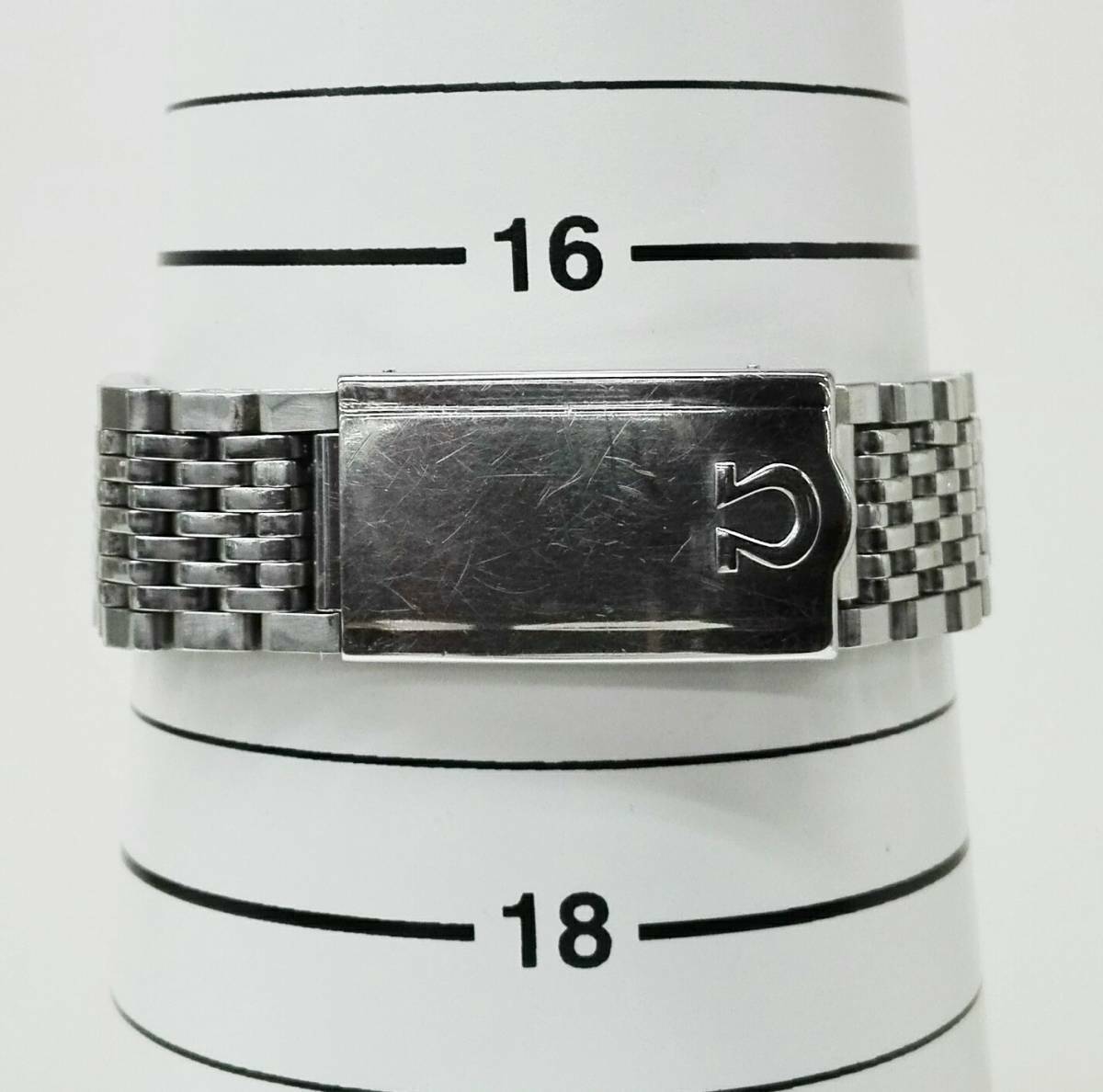

I just bought this vintage Omega constellation 168.005

It looks great. I’m sure you’ll enjoy it.

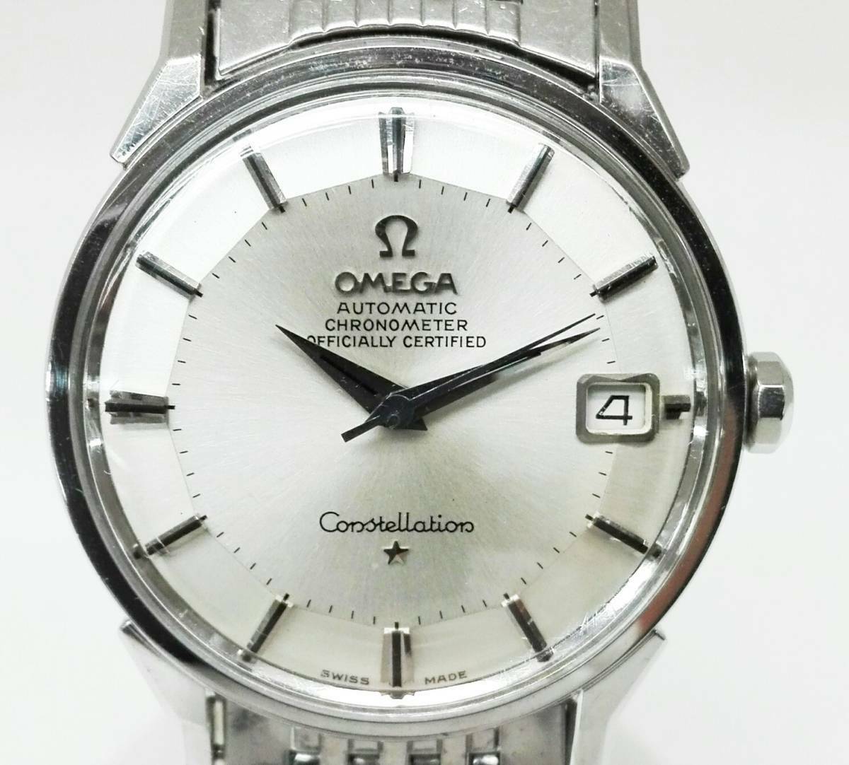

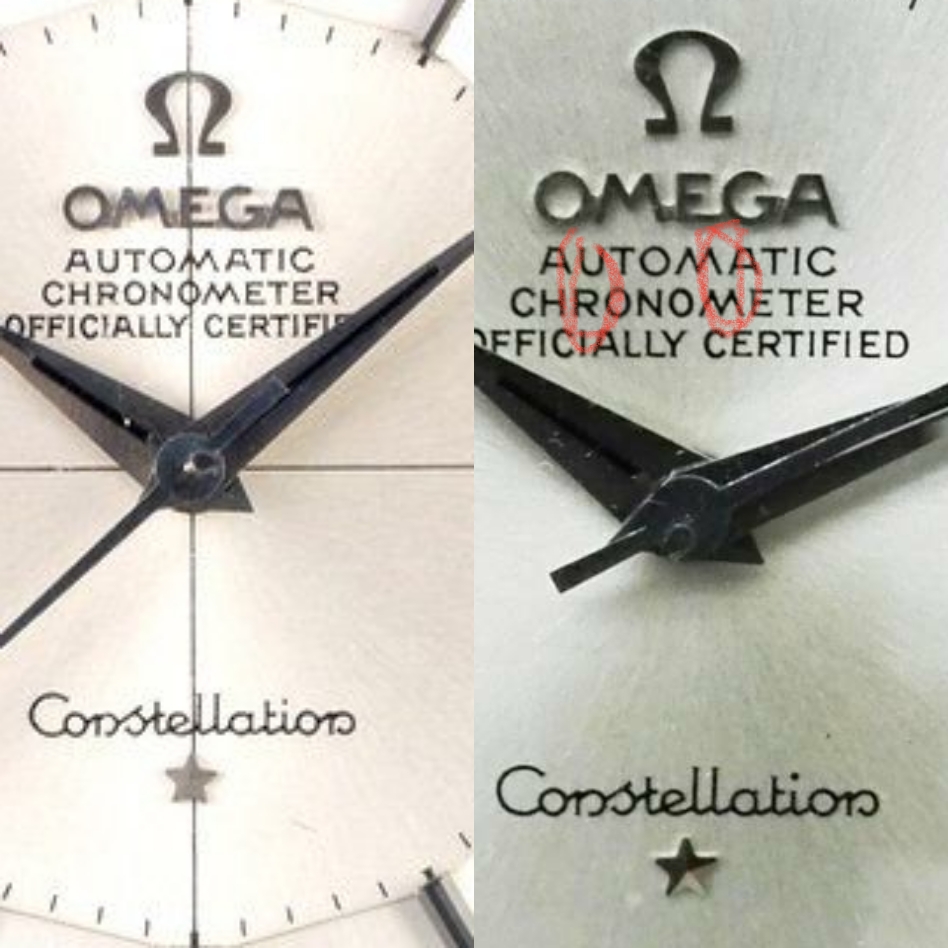

looks redial!!!
Are you going to tell us why?
232
247
If this is a redial i'll be stunned! Looks so good!
6,832
10,502
dodgy O in chronometer
dodgy C in officially
doesn't pass the MOY test
looks good to me -congratulations 👍
BOR is a bonus and - I'll bet that case looks so much better in real life than in the pics
lovely clean pie-pan dial, onyx inserts -it even has the index at 3.

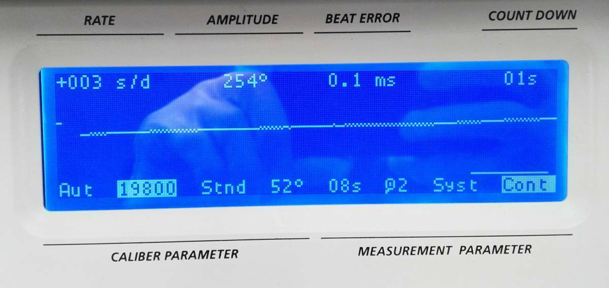

I'd liked to have seen a pic of the movt but it seems to be keeping good time from the one timegrapher pic

What a strong word! 😀
Sorry if it sounded strong, to you and to Mr Vo. Old cross-examination techniques and style die hard.
........... and I’ve just been re-watching the old (Raymond Burr) Perry Mason series on tv.

Yikes, I'm glad I didn't pay for it yet.
well, it’s not cheap but IMHO it’s an entirely correct watch.
