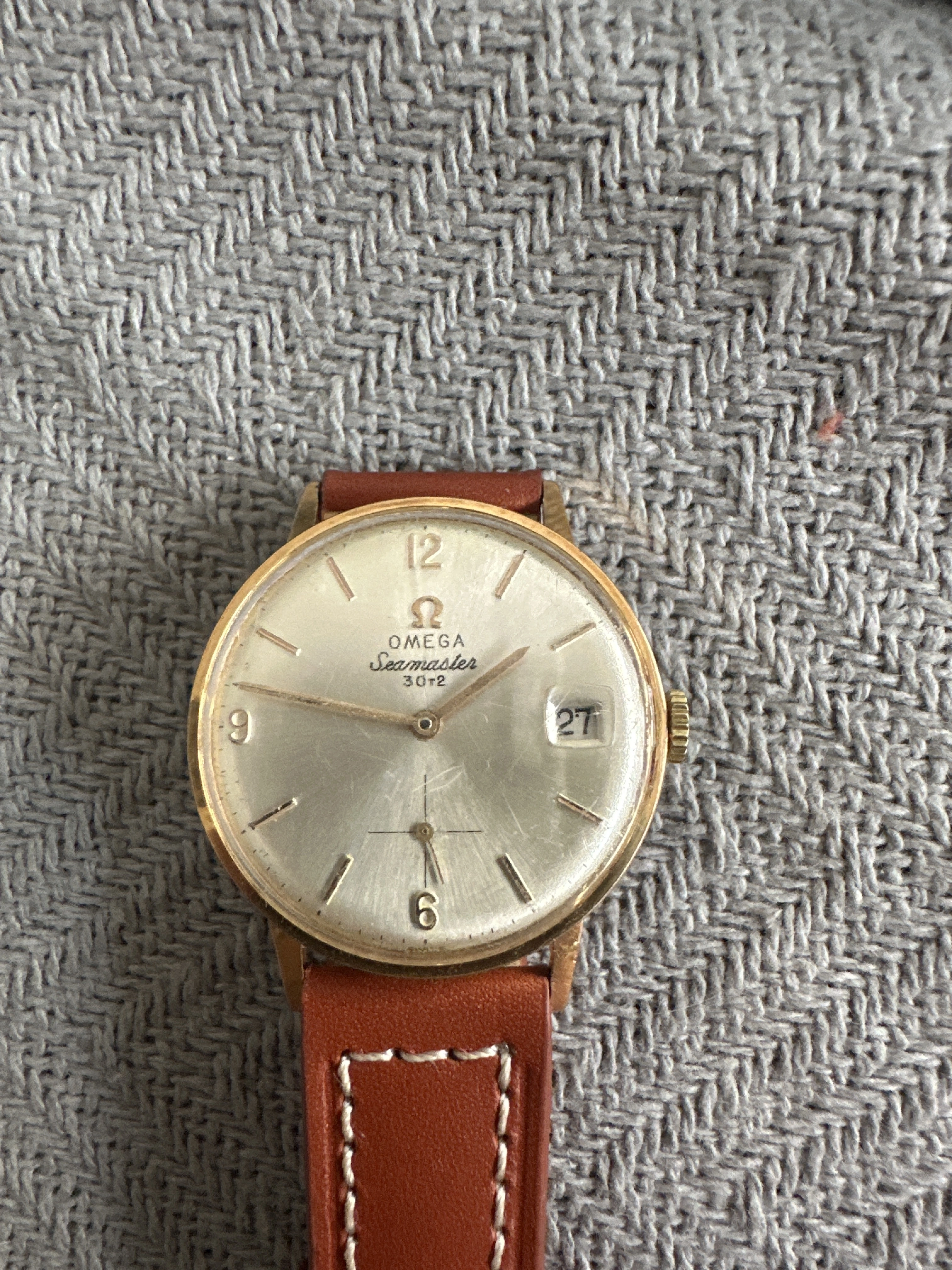

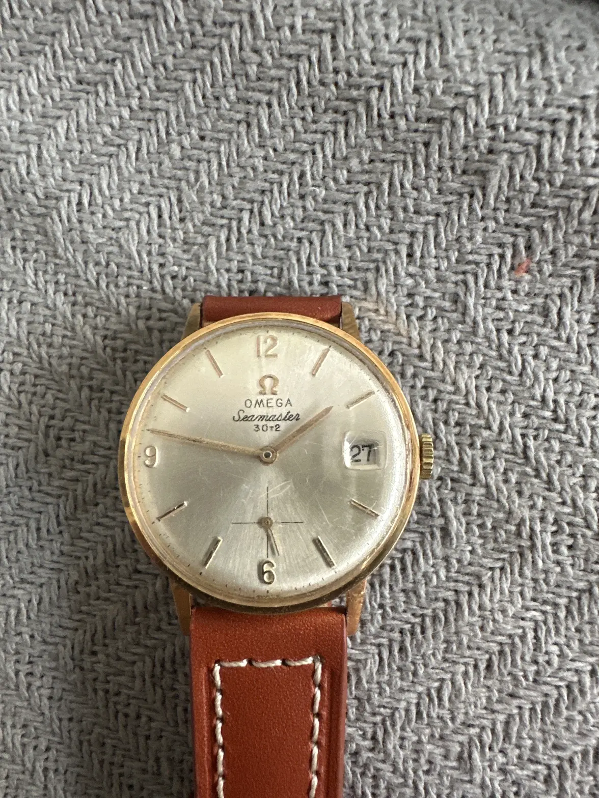

I have inherited an old omega 3012 I am trying to date it an
4
I’m trying to identify this watch, how old is it is it model etc, it’s gold in color but not sure if it’s plated or actually gold. It has a pop off back

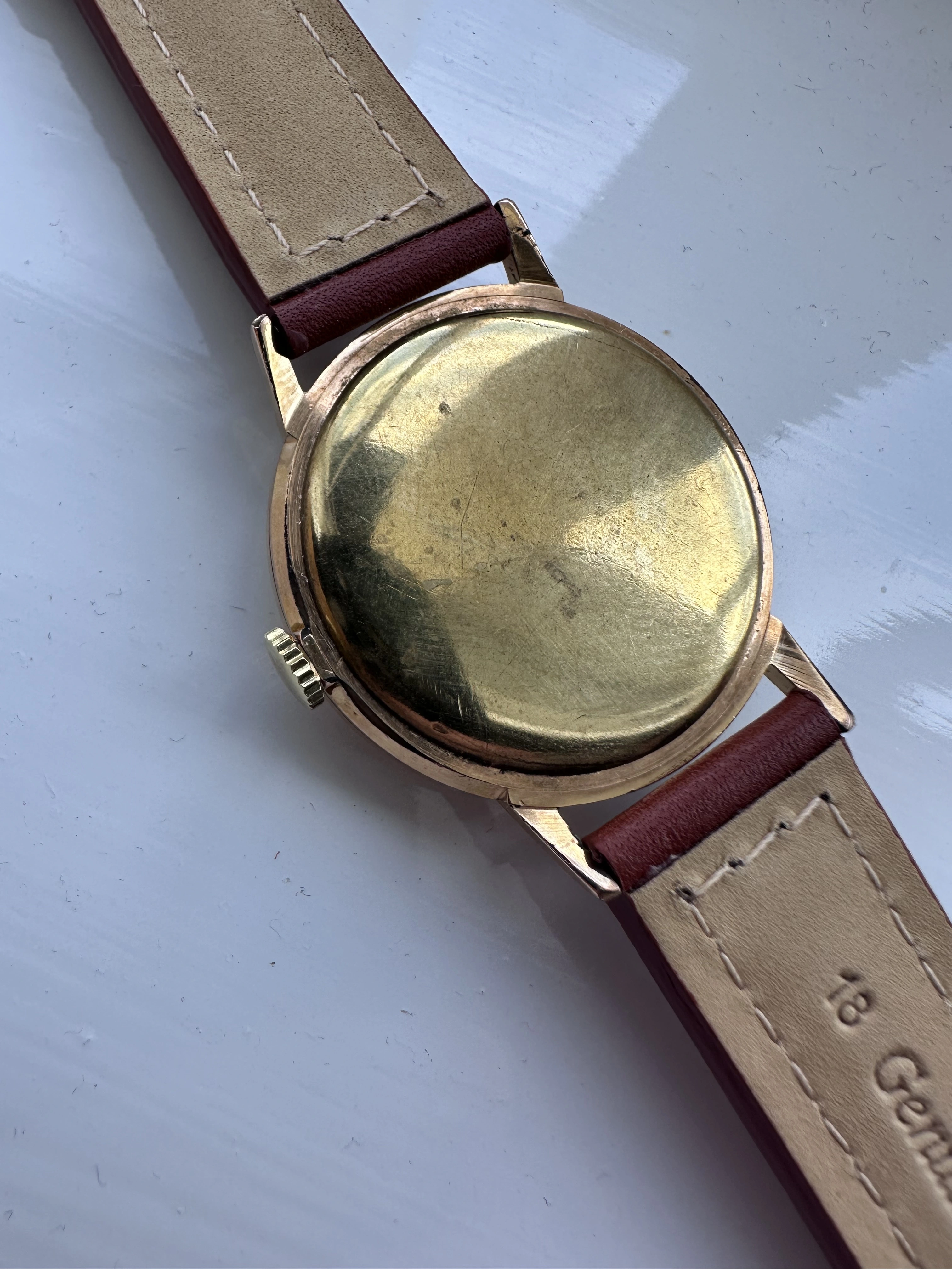

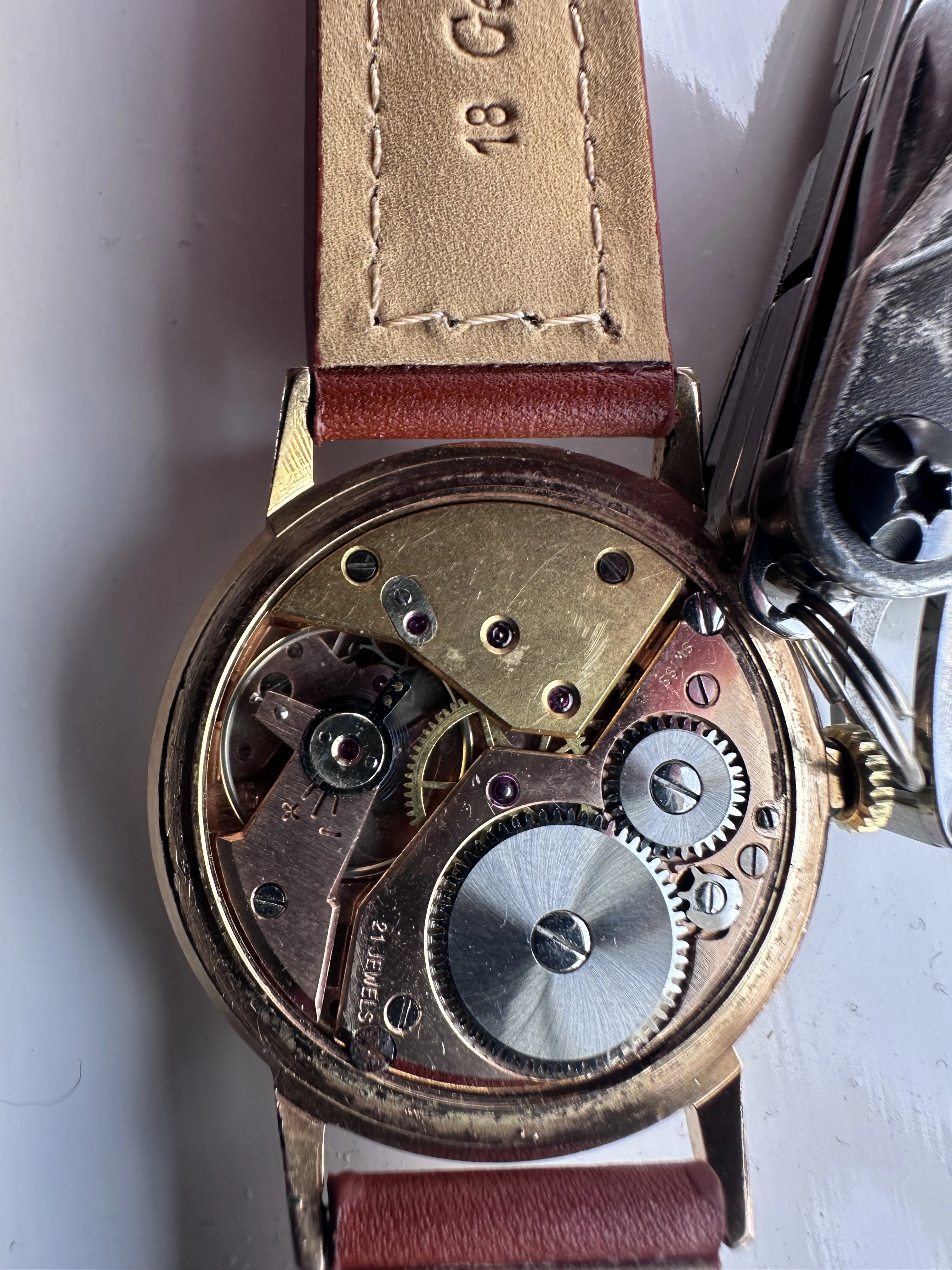

If you have Caseback opened you can date by movement SN and case reference is inside Caseback. It will also reveal if it is gold or gold cap.
Looks like 1950s.
Unfortunately the dial has been repainted, which was common practice back in the day if there was dial damage. Looks like the redialer added 30t2 which is probably the movement caliber. This was not on the original dial it is “artistic license” by the redialer.

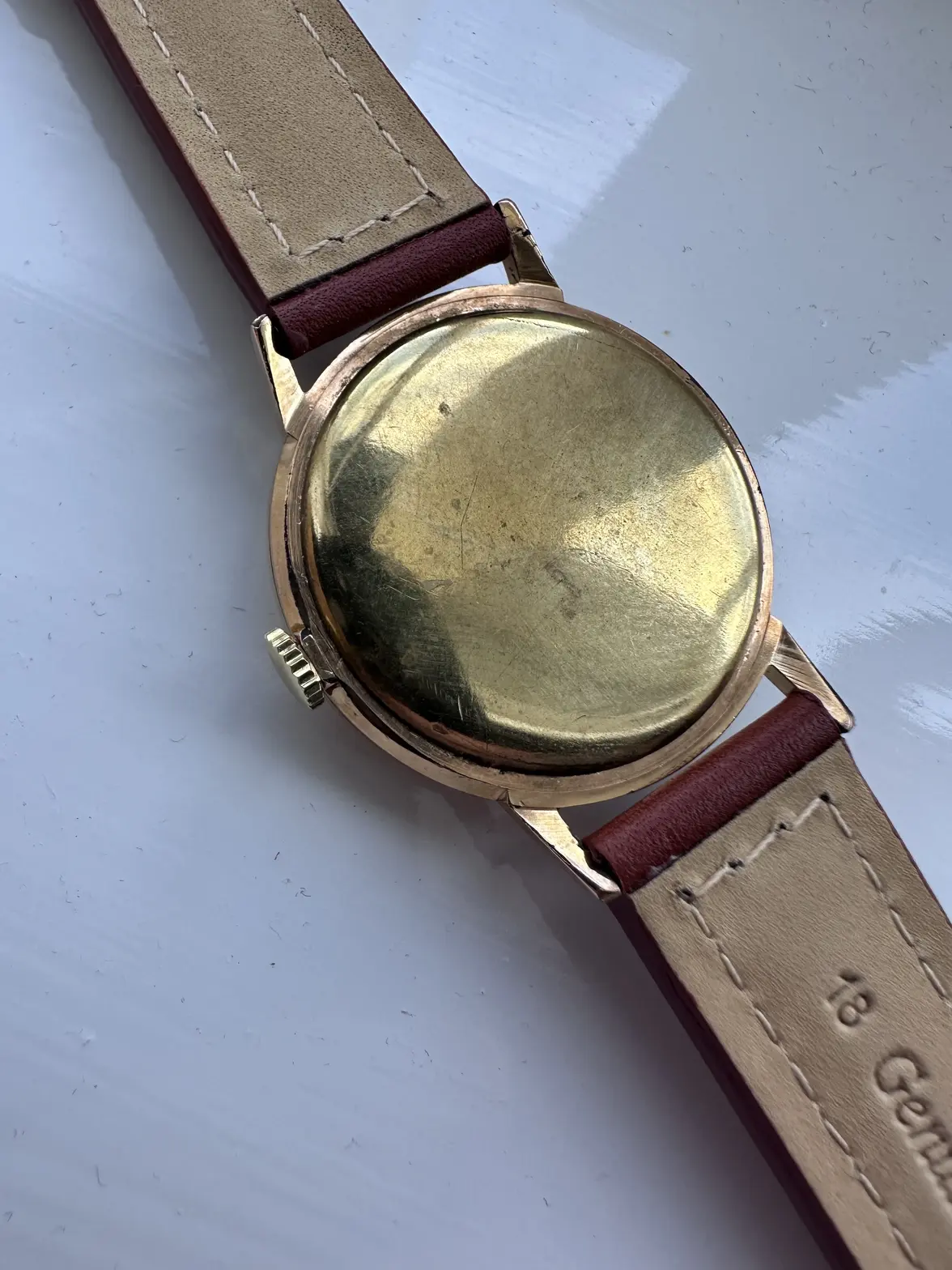

It’s not gold cap or plate. Info regarding gold content would be inside Caseback

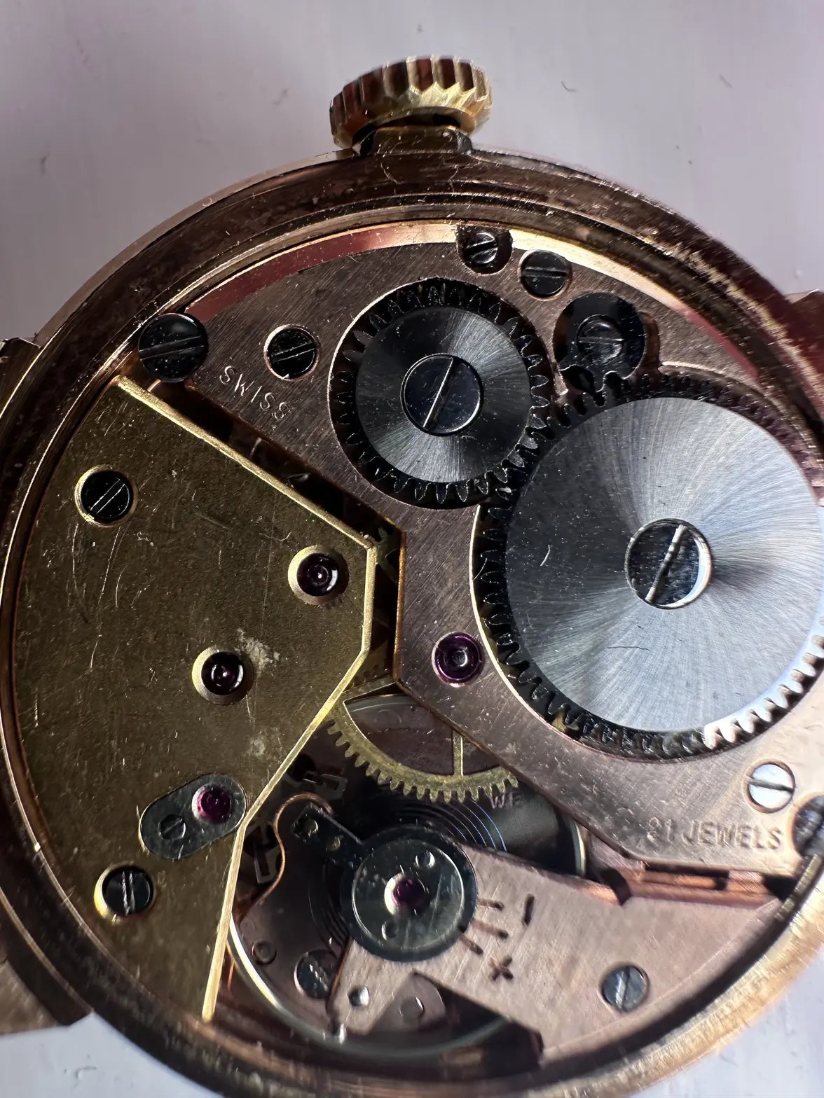

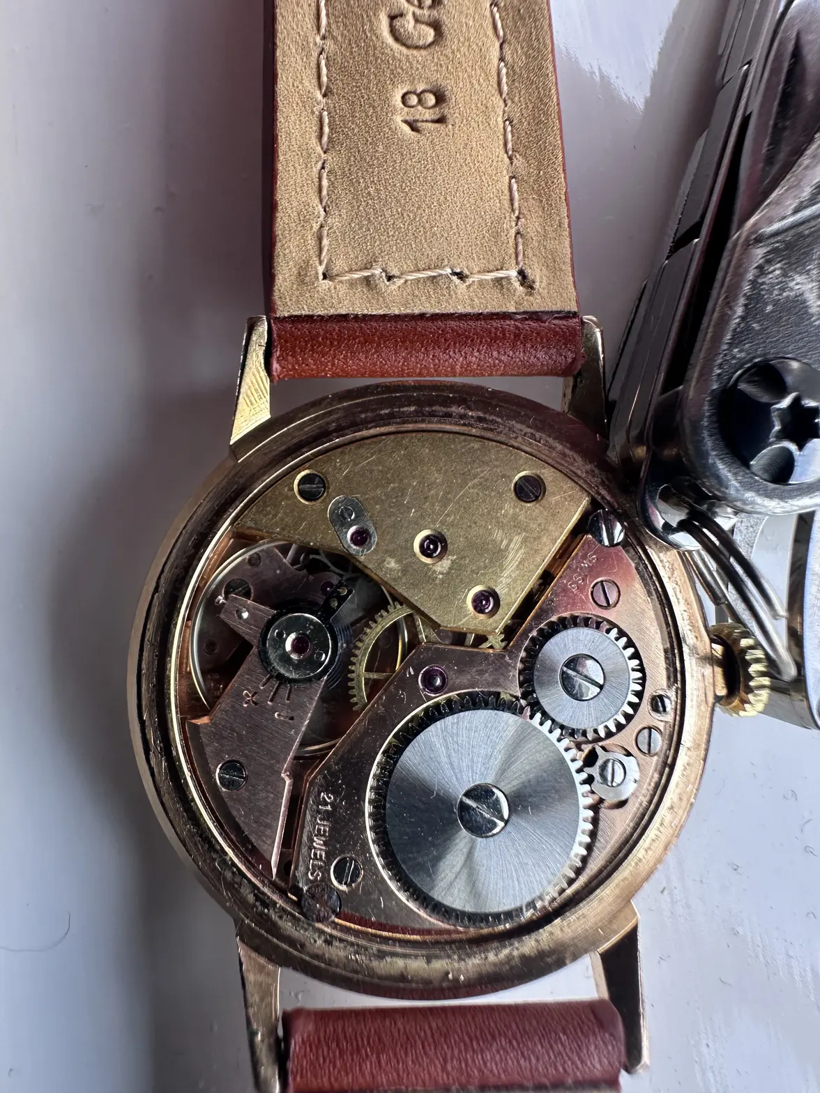

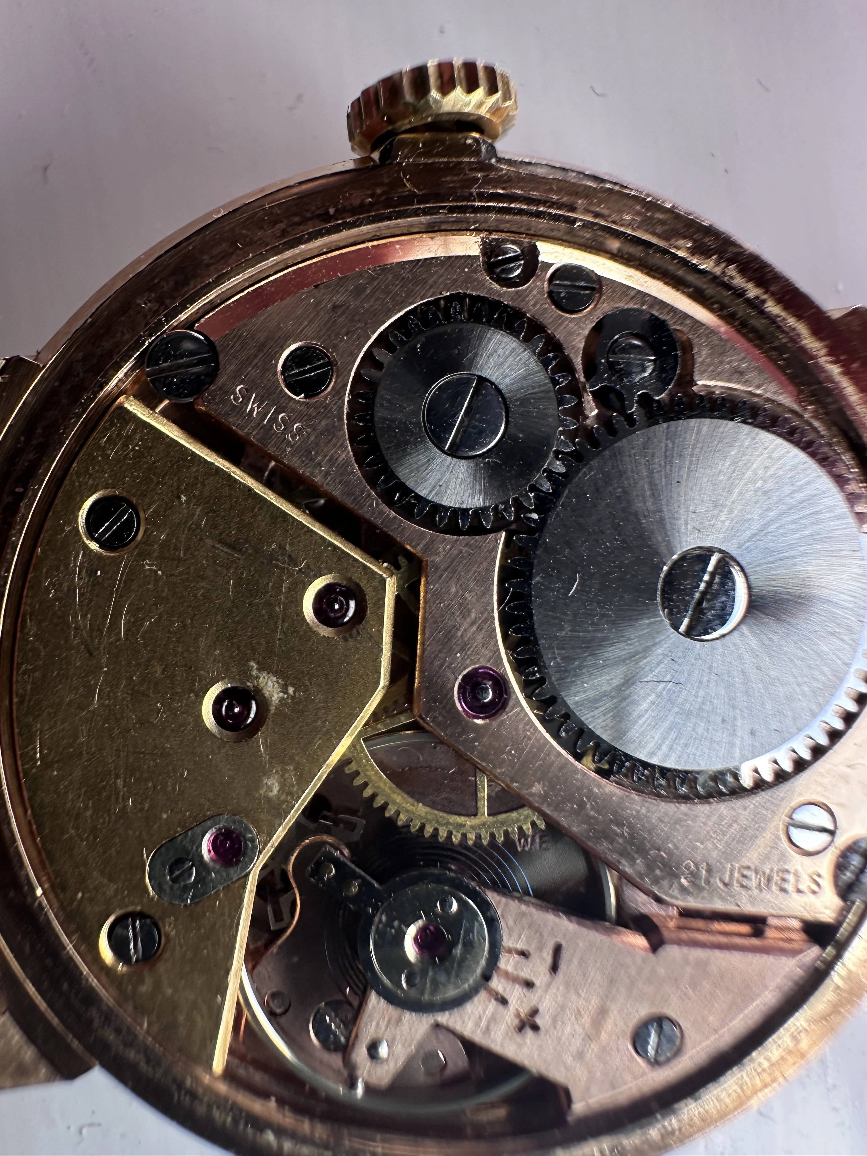

Looks like one bridge was replaced at service, lighter color.

It is very clearly not a 30T2 obviously, so no idea why they would put that on the dial other than for this reason.
As far as I can tell, this is just one of the 'anti-magnetic' fakes with a redial, but the movement at least claims to be swiss. I see the same movement sold in a few other watches on ebay, all with different/generic names, so I suspect this was just a generic swiss movement with a fantasy dial.

I hate to be the bearer of bad news, but the watch is a well known fake.

Then he got scammed.

The applied logo dial could have been out of an Omega.
Nothing else appears authentic. The 30t2 marking is bogus. A 30T2 movement predates the style, never was 21 jewels.

Here are hundreds of fakes for reference.
Maybe, but highly unlikely, many of the fakes have applied Ω logos.

Completely fake. No Omega connection. We see this one pretty often. Perfectly fine (non-Omega) movement, though, so it can be happily worn as an heirloom.
Edit: Unitas movement, FWIW.
