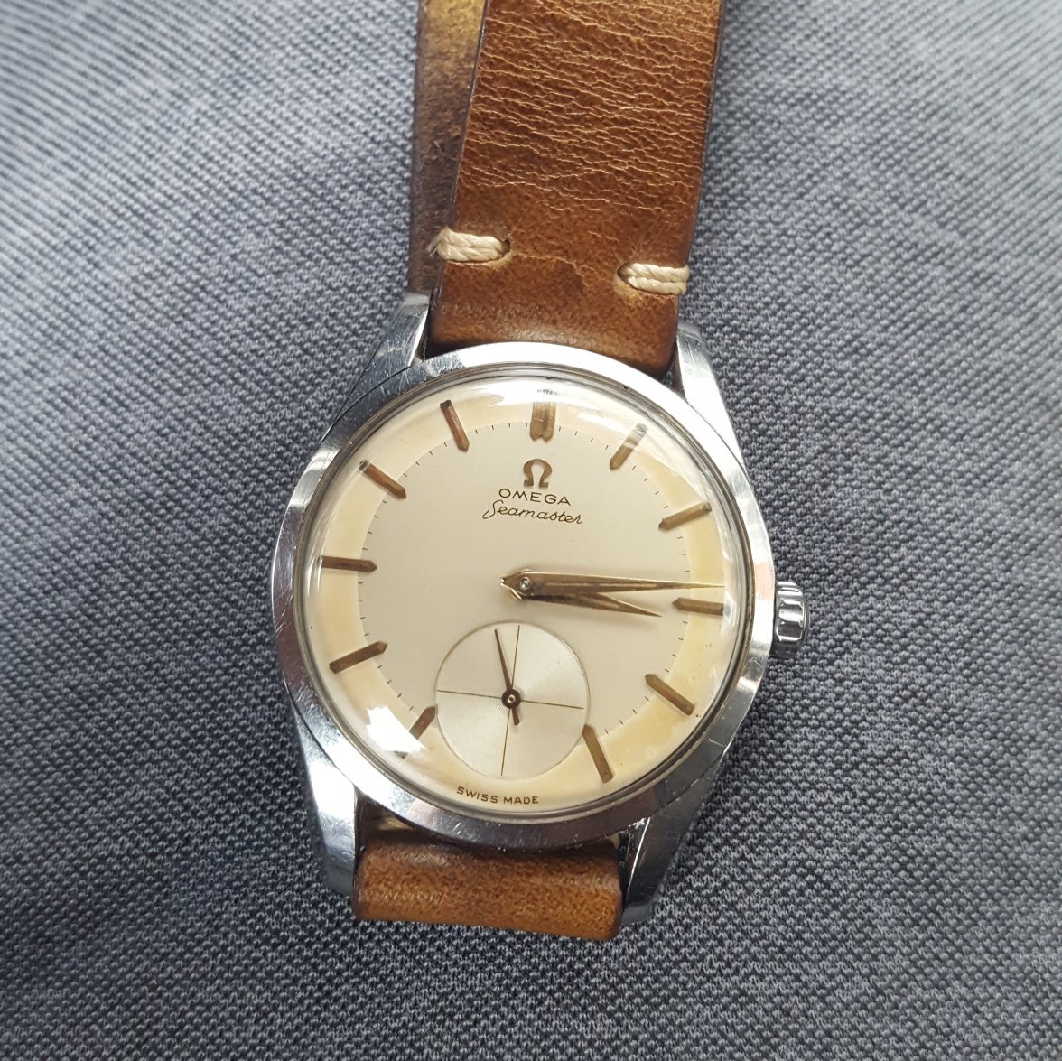

  4. felsby I don't see any option in settings or profile May 13, 2018
    1,439
    5,303
    Sorry for missing info, it is a ref. 2667 cal. 420 - so spot on, @BenBagbag !

  7. BenBagbag May 13, 2018
    2,820
    8,983
    Yeah, agree with @ulackfocus that they are replaced. Note also that the case size is 32.5mm which is common to the 420 movement. That is pretty tiny for a vintage Omega and probably why it was hard to locate shorter, correct hands.
    I wouldn't get close to that watch.
    Also, by 26X I meant Caliber. They were 30mm and often come with 36mm cases and the elongated hands like mine...

  8. felsby I don't see any option in settings or profile May 13, 2018
    1,439
    5,303
    Thanks to all! My watchmaker says correct replacement hands are tough to find, so I’ll heed the advice and stay away.

  11. ConElPueblo May 13, 2018
    9,587
    26,978
    Correct hands on the watch in the OP, in my opinion. The design mirrors those Omegas with 30mm movements where the overlap is factory spec, so I would suggest that these are correct, too. Also, if they weren't the hour hand would have to be tiny. The (very few) 2667s I could google my way to that had a similarly placed second track also have overlapping hands.

  14. X350 XJR Vintage Omega Aficionado May 13, 2018
    12,625
    29,944
    The fact that the second hand which does look original comes only to the second track makes me think the hour/minute hands have been replaced on OPs watch.

  15. ConElPueblo May 14, 2018
    9,587
    26,978
    But this is also the case on those Omega references where a overlapping minutes hand is standard, such as 2792/2892s...
    When I google the 2667 reference, I find three or four others with an inner seconds track, all of them have an overlapping minutes hand. None of them has an overlapping seconds hand.

  16. felsby I don't see any option in settings or profile May 14, 2018
    1,439
    5,303
    OTOH, the most likely explanation for replacing hands would be rust - and the dial looks pristine. Odd, if hands rusted then?
    Another thing, there is a visible gap around the dial. Is the tension ring incorrect as well?
