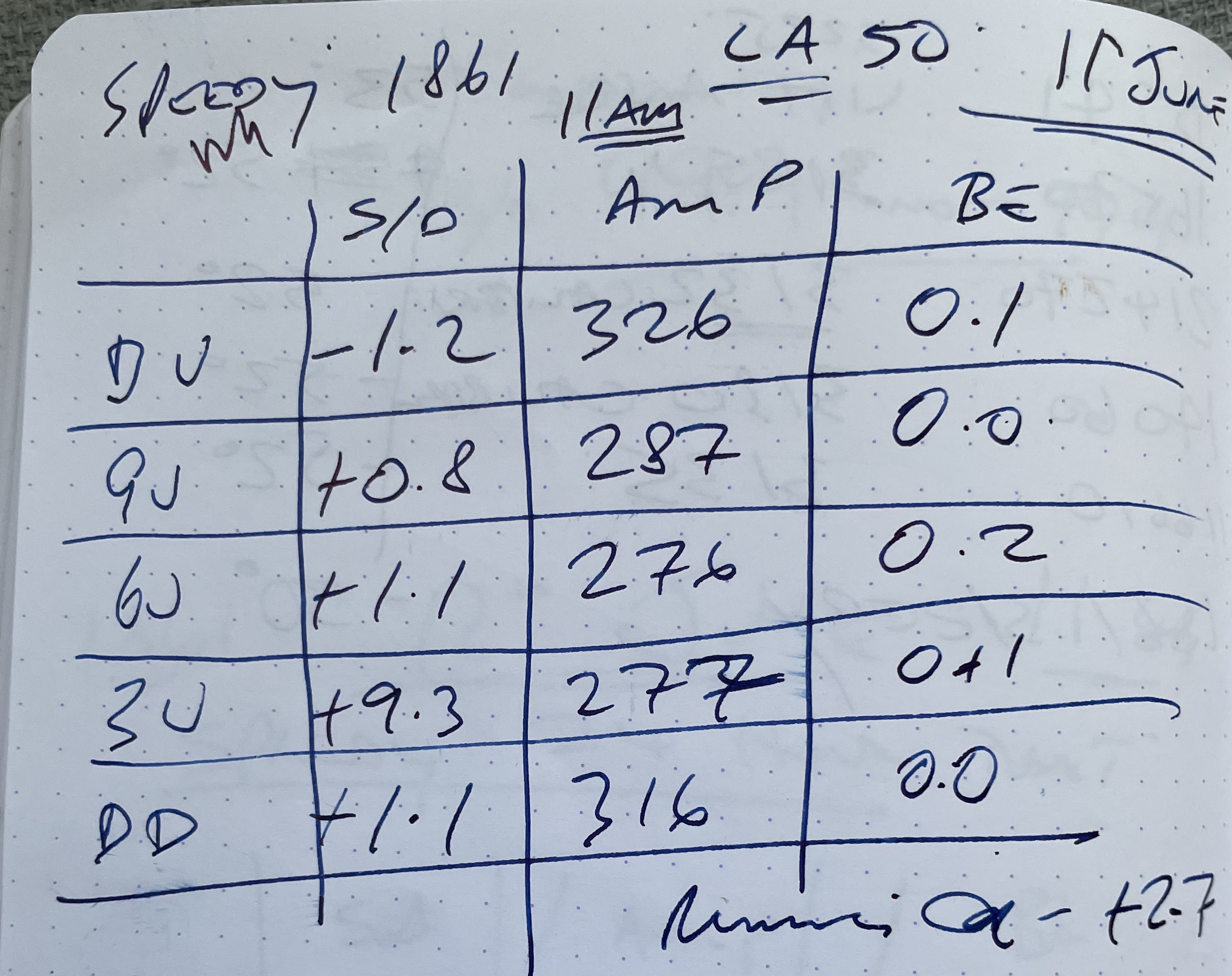

My Speedmaster 1861 005 was bought brand new in 2020…I’ve taken some readings using a Weishi 1900, just wondering how any experts reckon it’s running….let the watch sit for 15 mins before DU reading then 3 mins in between readings to settle and 3 mins check in each position…did a full wind test and 24hour test….it ran for a full 50 hours before stopping…..Lift angle 50
The watch was left untouched DU from Full wind until it was tested at the 24 hour stage..
Hope you can read my bad writing
Full wind sd +2.7
24 hour sd +5.5
2,845
9,196
7,103
23,044
You get credit in my book for using a fountain pen.
There are others much more well-versed in this than I, but if this were my watch, I would probably be satisfied.
29,186
75,420
Your watch is running well within Omega specs for that movement. I would be pleased with those results.

Your are doing fine if you ask me

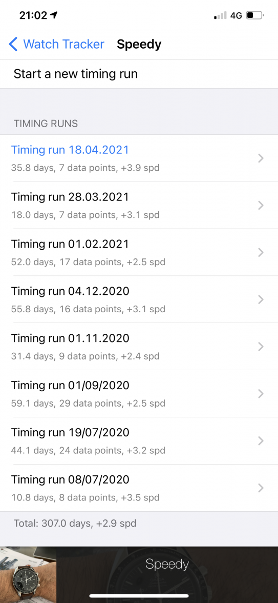

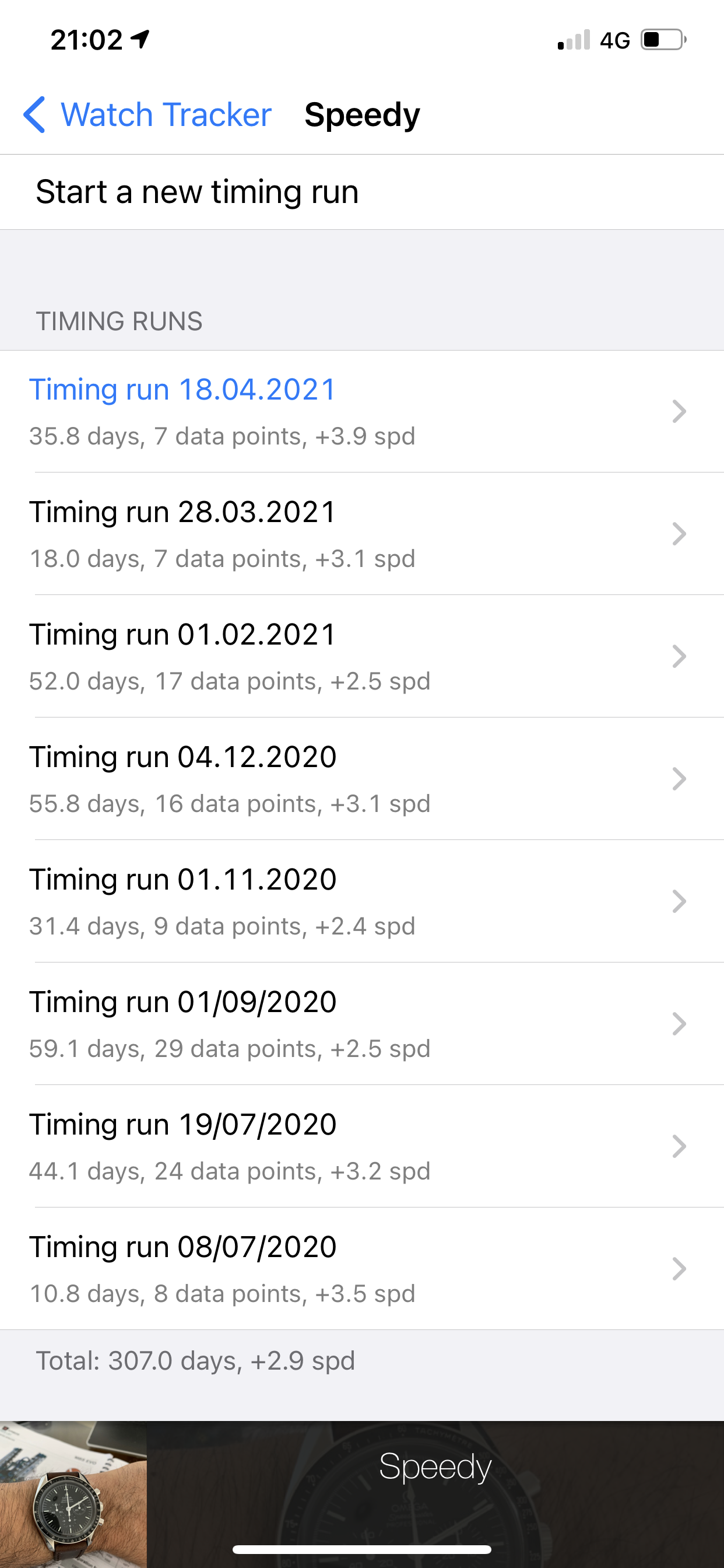

Here is mine over almost an year timing
Great thank you for your results….looks great

AS @ Archer stated running well within specs. Most of those 1861 seem to run fast and if the most you recorded was +5.5 then you are doing very well from my experience.

I'd love those specs on an 1861! Mine is less than a year old and runs +10 s/d so enjoy!
