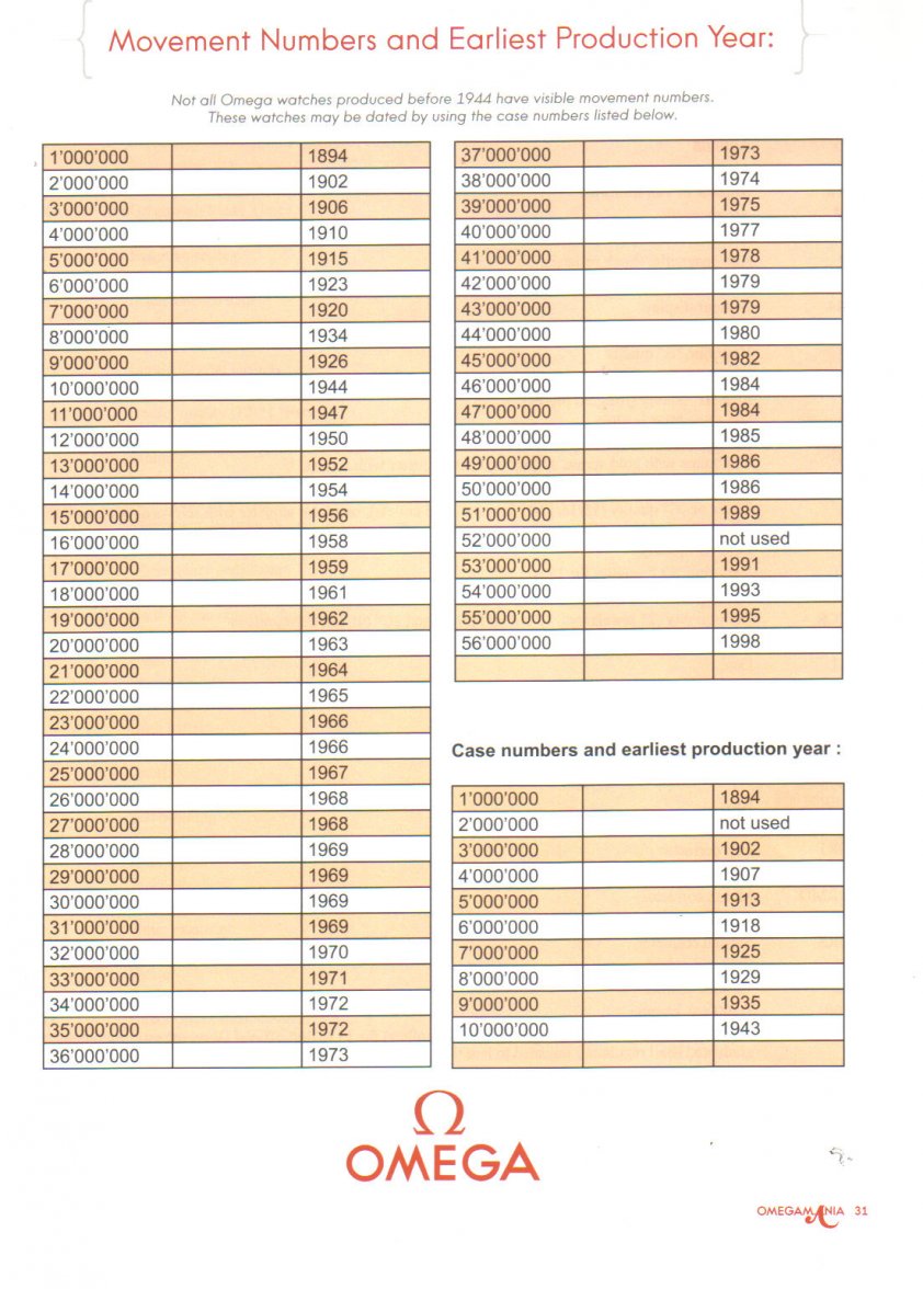

Is there a resource site to search movement serial numbers to date a vintage watch? I've tried the Omega Vintage site but haven't had any luck; it seems hard to navigate even when trying to match up movement to model year. I'm I doing something wrong?

would this chart be for Constellation model? sorry I should have mentioned that...
Yea it includes anything that isn’t a Speedmaster or Lemania chronograph powered watch so that includes constellations
In general terms yes. What age range are you interested in?

This is the "official" Omega chart. Unfortunately there are a bunch of typos early on, with transposed years, so you need to use common sense.

And do note this isn’t reliable information, just a rough guideline. +/- 2 years is absolutely normal.

thanks because I have a 1952 model 2848 starting with a "12" ; according to the chart would be a 1950...but it's actually a 1952...

I'd be surprised - the movement wasnt released until ~1955, the reference until 1956 if I recall correctly. In 1952, Omega was still producing bumper movements - your watch, if it's a 2848, has a full-rotor movement (490/491).

The serial number may start with a “12”, but what are next 2 digits? Since 12 million serial numbers were used between 1950 and 1952, you need to extrapolate from these tables a bit.
Also, the tables give you estimated manufacturing year of the movements only. It could take a year or two for a movement to be tested, cased and shipped to a wholesaler. Then another year or two until it is distributed and sold at retail.
