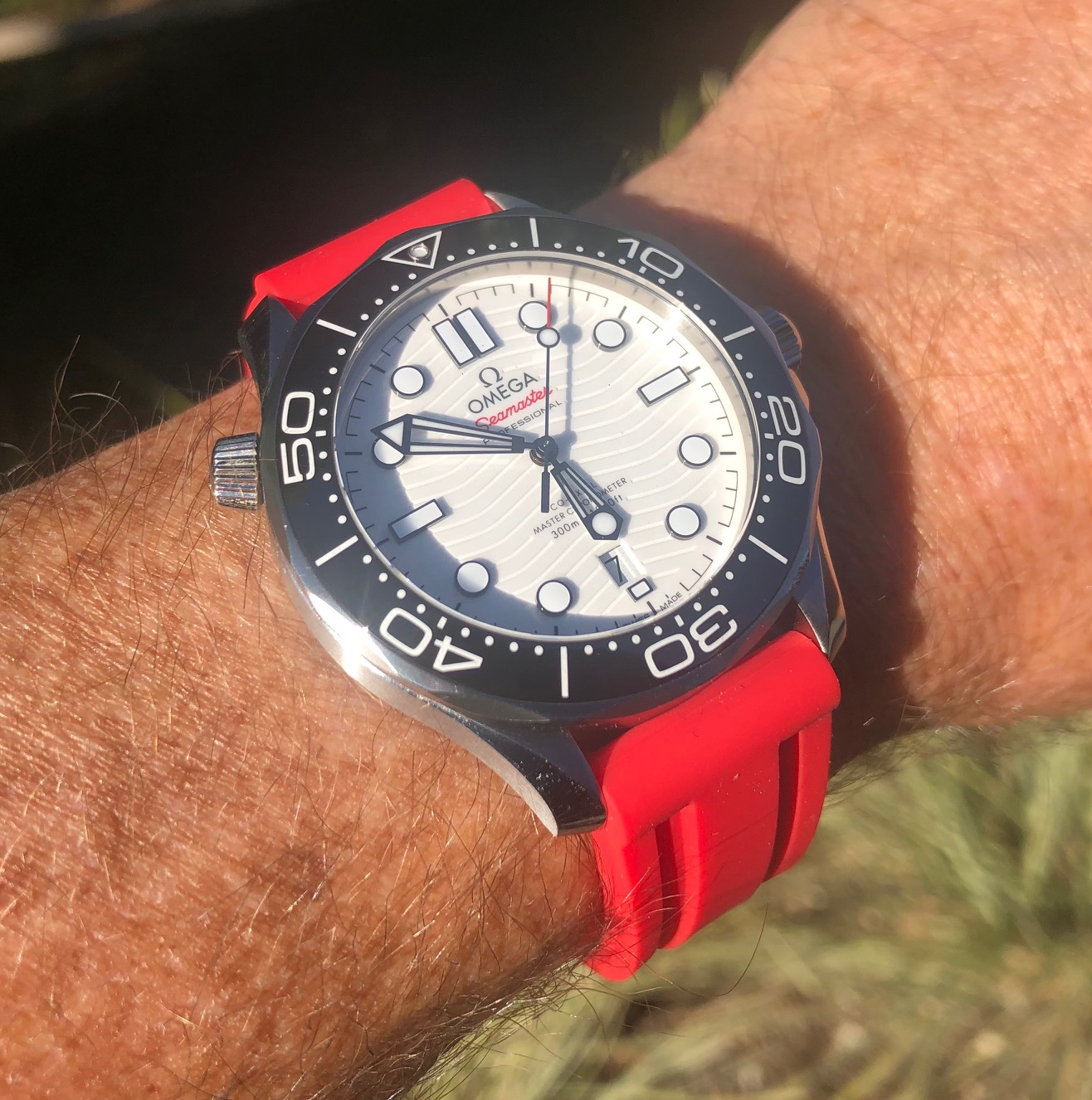

A little follow-up. I did buy the watch and it arrived today. I love it!
The watch actually did come with the Metas card and I was able to access the test results. Although this system doesn't indicate the test date, it does confirm that this serial number is legit. Although I'm not able to resolve the age to between 2018 and now, it no longer really matters to me. Thanks for the responses.
