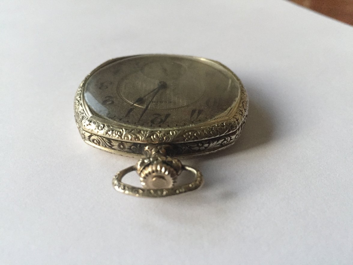

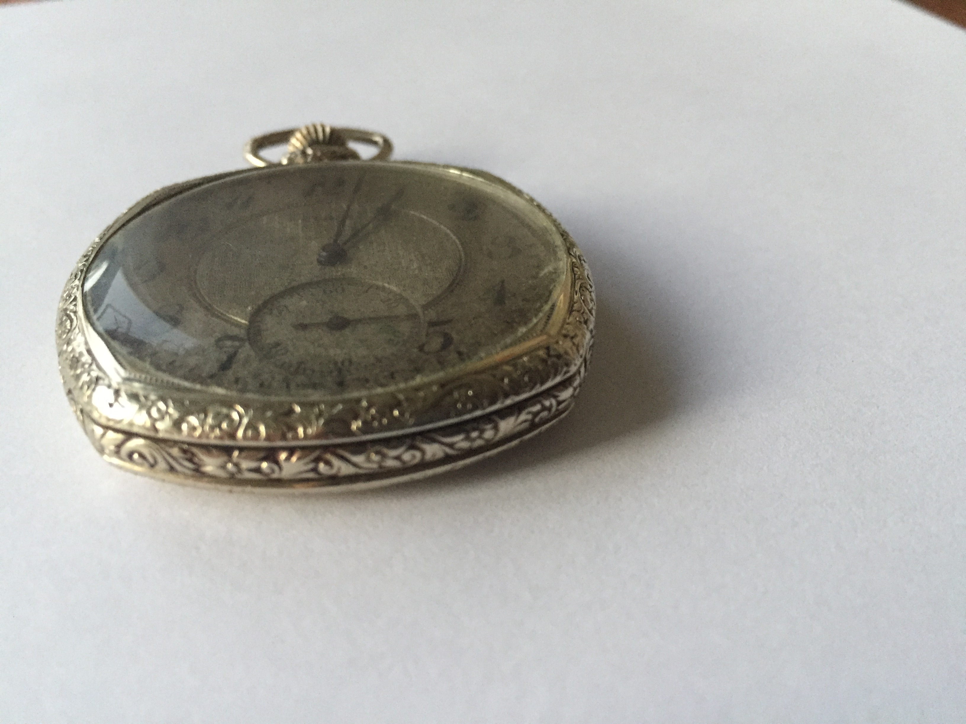

Hi folks. I am looking for guidance on how to open this pocket watch. It is happily ticking away, but I would like to see the movement etc. Given the square shape and the seam all around (no hinges to be found) I believe it is a snap-off back watch. However, there is no notch for a case knife. Any ideas?
Here is a tour around the watch:
