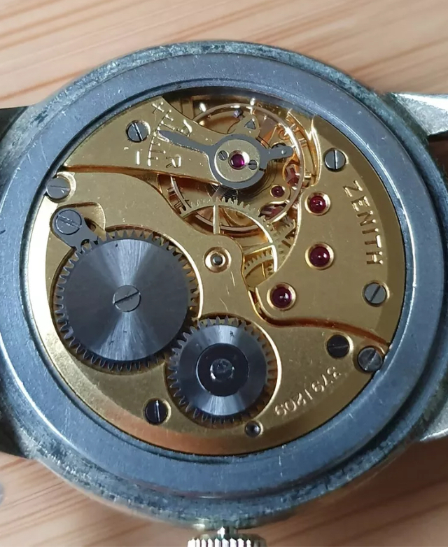

How much info can be pulled from mvmt pic?

here is the picture. It’s circa ’40 and that’s all I know. I wanna find a nos case fitting this mvmt but have no clue...

I'm guessing it's a Zenith. 😁

I was thinking about that, but didn't want to go out on a limb.
serial no?
unfortunately it’s custom see thru back. my guess is it’s cal 106?

Weird screws are clean but movement has scratches.
what does ranfft day?

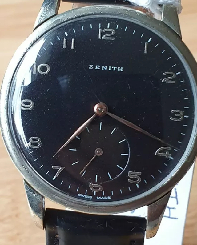

Seller said hands are generic. I am planning re-dialing it into white dial with blue hands/index.
Should be 48/49
Do you have hands and dial?

I agree - it looks like a 106 - I don't think you will find many NOS cases but good luck. There will be quite a few watches in circulation with movements in poor condition, so you may be able to buy one and use your movement to make it serviceable. Yours is a Swiss movement with the 7 digit serial #. Besancon Zeniths used 106 movements well into the 1950's and were 6 digits. Interestingly, my profile photo is a 1950's Besancon 106 that I bought in working condition. I took it in for service and my watchmaker said it was very rough. He suggested that I buy a used movement for parts off Ebay, which I did. These are not terribly collectible, so the marriage is not really much of an issue with me. It brought an old piece, with character back to life.
