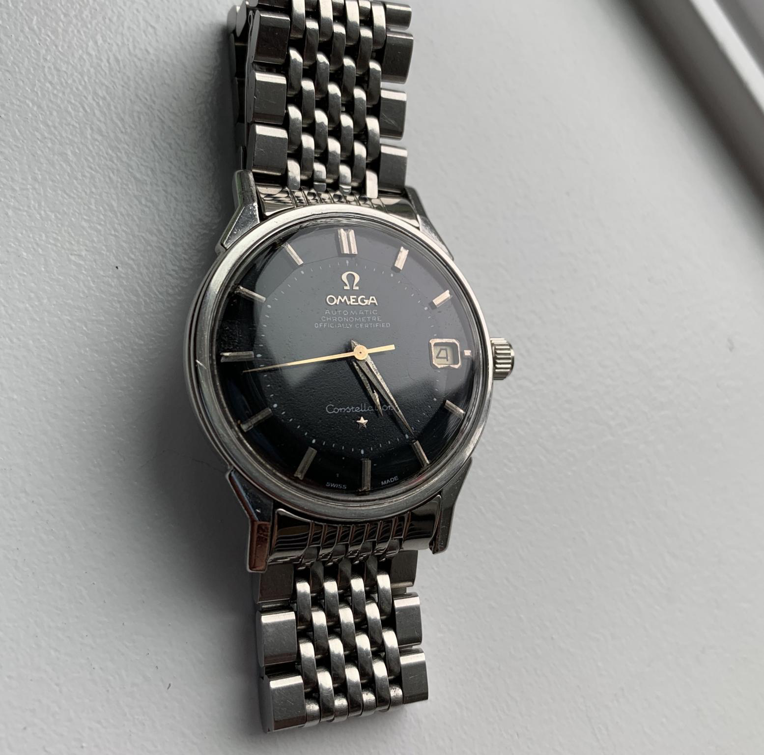

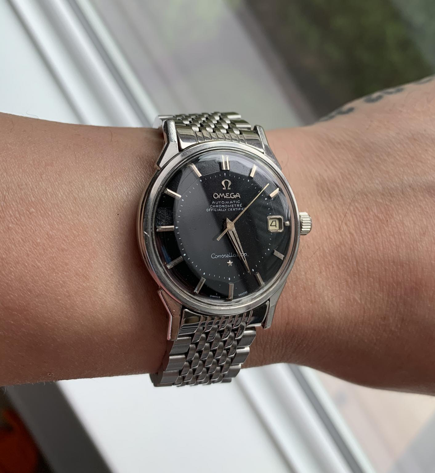

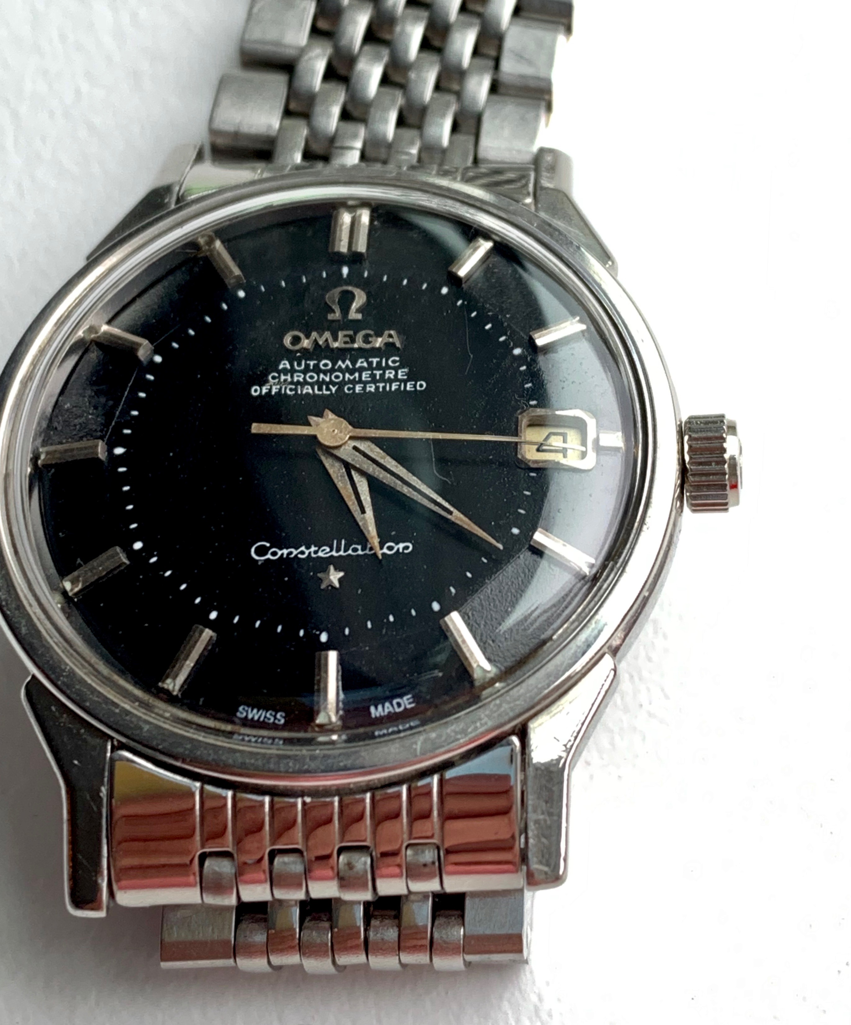

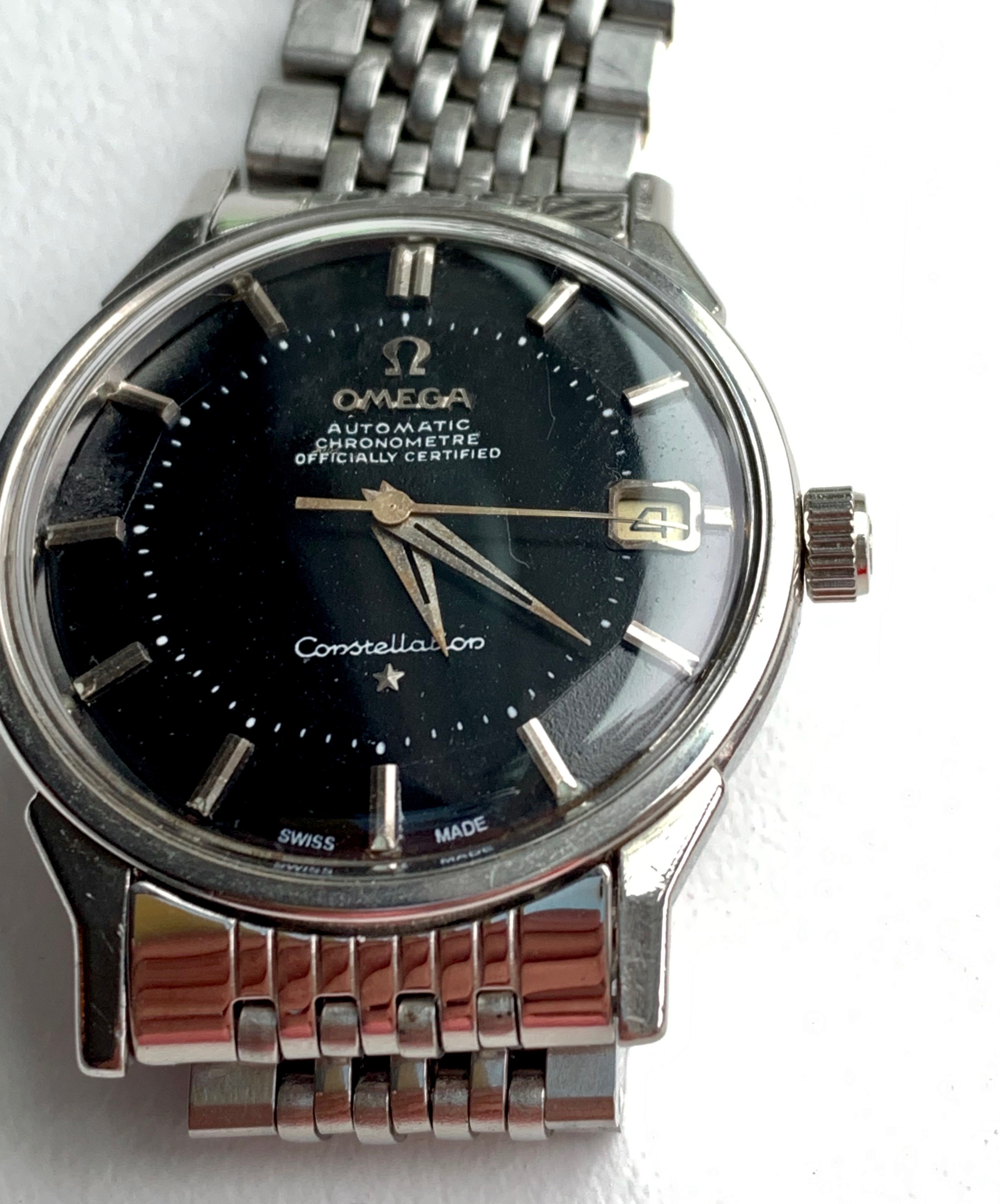

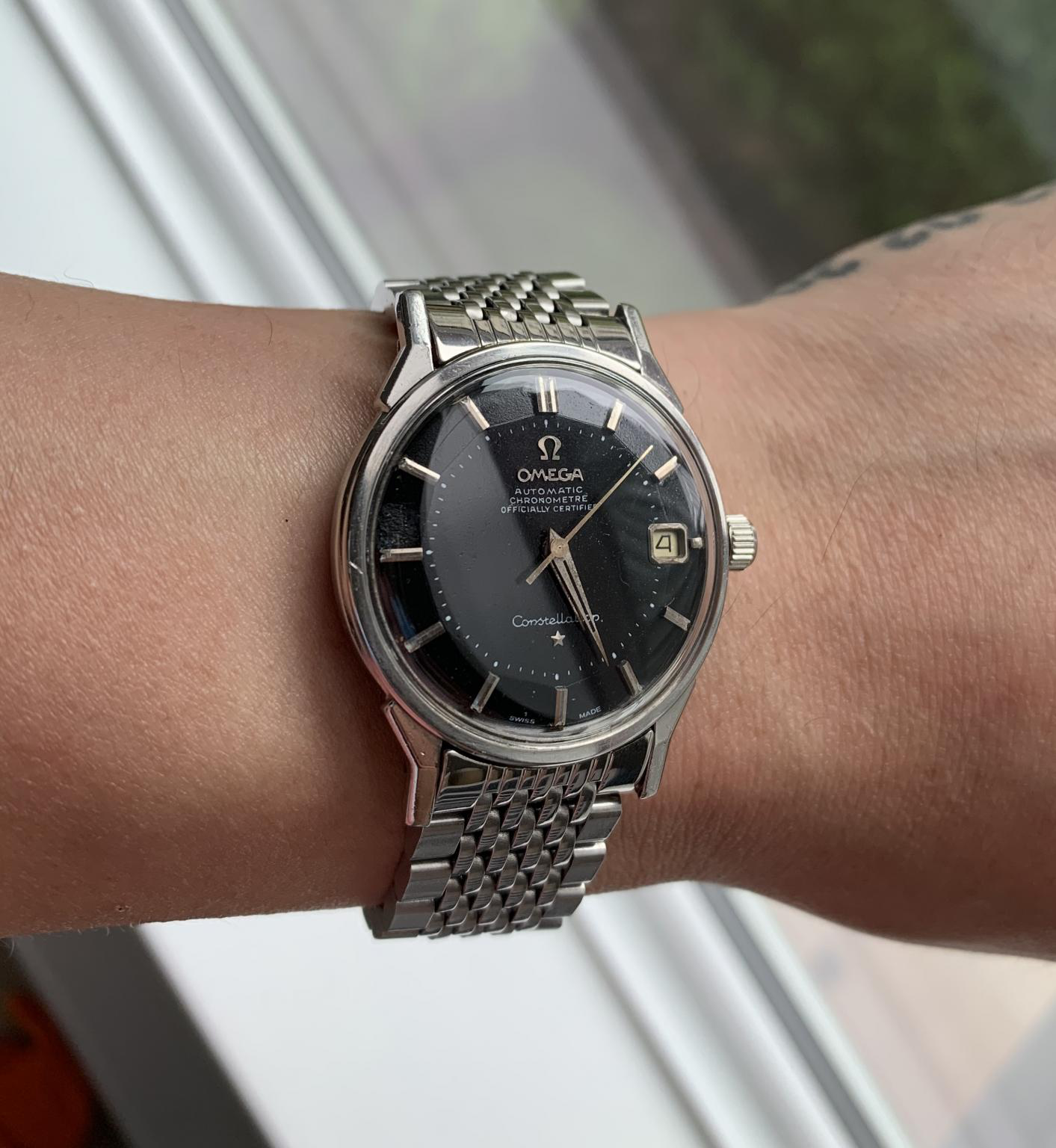

How does this Connie 168.005 look?
1,588
5,385
Dial appears to be refinished. Case is heavily polished. Wouldn’t be surprised if the movement is in rough shape.
363
807

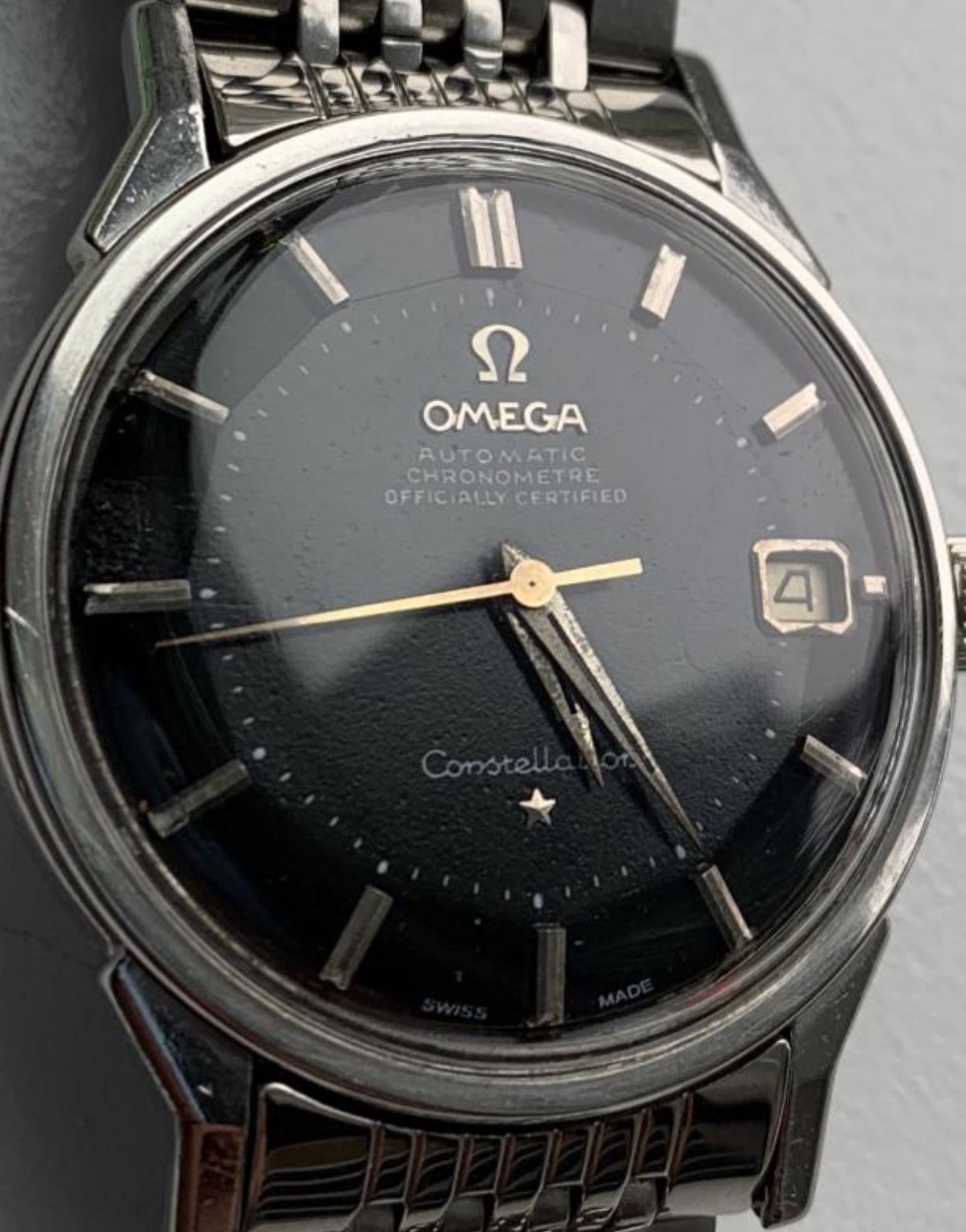

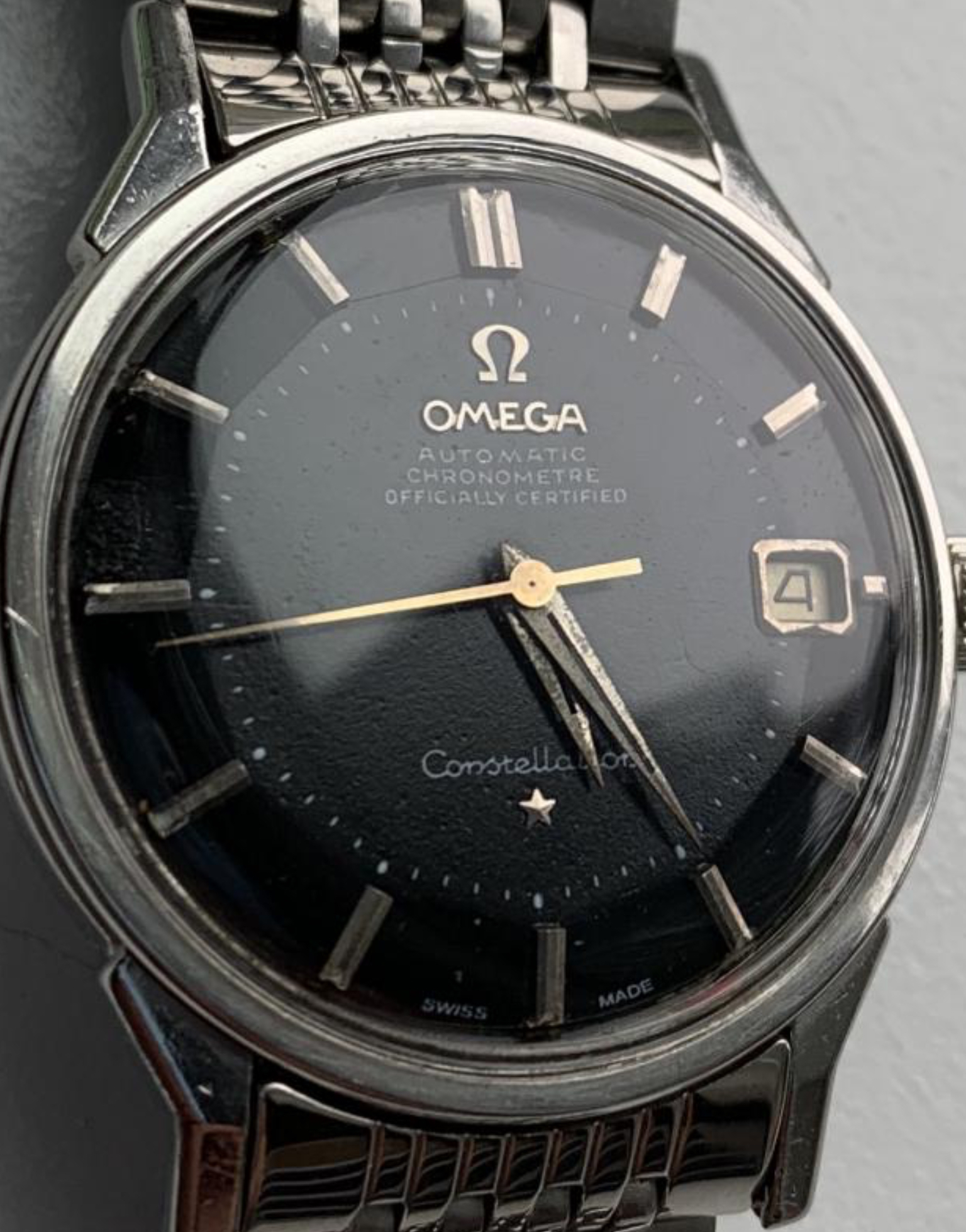

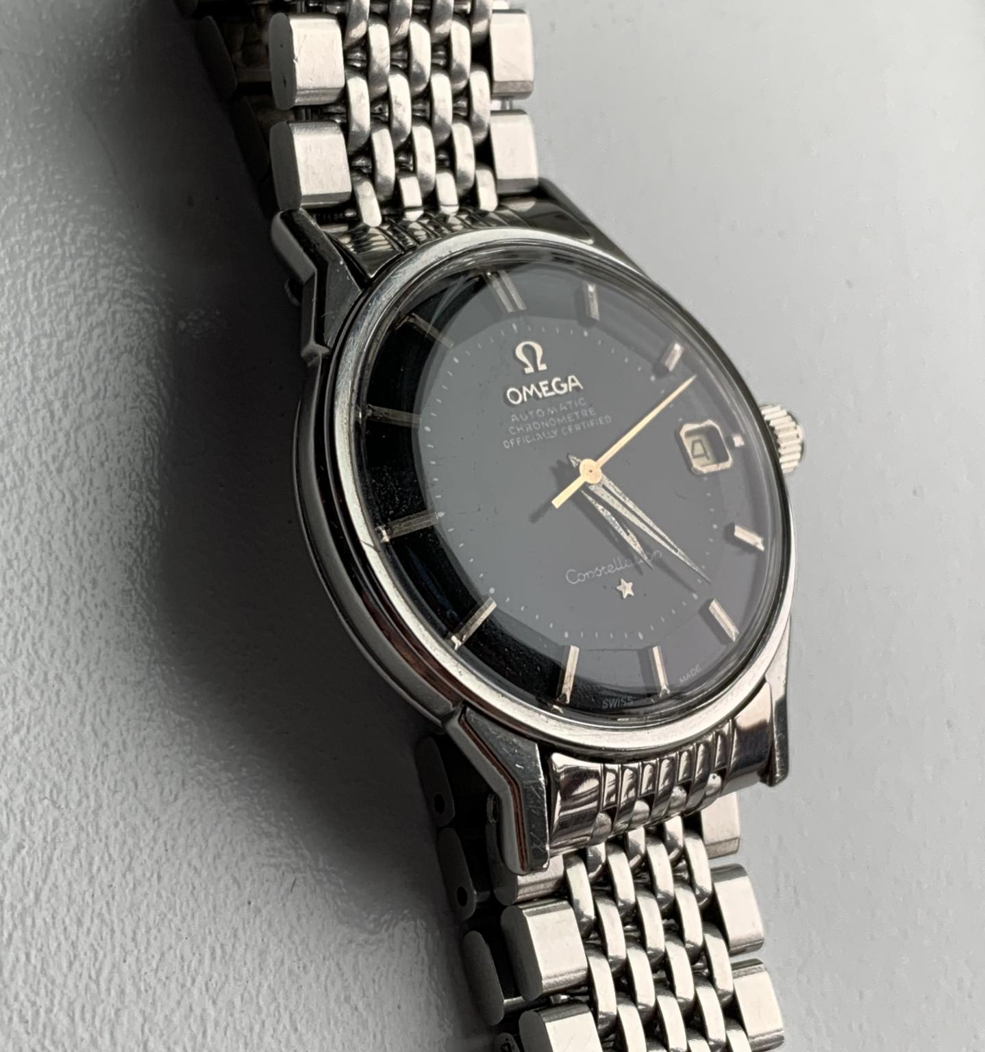

A better shot of the dial.
1,208
5,038
Just saw this on CWC. Yes bad redial. Overpolished case. Wrong crown. Suspect sweep second hand...
363
807
Yup you guys are right! It is in unfortunate condition.
6,832
10,502

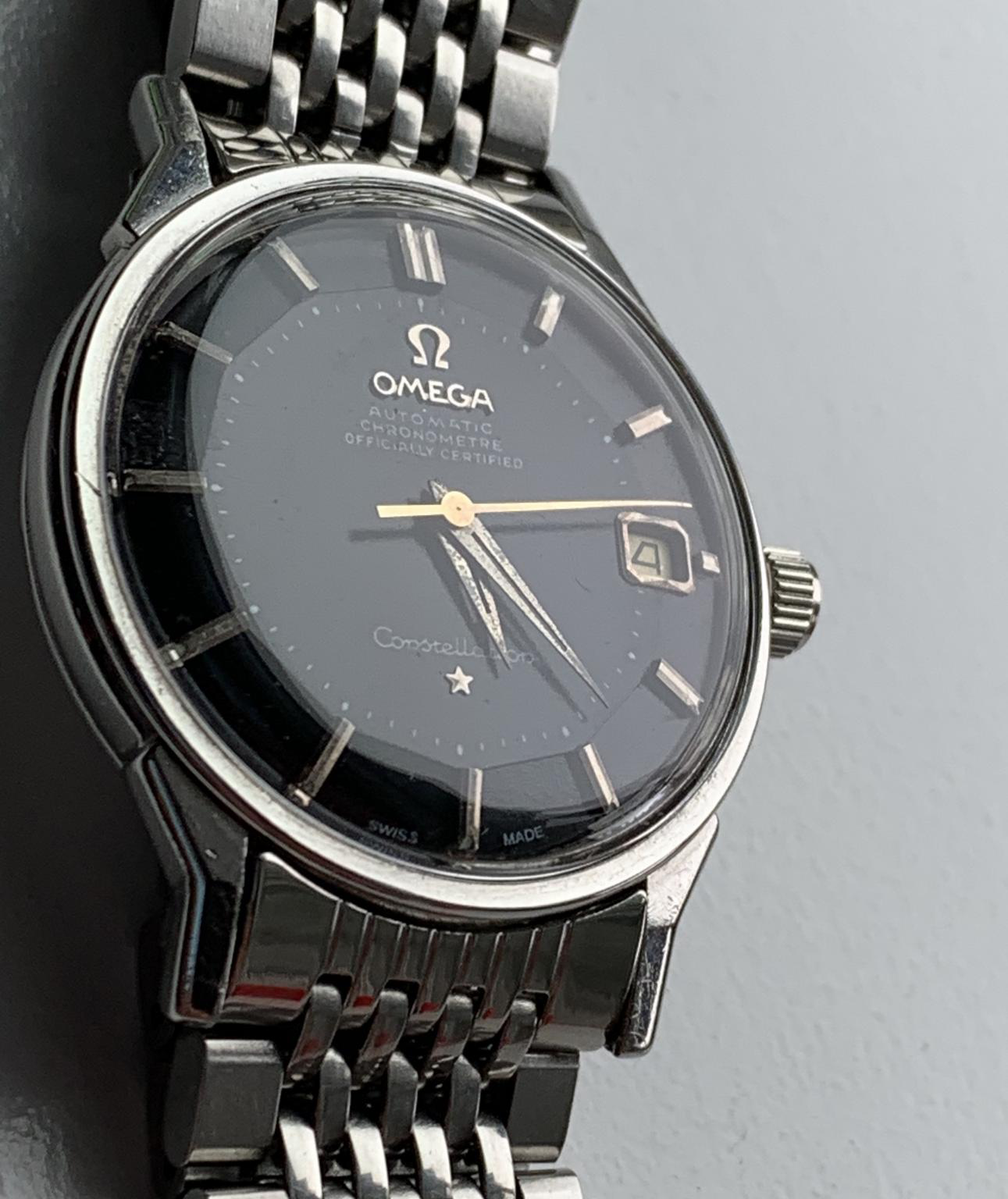

I was just looking at this, as it popped up in an alert, and was wondering if I should post it as an obvious example of a redialled black Connie.
So, well done @Xeer for posting.
to quote the seller “one of the most beautiful dials I’ve ever seen”
- either they haven’t seen many dials or they need new spectacles.
There are so many things wrong but even without looking at the script or the atrocious minute markers, the ‘orange-peel’ paint finish is the most obvious tell.
$2,400 for a heavily polished, redialled dogleg?
Just goes to show, not all Canadians are stand up guys. 😒
10,804
16,814
When you see RE on a dog leg (chronometer text) stop looking.
it was 90% likely to be a redial on the dial colour alone
912
4,429
That was my first thought! Glad to see I’m learning.
