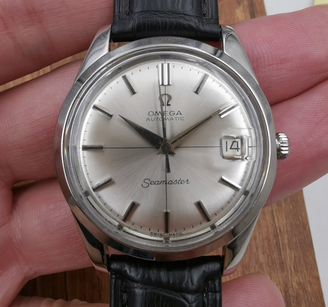

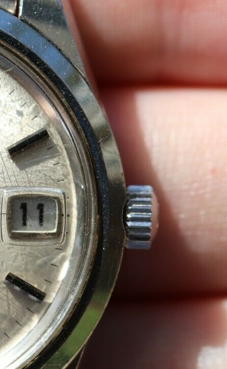

how do you think about this 166.010?
23
6
found this 166.010 on the internet,I can tell the crystal is not original. I think the condition is good, but I am not sure are all parts original ? help pls, thanks a lot !

Looks original and fine to me. Probably could use a movement service but that's pretty much expected with old watches. 👍
thanks mate ! l really like the crosshair dial

Yes she certainly does have a nice dial. Looks like the watch has been polished but that's also expected with oldies. 👍

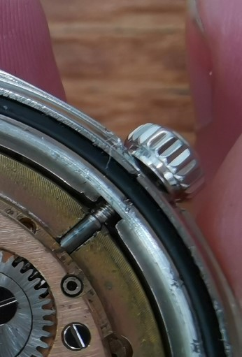

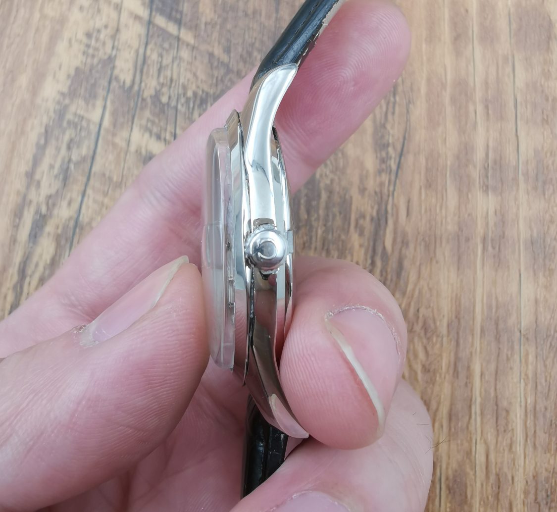

I don't like it:
Wrong crown, hour hand seems replaced [Edit: Minute hand, sorry], too much polishing, case corrosion/ damage and the movement - I don't know 😒
Looks like prepared for sale, how much is the seller asking?

I don't like it:
Asking for 630usd. may I know why do you think the crown is wrong?

Wait for other feedback to come, people have different opinions as you see....

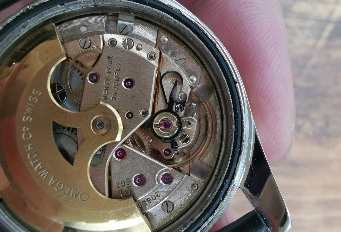

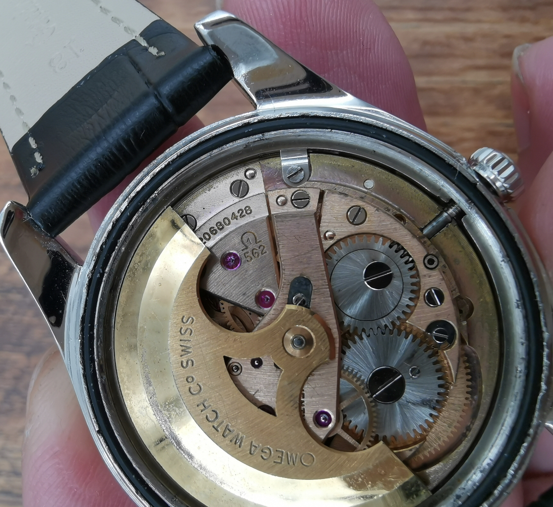

495
1,210
I'd run from that watch simply becase of the case being extremely over-polished. I'd also note that, while not a factor in+of itself, the rotor doesn't look like it matches the movement. A replaced rotor by itself isn't cause for concern, but given the rest of the watch, I agree with @Passover that this looks prepared for sale.
23
6
yep, I decide to pass it, since the crown is wrong

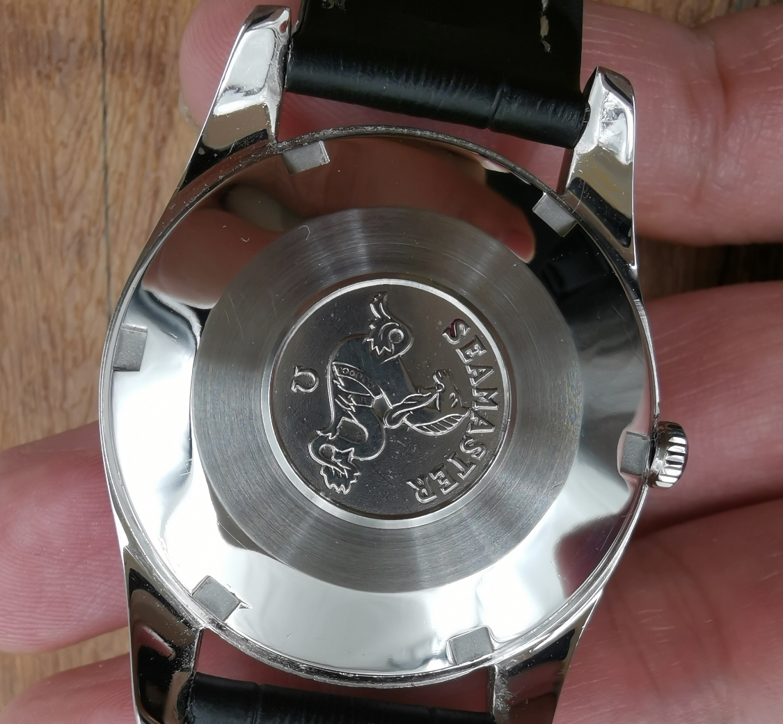

5,631
5,815
Polishing a case doesn't bother me when it's done right. That one, not so much.
