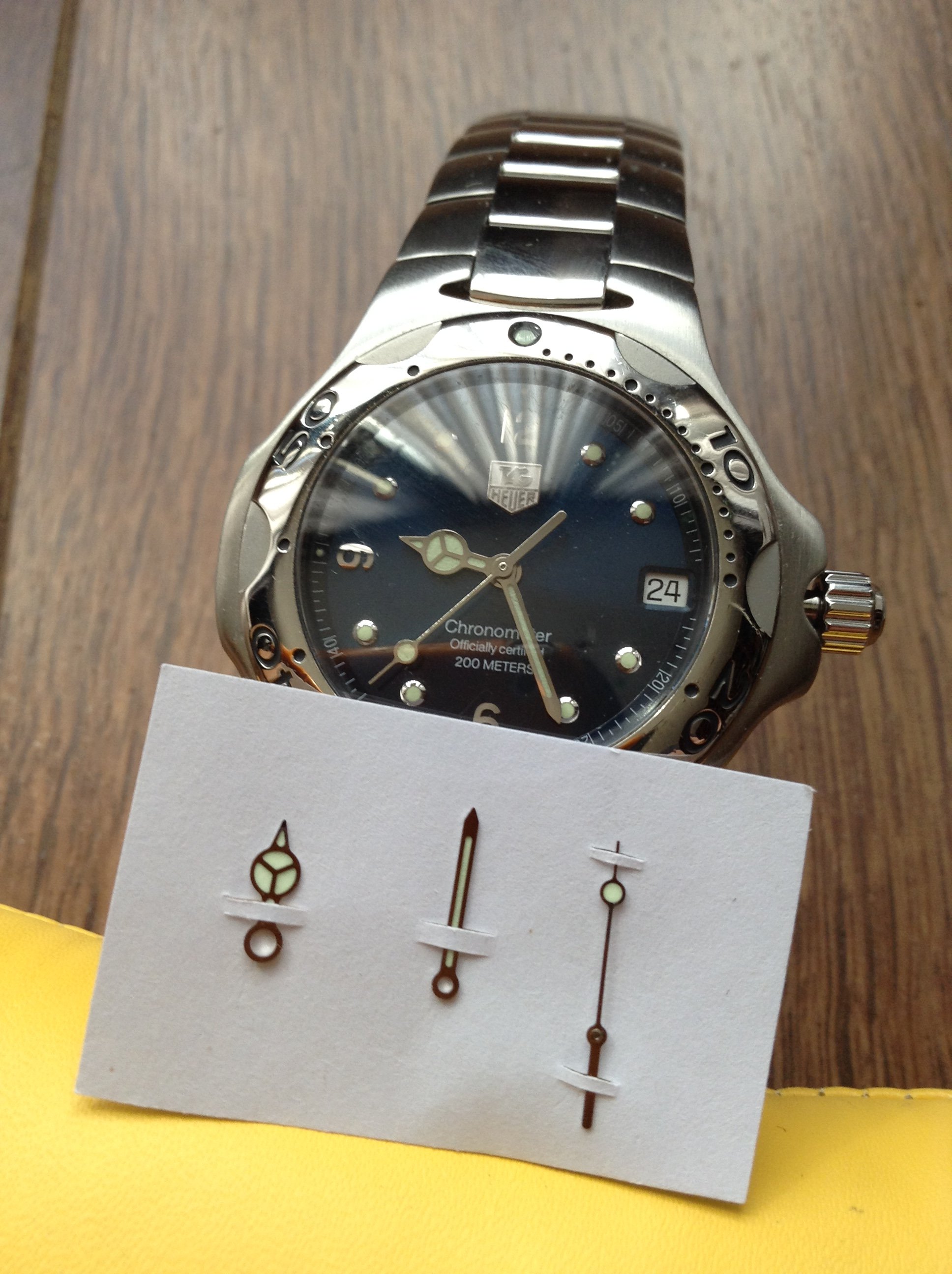

So recently I had my TH Kirium of 20 years serviced and they replaced the tritium hands with superluminova. I didn't know after the fact I say t swiss made t on the dial so got them replaced back locally.

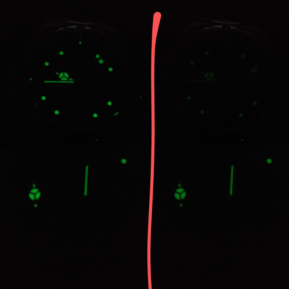

You can see the difference in the picture on the left, at full burst and on the right after 5 seconds, the glow on the tritium hands and the spare luminova hands.
I don't believe I can tell one from the other in your photo.
5,367
24,819
it's a side by side of before and after 5 seconds with the spare loose luminova handset at the bottom.
Maybe this helps.
6,863
22,205
Okay, so the Tritium hands and dial are actually on the watch, and the two photos below are the Luminova hands?
If that’s the case, then I wouldn’t be able to sort Tritium from Luminova from either the color nor glow. Do you have a photo that’s similar to the above, but after a minute?
5,367
24,819
The luminova handset is actually in the same shot together with the watch head on the left and right.

Are you sure that they replaced the hands with Super Luminova?
5,367
24,819
Are you that they replaced the hands with Super Luminova?
I assumed they would not have replacement tritium hands for a watch from '97/98. The later models Kirium came with luminova hands albeit skeletonized ones.
Also the t's disappeared from the dials on later models.
Plus the glow of the replacement hands is really strong for a few hours.

Not experienced enough to comment on luminous matching, here's a picture to compare in daylight (there is a slight greener tone on the new hands).
