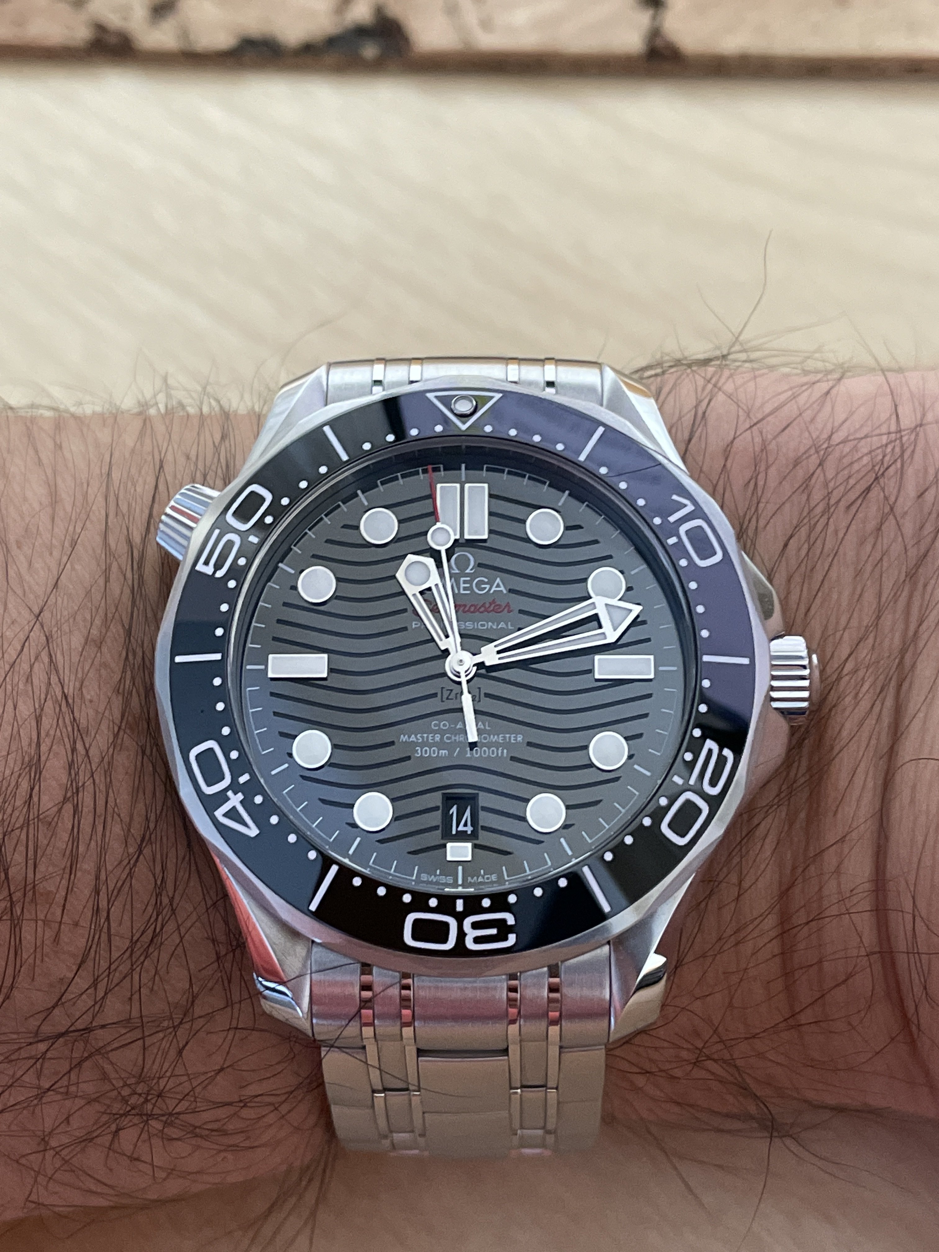

I know that you knew that, but this is a good opportunity for me to ask for photos of your watch!
Here you go. Extremely chuffed with it.
