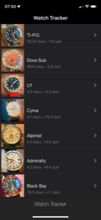

I am obsessive about tracking accuracy, but very tolerant of inaccuracy when it comes to vintage and/or non-chronometre certified watches. Any non-chronometre watch that runs +/- 30 sec/day is fine by me. I always keep watches that I wear set fast with respect to the correct time, and will tolerate up to 2 minutes fast before considering re-setting. On any given day I check the accuracy of 3 to 6 watches using the WatchTracker app on my phone.

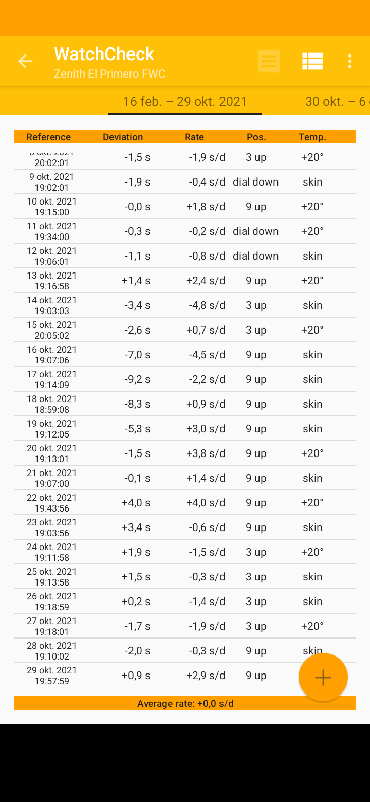

I keep track by going to Hodinkee homepage. Top right (indicated by my blue arrow) is a little dial. It gives me exact time and for those who have moonphase watches, the moon. Every Sunday night I use the same procedure for my clock. This past week it had not gained or lost a single second. The clock is dependant on temperature and humidity, I think.
Most of my watches are serviced and gain a few - up to 15 seconds - daily.
I guess I do care or I would not be doing this. Is it really important? None of this is. It’s a hobby.

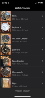

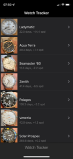

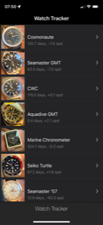

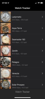

I don't currently own every watch shown here, but this should give you a sense of my tracking obsession 😀

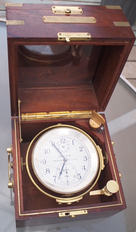

The only time I ever re-set this one is when I forget to wind it. I can’t tell you the accuracy in seconds ‘cause I don’t watch it that closely. But it is never as much as a minute out.

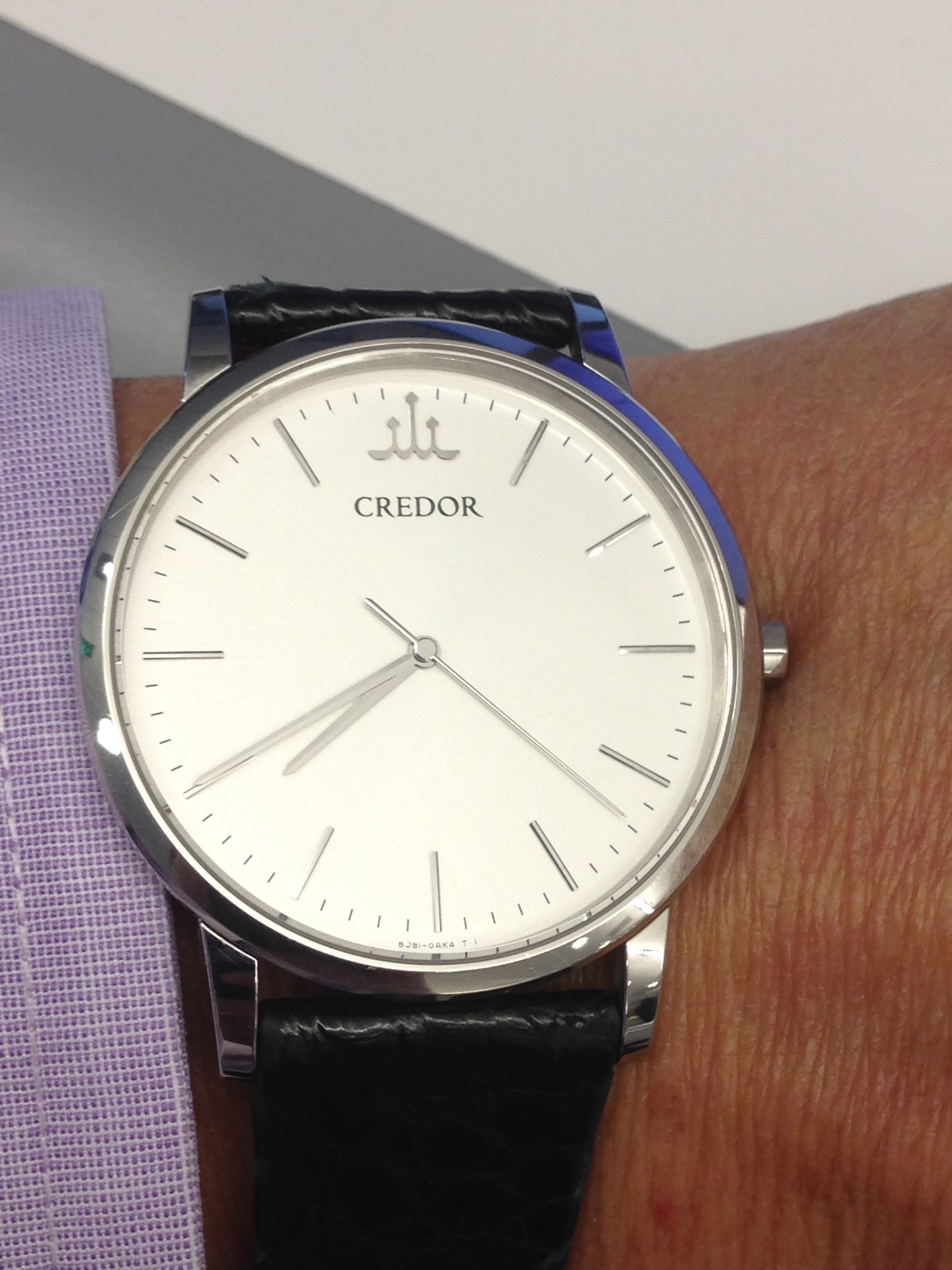

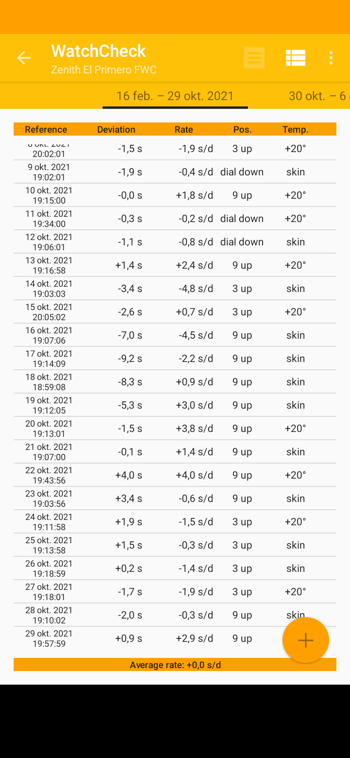

I always wanted a high accuracy watch for my daily wearer to help me not to be late to any commitment. I started with the Omega Constellation Quartz (+/- 1s/day or so) in the early 90's ...
then switched to the Credor GCAR045 about 8 years ago because of the claimed accuracy of +/- 10sec/year which I can confirm ...
after ~8 years of daily use (approx. +10 seconds/year). At DST time change in March (or November) I set my watch to be 4 (or 2) seconds slower than the gov time - https://timegov.boulder.nist.gov/ - so I know I won't be off more than 4 (or 2) seconds at any time (from -4 in late March to +4 in early Nov during DST, or from -2 in late Nov to +2 in early Mar during standard time) ::facepalm1::.
