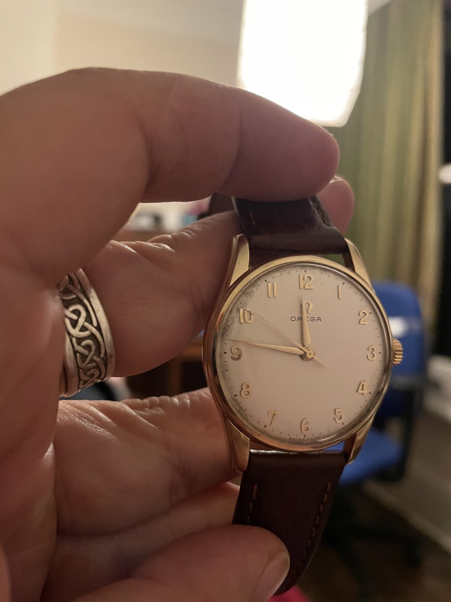

A couple of months ago I got a watermark in my previously pristine watch. Is there any way I can treat or remove it? It’s only at the edge, near the 8 and 10. Any ideas or suggestions? Photo attached.

Melanie,
Do you happen to know when the watch was last serviced?
Assuming it is water, then the watch may not be water-resistant anymore but the stains could also come from something else like an old gasket that is disintegrating or possibly some oil from the movement.
I am tagging @Archer our resident watchmaker to see what his expert take is.
PS: beautiful watch!
EDIT: I was just checking your resent posts and saw that you posted about an experience with “Armstrong Watch”. What was that about!?

First thing to do is to get it to a watchmaker for a complete service and to change the gaskets. If you “suddenly” got water damage on the dial, there is very likely water in the case which has potentially started corroding movement parts. As far as cleaning the dial, you really need to have a pro do this - even most watchmakers won’t touch this. You are likely to remove the paint/varnish and damage the dial if the cleaning is too aggressive.
But the key thing is to stop any further moisture intrusion.

That is unfortunate, when the dial was perfect before. I would not attempt any remediation of the dial.

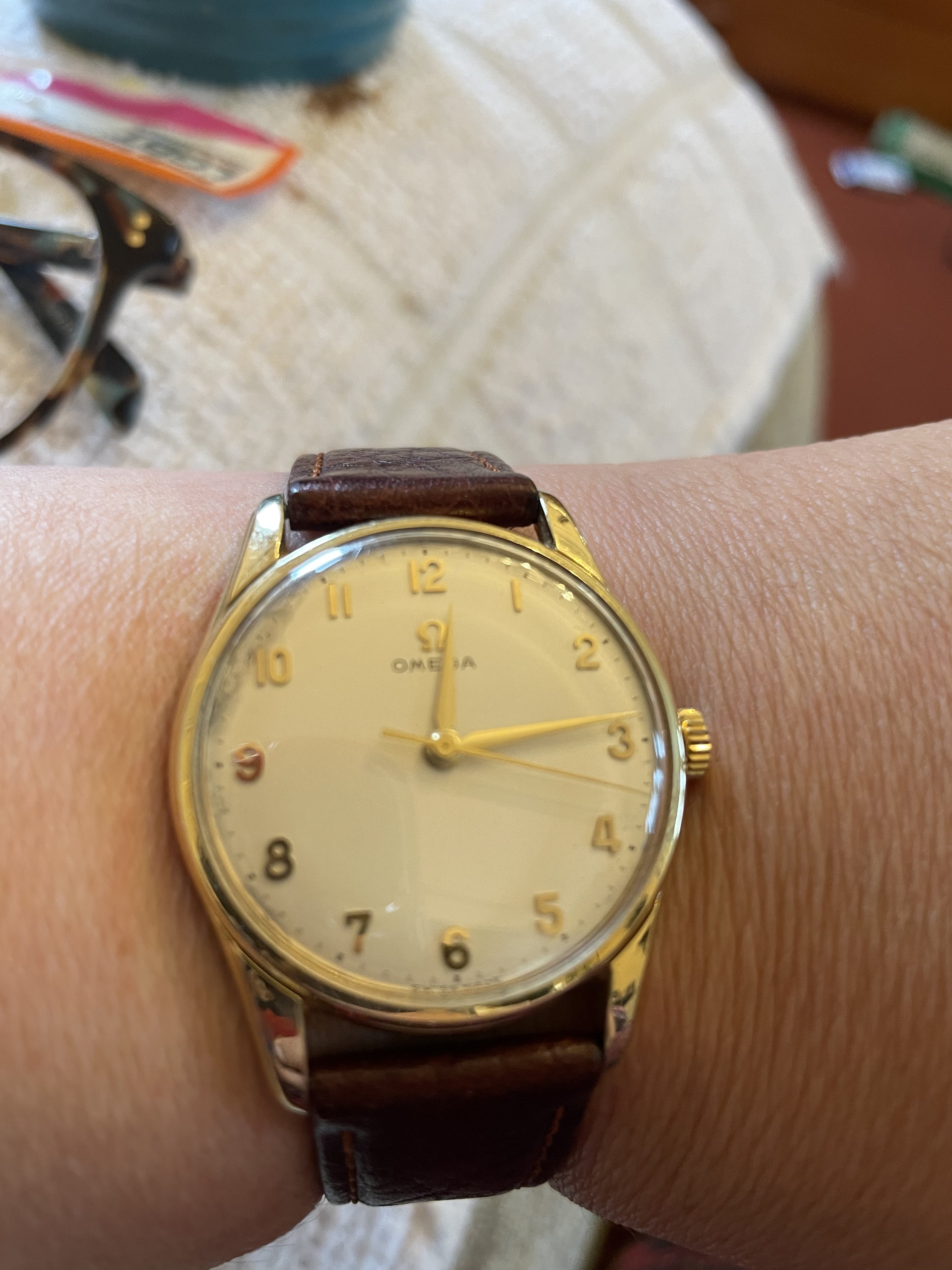

Thank you! Looking at it more closely I’m wondering if the watch face was repainted at some point and that what I’m seeing is partly that paint flaking off? Clearer photo attached. It is solid 9ct gold with original winder.

It could be something on the surface, but more likely the water has gone under the top layer of finish.

That is probably all you are seeing right now when you look at the watch. What I see is a mostly nice dial. Moisture and watches can be a bad mix. It remains a nice looking gold watch to my eyes.

That's unfortunate. I don't know of any reliable way to fix something like that. Give it some time and see whether the watch still gives you joy.
