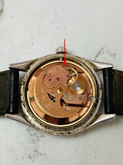

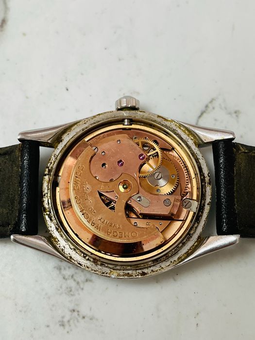

M Posts 10 Likes 5 Mart2436 ·Sep 20, 2022 I'd like advice on how to release the winder on my 50's Seamaster 2802? Thanks all.

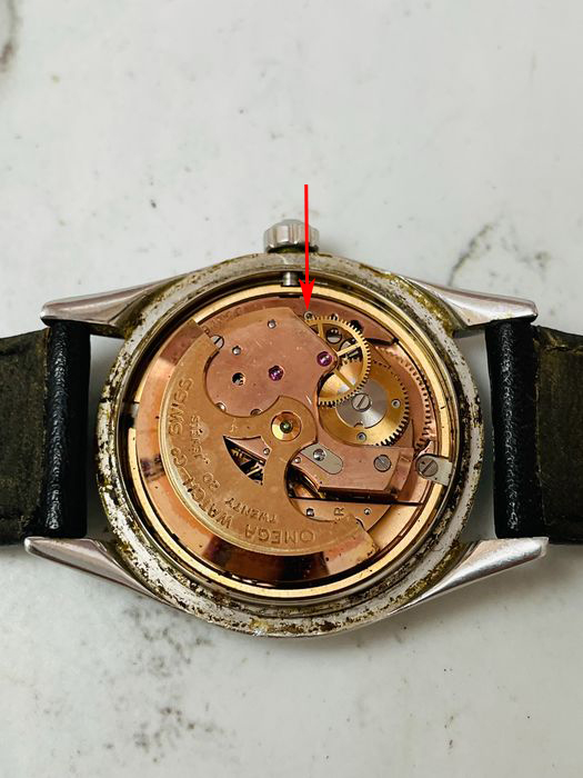

Posts 13,489 Likes 31,801 X350 XJR ·Sep 20, 2022·Vintage Omega Aficionado You need to press down on this little button while simultaneously pulling the stem/crown out.

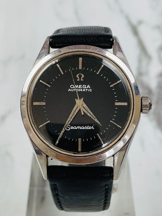

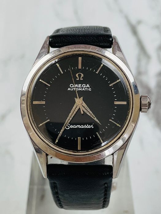

Posts 5,660 Likes 9,496 watchyouwant ·Sep 20, 2022 Your Dial is a repainted one.... Like many other black ones.
Posts 24,797 Likes 55,079 Dan S ·Sep 20, 2022 watchyouwant Your Dial is a repainted one.... Like many other black ones. But he still presses down that little button to release the stem, right? 😁
Posts 403 Likes 2,383 JayBe ·Sep 23, 2022 It would be maybe worth mentioning that you should pull the crown out all the way, before pushing the button and releasing it. Otherwise you'll have problems getting it back in.
Posts 3,578 Likes 13,519 MtV ·Sep 23, 2022 Also, it does not need a lot of pressure. It’s a delicate mechanism.
