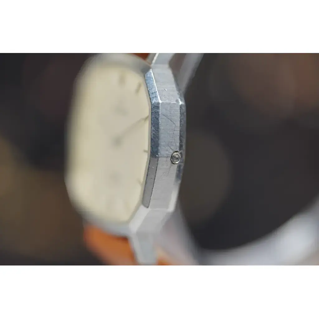

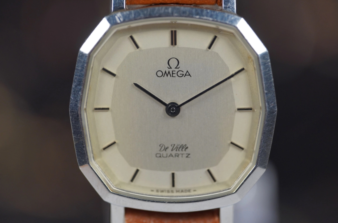

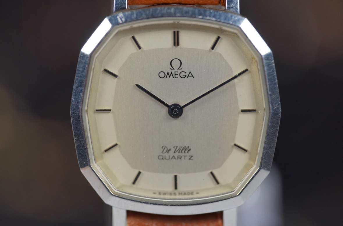

Can someone tell me how to change the time on my Omega de Ville. She does not have a traditional winder.
I’m worried about breaking her if I poke something in the tiny hole.

This one doesn't have the traditional crown and stem, has a small "button" you press with a stylus/toothpick/paper clip to set the time in sequential presses.
Chances of finding one on the open market are slim to nothing.
You will need to go to Omega to see if they are able to repair it with a replacement.

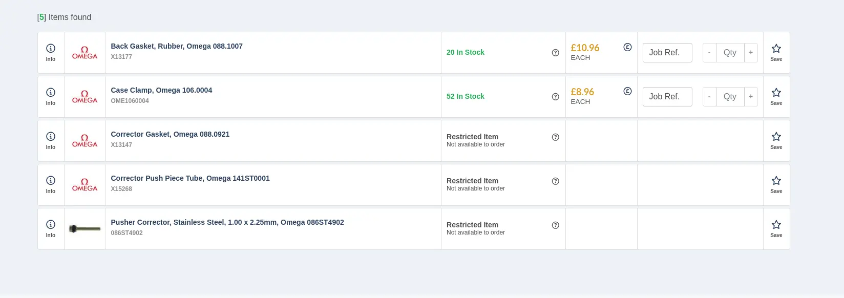

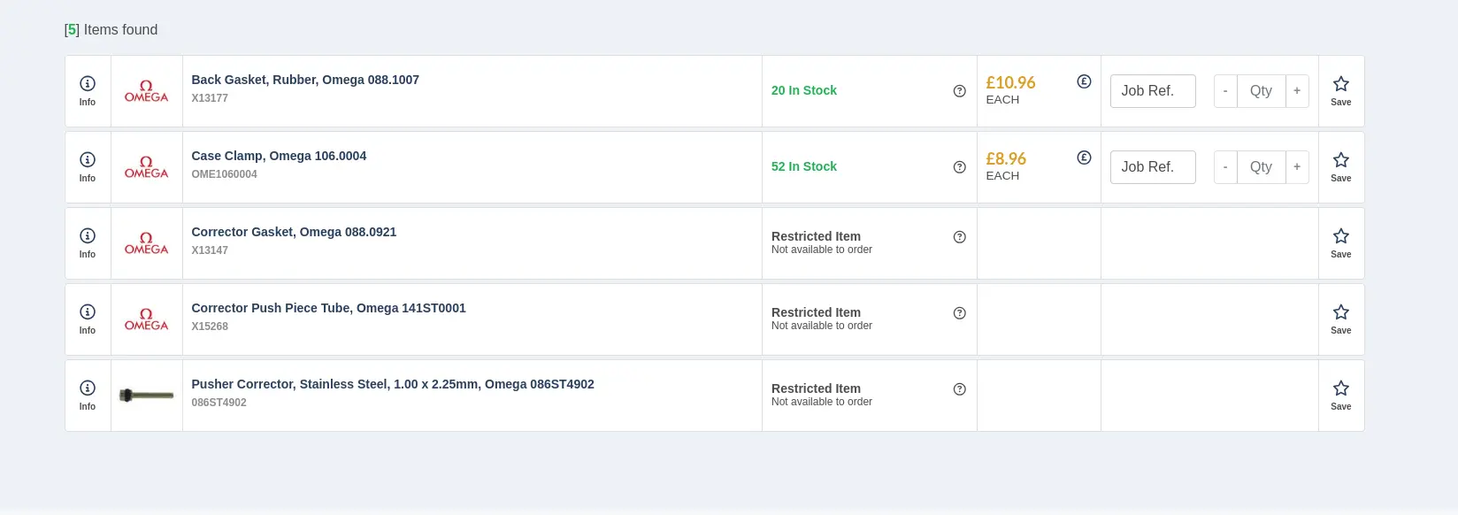

I searched the cousins website for case parts that go for your watch ref. 591.0103. https://www.cousinsuk.com/category/filter/omega-case-parts I am not expert, but it looks like you need the pusher corrector, pusher piece tube and corrector gasket. Cousins no longer has these, but an Omega Certified Watchmaker might be able to get them if they are still available from Omega. Perhaps @Archer is willing to look that up for you.

Still available from Omega...
086ST4902 | STEEL PUSH-PIECE Ø 1.00 L 2.25​
141ST0001 | CARTIDGE FOR CORRECTOR​
