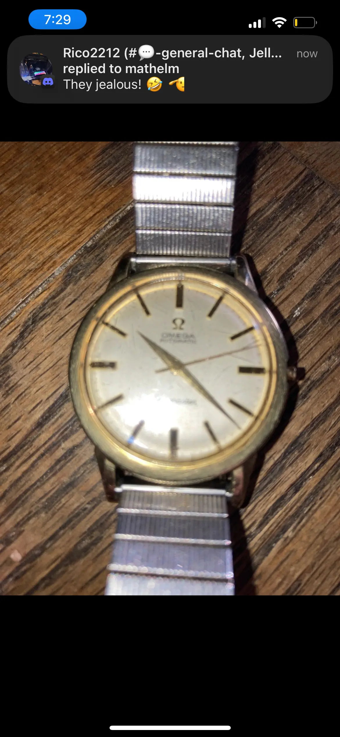

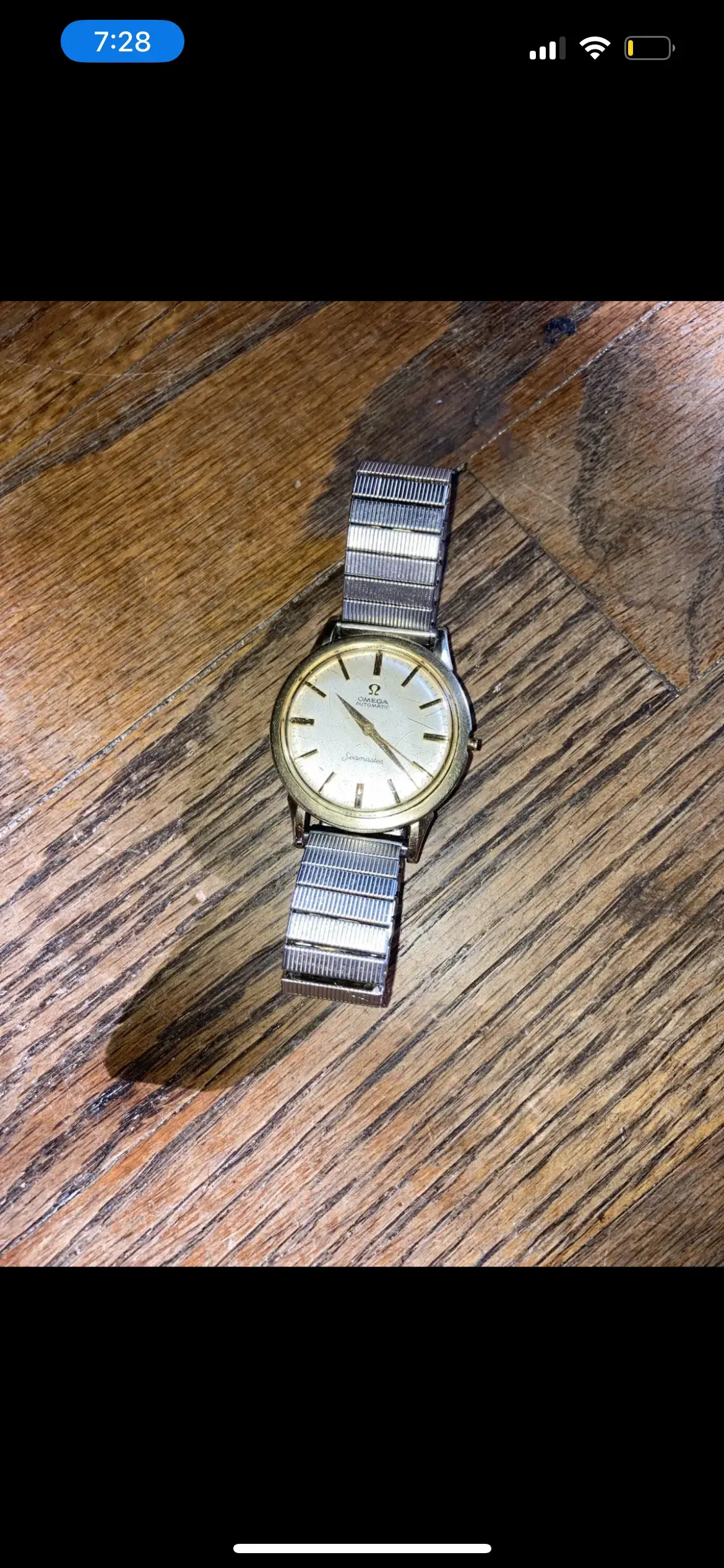

I picked this up for 386 out the door. What do you guys think ? How hard is it to source and fix a crown ? Will I have to replace the stem too or can just the crown be done ? Assuming it runs and keeps good time what do you think it’s worth ? I also don’t really like the bracelet, I think I’ll replace it with a regular brown leather one. I have 14 days to return it, so that’s always an option if I get it and it doesn’t work or needs more repairs. I would love to hear any thoughts

The photos are absolute crap so hard to tell what it is, but it looks to be in pretty rough shape. It might be the pictures, but it looks like a worn-gold plated-down-to-base-metal watch? Also, the crystal is pretty bad, probably beyond what you'd want to do with polywatch.
Anyway:
Strap: worthless.
Watch itself in 'fresh-serviced' condition is worth ~$600 in great external shape. Based on the photos, I'd say its worth $400 in fresh-serviced-fully-functional condition.
It isn't possible in the pictures to see what it is missing, but I'll bet you need crown + stem. HOWEVER you probably also need some work done (even parts!) on the keyless works thanks to the fact that the crown/stem fell out. Additionally, just based on condition/that effect, I'd say it needs a full service, plus probably quite a few parts. SO, to get up to that $400 or so, you need:
1: crown + stem: Looks like you'll pay about $75-80 for one of these in 'well used' condition, figure an even $100 minimum for something nicer.
2: Crystal: Generic crystals are about $30, probably pay a watchmaker ~$50 to do so.
3: FULL Service: A full service on this is going to start at about $300. I'm guessing based on its condition that it'll need parts, so probably at least $100 in parts, maybe multiples of that.
SO to answer your question: The max this watch could be worth is ~$400. In order to do that you need to spend $75 + 80 + 300 = $455. From that analysis, I'd say this watch is worth about NEGATIVE $55.
IF you were a watchmaker/did repairs yourself, you could obviously save $350, so a hobby watchmaker might be willing to spend ~$150 on this at most, but for that, you'd need much better pictures.
SO: $386 out the door is, IMO, a VERY bad deal. You overpaid by about $500.

Further info:
Closest comparison I could find is this MUCH nicer 565 movement watch (which yours is clearly not, since you don't have a date, I'm guessing you area caliber 550): https://www.ebay.com/itm/267416632852
It was sold for $330 as not-running, but with a MUCH nicer case, and an obviously complete movement in need of service as well. I'd say what you have is a significant downgrade in about every way from that one.

Firstly, 386 what? £/$/€/bananas?
It’s impossible to give any meaningful assessment based on the photos. It’s looks gold cap so the condition of the gold layer will have a significant impact on value. If it’s poor the value could drop by 50%. Or is it solid gold?
Same with the dial, if the dial has any ageing or major marks then price is reduced significantly.
I also don’t recognise the case and wonder if it’s perhaps a locally made case.
So in the current condition, assuming the dial is ok and the case is ok, I’d say it’s worth between £250-350. Condition will have a major influence on this.

yea we will see when I get it in my hands. Like I said I can always return it. According to the seller it’s runs well so I figured I would take a shot on it and just return it if it doesn’t work or needs too many repairs.
