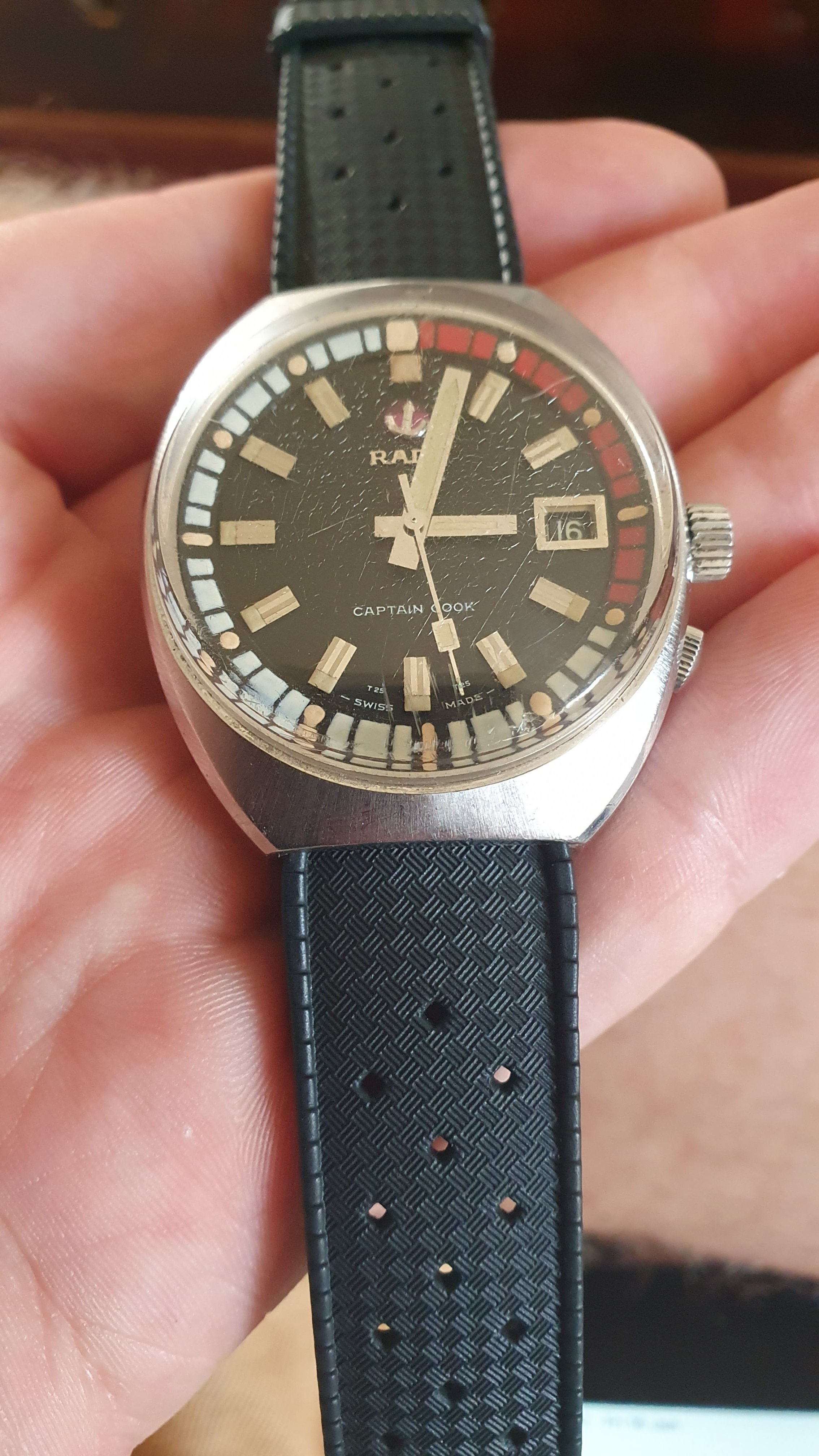

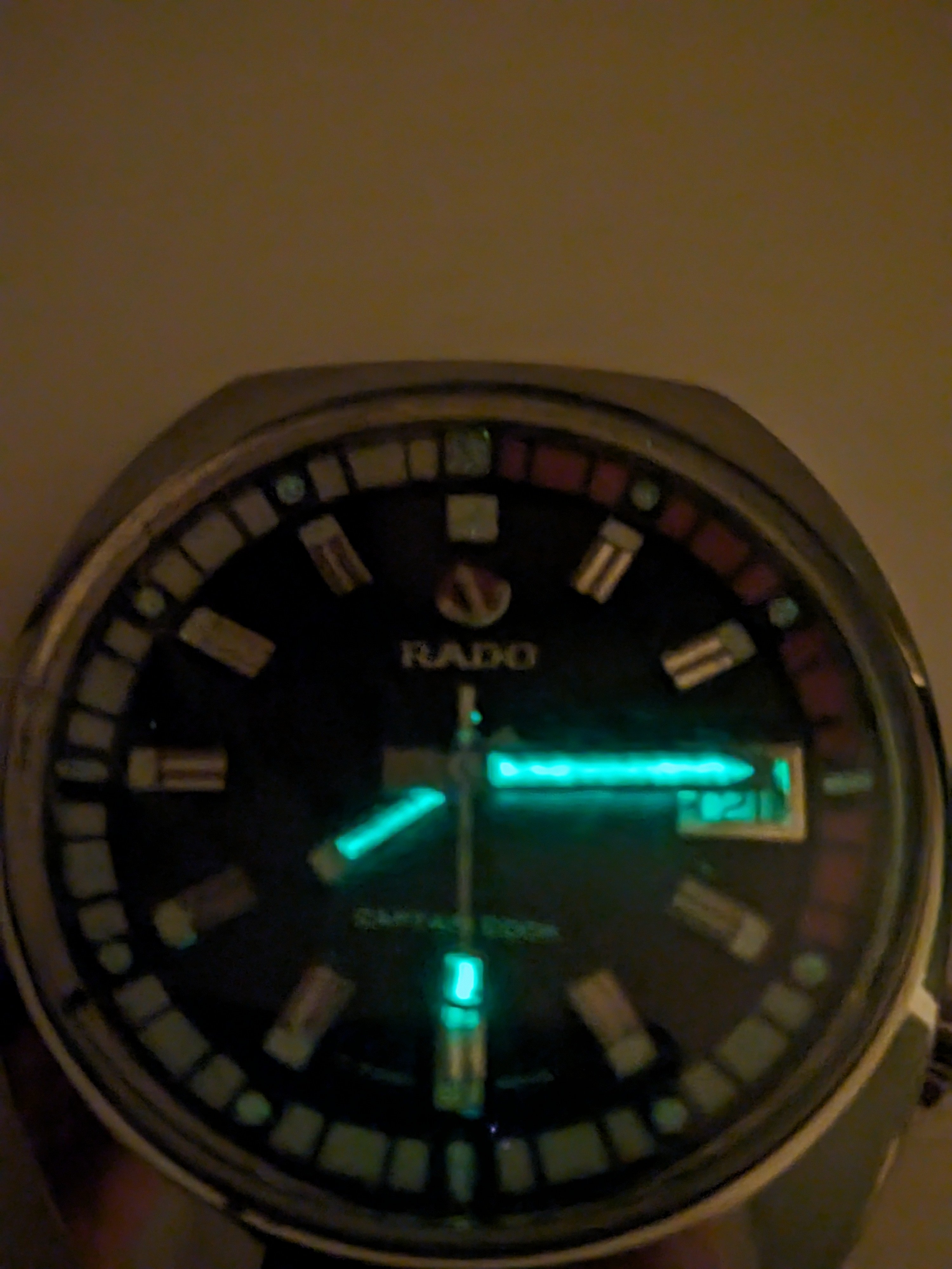

I bid on a Rado Captain Cook late at night as I was falling asleep. It was a token bid that I didn't expect to win. Unfortunately, my bid prevailed. In the cold light of morning, as I took a better look at the single (!) photo of the dial in the listing, I was pretty sure I'd made a mistake.
And now questions remain: what's original and what's not on this thing?
Thoughts:
- The case and caseback look correct to me.
- The hands look correct if in rough shape

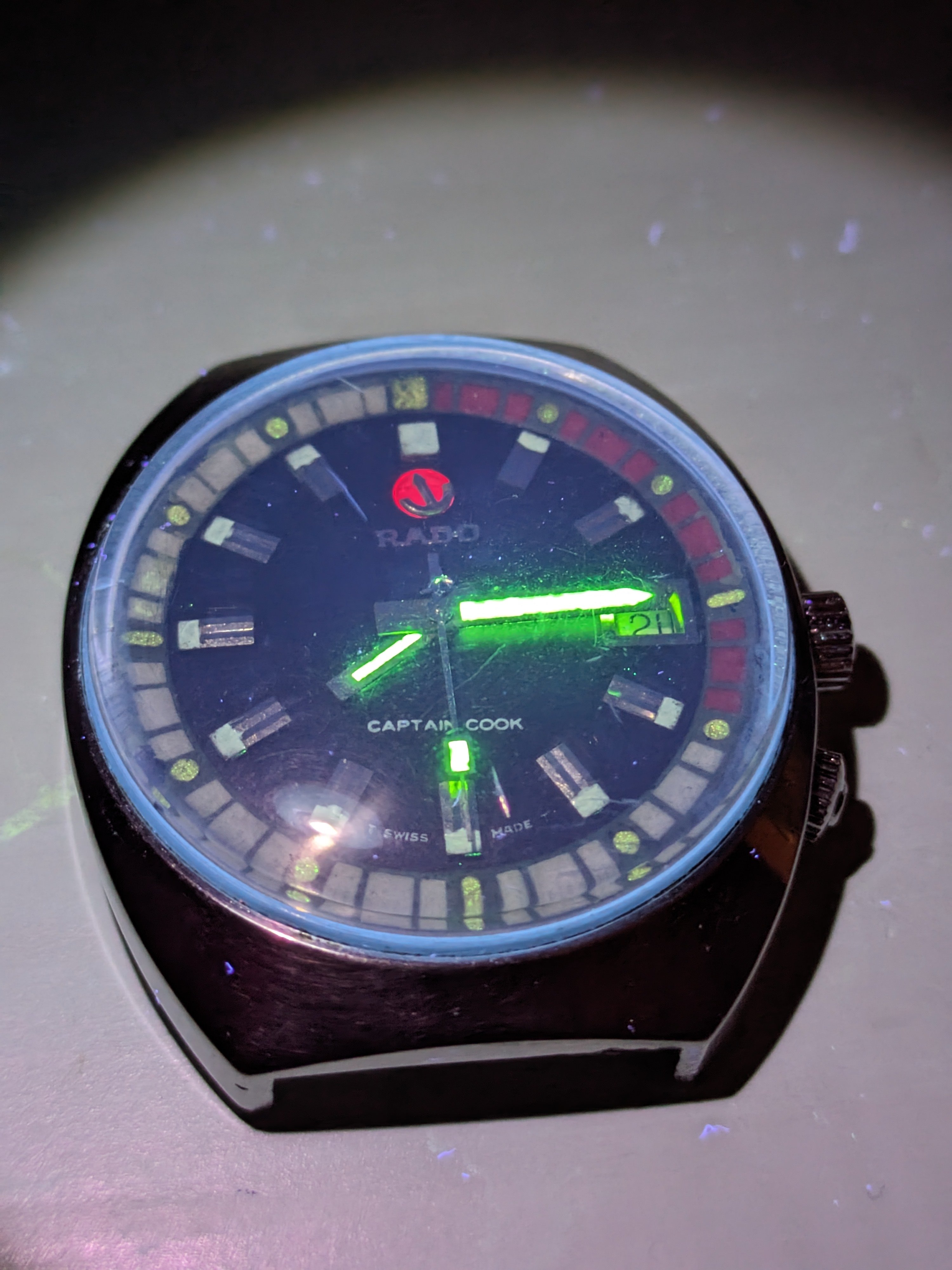

- The bezel insert turns and I see faint traces of reaction to UV light - they fade VERY quickly. The bezel has damage and the painted indices look sloppy to me.
- The dial indices have no lume. This seems wrong to me, but I couldn't find a vintage lume shot online.
- The 'T Swiss Made' on the dial doesn't match some of the examples that I see online - I see some that are similar, but not sure if those are legit either.
So, what do you think: did I scrape a mostly original example from the bottom of the barrel, or is this thing a horrible made up franken?

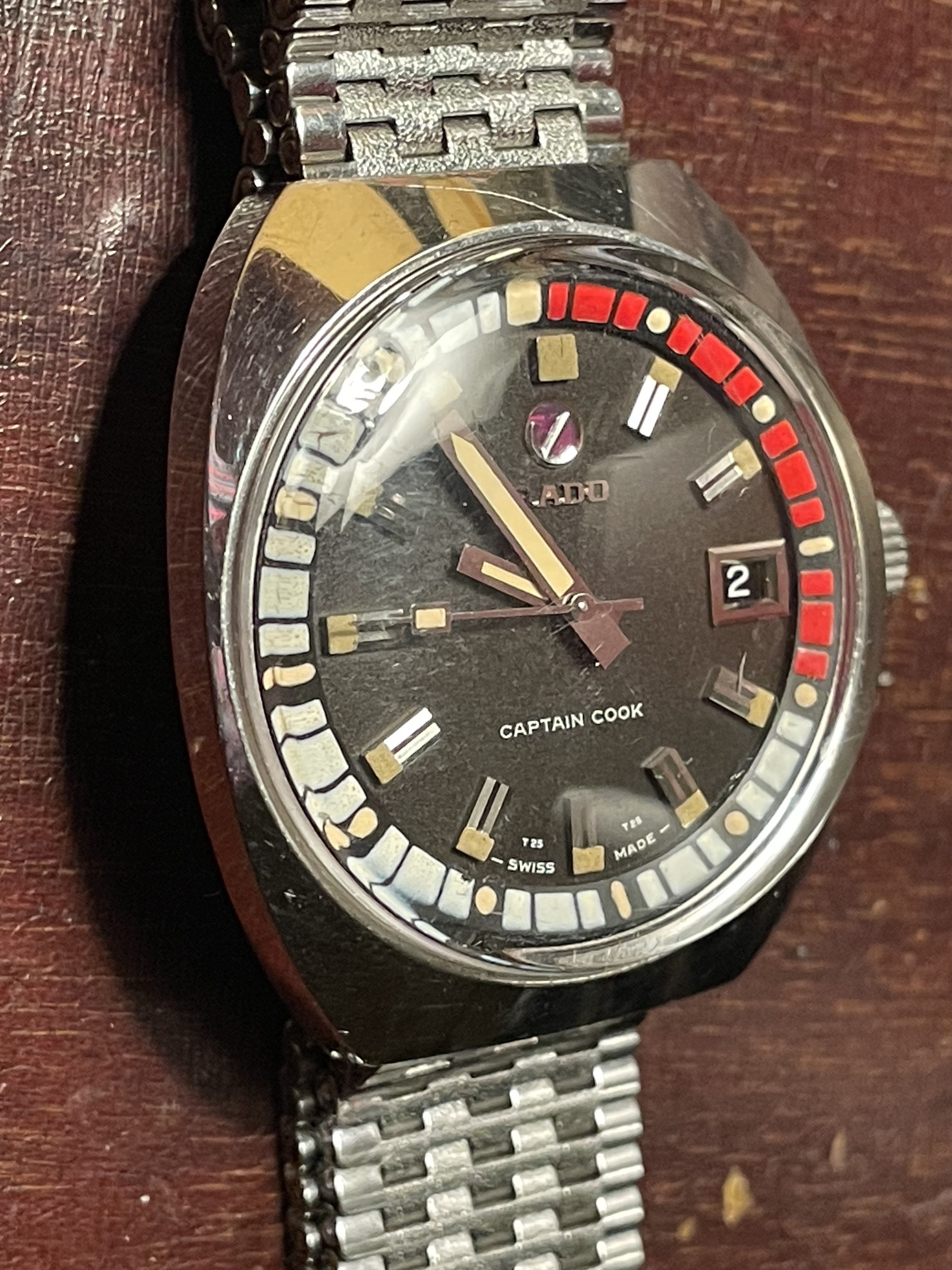

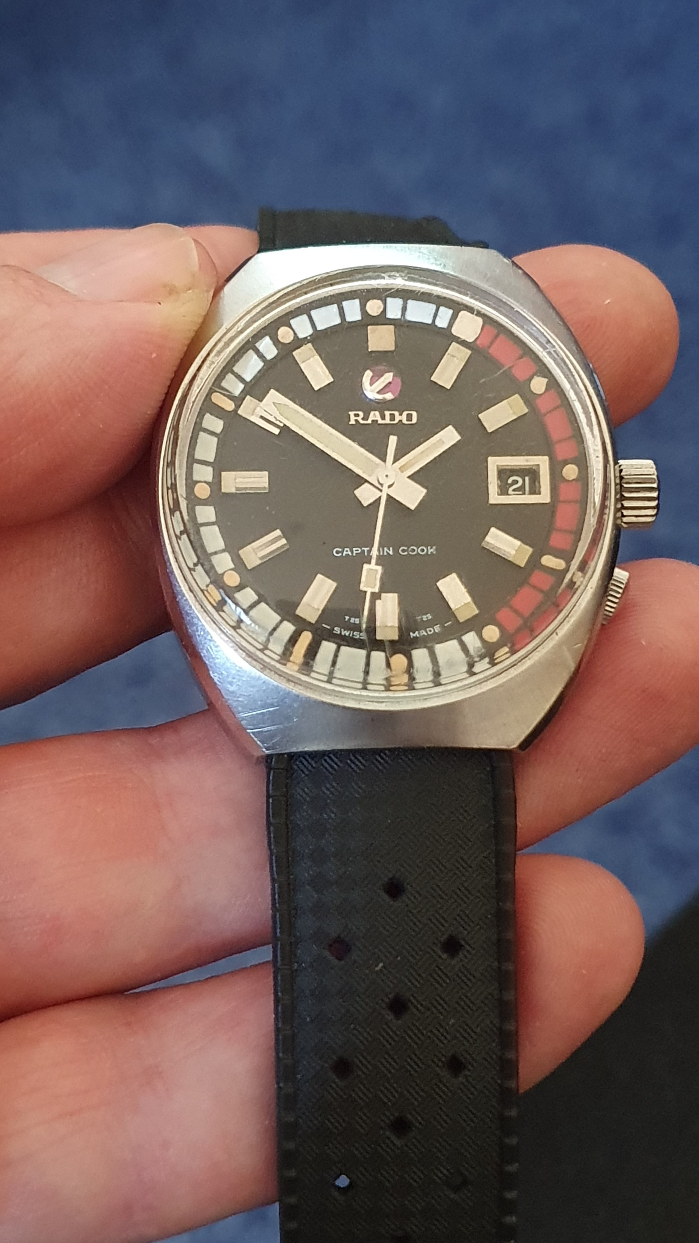

Mine for comparison
Sorry for the horrible glare- dresser lamp was best I could do on short notice

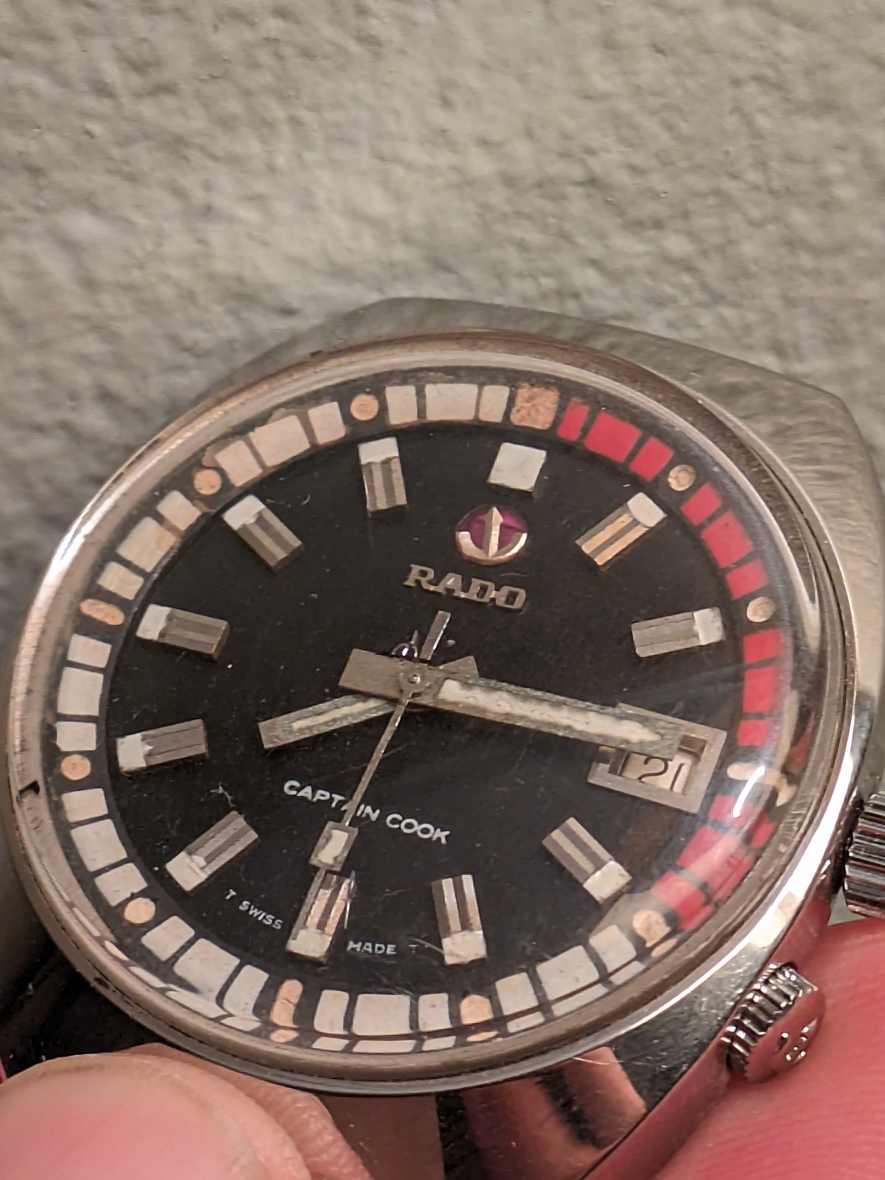

Mine for comparison
Thanks! I appreciate it.
So, mine looks like redial of some sort and the wrong date wheel to say the least?
16,305
45,025
I wouldn’t say redial, hands look relumed and the lume on the dial is brittle so possibly some plots were missing and whomever relumed the hands just removed the rest to match. But all is not lost- if you got it cheap enough and it’s serviceable, there are a few vendors on eBay selling nos hands and dials on eBay. These were abundant in the east as were well stocked Rado service centers so the parts are pretty abundant.
Yours looks to have the factory crowns and case looks decent so that’s a good start.
Thanks! I won it with a sleepy, ill-conceived bid of $250, so maybe that leaves enough room to sink more money into a project watch 😒.
I guess it's time to set up some eBay alerts.

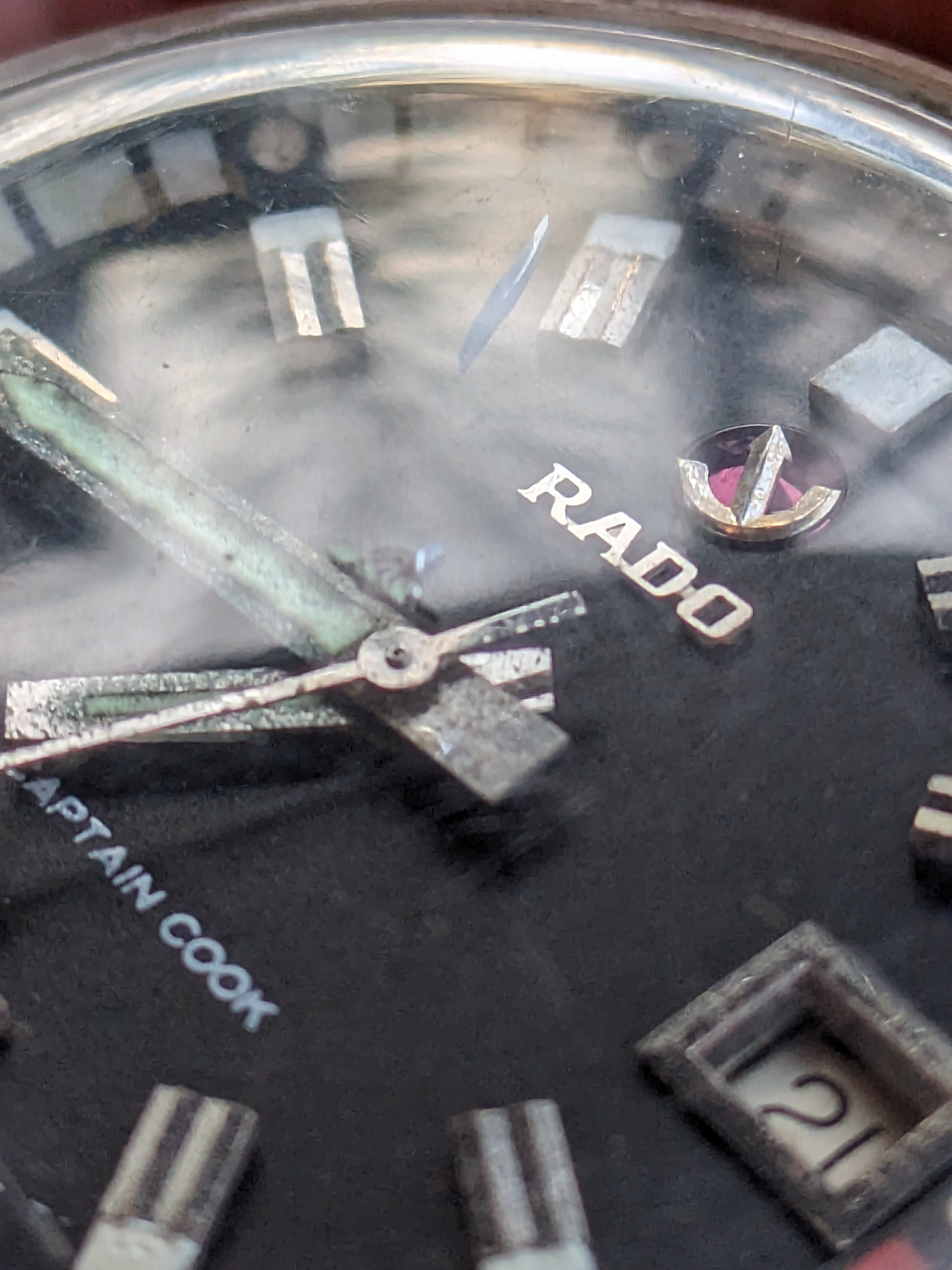

I have this watch too. I've never been sure about the bezel, the markers seem quite sloppily painted, but looking at other examples, maybe it's ok. The crystal on mine is crazed and needs replacing...I've been looking for a new one for a while, but no luck yet. The crystal has a little anchor logo which you can see with a loupe.

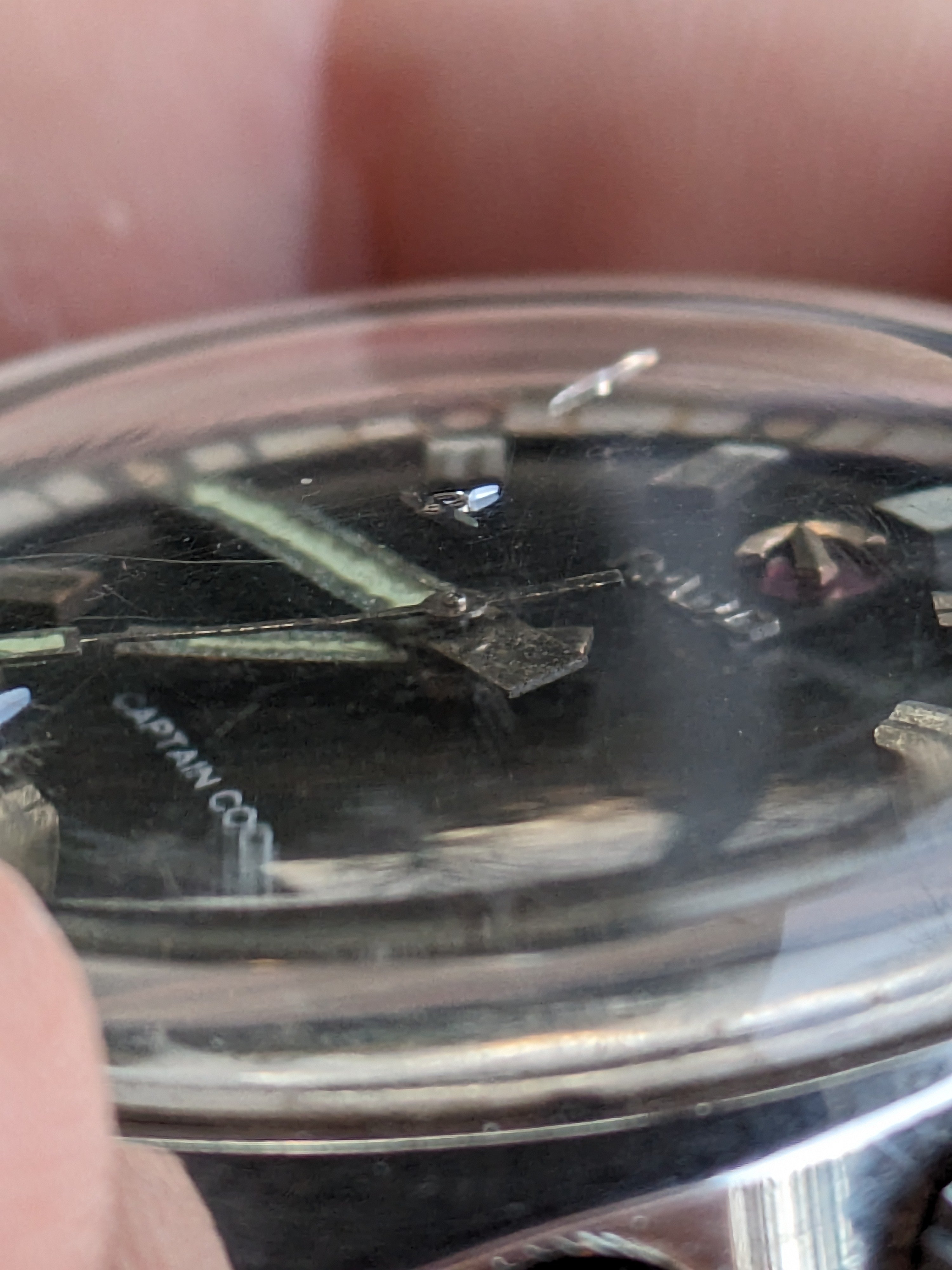

I went to go see if my crystal has one, but results were inconclusive. There's a bit of a problem where the logo might have been 🙄
