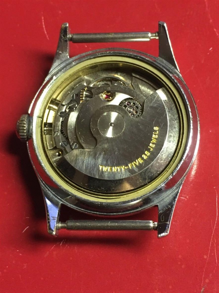

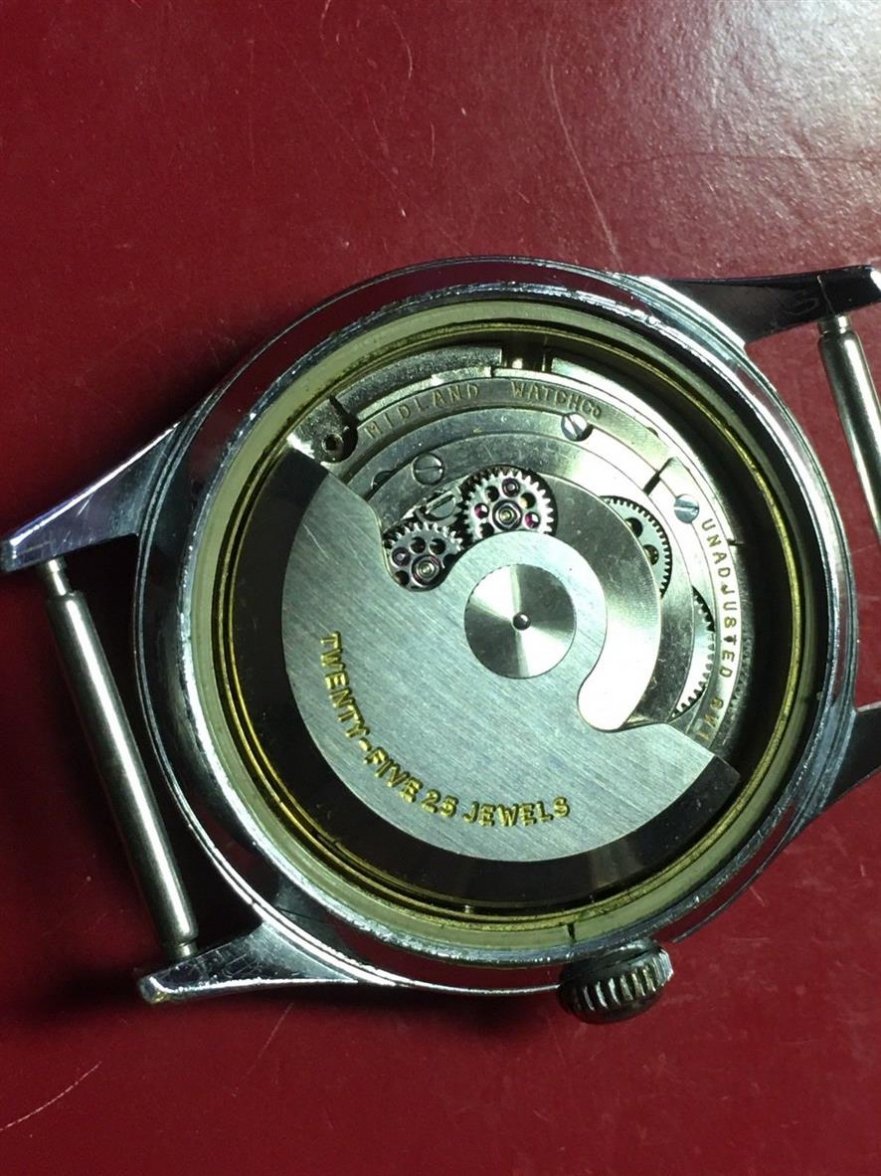

What can you tell me about this Movement a ETA 2453 25 Jewel automatic?
Are some jeweled bearing missing from these wheels?
What do you want to know?
What makes you think anything is "missing"?
Anything you can tell me would help.
Haven't found anything on the Midland brand, only thing I've found on the movement was that Hamilton used the 2452 calendar version with some of its products and the series , at least the 52 and 53 variants ,was well respected and popular. Sounds like a high quality movement.
If you'll look closely at those wheels one appears to have four jewel bearings while the other has only two . Seems like if these were intact they would both have four or more evenly spaced. Perhaps all the holes filled with bearings.
If there are 25 jewels in the self winding variant and the basic movement is a 17 jewel then four bearings on each wheel would add up to 25 jewels total.

Sorry, but unless you have specific questions, there's not much I can help you with. It's a pretty common movement used in it's day, and part of the 2450 family.
Remove the 2 screws holding the automatic bridge in place, unscrew the rotor from the underside (1 screw) then turn the eccentric and remove the reversing wheels. You can look for yourself then...

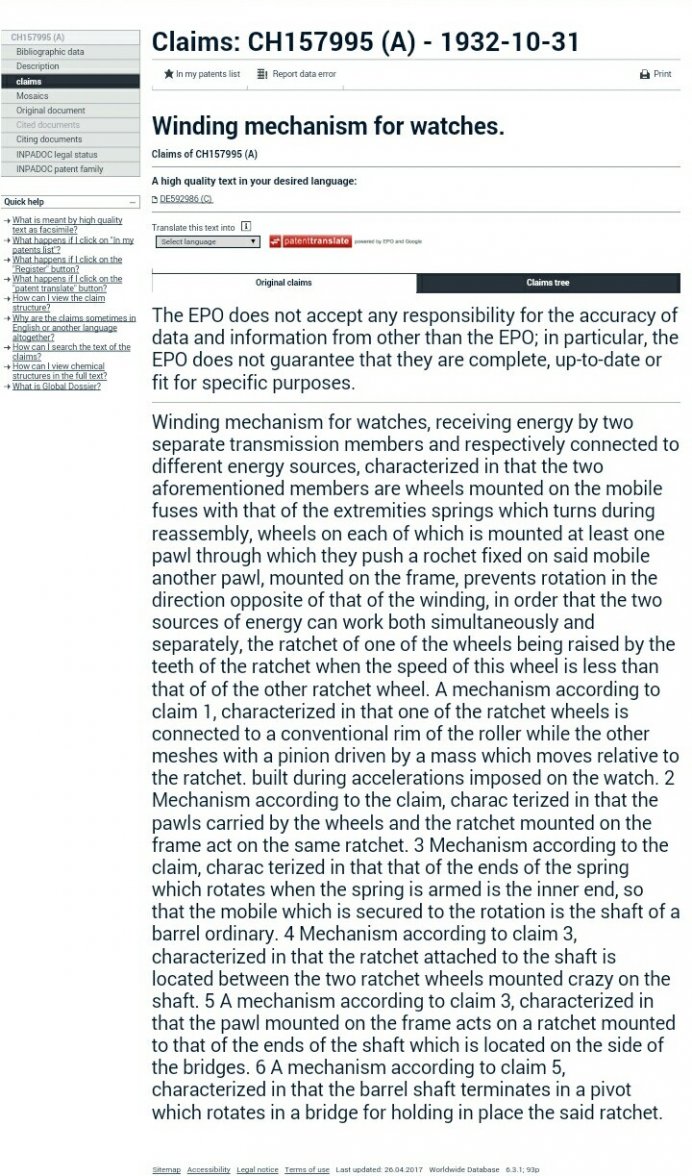

Regarding the winding method made (or not) by Rolex, I too was told that they have not given any proof.
After looking at their first patent though, and viewing a translation from the French (given on the Espacenet search site), it appears to clear things up a little.
https://worldwide.espacenet.com/pub...KC=A&FT=D&ND=3&date=19321031&DB=&locale=en_EP
As you can see, the claims mention two methods of energy generation, one in the conventional way i.e. the crown, and the other being a: "pinion driven by a mass that moves relative to the ratchet,
built during accelerations imposed on the watch."
The 'mass' being the rotor weight , and the 'accelerations' the spinning of it during movements of the watch.
That is my understanding, but YMMV. 😉

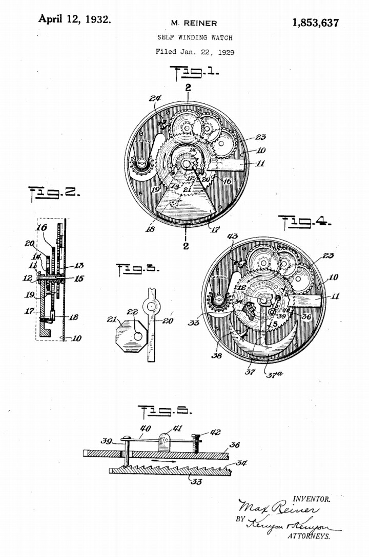

Here is a patent issued earlier than the Rolex patent for a non-bumper rotating automatic watch.
Max Reiner patented four self winding watch patents between 1931 and 33, all registered the PERPETUAL SELF WINDING WATCH CO. Of U.S., owned by Emil Frey.
https://patents.google.com/patent/US1853637?oq=self winding watch M. Reiner
I posted these and other auto patents here:
https://forums.watchuseek.com/f11/self-winding-wrist-watch-patents-1817074.html

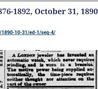

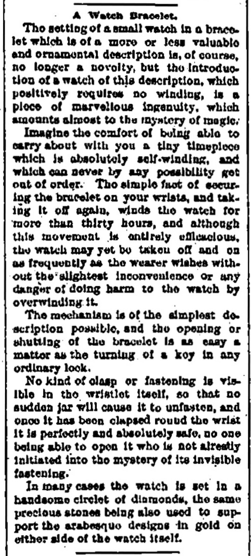

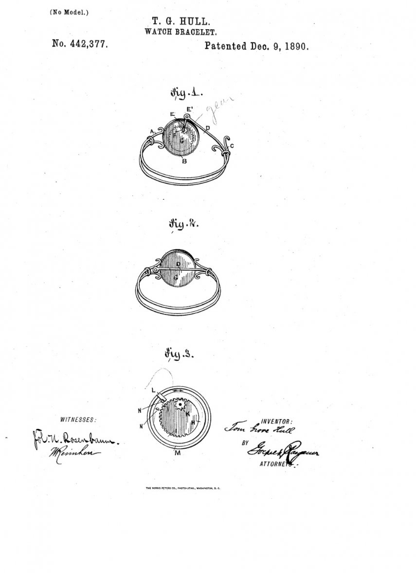

I even discovered a patent and newspaper articles concerning an 1890 patent for a 'self winding' watch not before known.
As can be seen in the patent diagram, it was wound by the opening and closing of the bracelet, very ingenious if not exactly 'self winding' as we know it!

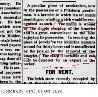

Here are three of the 1890 newspaper articles.

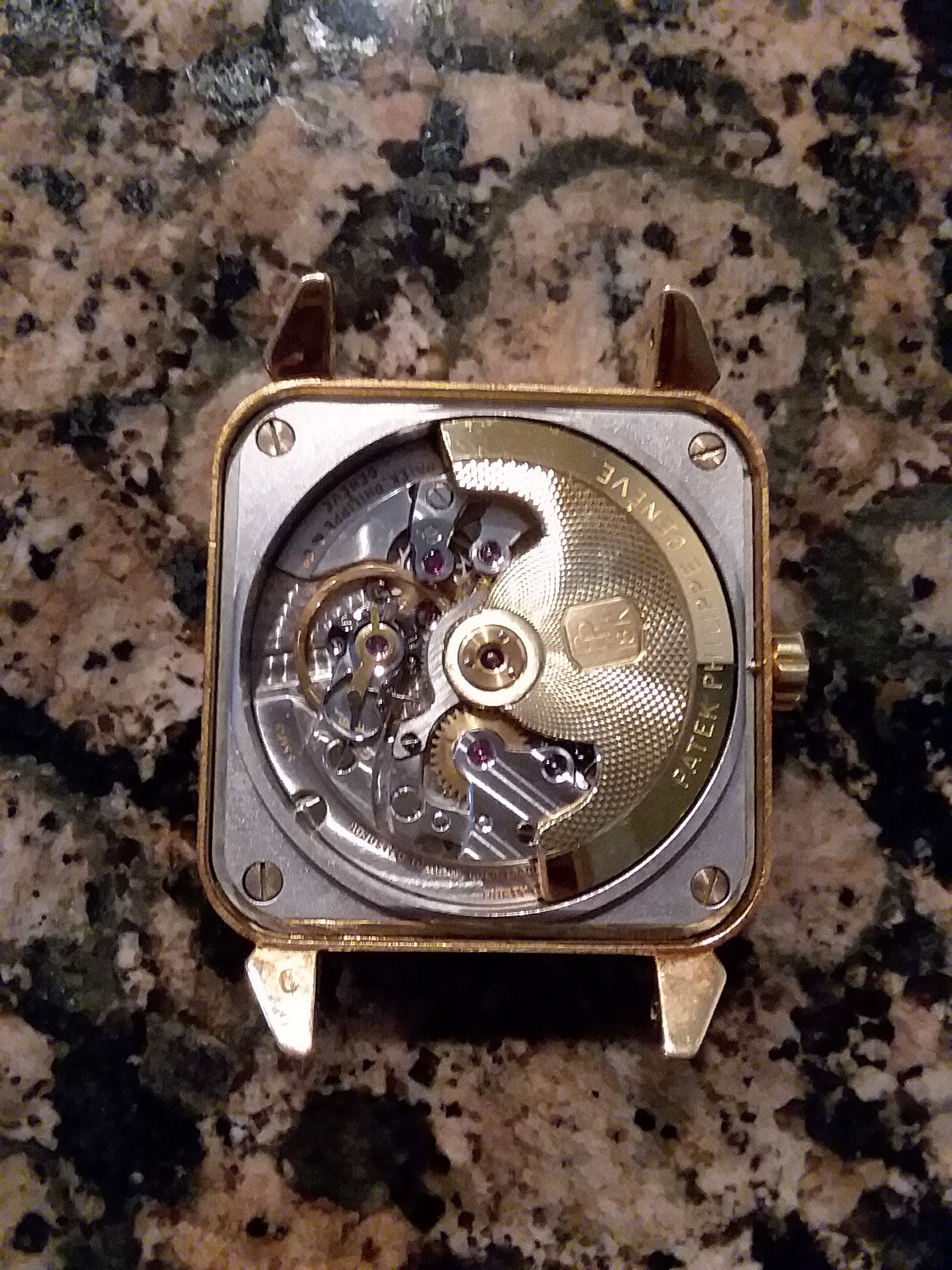

What avout the Patek Philippe 12-600 automatic ?
1,195
1,980

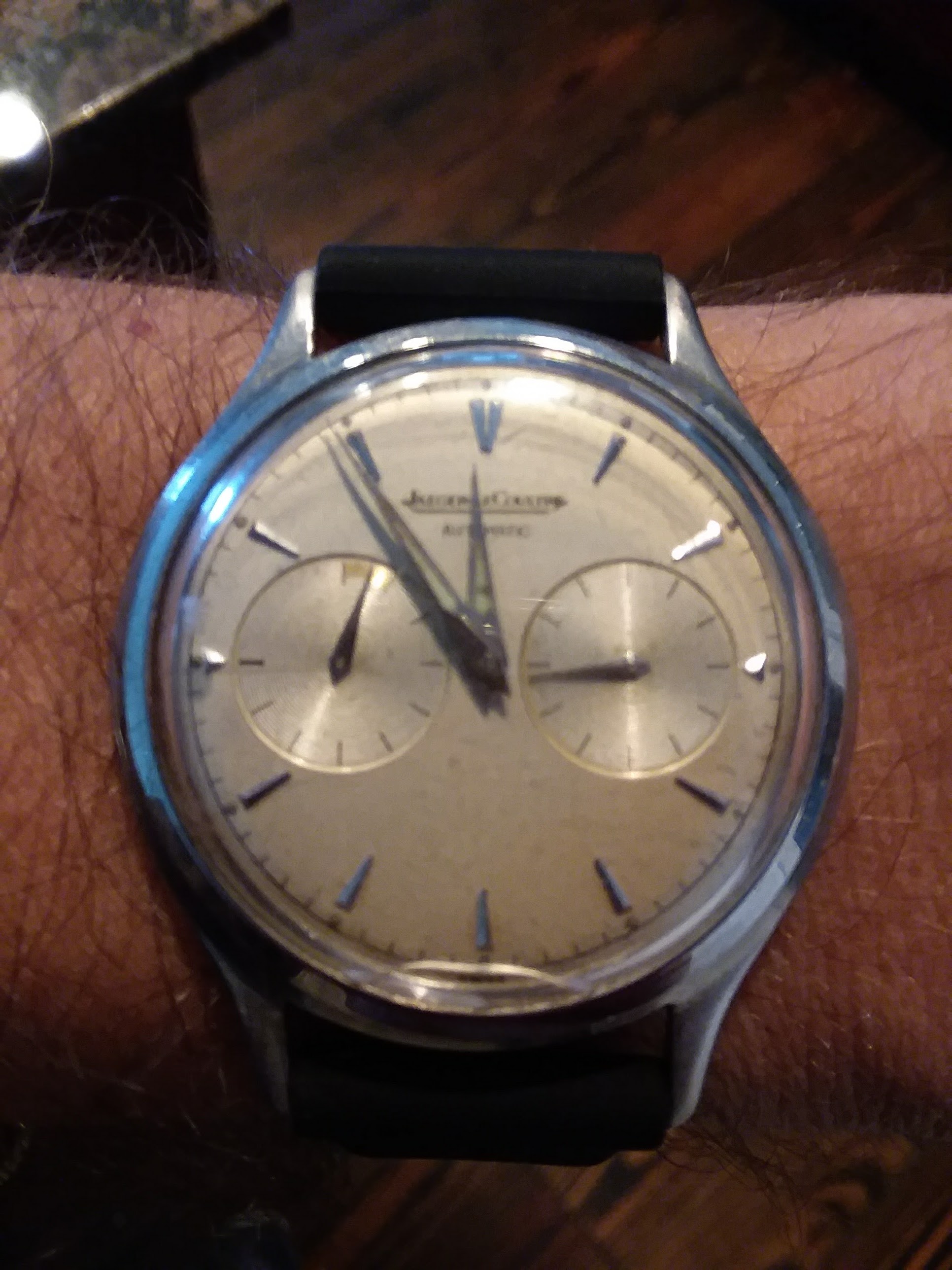

Another awesome automatic movement IMHO
did have some issues however is the Jaeger Lecoultre Futurematic !
