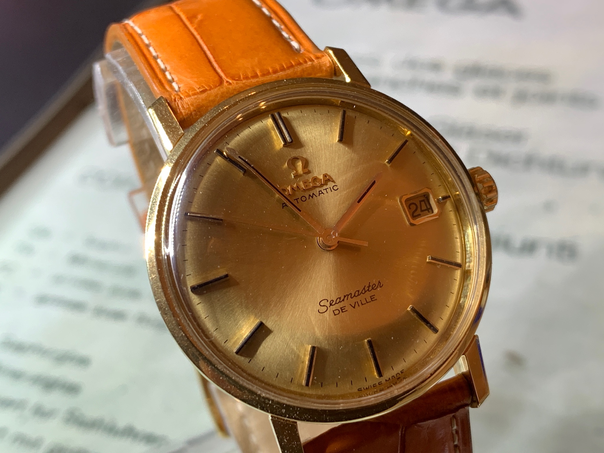

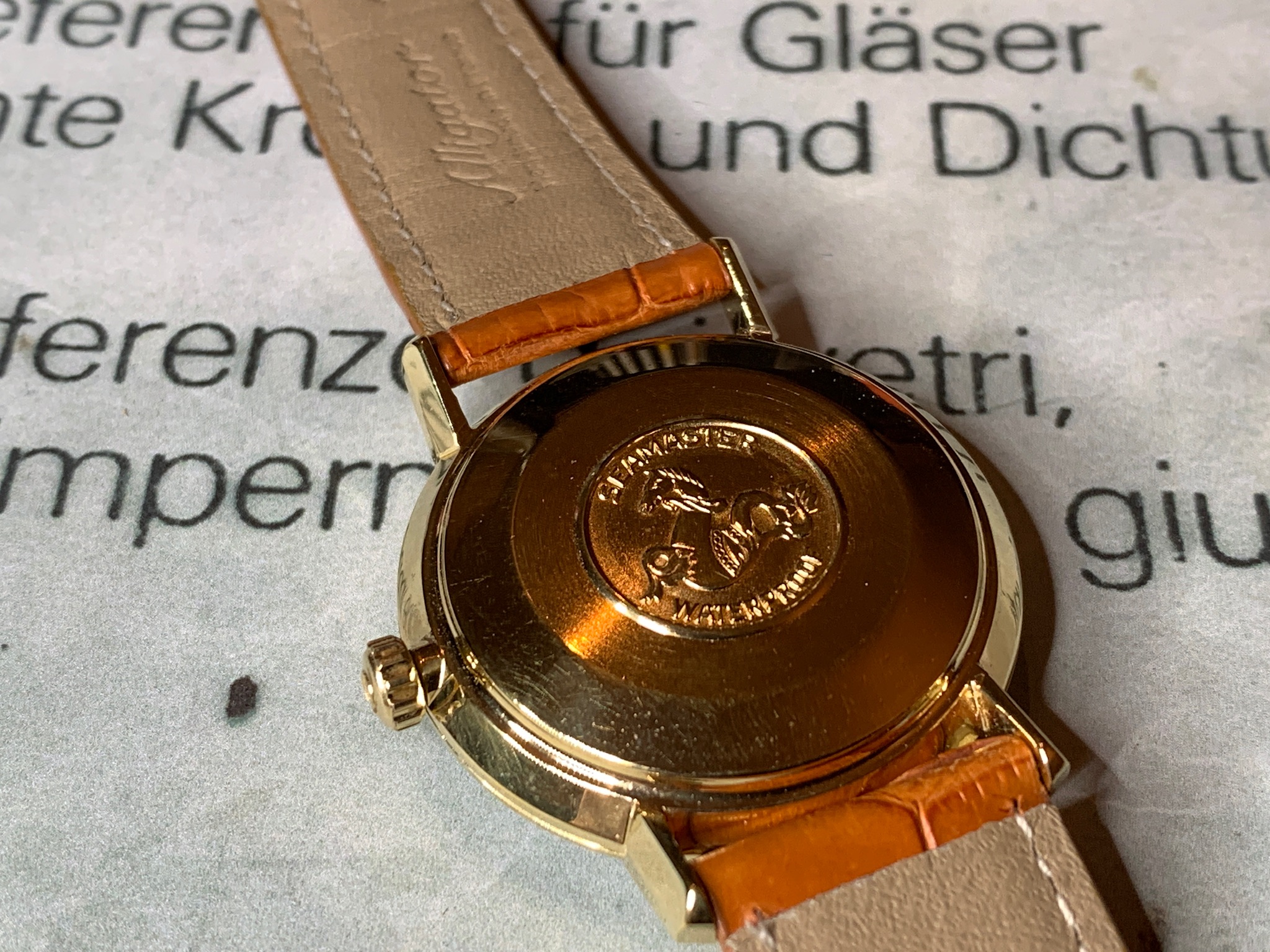

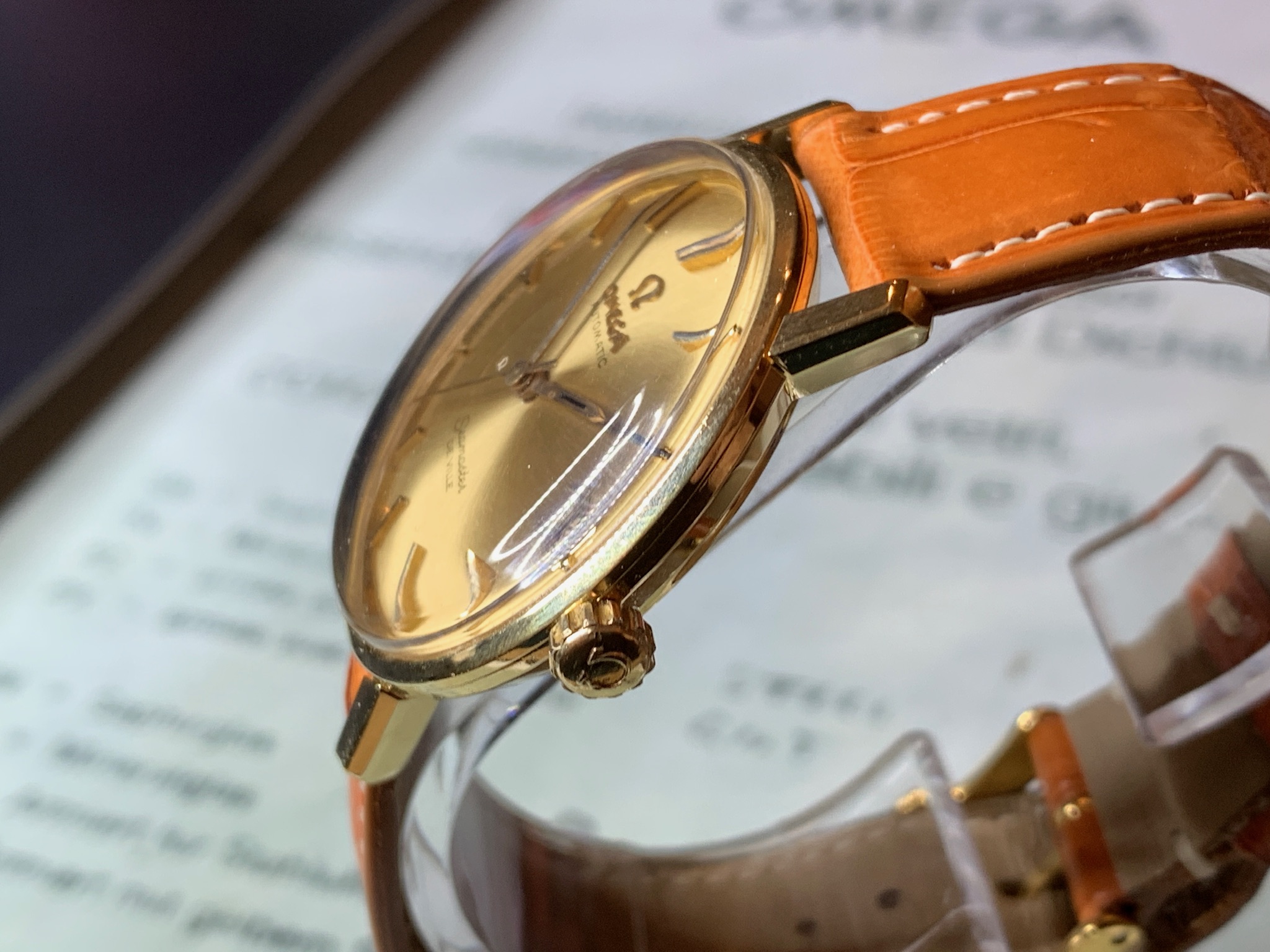

Hi, I've always loved watches. And flashlights. And old cars and guitars and amps. I'm looking for a vintage Seamaster De Ville in both original condition and in very good condition. I've come across a Seamaster and would humbly ask for your opinion on condition and originality. The asking price is about $1,500 USD. Here are some photos:
I've looked at others which had quite excellent redials for less than half the money. But this one seems straight although the stamped "166.020" seems very light. The case lines look sharp and the rotor appears shiny and true. Please share your thoughts on condition, originality, and price with me. I'd rather pay more for a good one than have two or three frankenwatches.
Thank you very much from North Carolina.

It looks nice overall, although the price is at least 2x what I would pay. I would say the case is just lightly polished. The bright white lume in the hands is catching my eye. This is a low-jewel movement BTW.

I’m new to vintage watches myself, but I’ve learned you can get a lot of watch for $1,500. I think this would be better priced around $900 - 1k less.

Watch looks good, though I'll second @Dan S on the lume. Looks redone. Price is insanely high though.

It is decent enough but as others have said, just too expensive. For that money I'd want a NOS 562 or 565 with BOR plus box and papers. That said, there's no easy answer to finding a good one at the right price. The Seamaster De Ville isn't a "top end" model which is possibly why its increasing scarcity has gone under the radar - it's much easier to find a good Speedmaster or Constellation on the Sales forums here, where maybe 3 or 4 SMDVs show up per year. Patience, persistence and thorough research are the answer. Study dials, hands, cases and movements and be prepared to strike when you spot the right watch.

The 166.020 with the caliber 560 is actually a very uncommon watch.
And no OXG?? Or is that behind the rotor?

Nice one. Glass not original? Very crisp back side. But, as many already stated, pretty expensive. That is more massive gold territory if you ask me.
There's is an "OXG" on the movement in my original post. I have seen another photo which I did not post which has it. With a quick search, I now know what it means. 😀
