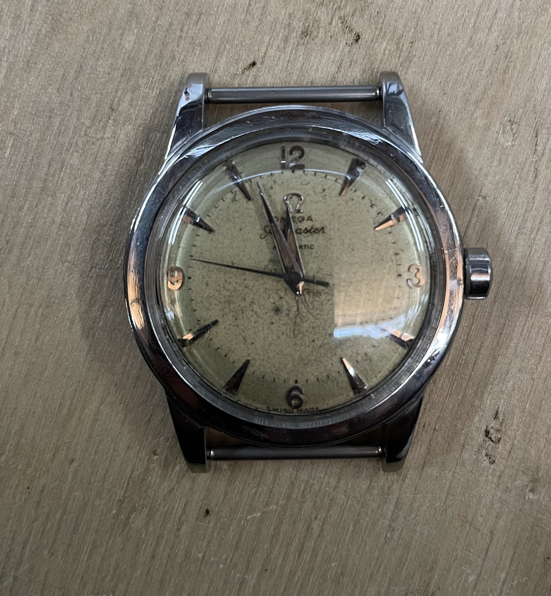

Hi can you help me ID this watch?

Hey guys. I got this watch recently but can’t figure out what ref it is. Can you guys help ?

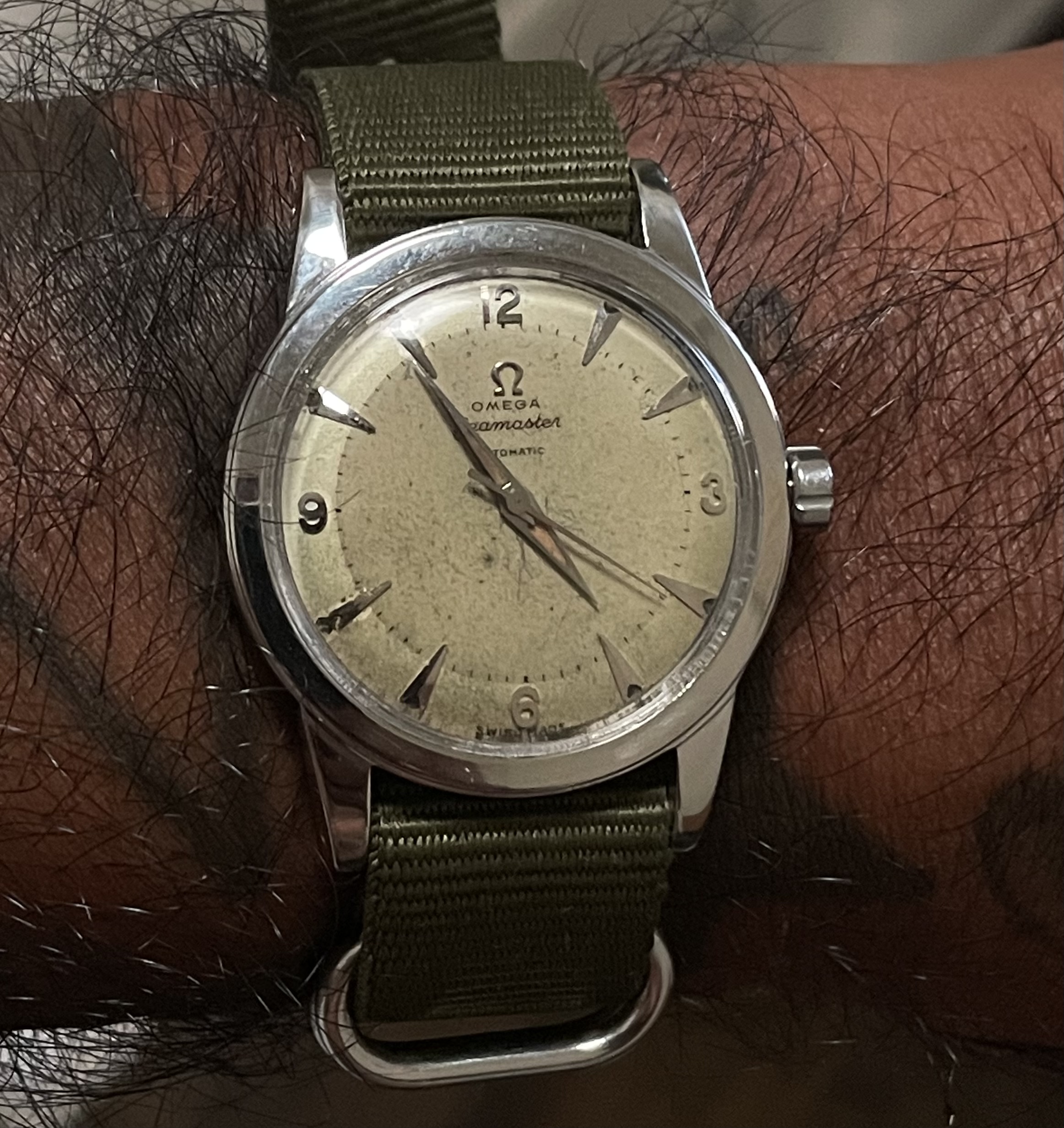

Going by your fearsome looking wrist, it is whatever ref # you tell us it is, Sir.

Hahahahah. It’s the hairy arms right?

It could be from one of 2 families, show the caseback to narrow it down. I am leaning towards 2577, but as noted above it could be a later 2846 (not 2848, that is the sub second full rotor fat lug)

Hi Ralix, welcome to OF 😀
Your Omega is a ref 2577 (unless your wrist are really big and it is the 36.5mm jumbo variety 2494) from the early fifties/late forties.

To be fair there still are another couple of refs it could be but a caseback shot and a good idea of the diameter will narrow it down.

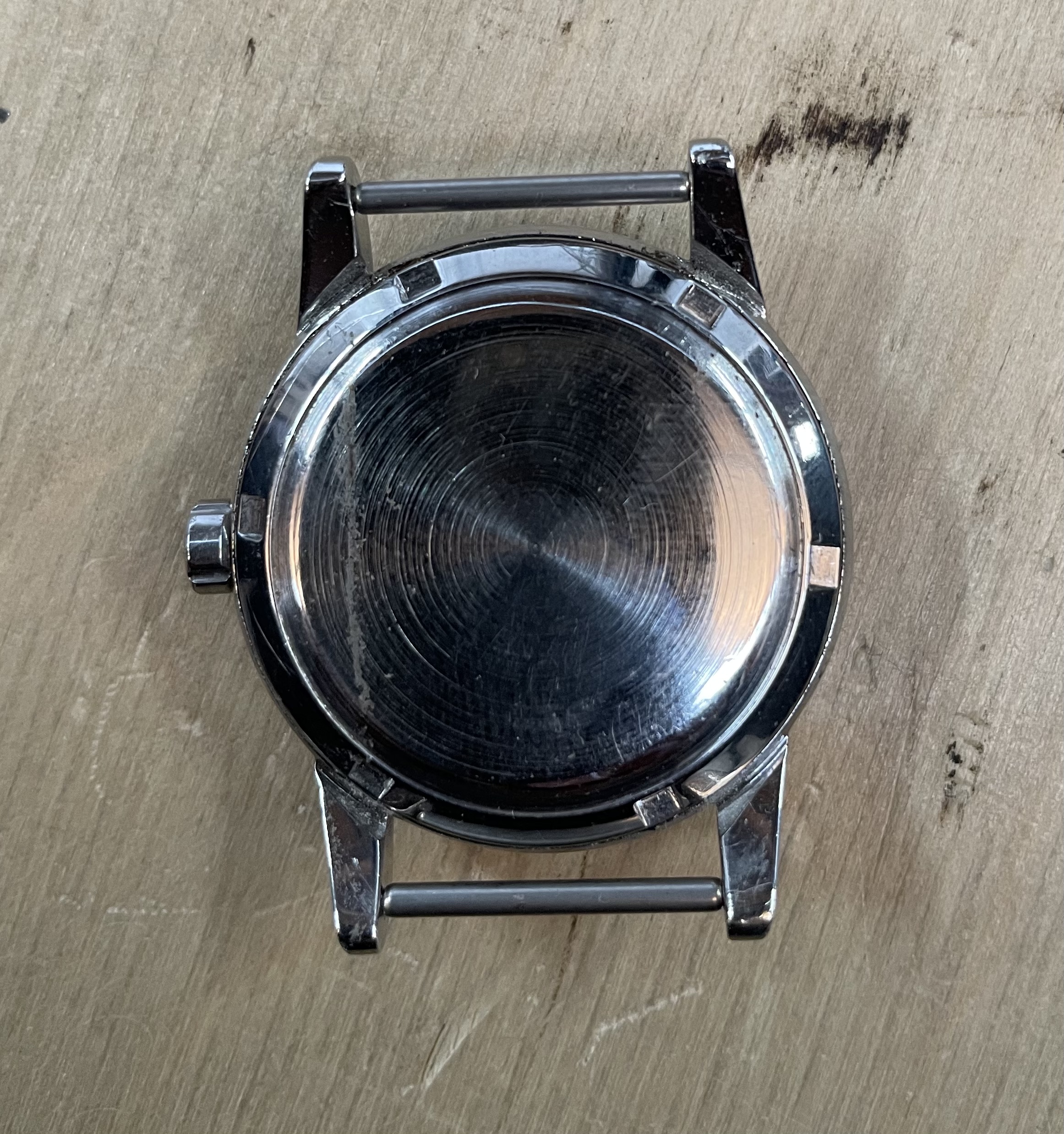

Any chance of a photo underneath the back cover? This is where the model info is stamped

I don’t have an opener but I guess I’m buying one today.

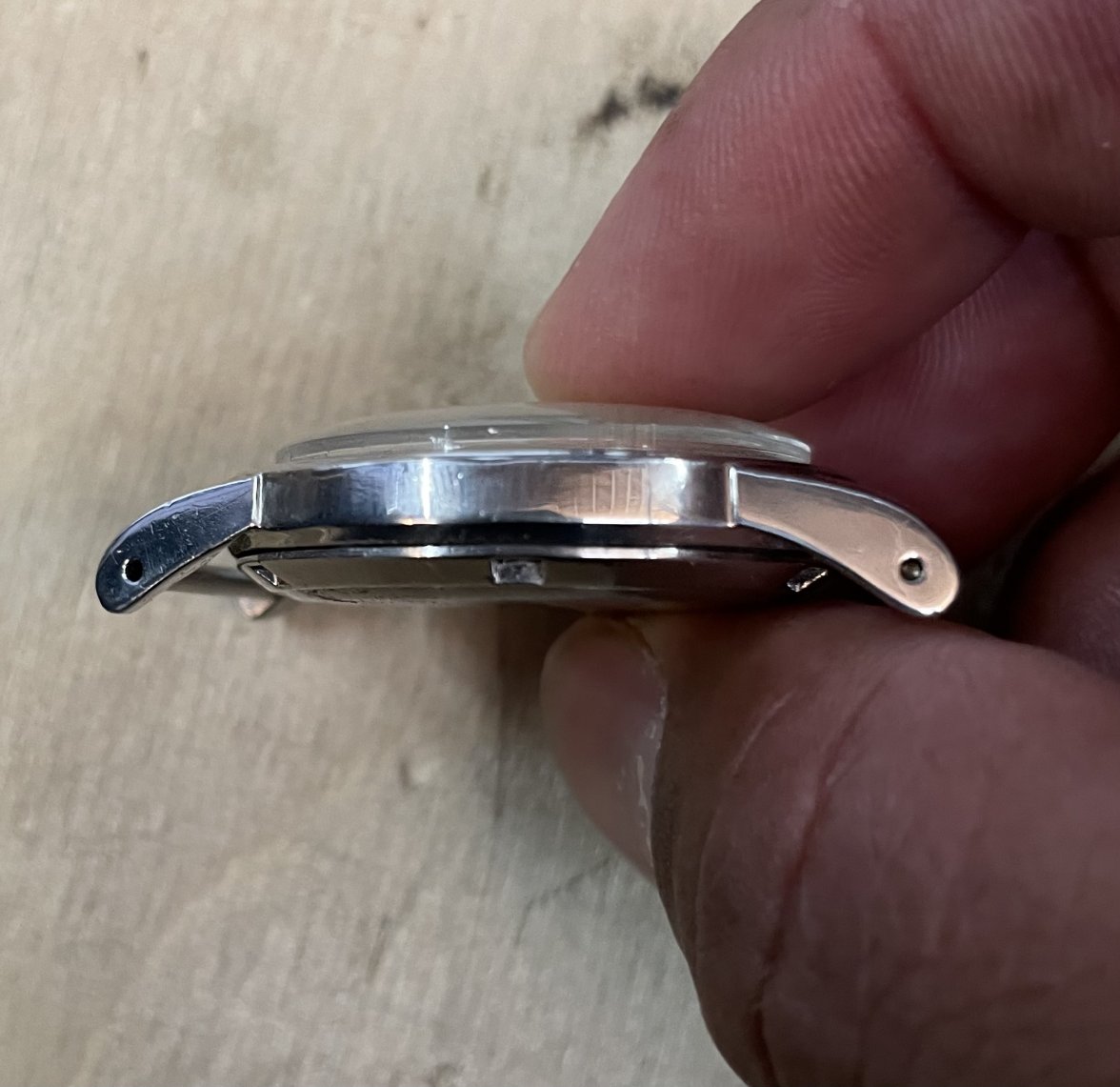

Well I was thinking 2767 was a possibility if it had a push on back, and I think there were some smaller case fat lugs too. Just when I think I've got my head round 1950s Seamasters, another variation pops up!
Bearing in mind the screw on back and reported ~34mm size, it's most likely a 2577 though. I think strictly speaking the 2577 is usually described as 35mm exc crown.

I don't know if there is a 2577 predecessor, but most of the 'not-a-ref-2577-34/35mm-Seamasters' are post 2577 and have the newer Omega logo - the logo on this one is the earlier type that was discontinued around 1953. The earlier type of logo means it can't be a full rotor movement, so no 2846/2848 either.

I guess we're not discussing the refinished dial?
Nope, because most of us think it’s original.

If it’s refinished it’s an old refinish Heavy patina on it.

It’s a bumper movement
