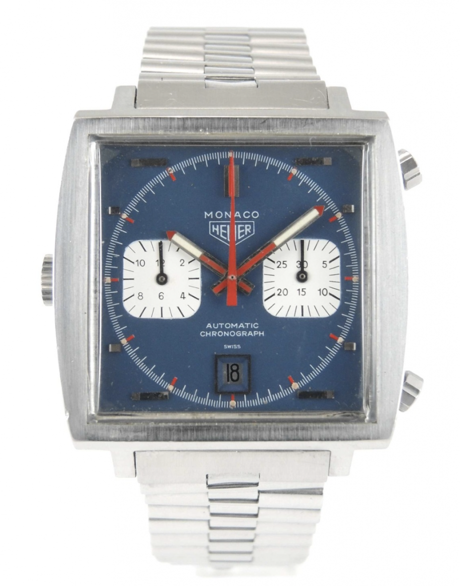

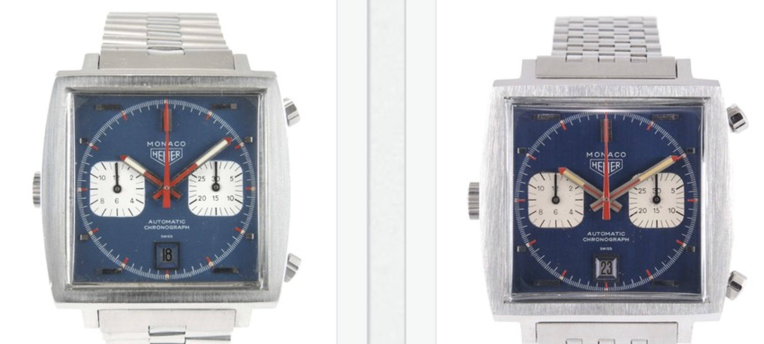

Can 1133B owners comment on this. I need a 1133B in my life.
Please ignore the case condition. I'm asking which dial, hands and pushers are more original?
Left or right Monaco?
Why is there such discrepancy in dial color in same reference?
Thanks all.

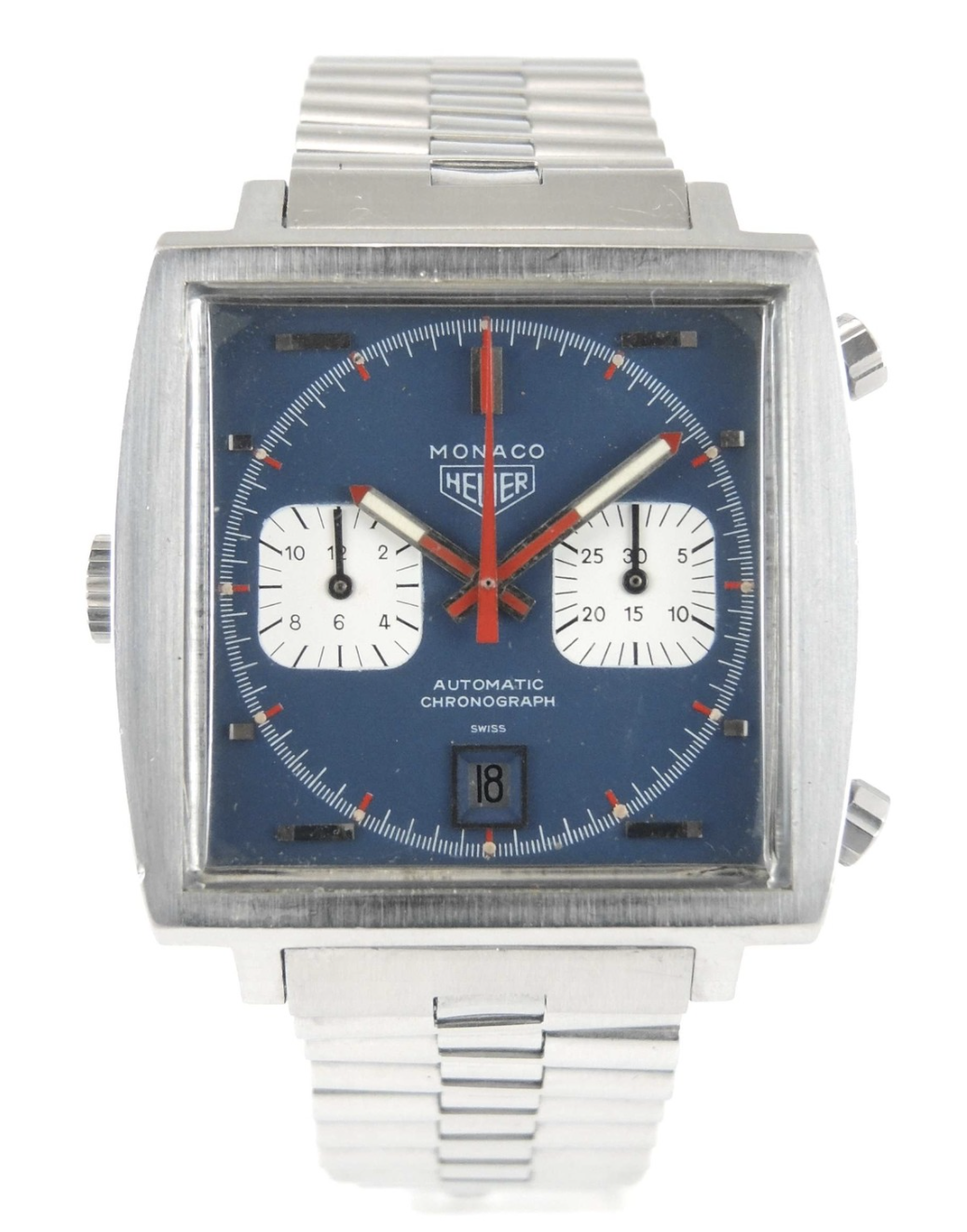

In this case I think the discrepancy is heightened by the different lighting conditions of the two photos. If it's the same seller, ask for side-by-side photos in the same lighting to compare.
However, the earlier Monacos had a dark blue metallic dial whereas the later production runs had a flat blue dial - it's possible that the example on the right above is what's known as a "Transitional" dial (from the very first batches, to the standard production later on), while the left is a "standard" production model.
Hands are murkier, but they appear correct for both models - we see the thinner lume style on earlier models, and the wider ones on later models. The wider hands could also be service parts, but this is unclear.
Crown and pushers are too hard to tell in these photos, you'll need shots of each side of the case to compare. but, all Monacos had fluted pushers and both of these do, so no immediate red flags.

I’d guess it’s just the lighting. Transitional Monaco’s are expected to come with the simple flatter handset. Both look good though.
Immediate edit !
Actually on close inspection I’d say it could be a transitional dial on the right hand watch. Can you find the serial number on the case ?

Just did a quick google search and the seller of the right hand watch is describing it as a transitional dial. Definitely looks it. I’d want to know the SN of the case. If it’s a transitional serial number it’d be a cool example to have and you could always keep an eye out for a correct transitional handset.
Immediate edit !
Nothing with Heuer is a hard and fast rule; in many cases sometimes the older dials were just used up with the newer handsets. We see this especially in the automatic Carreras as they revised the designs at a rapid pace between 1969-1972 or so. I'd still expect an earlier serial on the Transitional dial example though, at the very least.

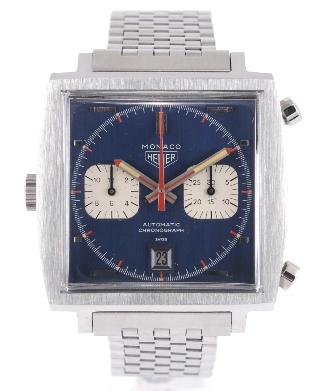

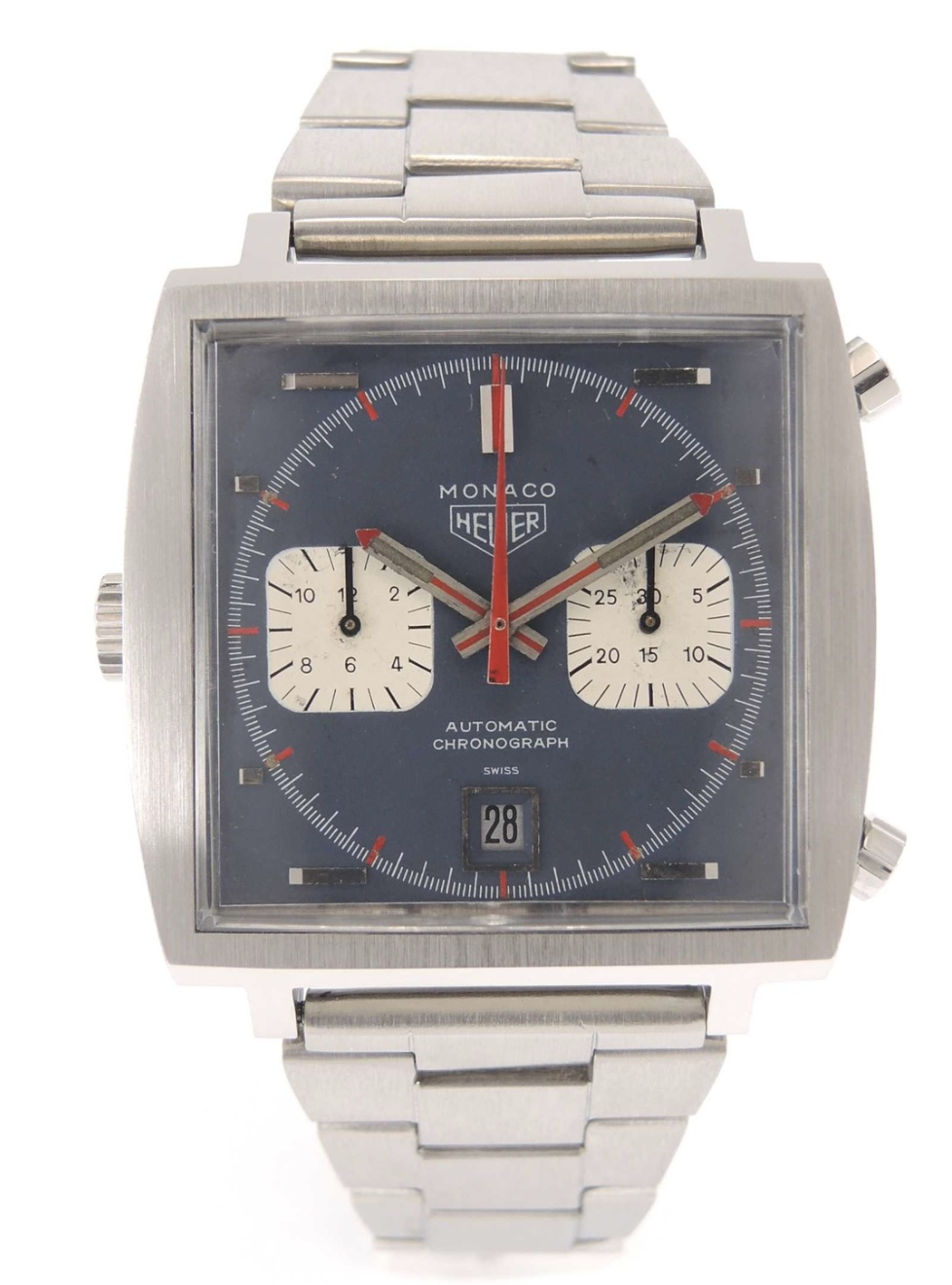

I've seen many different bracelets on 1133B, many claimed original. They do seem like they belong.
These 3 are from the same dealer, each sports a different bracelet.

I’m not expert on the bracelets, but the two best choices for me are firstly 1) the NSA that flares out to the full lug width before the endlinks, then secondly 2) the non tapered NSA as in your middle photo. Obviously both should have a Heuer signed buckle.
The bracelets were made by Novavit (NSA) - the top is a Mark II, the middle is a Mark I, and the third is not a genuine Monaco bracelet.
For the first two examples, this also lines up with their likely production dates...

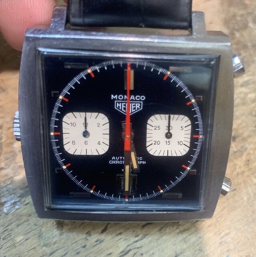

Thank you gents. Offer is accepted.
This gal is on a flight coming my way.

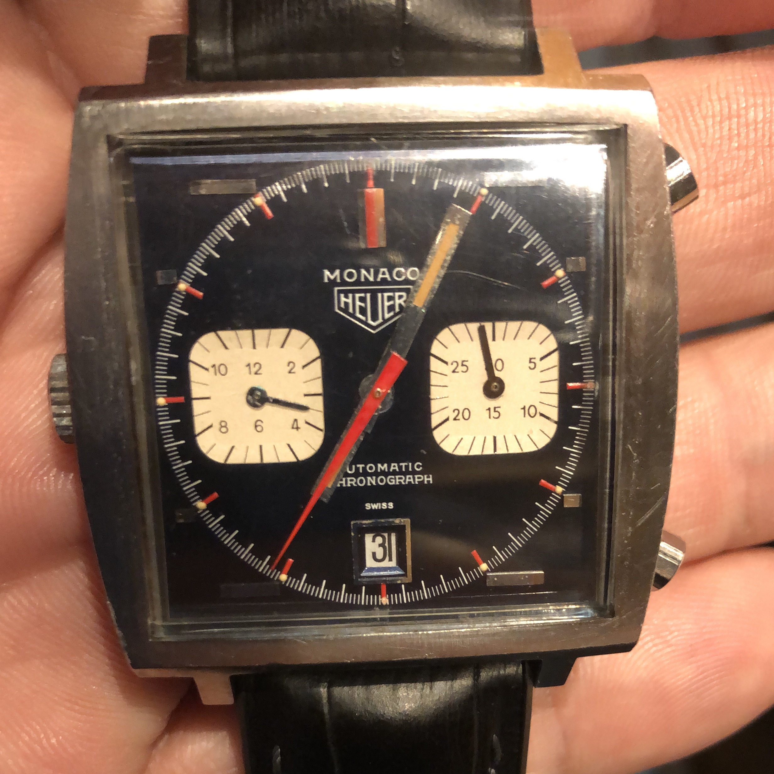

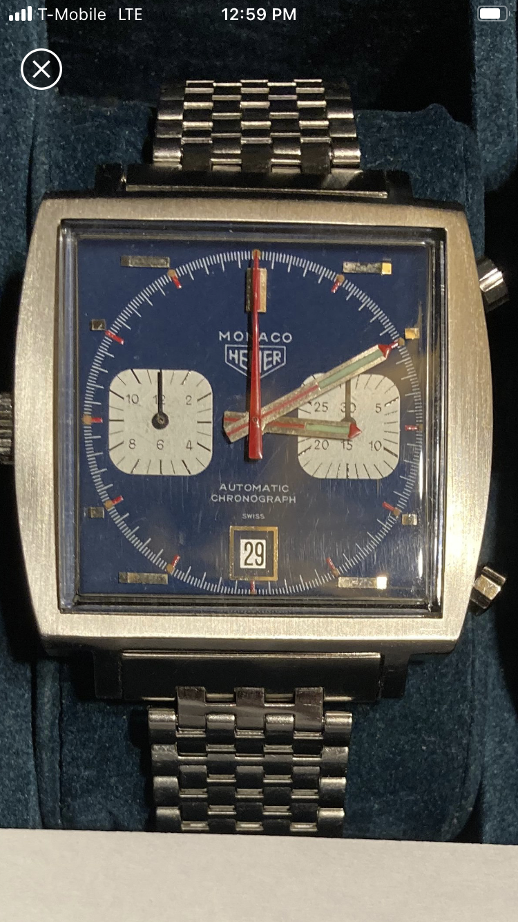

The green lume on hands are funky. May have been relumed some point during service. My guess. Do you see any other issues?
She comes with original bracelet and Cal11 movement. Checked all my boxes.
Case looks like it's seen some polishing through the years but I think it's nice

Do you have any idea where/how those greenish lume hands happened?
The brown hour marker lume dots seem right. I’m glad most lume dots are intact.
