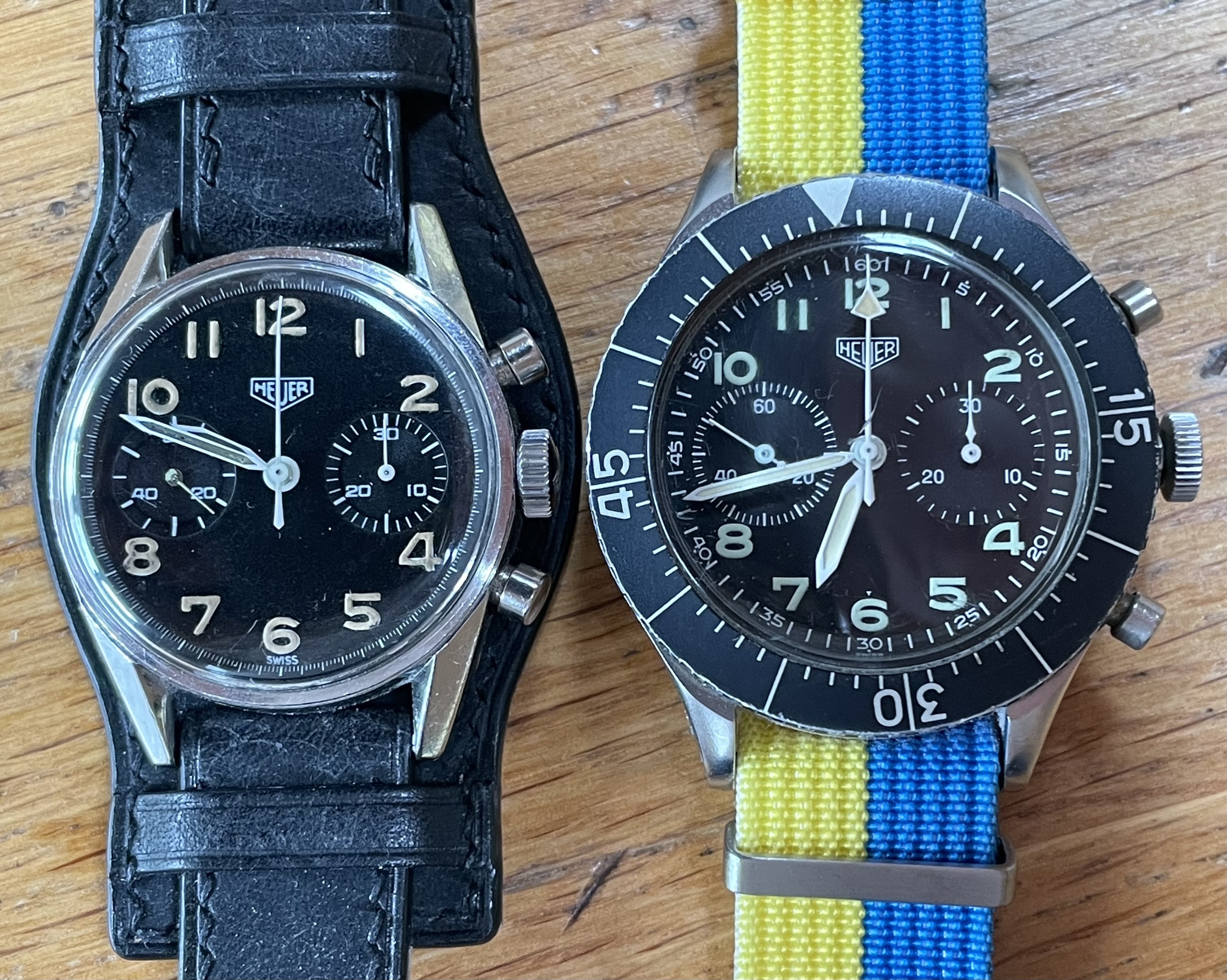

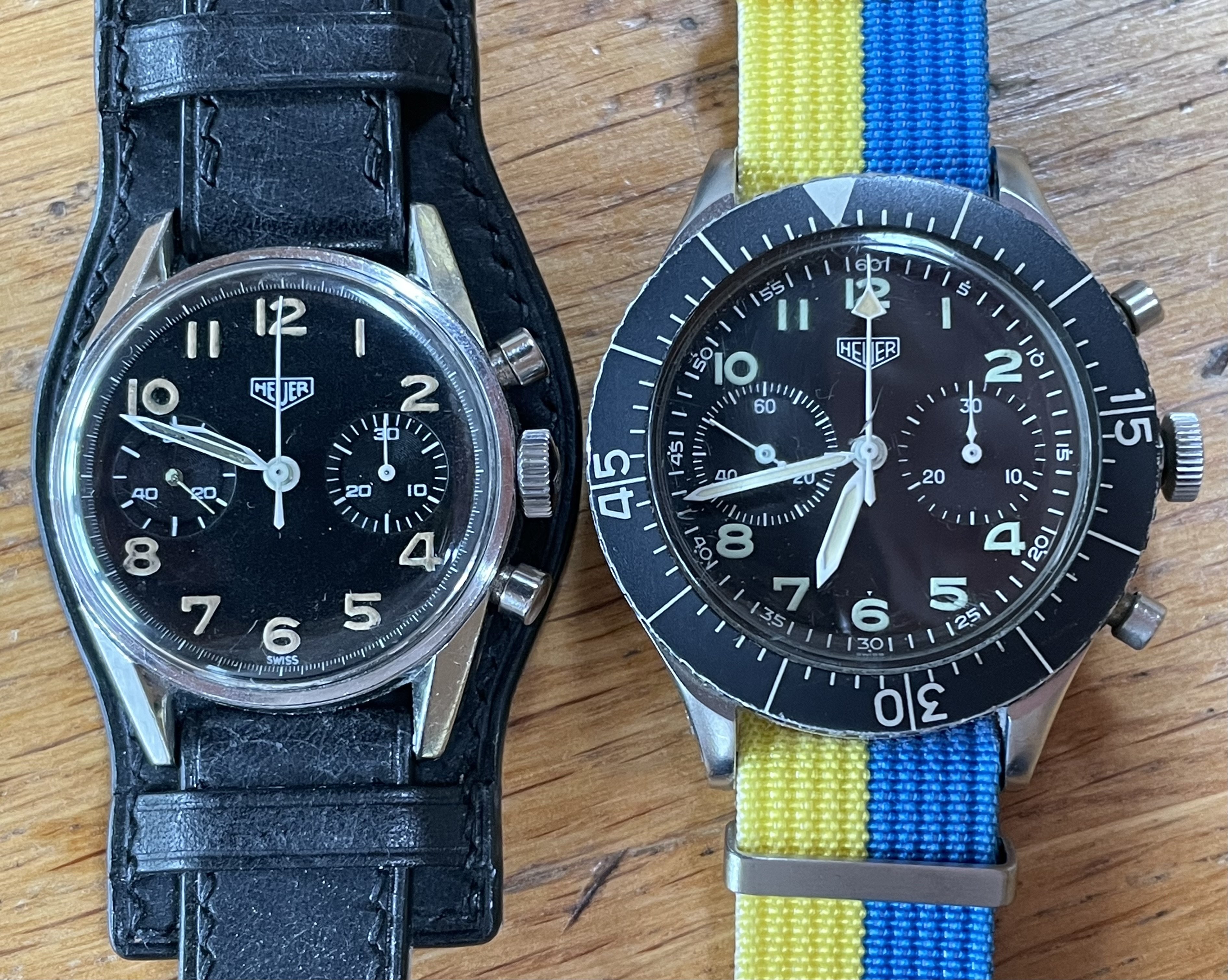

Have them relumed. I have both watches - the hand sizes are not the same - 1mm longer on the Bund and slightly wider. The usual lume colour on the Bund won’t look great either in my view
