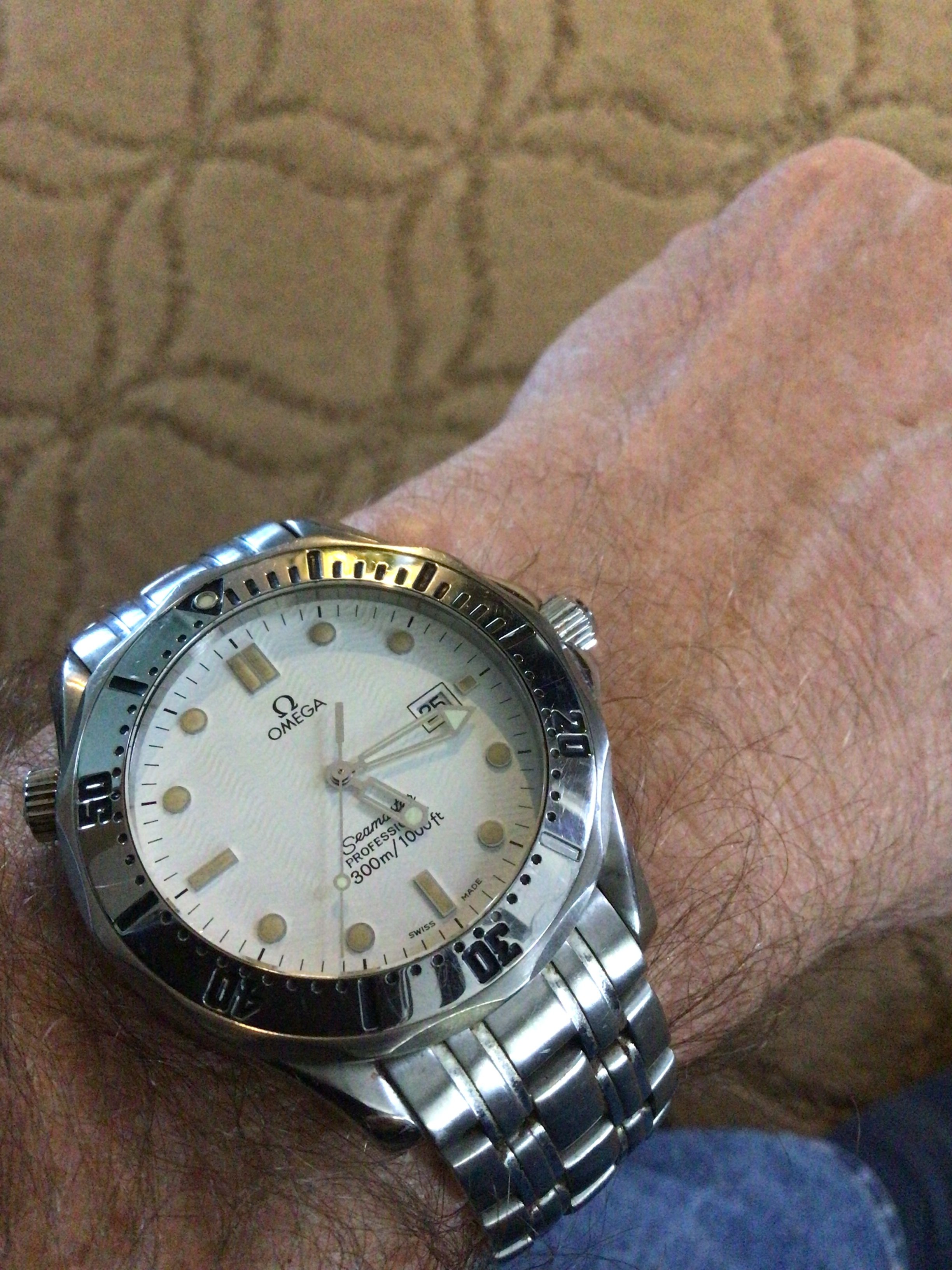

Here is the Seamaster I inherited

One other thing -- since you plan to take it into a jeweler to get the bracelet adjusted, I would take it to a place that can also replace the battery and do a pressure test on the watch to make sure it is still water tight. They'll probably also run the bracelet through an ultrasonic wash to get all the dirt and grime out of it. You'd be shocked at the amount that is in there after several decades of wear!
Also make sure the tech working on the bracelet realizes there are pins and collars -- these are a bear to get out and if they think they are friction pins they may use the wrong tools and damage the pin. They also need to be careful to not loose the collars. This is definitely not a bracelet to work on without the proper tools and some experience -- trust me, because I tried back in the day and bent a pin AND lost the collars. Luckily, I realized what I'd done and had extra links that I could get the appropriate parts from.

It is a quartz watch, as others have noted. It would say "chronometer" on the dial if it was an automatic. The second hand will also jump from one second mark to the next and not sweep. The fact that you thought it had lost time after setting it the first time, but it hasn't since you reset it most likely means you set the time wrong the first time. I do this all the time -- set the watch to the wrong hour or ± 5 minutes off.
If the battery is going bad, there should be a change in the seconds hand behavior - it will start jumping by 2 seconds (maybe 3, I forget for this movement). If the seconds hand on your watch is making 1-sec ticks, the battery is fine.
A sort-of related question.
Doesn't omega replace old quartz movements? Would it be wise to do so if given the opportunity?
I know that is unheard-of for mechanical watches, but I wonder if things are different for quartz.
Not completely true. There were very early examples of the SMP which had non chronometer rated Auto movements and had the 3 lines of text as shown above, not certain if these included white dials but there are certainly blue dials out there. However, the date window placement is noticeably different on the 1538 quartz and 1108 Auto movements so this one is indeed a quartz watch. The window is much closer to the centre in on the 1538 than 1108/1120.

Today my jeweler resized the strap, now the watch fits perfect. I asked about a battery and he said it is automatic, no battery. He then said if it is running fine then to leave it alone. Anyway, it is nice to be wearing it.
So the second hand sweeps smoothly, as opposed to ticking second by second?

Assuming this sentence is correct:
When I acquired the watch about a month ago it had not been worn for two years, it was running but the time was wrong.
The most likely scenario is quartz with dying battery, as many have stated. But if his jeweler is correct... either the OP is mis-remembering or we have a mystery of time on our hands.
@Ohio Painter did Your Jeweler remove the case back and actually look at the movement and service the watch, or is all they did resize the bracelet for you?

My guess is the jeweler is not familiar with Omega watches and just assumed they are all mechanical.

They resized the bracelet. I asked about the battery and that was when it was mentioned.
It has been keeping good time since last adjustment. As it is 30 years old I will plan on getting it serviced at an Omega service approved jeweler later this year.

No, I took it to a local jeweler who I have been loyal to for the last 30 years. For service I have a James Free not too far away. Is James Free recommended here?

James Free is an authorized dealer for Omega and can facilitate service. They’ve never done me wrong, but they also don’t work on too much in their shop anymore.

Note every photo of this watch has the second hand bang on the index. That is unlikely with an auto SMP as there are 8 options for the hands location between the indices. The ‘jeweller’ was presumably not all that savvy.
