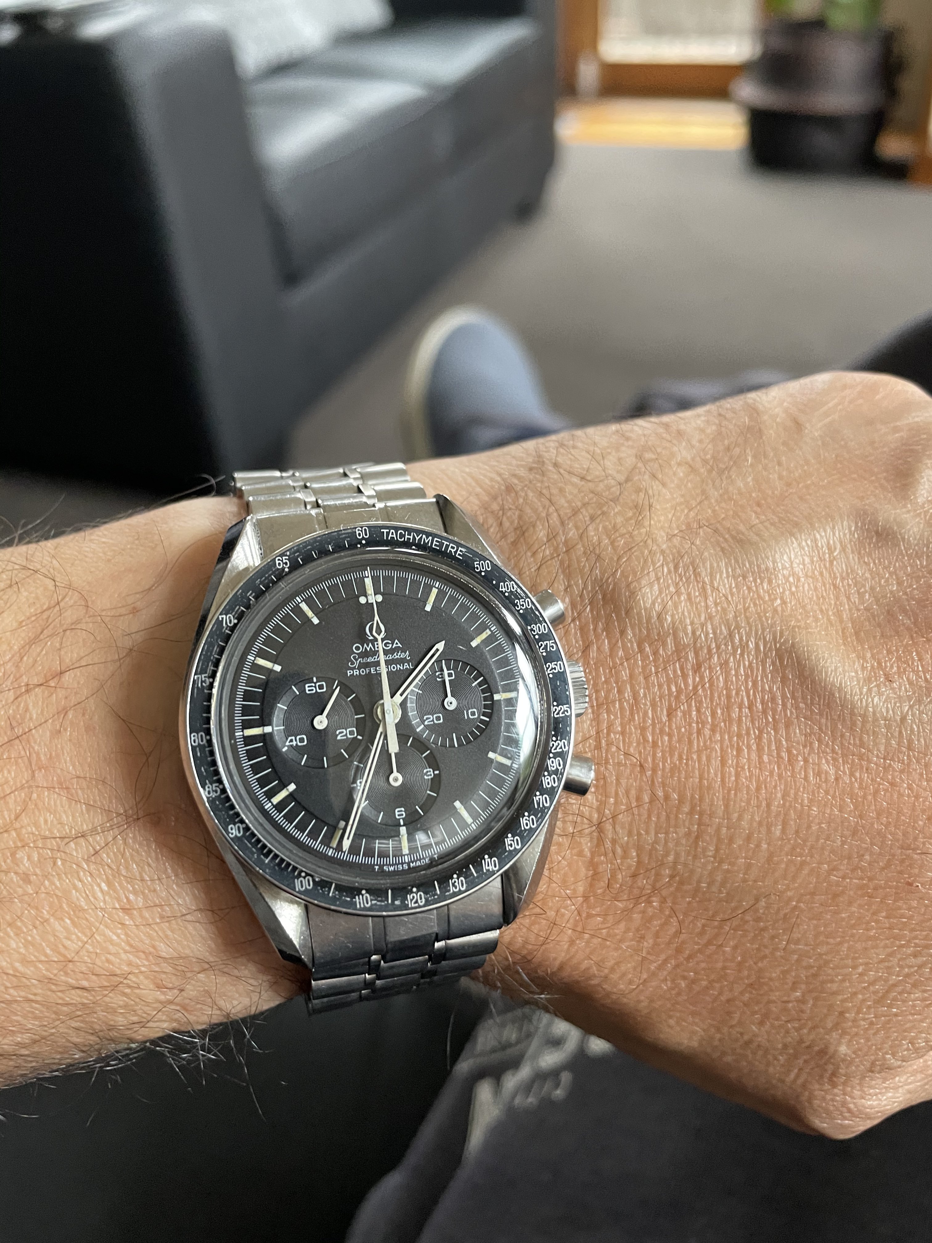

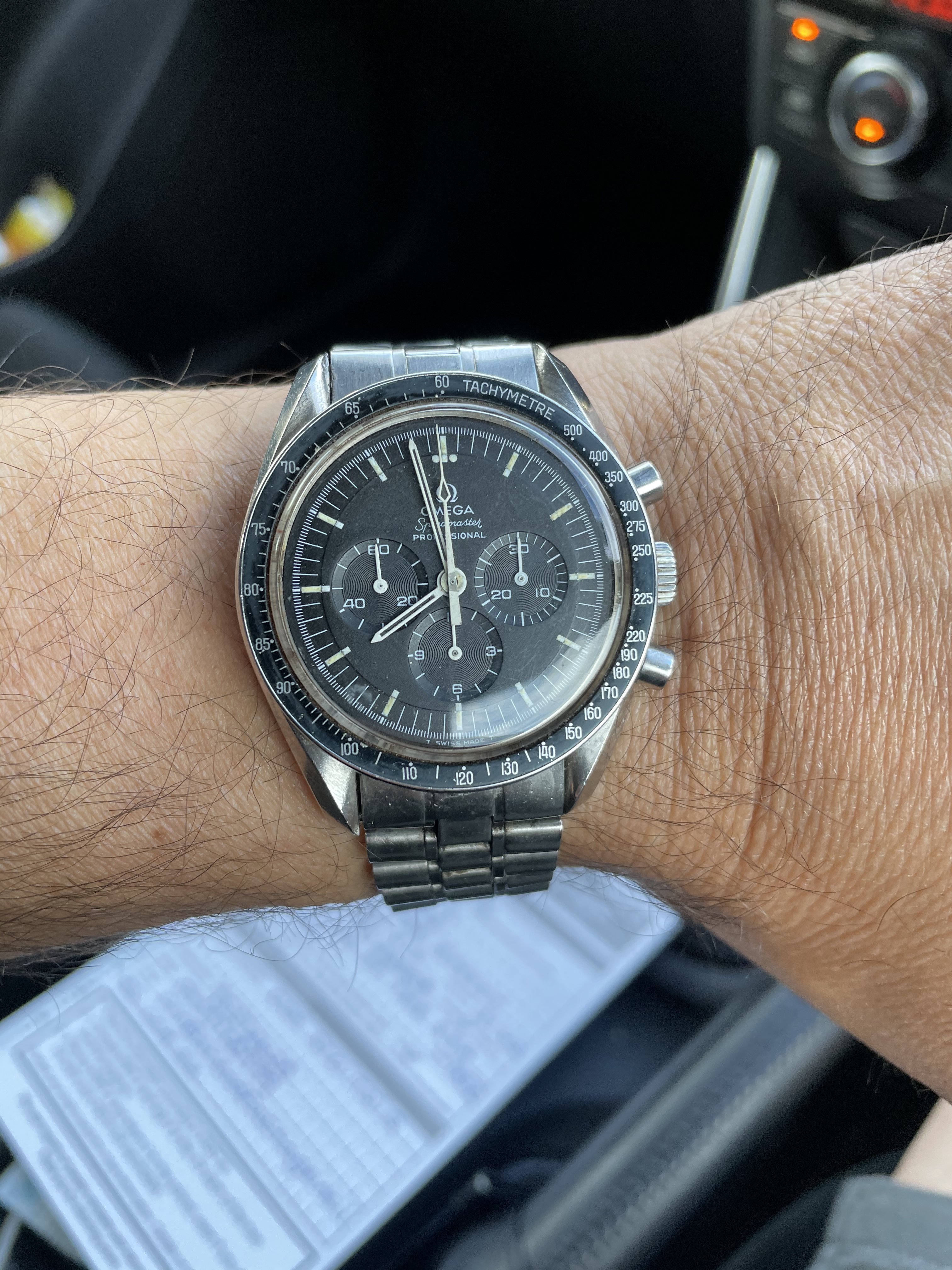

Hi Guys
I just had my 1969 Omega Speedy serviced at a reputable watch repairer
It has a 220 bezel
It has come back scratched and not in the condition I gave it to the repairer.
When I rang him, he went on the defensive, and said they didn’t do it
I then sent him some comparison pics, and now he want to look at it.
What can I do
These bezels are rare, and almost irreplaceable
Any advise will do
Comparison pics attached

I am also asking myself if your bezel wasn't already scratched before service but with a bit of dirt/maquillage the scratches were faded and not as visible as after maybe a ultrasound cleaning bath... Every font is looking darker, dirtier, faded on the "before" pic unlike the "after".

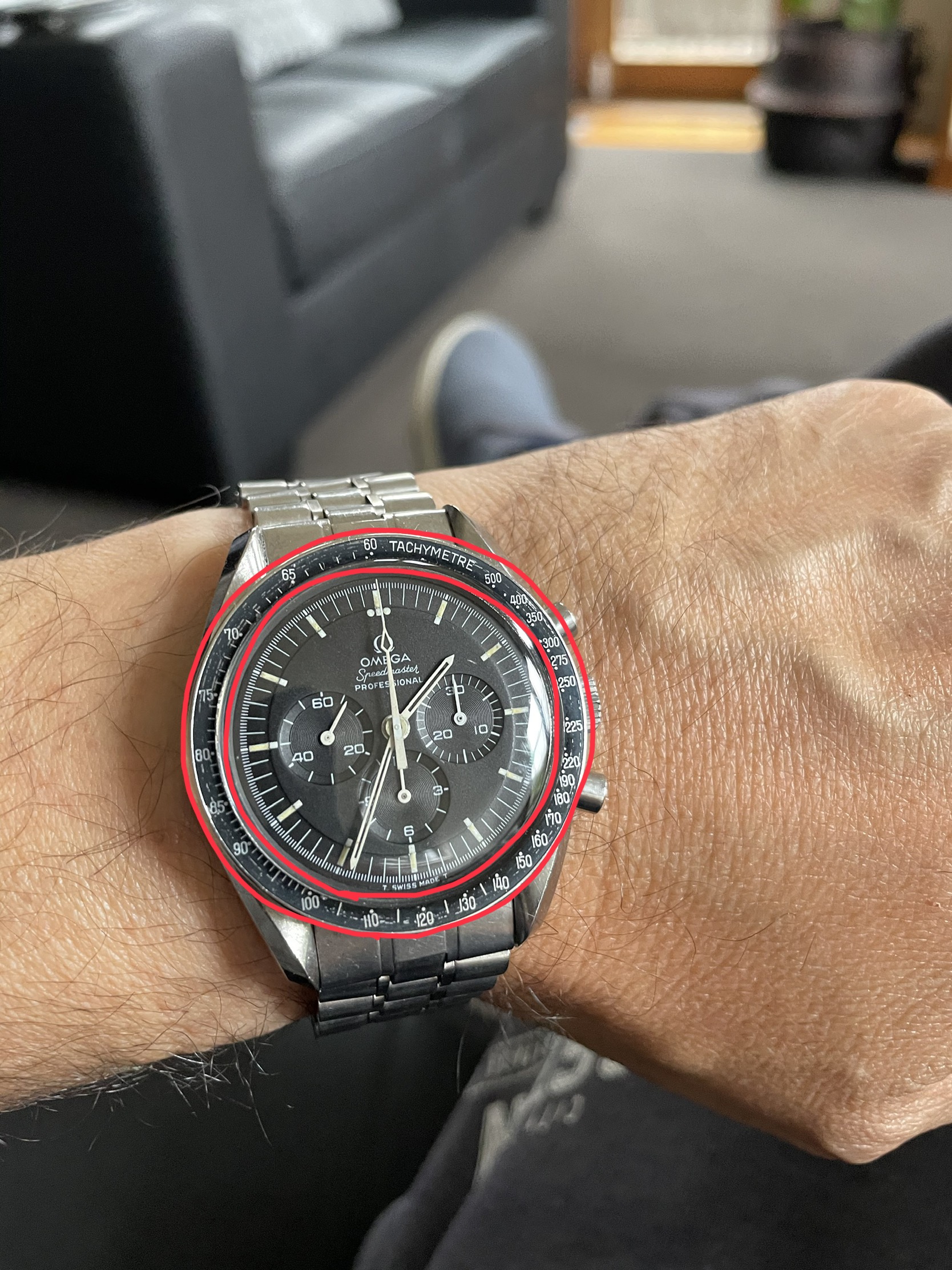

circular marks most likely are from bezel press.
This makes sense, but scary if true. I thought the press moulds were usually made of silicon? What could lead to damage in this specific instance - misuse of the bezel press, or something like very fragile bezel to begin with?

IMO, the "before" photo shows some degradation of the paint on the bezel in the form of irregular fading, etc. For example, you can already see a line passing through the 85 and 90 printing. Obviously, if the bezel had not been touched, it could have taken many years to degrade further, but it was probably fairly delicate. Most collectors have experienced damage occurring during a service, e.g. lost lume in hands or dial, etc. It's unfortunate, but a risk that you take in owning old watches.

I cant see a difference between the photos - what / where exactly are the areas you think have been damaged?
2,597
5,666
I’ve tried to mark up the areas that show the damage here... 😁

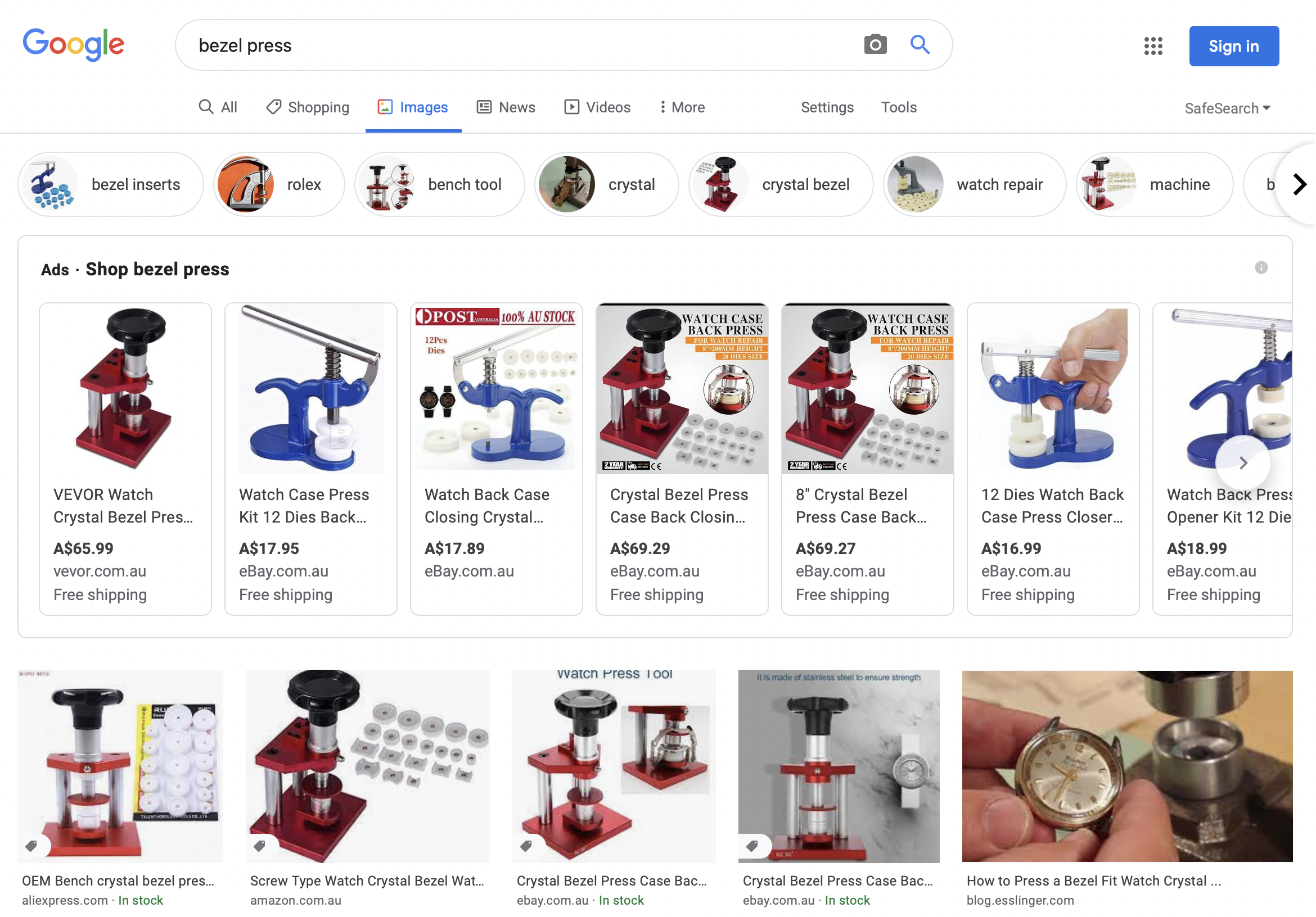

Thanks what is a bezel press?
It's a thing incompetent "watchmakers" use to fυck up good bezels.
521
980
The bezel press is a tool to install the bezel.
See the video on this product page.
I agree, however it would be very unusual for dies to cause this sort of damage. I've pressed a shit ton (technical term) of bezels on using a press, and honestly never seen anything like this before.
But the problem with vintage is, you don't know how fragile something is until it's too late - this is why I avoid removing the bezel unless it's absolutely necessary.
Thank you all
I would ask your watchmaker if he removed the bezel, and if so why. If he did, then ask what he used to install it again.
Unless the bezel was misaligned, there is often no need to remove it.
