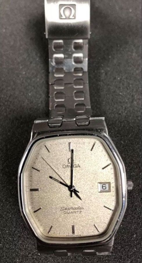

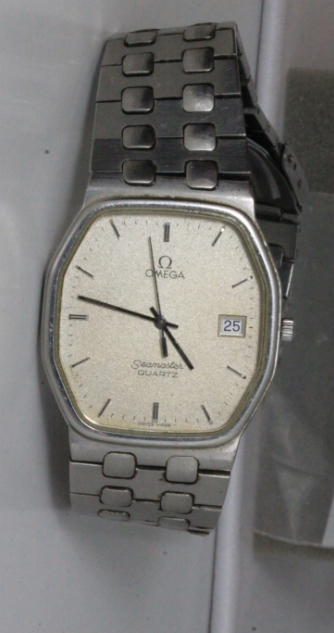

So a few years ago my late father left me an Omega Seamaster quartz, that he had purchased in Oman some time in the 80's.
The watch case number was 169.0279 with the omega 1430 quartz caliber. The picture below is the only picture of the original watch.
This was prior to the service, It looked so much better after, but I do not have any pictures of after, unfortunately.
There was an issue with the second hand hitting the hour hand and stopping and my mother paid to have the watch serviced at omega (swatch) in the UK.
The watch was working perfectly and was essentially the watch that got me into horology in general.
Unfortunately the watch was later stolen and has been reported as such and also registered with the watch register.

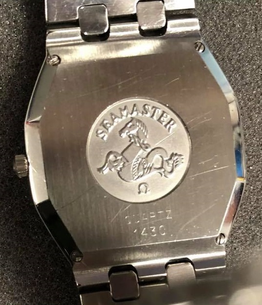

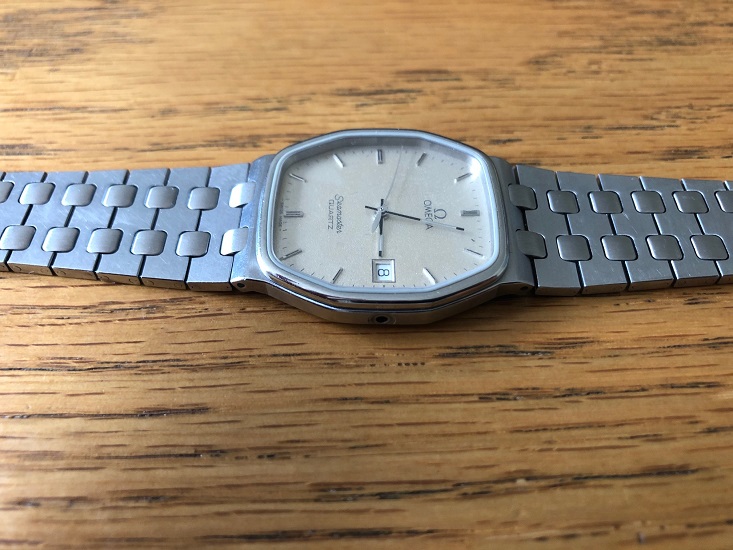

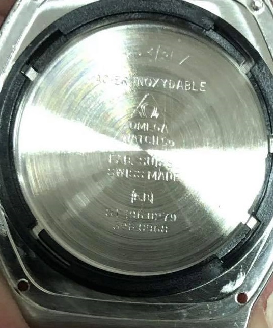

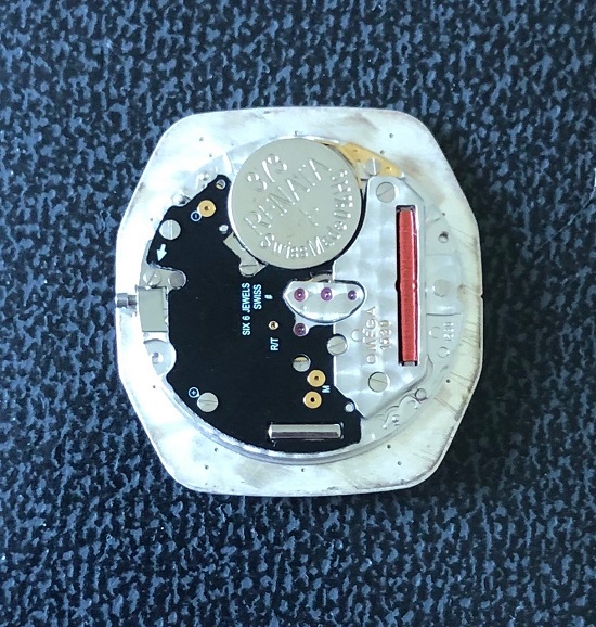

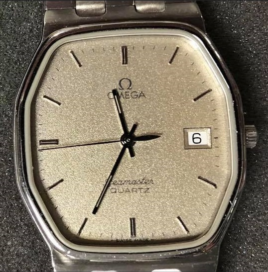

Weirdly a little while later the same model came up on ebay and was local to me, I thought that there was a possibility that it could be the same watch and bought it, it was listed that the crown was broken (split stem was snapped) however the hands did not match the old picture I had of the watch, also after purchasing, and opening, the movement inside was that of a 1530 cal rather than 1430 and had no serial number so I assume is not the original watch that was stolen because as far as I am aware it was only serviced once and the movement was never listed as replaced. Some pictures of the watch.
For sentimentality I decided I wanted to repair this watch as a keepsake as I very much doubt I will receive the original watch back (you never know of course).
I have two original 1430 movements which I intend to make one good one to restore it back to the original movement.

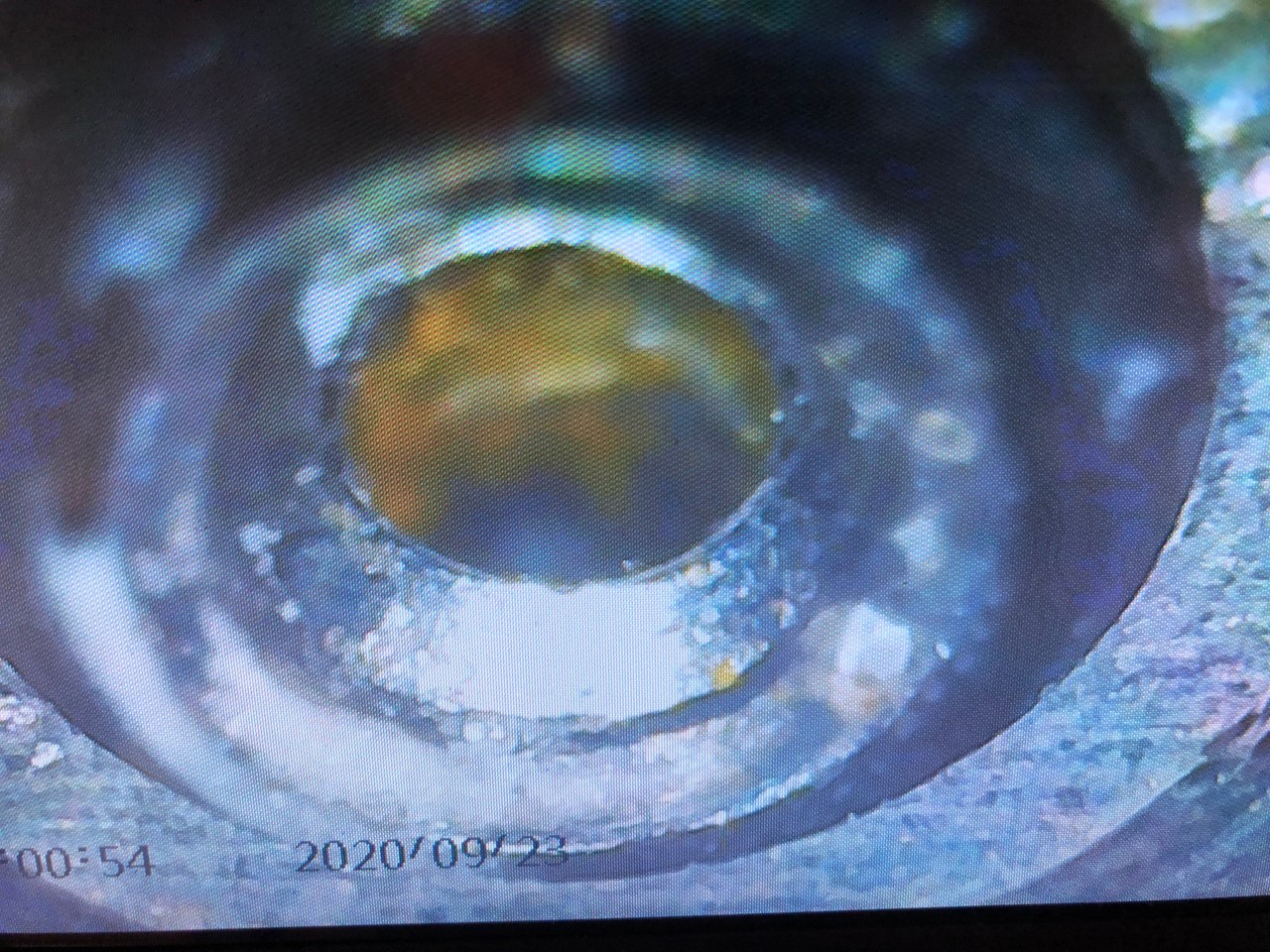

Sure, I appreciate that is the case, but this crown is unusual. I actually bought a split stem (male). Used alum powder to remove tho old stem that was snapped off in the crown and discovered there is a weird chamfered lip around the hole for the stem. The diameter of this is less than the internal hole. This meant that even though I could potentially thread the new split stem it would be too large to go through the lip. I even tried drilling this piece out but it did not go well.
This is a close up of the issue.
