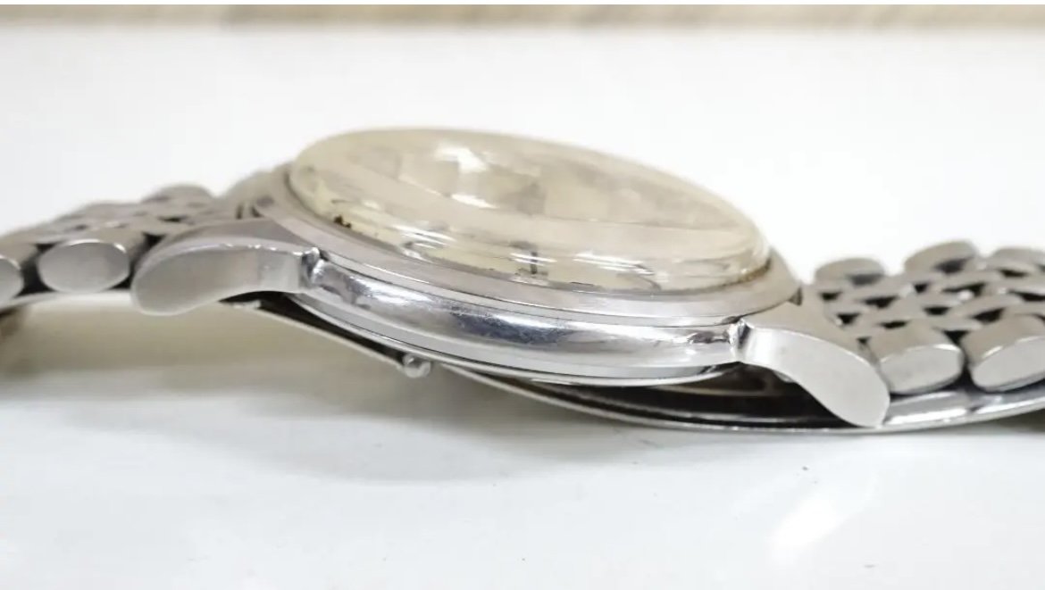

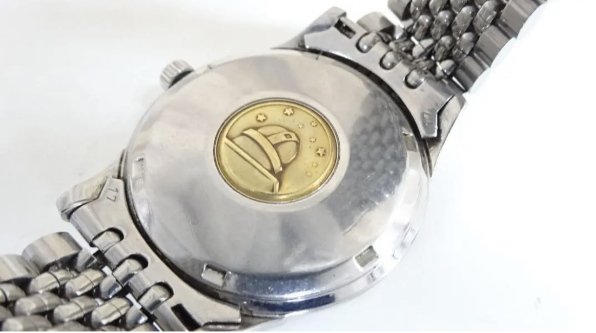

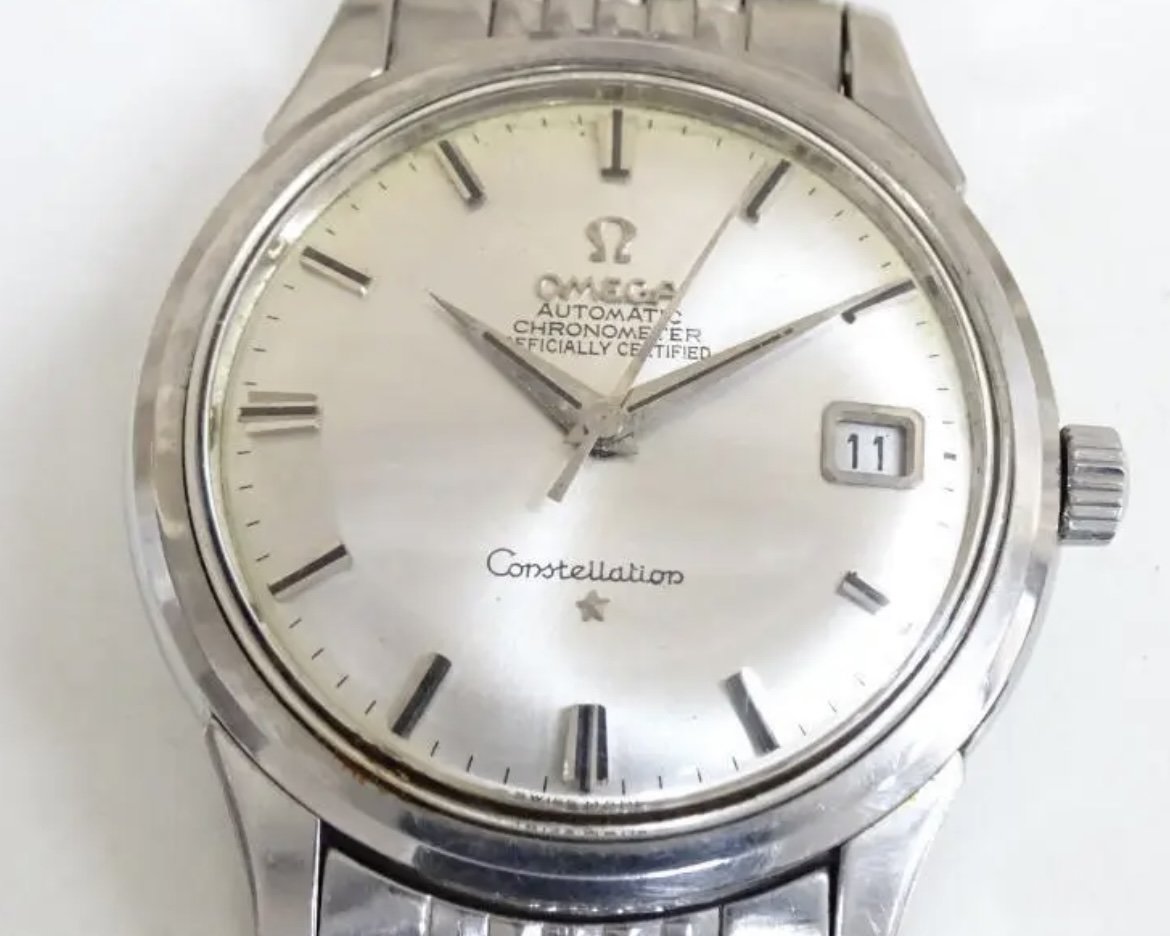

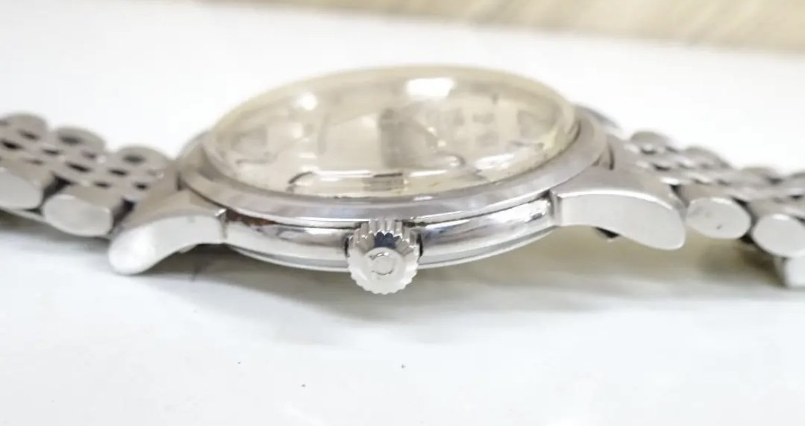

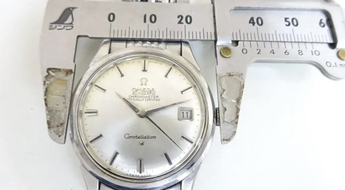

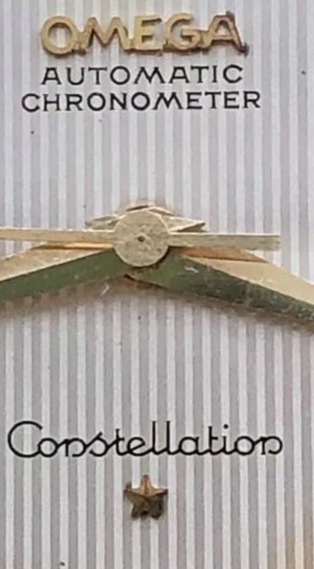

Posts 277 Likes 1,385 Andreas-am ·Aug 25, 2023 Hi together, I found a nice 168.001 in Japan. I think the case is OK, maybe a bit polished but not too much and the dial looks really good. What do you think about the condition and what can I spend for it? I think up to 1500€ is ok, isn't it? Thanks, Andreas

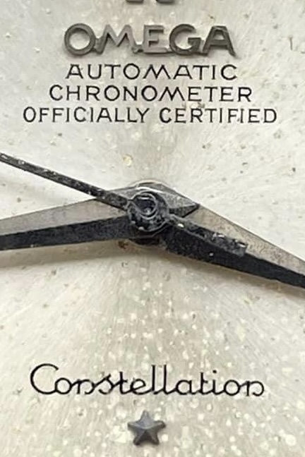

Posts 13,493 Likes 31,814 X350 XJR ·Aug 25, 2023·Vintage Omega Aficionado Redial and not a particularly good one. Fonts off as is the location of the printing. Note how close the printed text is in relation the the applied OMEGA.
Posts 277 Likes 1,385 Andreas-am ·Aug 25, 2023 Yes, you are absolutely right! The writing looks really bad - I need to be more calm when I see a good offer. 🤦 I'm glad I didn't just buy it. 🙄 Thanks, Andreas
Posts 1,024 Likes 4,126 qazwsx1 ·Aug 25, 2023 The font of ref .168.001 with and without “officially certified” should be look like this.😁
