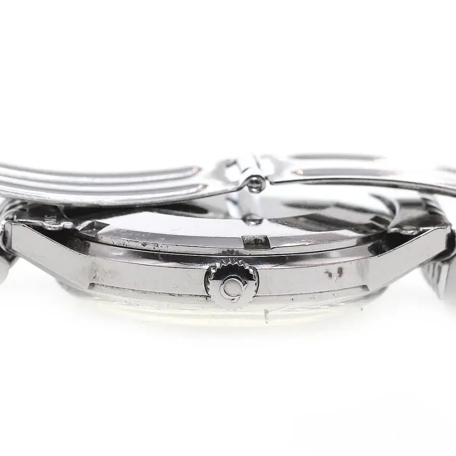

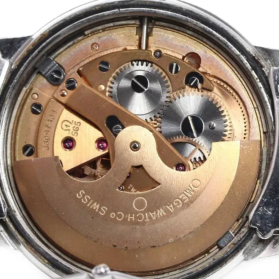

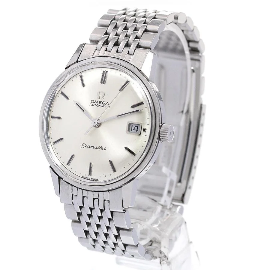

Hi everyone!

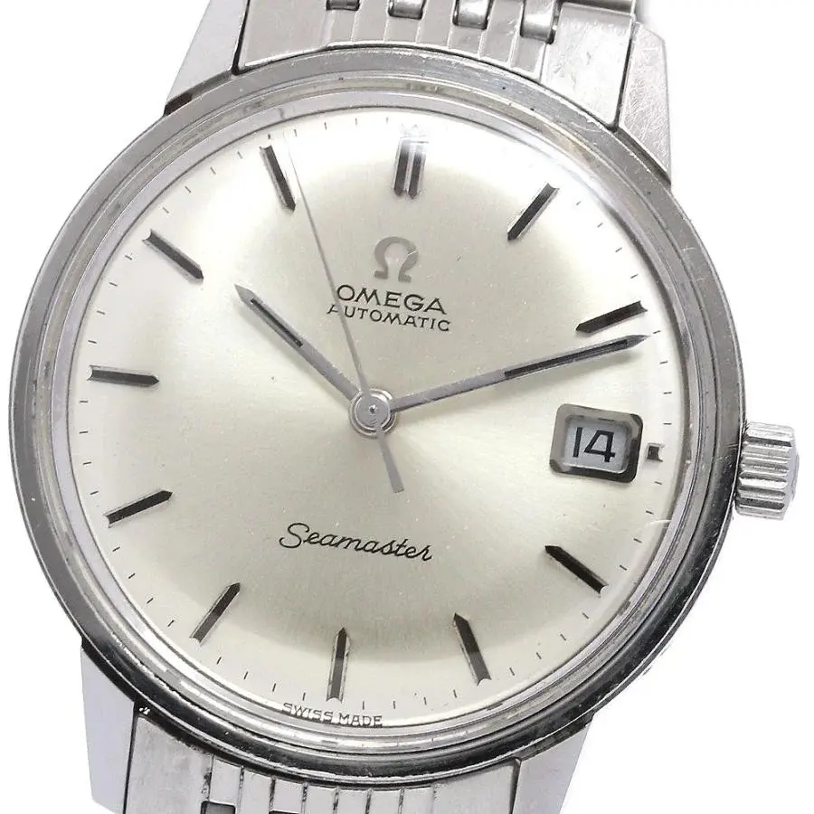

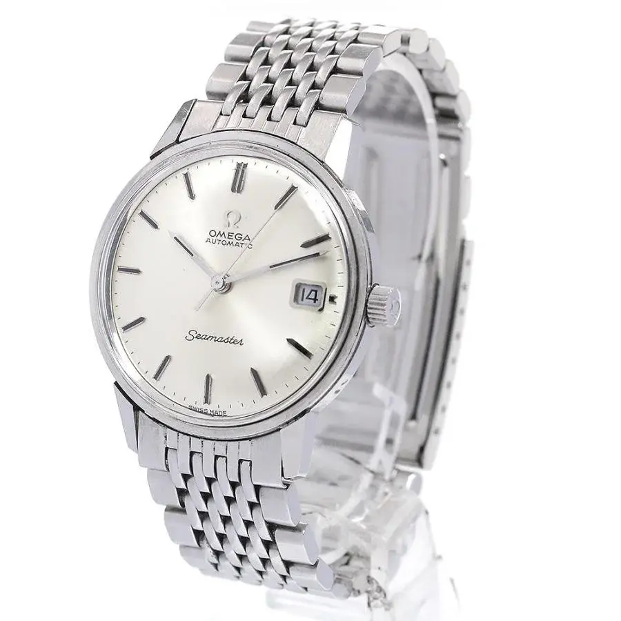

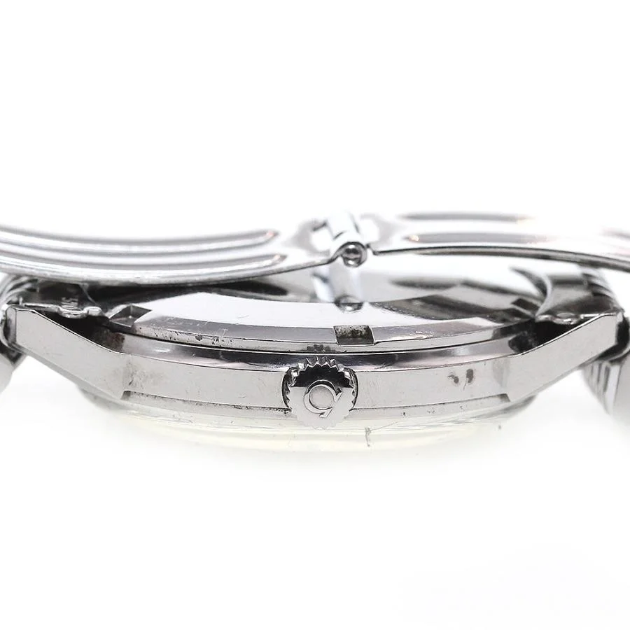

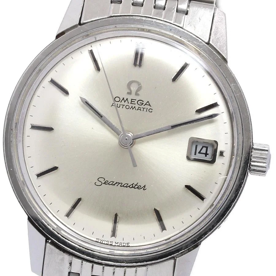

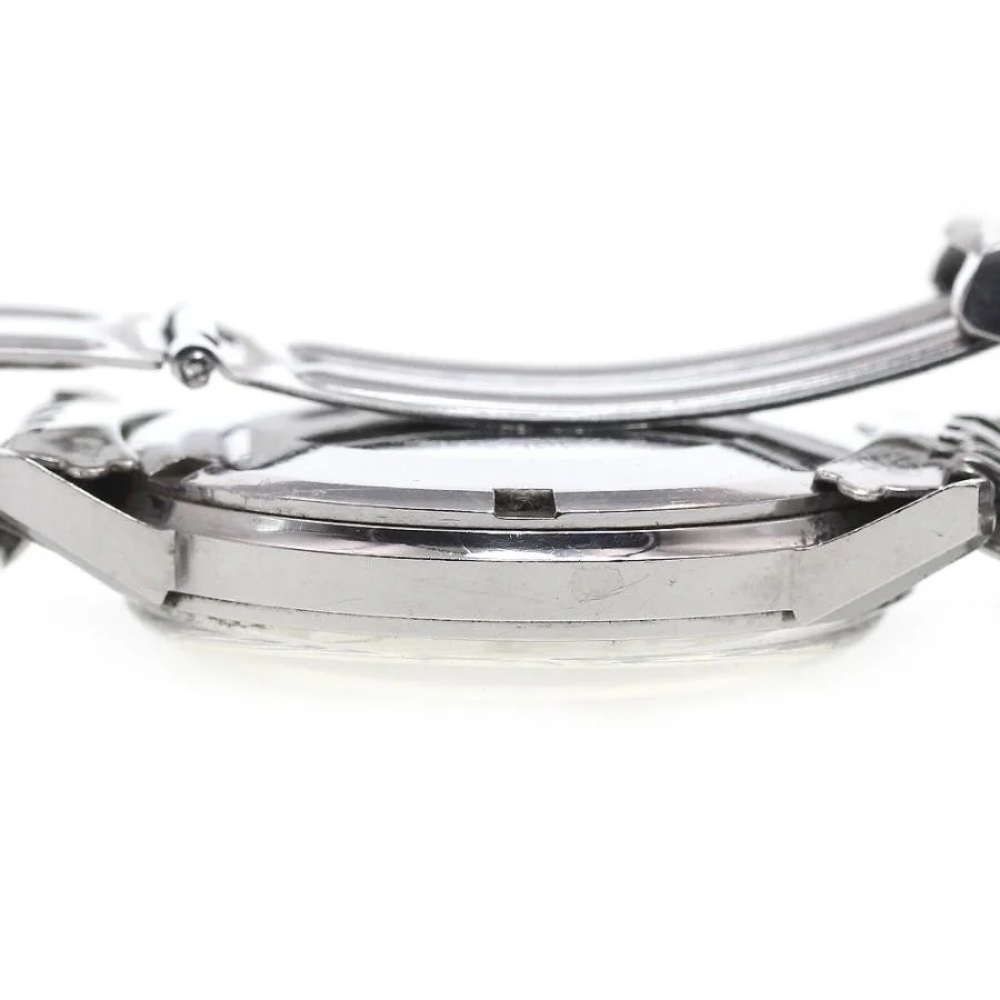

I wanted to get a second opinion on this Seamaster. To my untrained eye, and from what I have been learning on here, it looks generally fine. I am confused with the dial, esp. towards the bottom. Is that discoloration/ fading or just a glow/ angle issue? I think I can see a similar glow on other such watches.
Hands and crown look ok to me. I cannot see the Omega sign on the plexi but it otherwise seems good. Case and bracelet seem acceptable also.

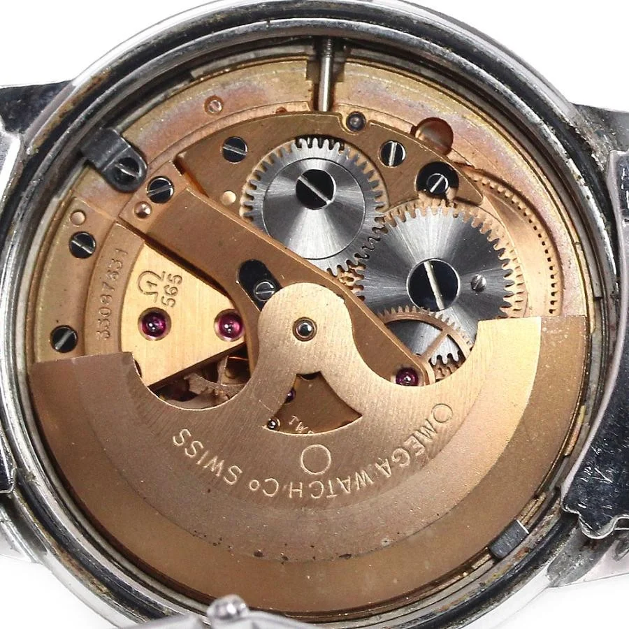

I know next to nothing about watch movements but this one seems a bit ... tired - especially the peripheral parts.

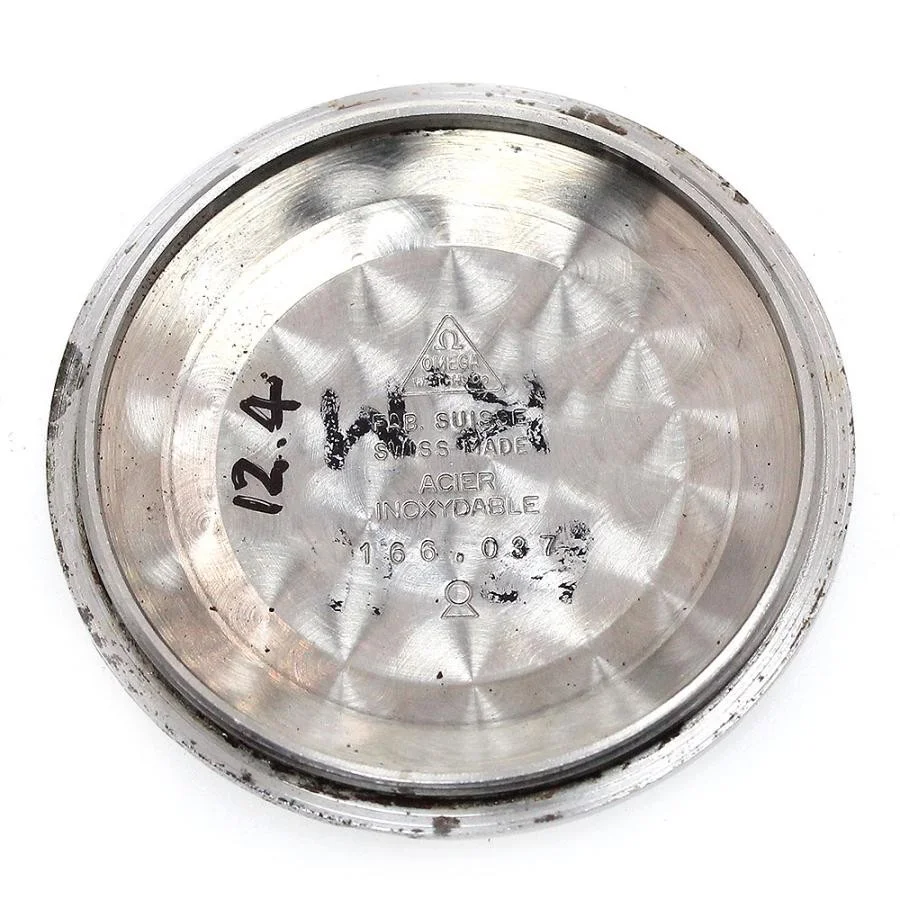

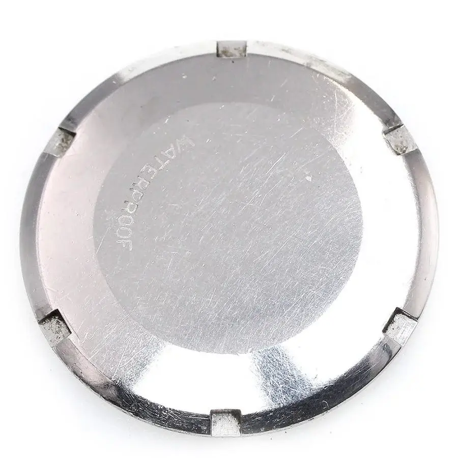

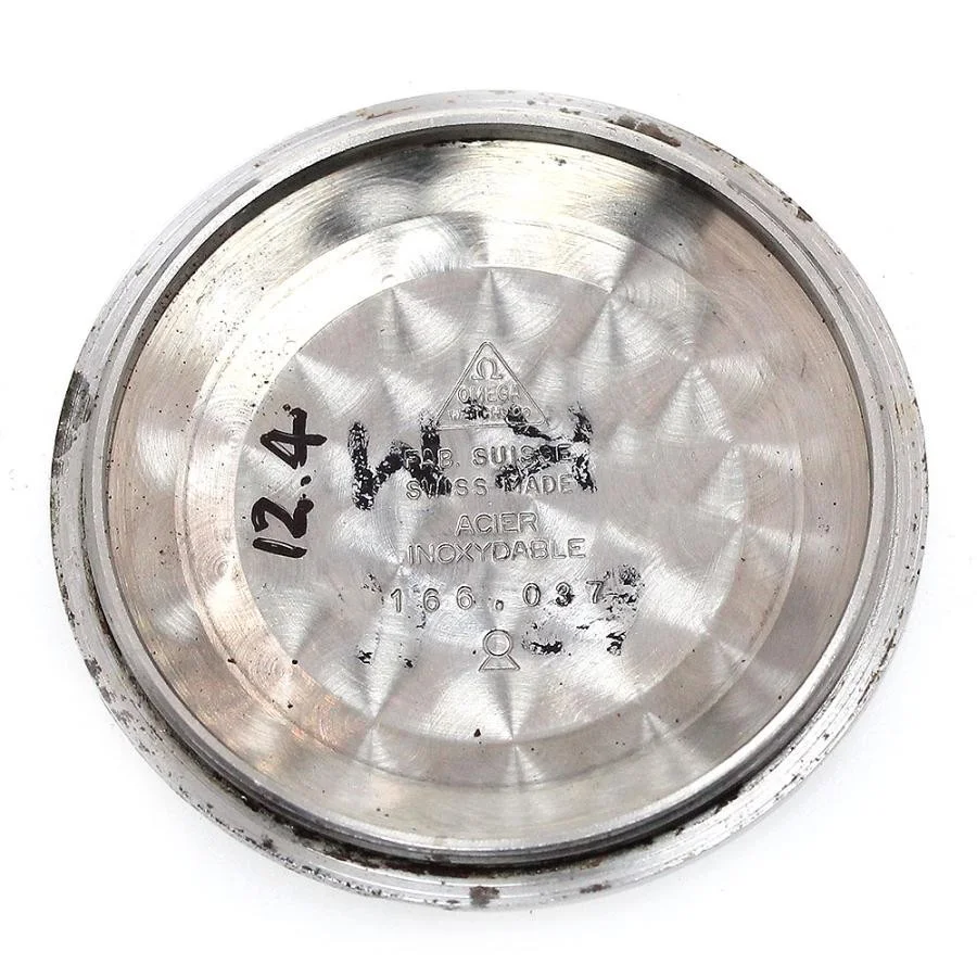

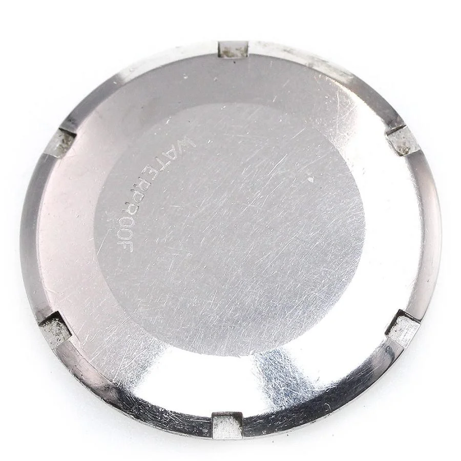

The back of the case is missing the usual 'Seamaster' and the hippo sign. These are usually present in other 166.037s.
Another thing is that there appear to be two or three Japanese sellers who buy these from each other and re-list them. Is this be a red flag? I came across this very watch twice or thrice while looking up other Seamasters.
And some comments on here from late last year mention that similar Seamasters can be found, with some patience, for $500-650. Needless to say, I have not encountered any for anything close to that!
Would appreciate any comments.
Thanks!

Overall, this watch looks correct to me.
The lighting is very bright white, making it tough to tell how the dial would look like under natural conditions. There is pitting in several areas. Unless there's proof of a movement service, assume you need one if you're planning to wear this watch daily. This reference (166.037) shows up as a Seamaster but also as a Geneve (and sometimes Seamaster + Geneve). I've seen examples with and without the hippocampus on the caseback. If that's important to you, wait for one that has it.
The same item may be cross-listed by several eBay sellers in Japan. Pick the seller who is offering the best deal and/or appears most reputable.
You should be able to find a Seamaster for $500 - $650 given enough patience.

Some points:
If you live outside Japan you will have to pay VAT on top if you import a watch from there.
If you take a closer look you see this:
Don't know what it is but if it was just dirt they probably would have removed it.

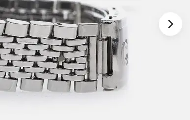

The bracelet is quite short and damaged:
So you have 800$ + Shipment (?) + VAT + a service for a not rare, medium quality watch
Where are you located btw?

Thank you. Yes, the VAT is a serious consideration. It is 20% if imported to the UK (current location) but I think does not apply if imported to the US (winter location). If the de minimis exemption still exists, that is, and for watches under $800.
I have been sticking to the $750-800 price range because it is nearest to the $500-650 range mentioned on this forum for this type of watch. There are some Seamasters at $950 and up that are Near Mint and would be more straightforward to buy, in terms of condition, but prices are starting to get out of hand!
Something I have not done, but perhaps I should, is ask around at local stores and watchmakers. I had thought it would be easiest to find online, but has not been thus far!

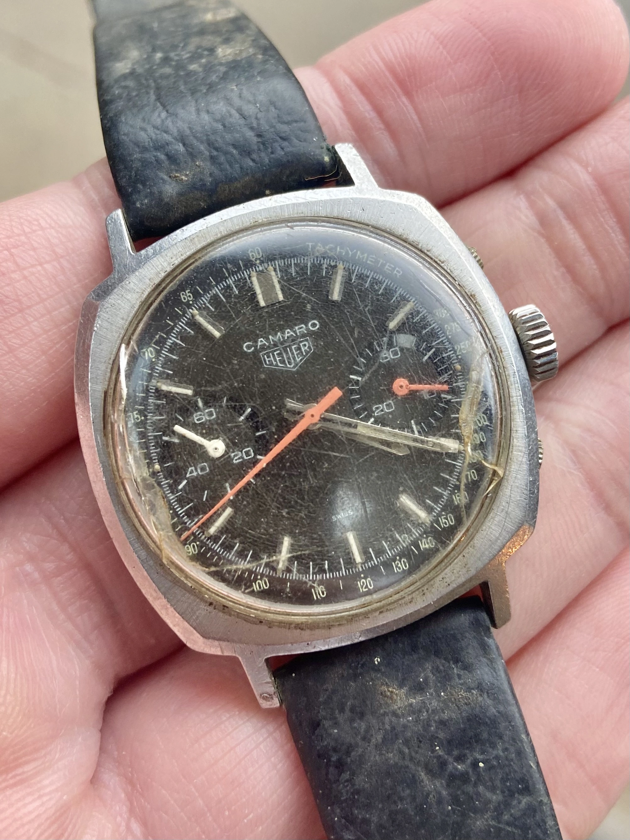

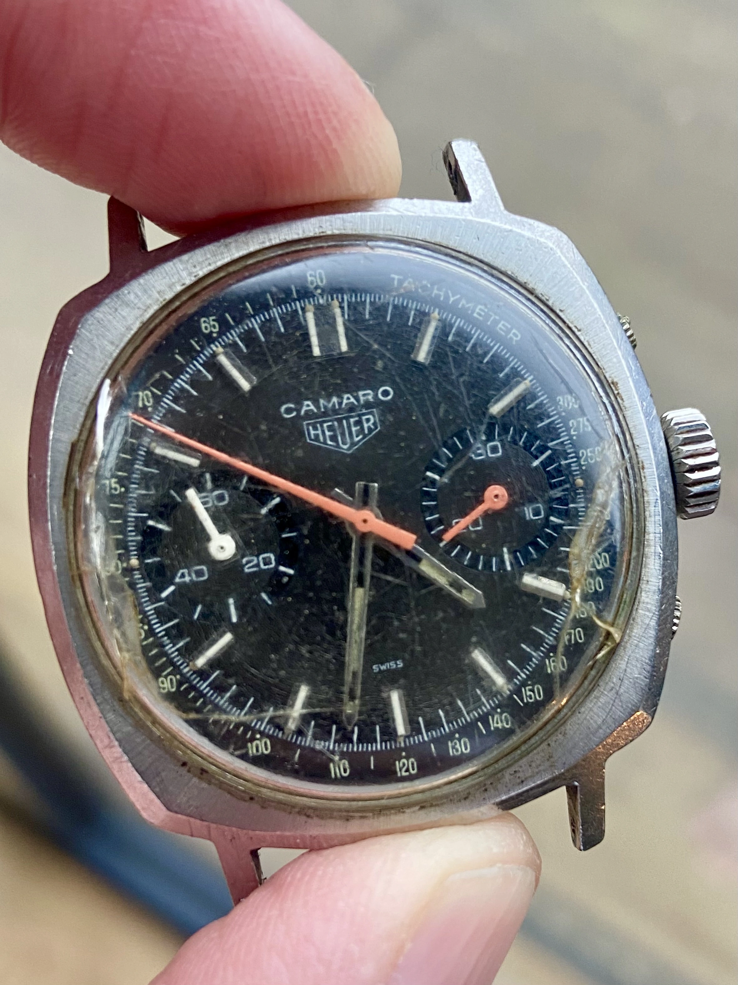

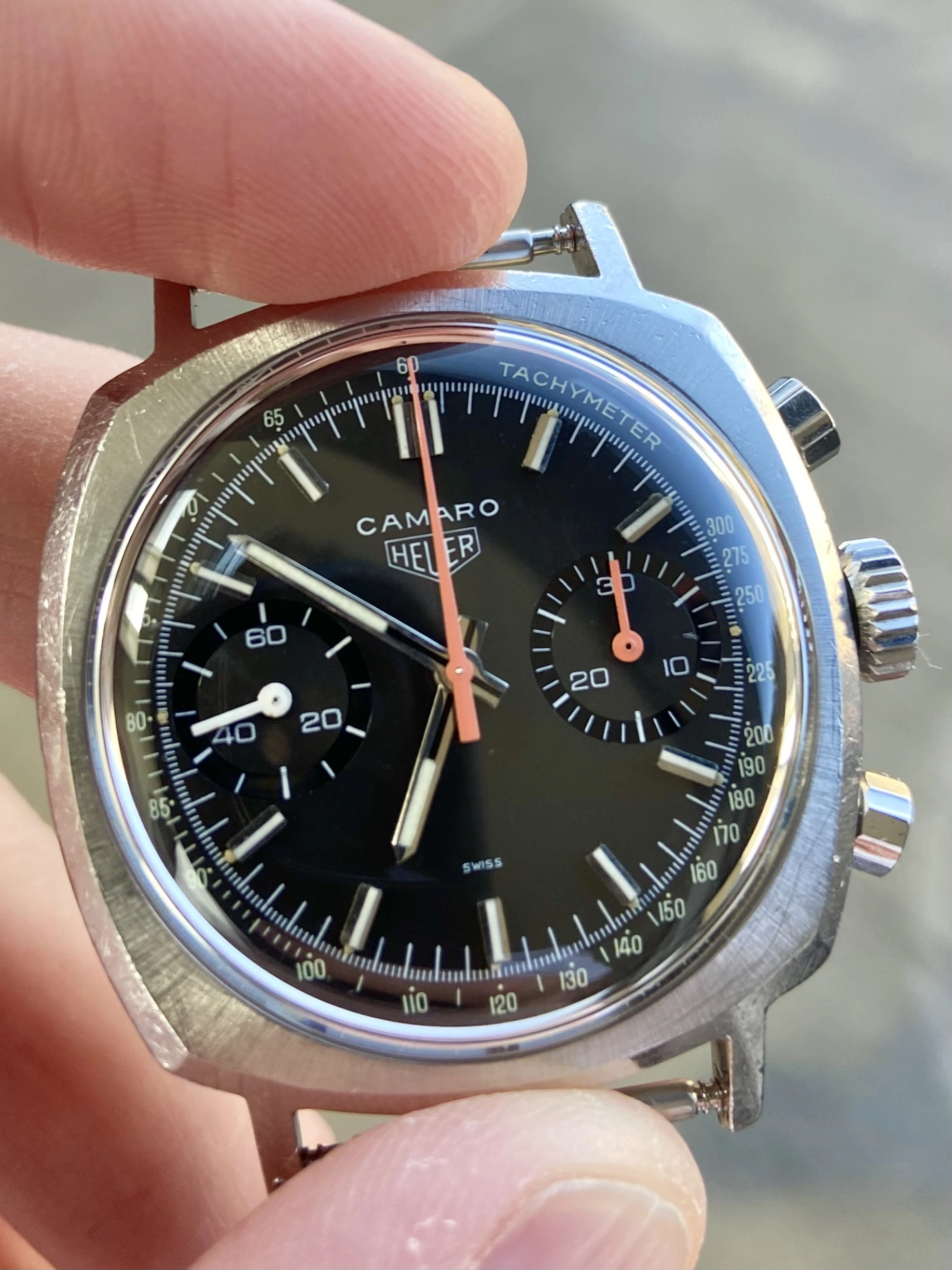

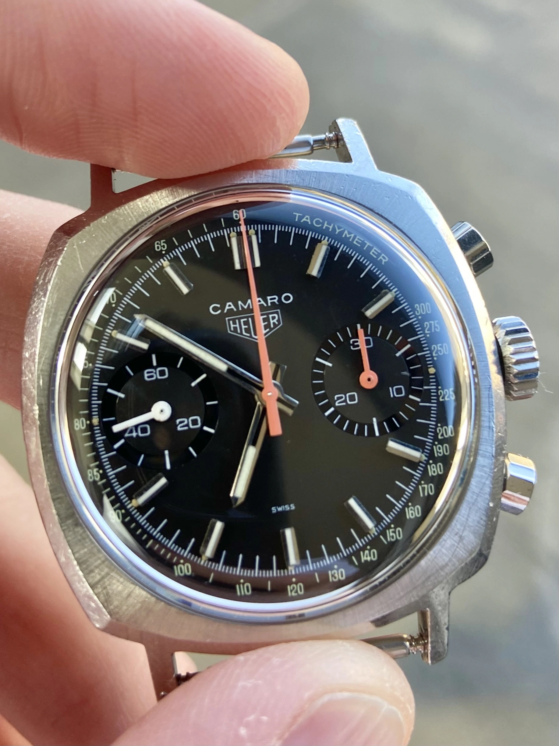

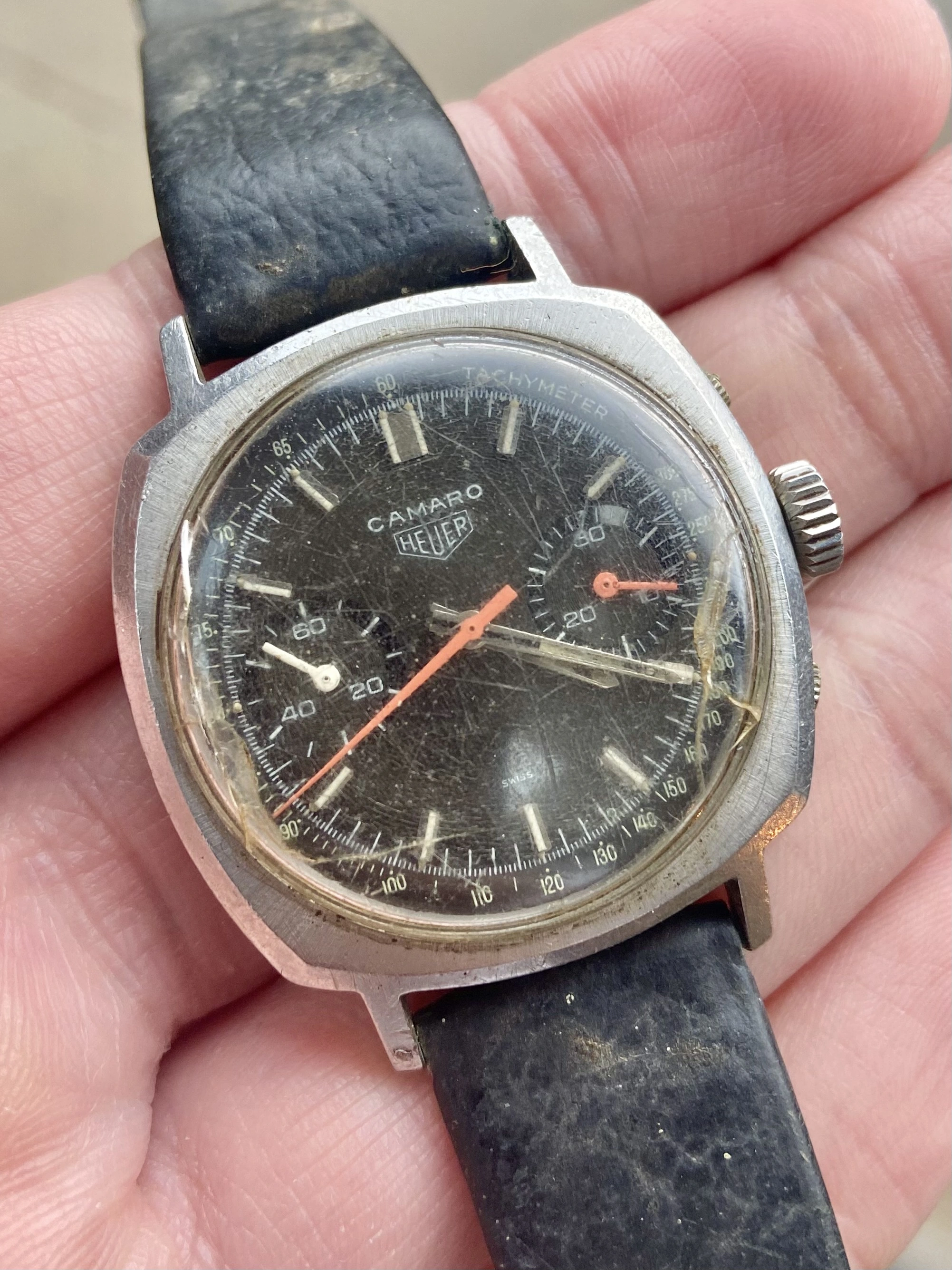

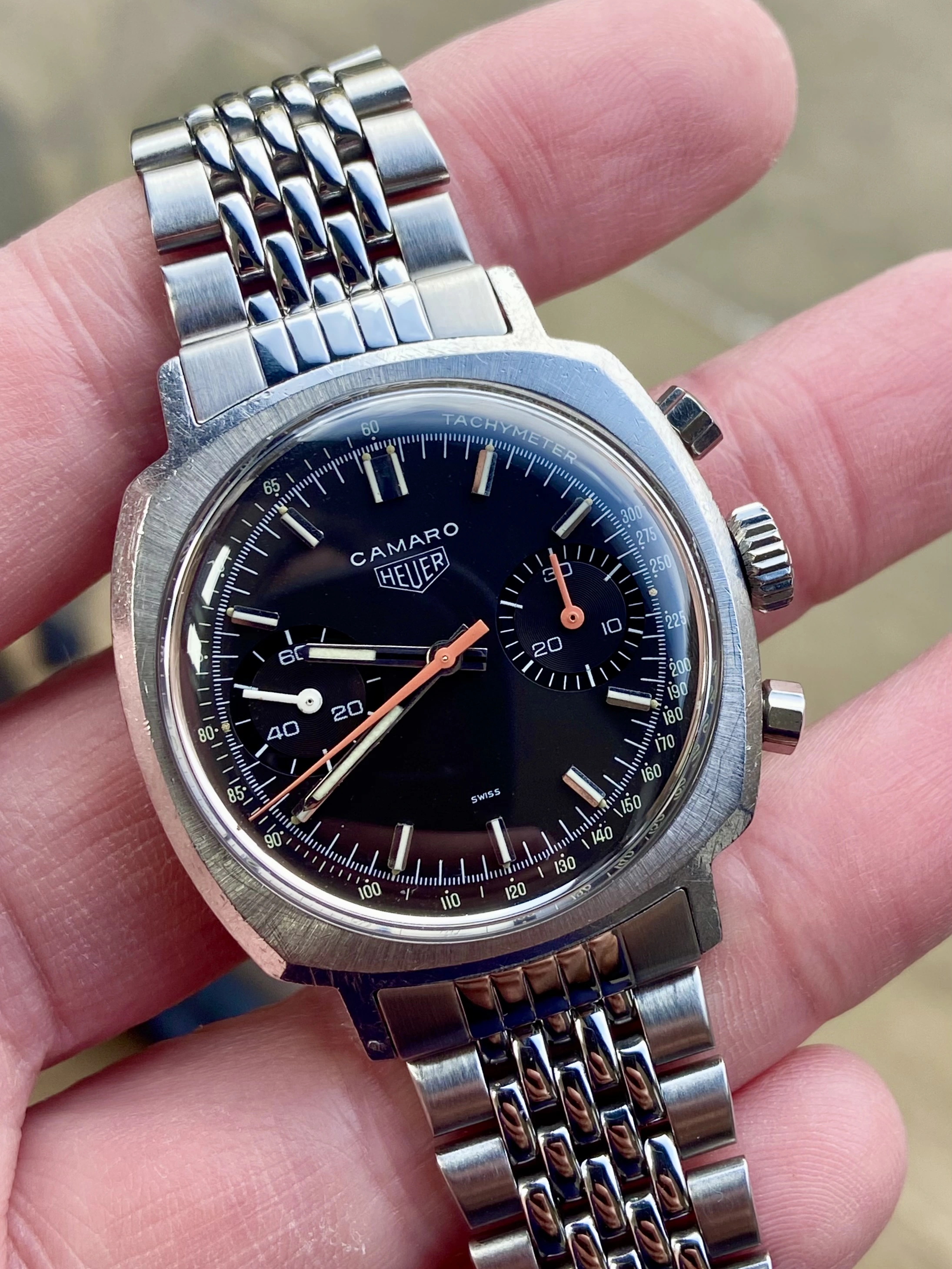

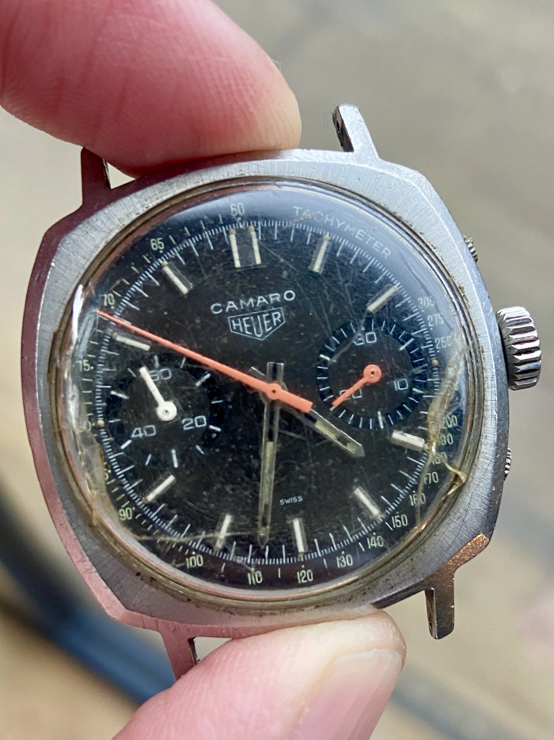

Regarding imperfections, you have to know what can be easily resolved and what can’t. For example, I always look for mint dials under a knackered crystal. Crystals can be swapped easily, as can crowns, but an overpolished case or damaged dial is what it is and can’t be improved easily.
To a layperson, a filthy watch with a terribly scratched crystal is a watch that needs a lot of work. To me, it’s an hour to clean it and replace the crystal and it looks immeasurably better if the dial is good.
Not an Omega but here’s an example. I got this cheap as it look horrendous. But the main components, dial, case, movement were solid. It ‘just’ needed a new crystal, pusher, clean, relume of the hands and full service. Had the dial been bad it would have been a no go.
