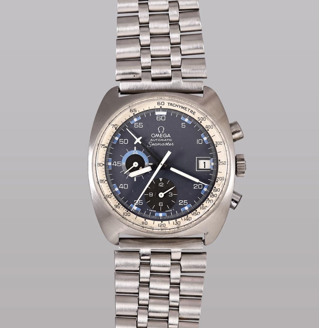

Hi there

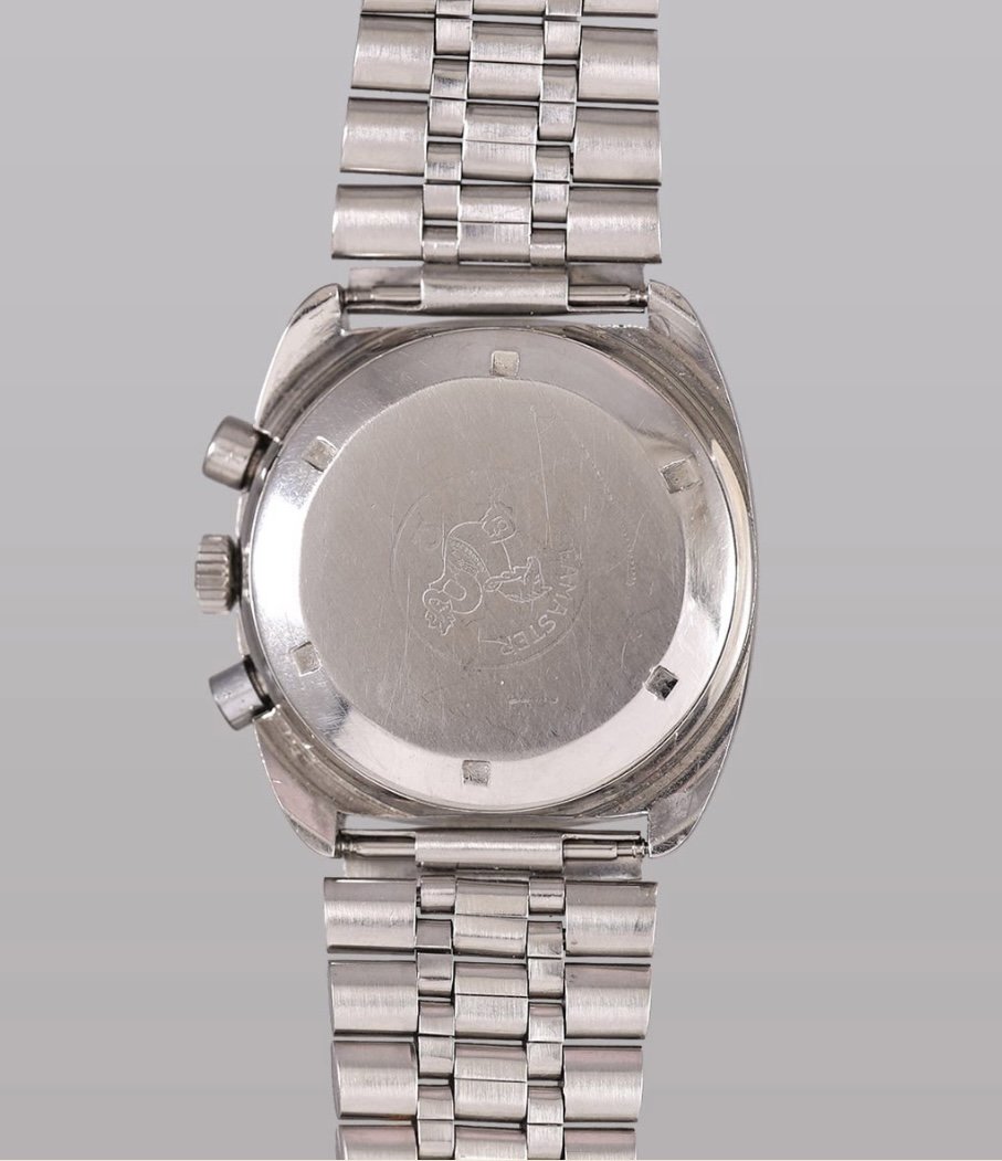

Wondering if anyone can offer advice on the originality of this 176.007
It looks ok to me (perhaps incorrect bracelet apart) but I’ve no doubt there will be peeps in here with more knowledge than I
Asking price is around $2200

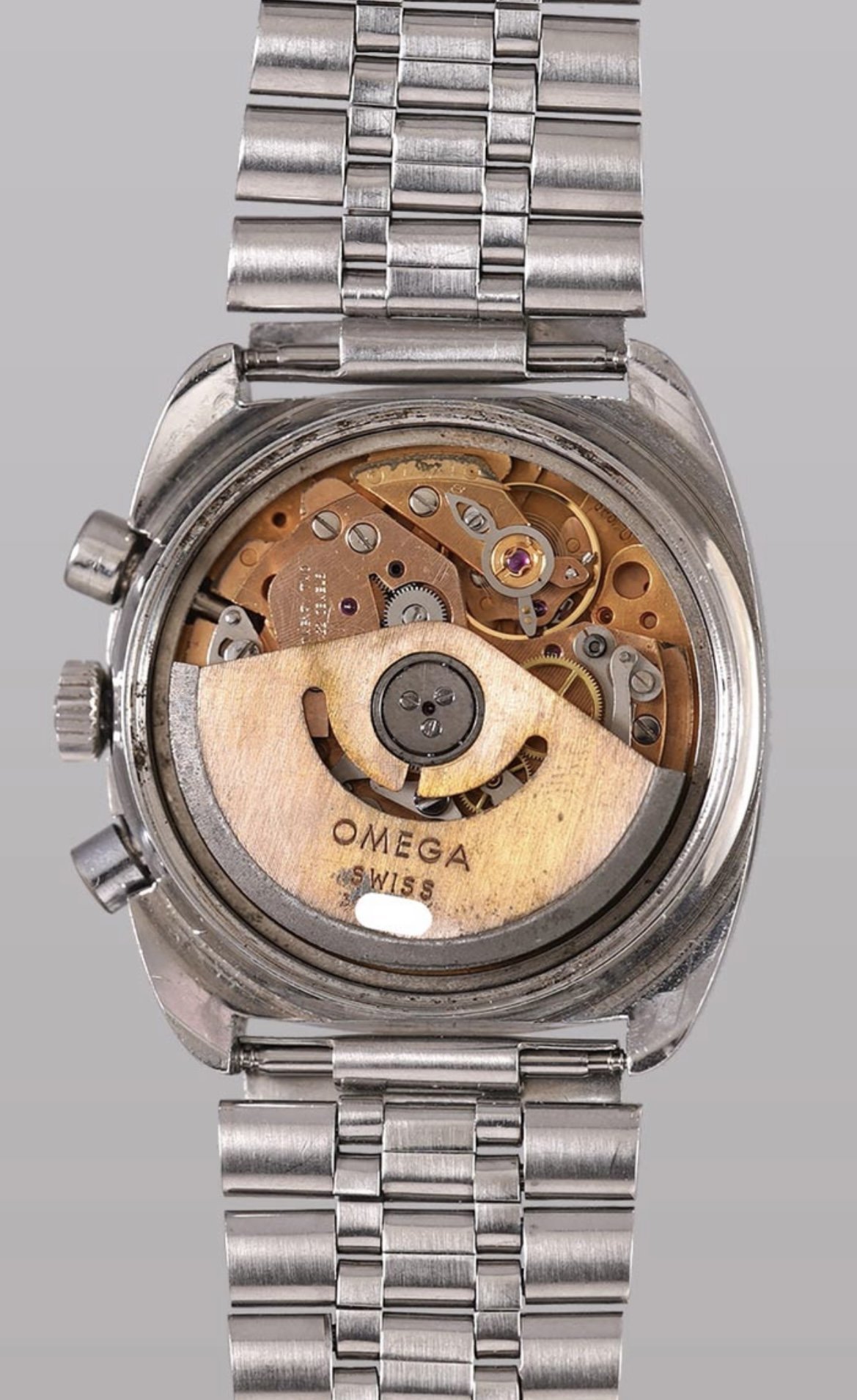

My thoughts are that the movement looks like it has seen some moisture. Normally they present a bit cleaner than that inside. I’ll let the more experienced chime in though.

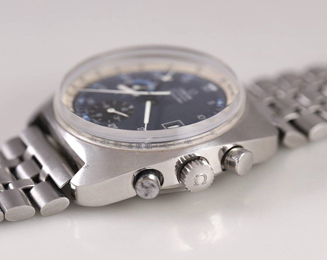

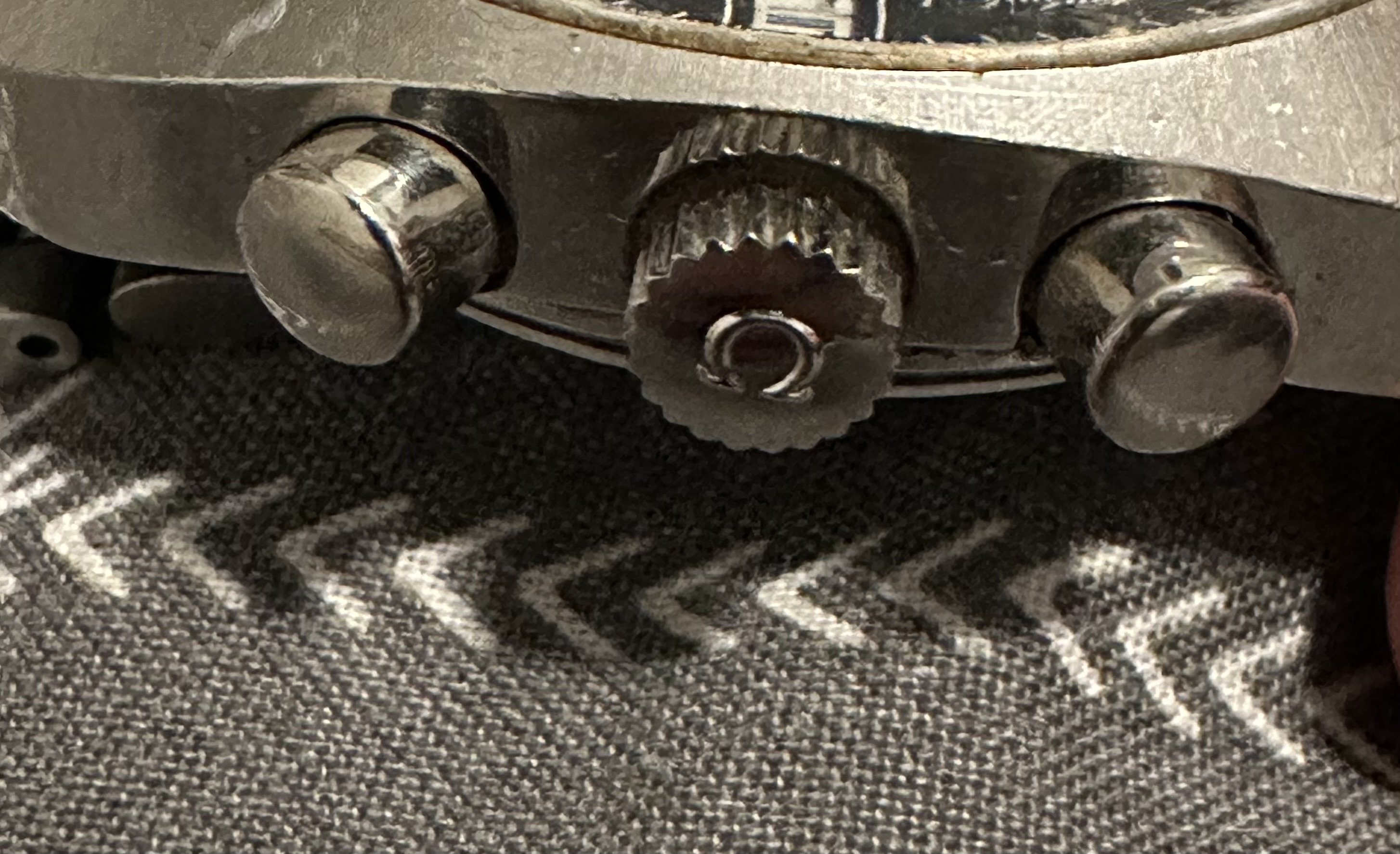

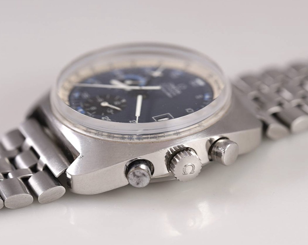

Oh and the pushers seem off. One is definitely the wrong size. Just had a look at mine.
Thankyou
I hadn’t spotted the differential size of the pushers
Agreed, the movement looks rough- so I probably should avoid
