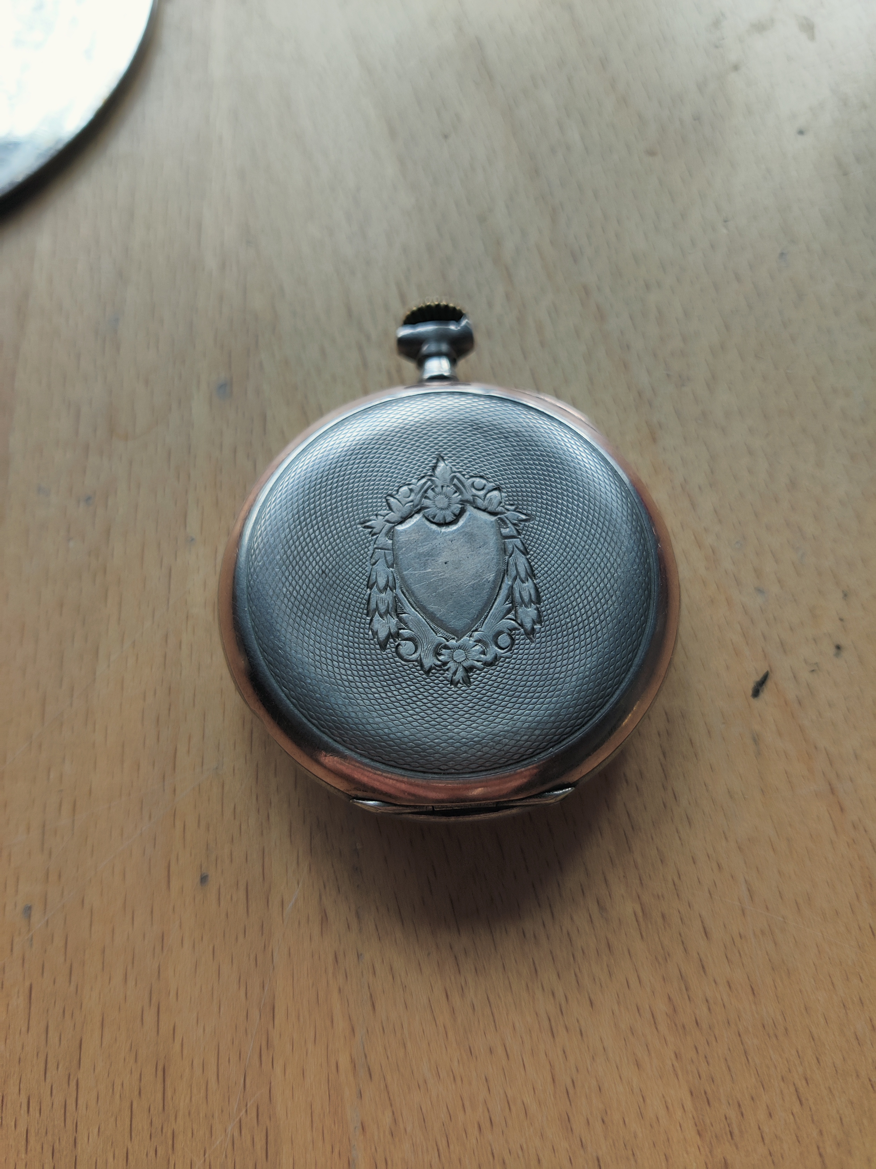

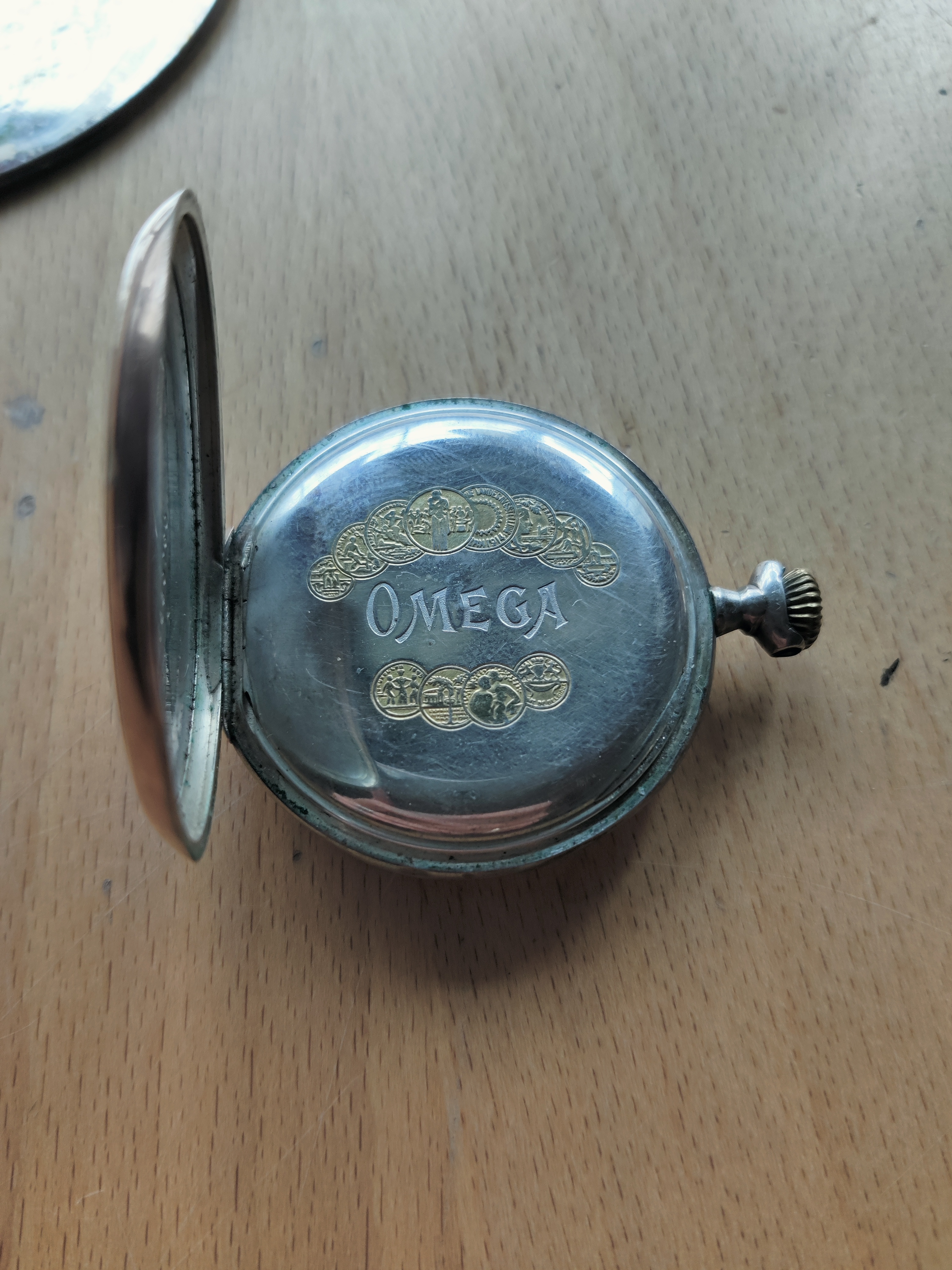

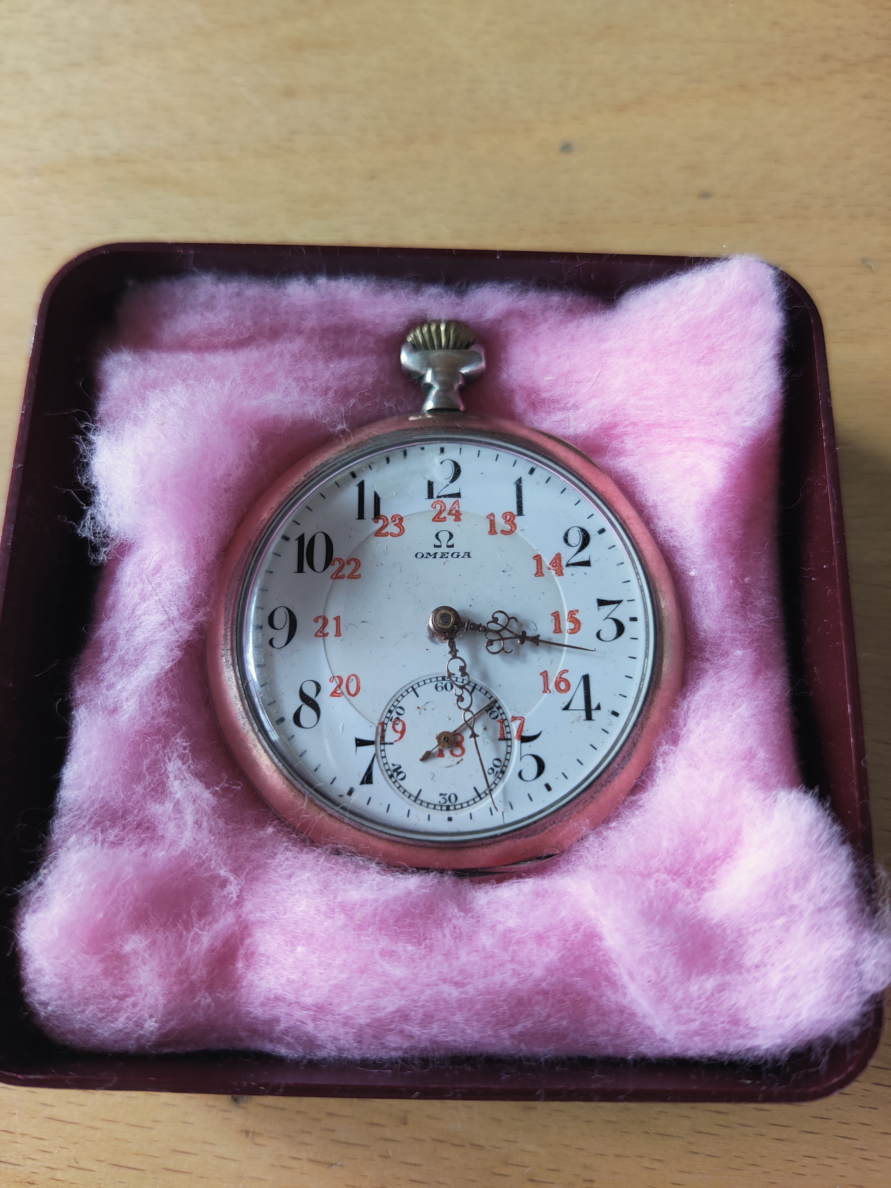

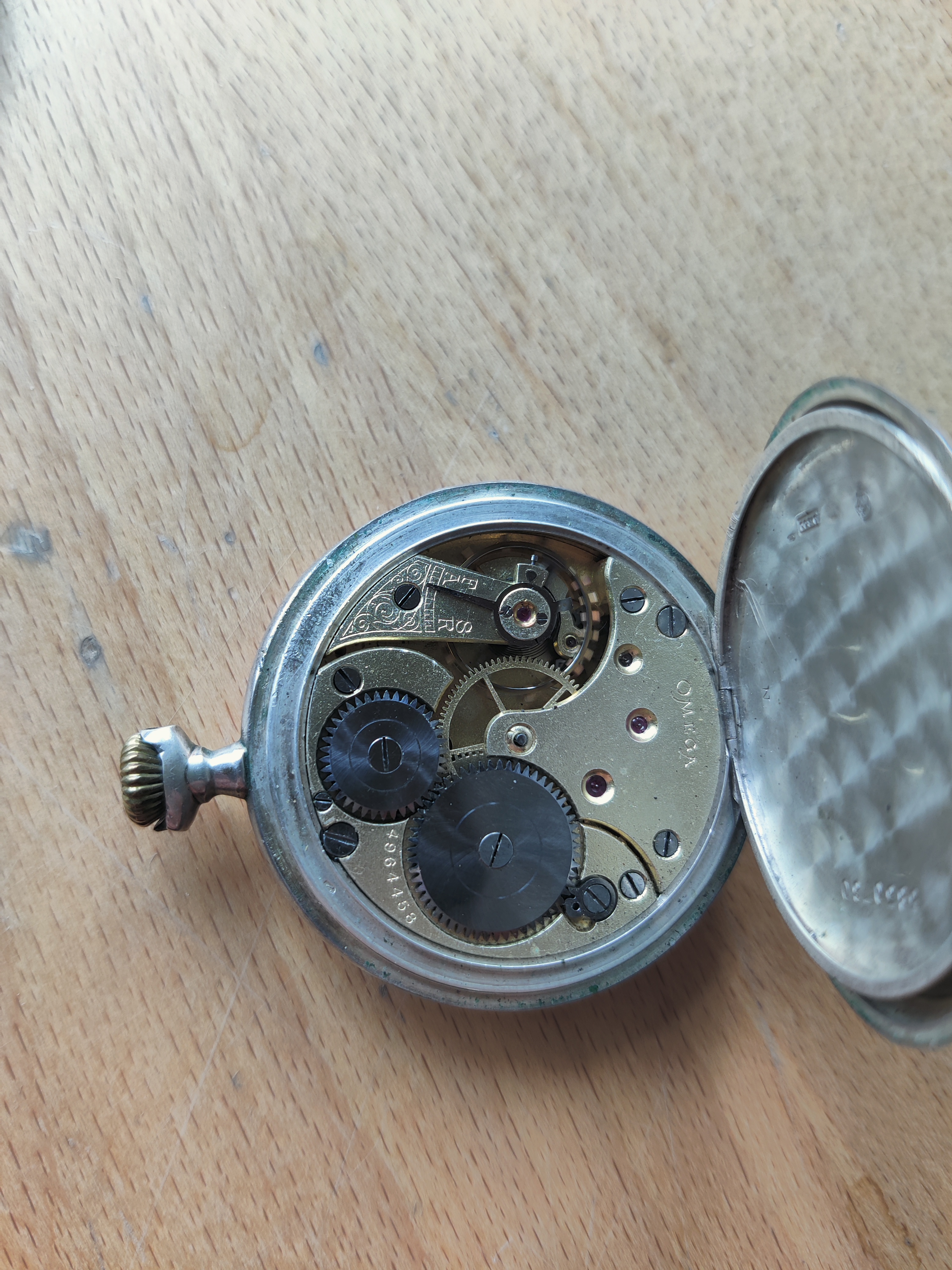

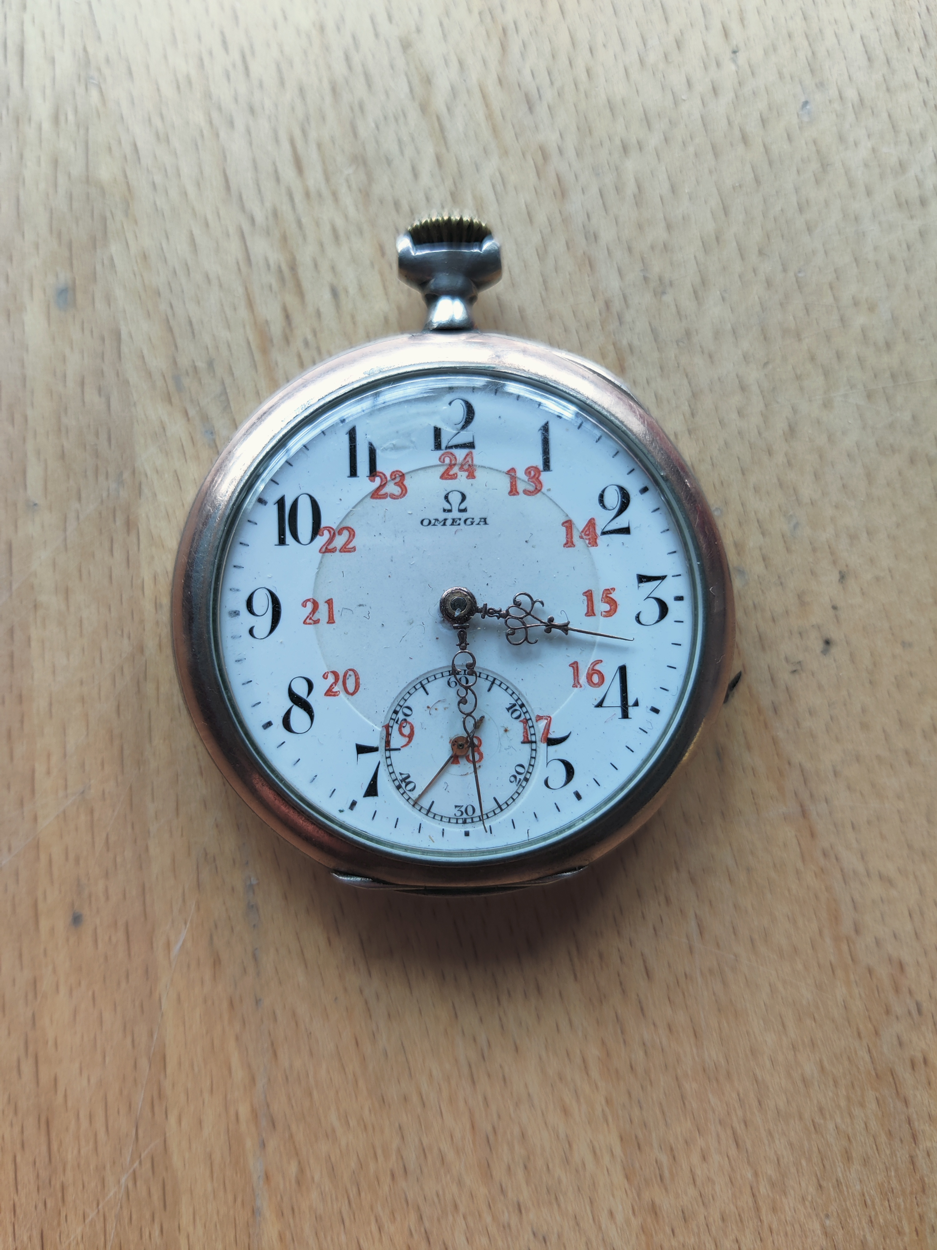

Hi! I recently received a pocket watch from my beloved grandmother. She was clearing out some old drawers and figured this would be a great gift for my birthday.
I know very little about Omegas, even less about Omega pocket watches. Therefore I'm reaching out to the forums, from where I've received wonderful help before.
I'm looking for any kind of information about the year of manufacture, movement etc. Any and all information will be greatly appreciated.

Looks like an old Omega pocket watch. The serial number days it to between 1910 and 1914, and the movement looks like the venerable of 19 ligne. The bow should be fairly easy to source or have made.
