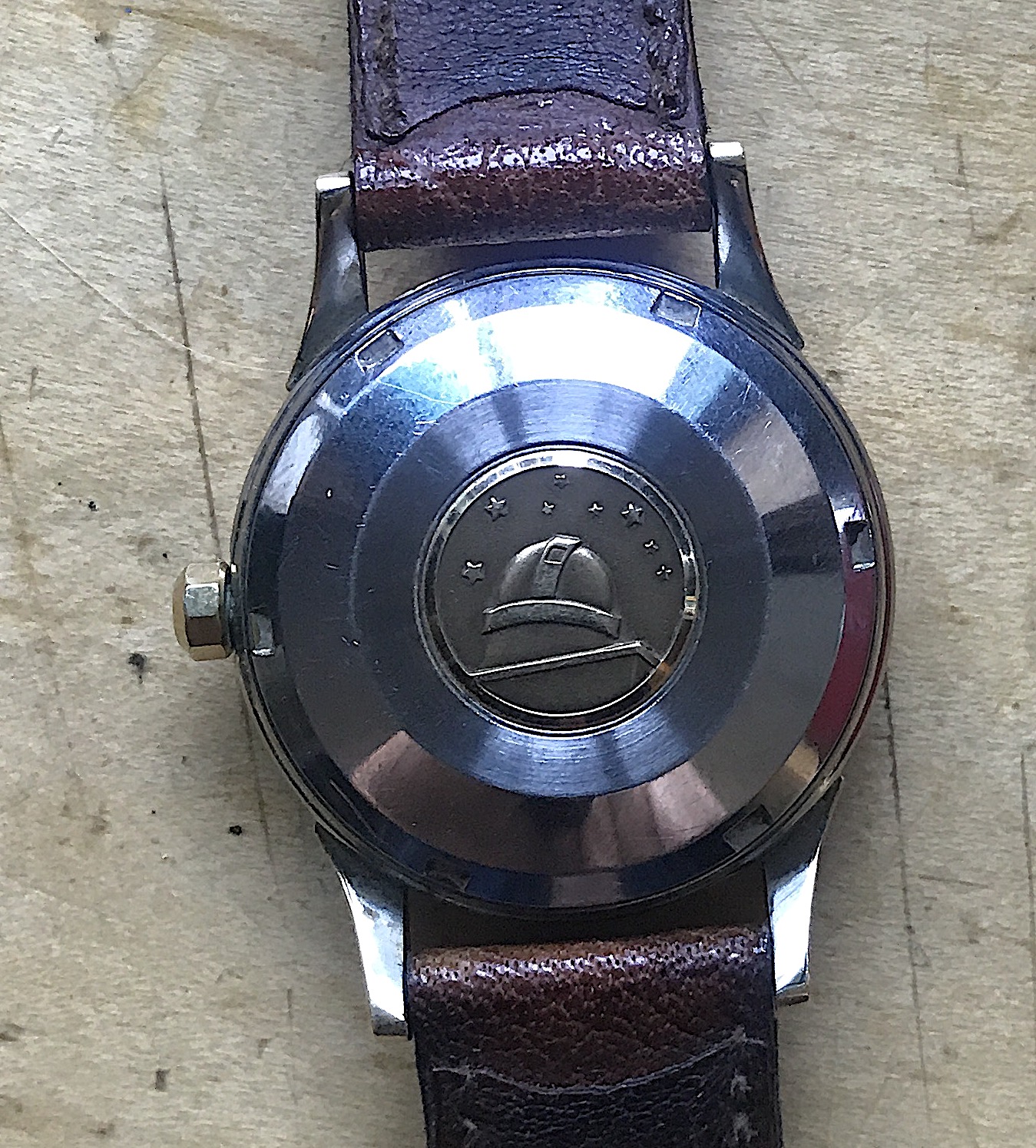

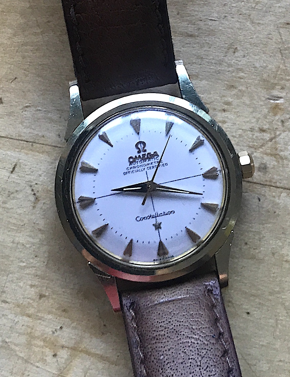

I have an Omega Constellation Pie Pan, Movement 505, screw case 2887 serial number dates it as 1956. I'd like to know if it's original or has been altered and if possible a value. Thanks for any help.

Good looking case but unfortunately the dial has been repainted.
This will hurt the value significantly.
3,595
13,551
Pics with a higher resolution would help, but this is definitely a redial. The thickness of the fond, as well as the cross hair which doesn’t continue through the text are the biggest give-aways.
Also, it’s technically not a pie pan (or twelve edged dial), but a dome dial. There’s no edge between the inner part of the dial and the outter ring where it falls of.
Value is hard to say, as it depends. For a collector, it isn’t valuable as the dial was redone. For someone who doesn’t know or doesn’t care there might be value in this watch, but it’s somewhere in the upper half of triple digits.

Dial like that it’s worth less than half of a watch that the dial was untouched.

Though the overall watch case appears fine (case front and back are in good condition), the watch is significantly devalued by the re-painted dial. Feel sad to say that.

Nice case, caseback in good state. Ruined dial.
I can only see someone buying it for parts.
I think this is a bit over the top, this would make a fine watch for anybody except us Omega nerds.
