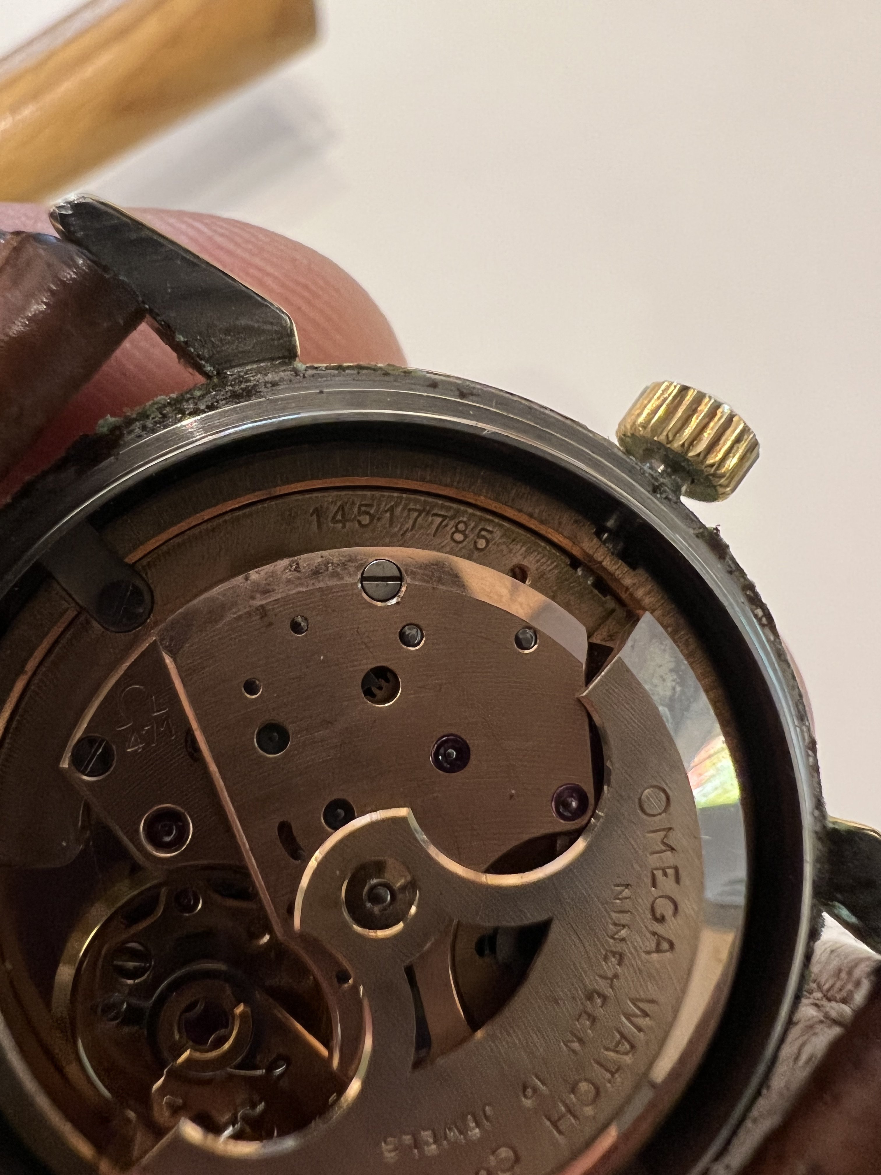

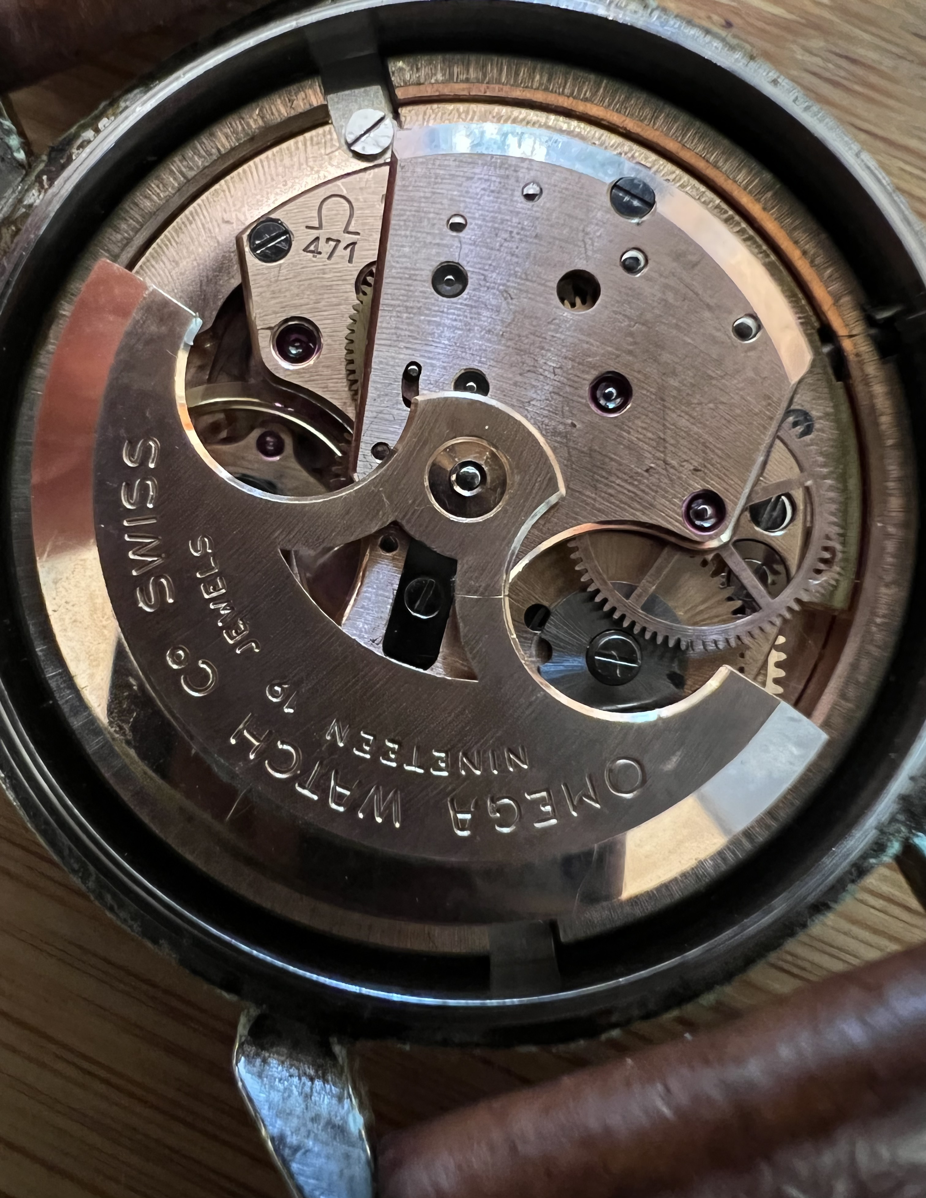

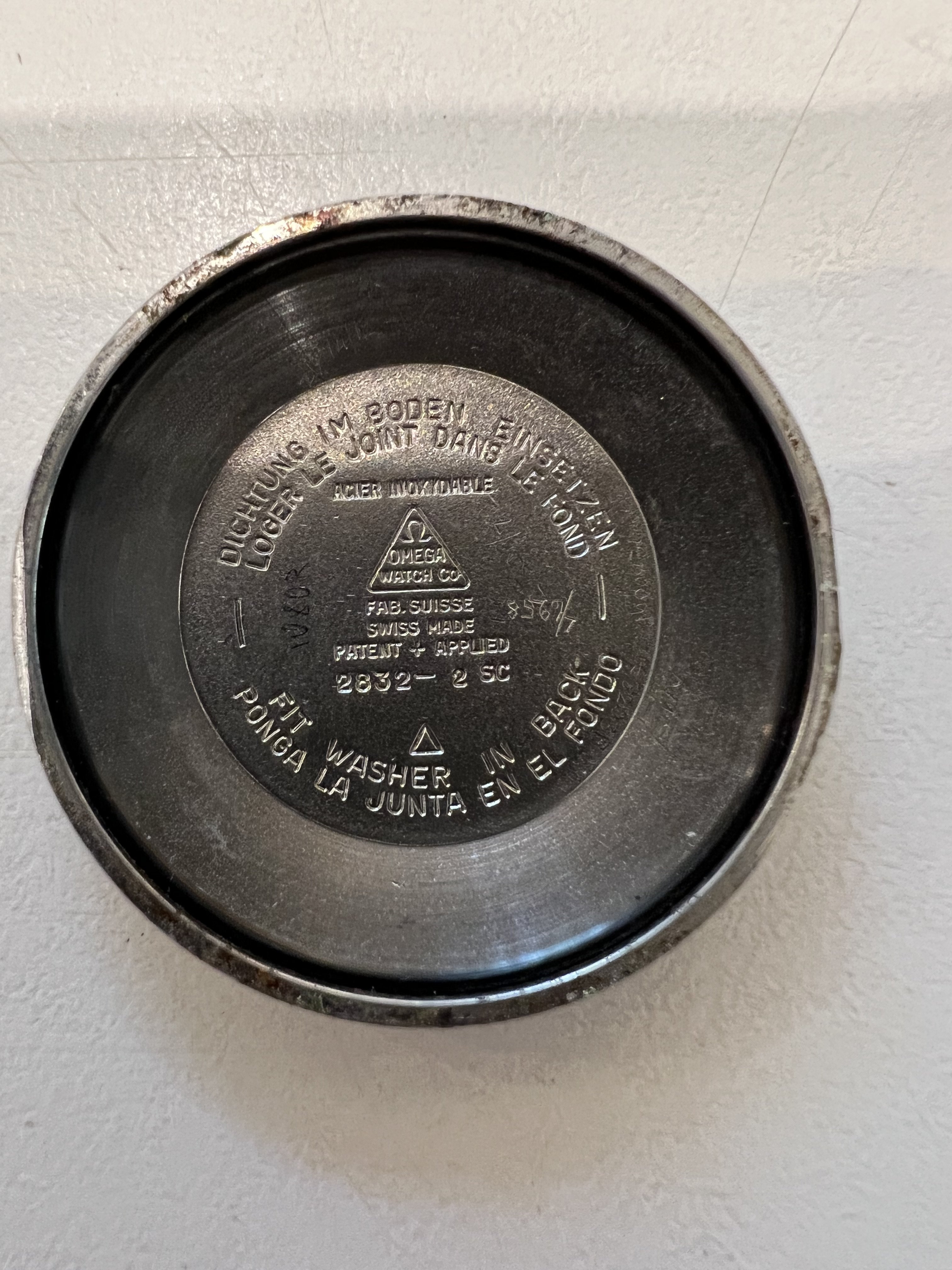

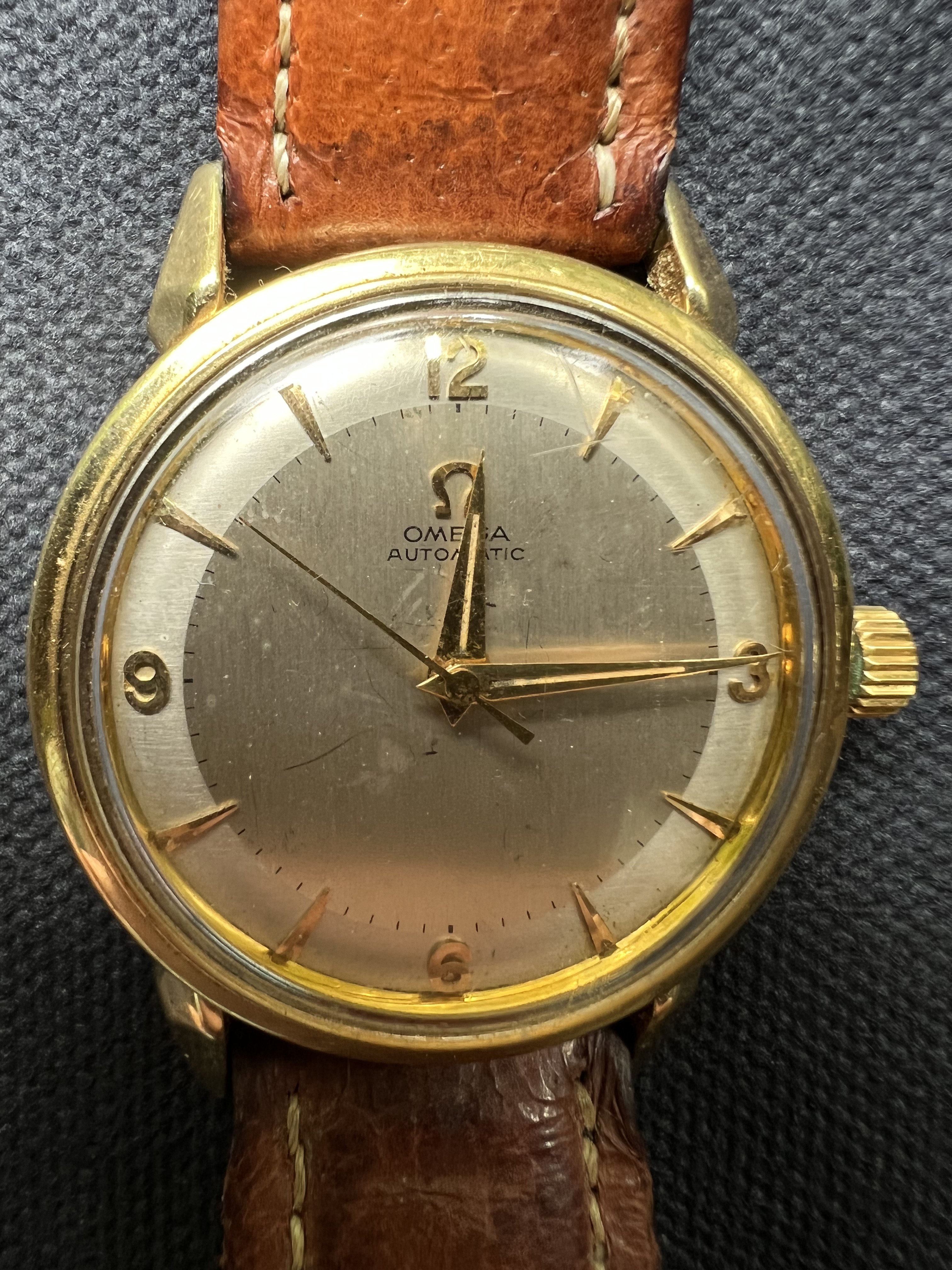

Found this watch in a friends estate.
Can anyone can give me any information on this watch ? Is it a sea master ? and any idea on its value?
all I know is it's probably 1954. It's running but losing time
Cheers
24,836
55,256
Yes, although this particular watch doesn't indicate it on the dial, I think it is actually a Seamaster, reference 2832. Gold capped, approximately 1955. Value will depend on condition, and it looks like the dial (which is the first thing you see) may have some damage.
You can get a sense of value by looking at sales on eBay and in the sales listings on the forum. Look for sales of stainless and gold-capped Seamasters from this era (without bracelets), and you will be able to figure an approximately range. Yours will not be at the top of the range, but you will probably get a sense of relative condition as you look.
18,840
39,183
Hour and minute hands also incorrect for this dial.
4,045
45,721

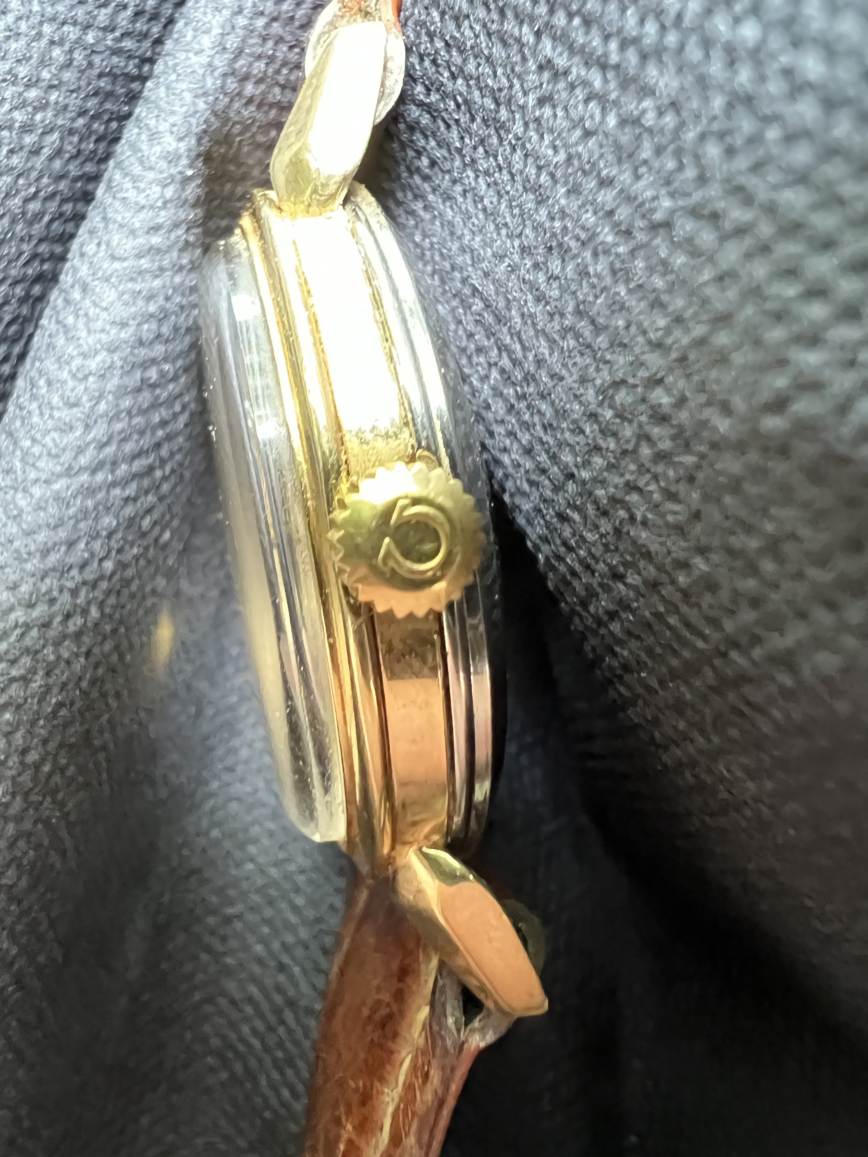

Is that the correct crown too?
