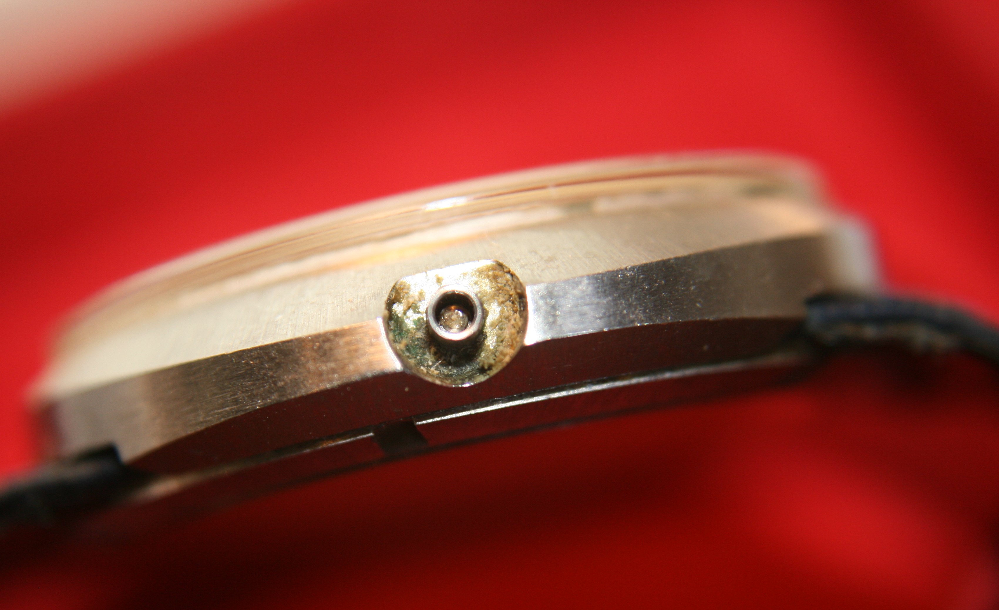

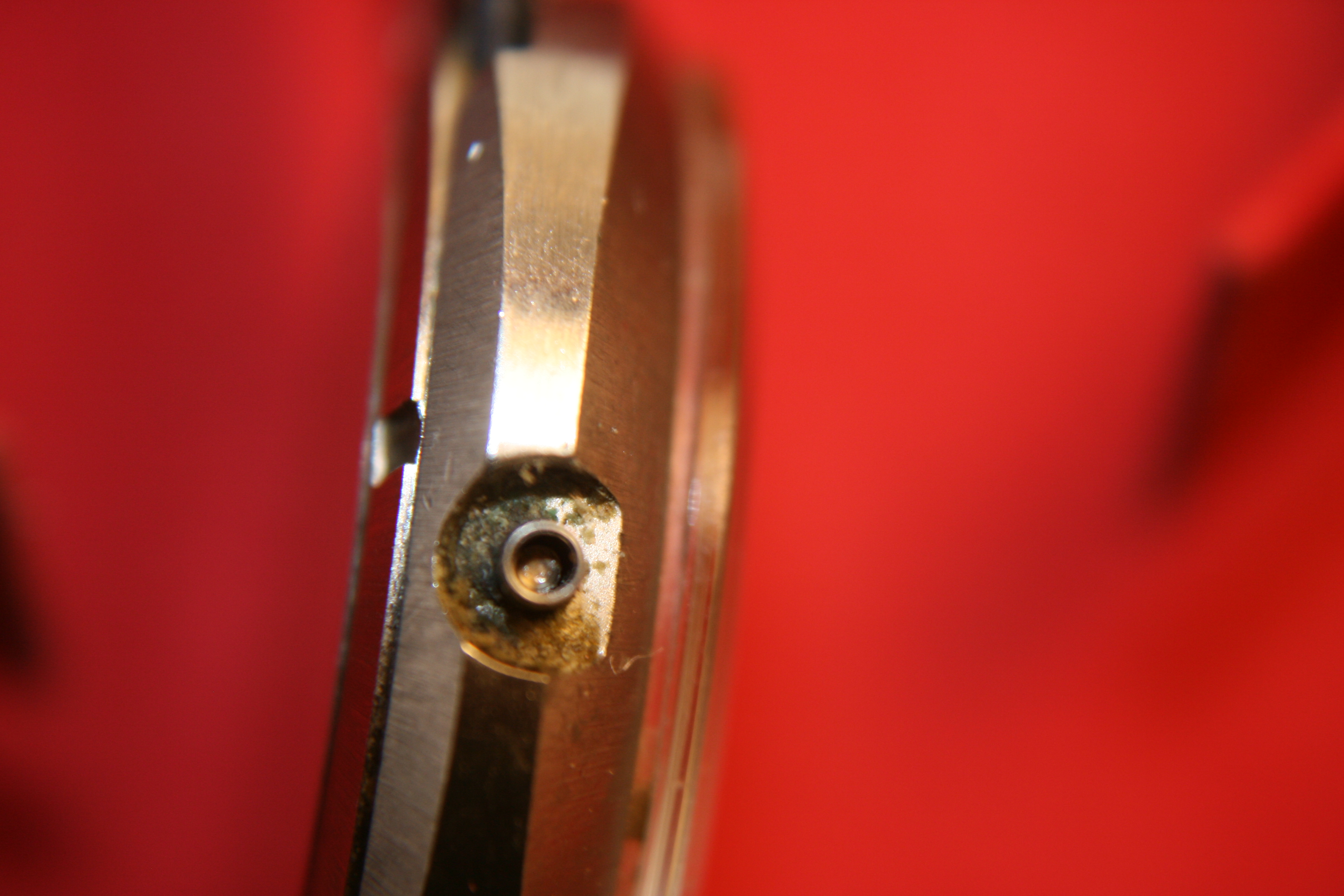

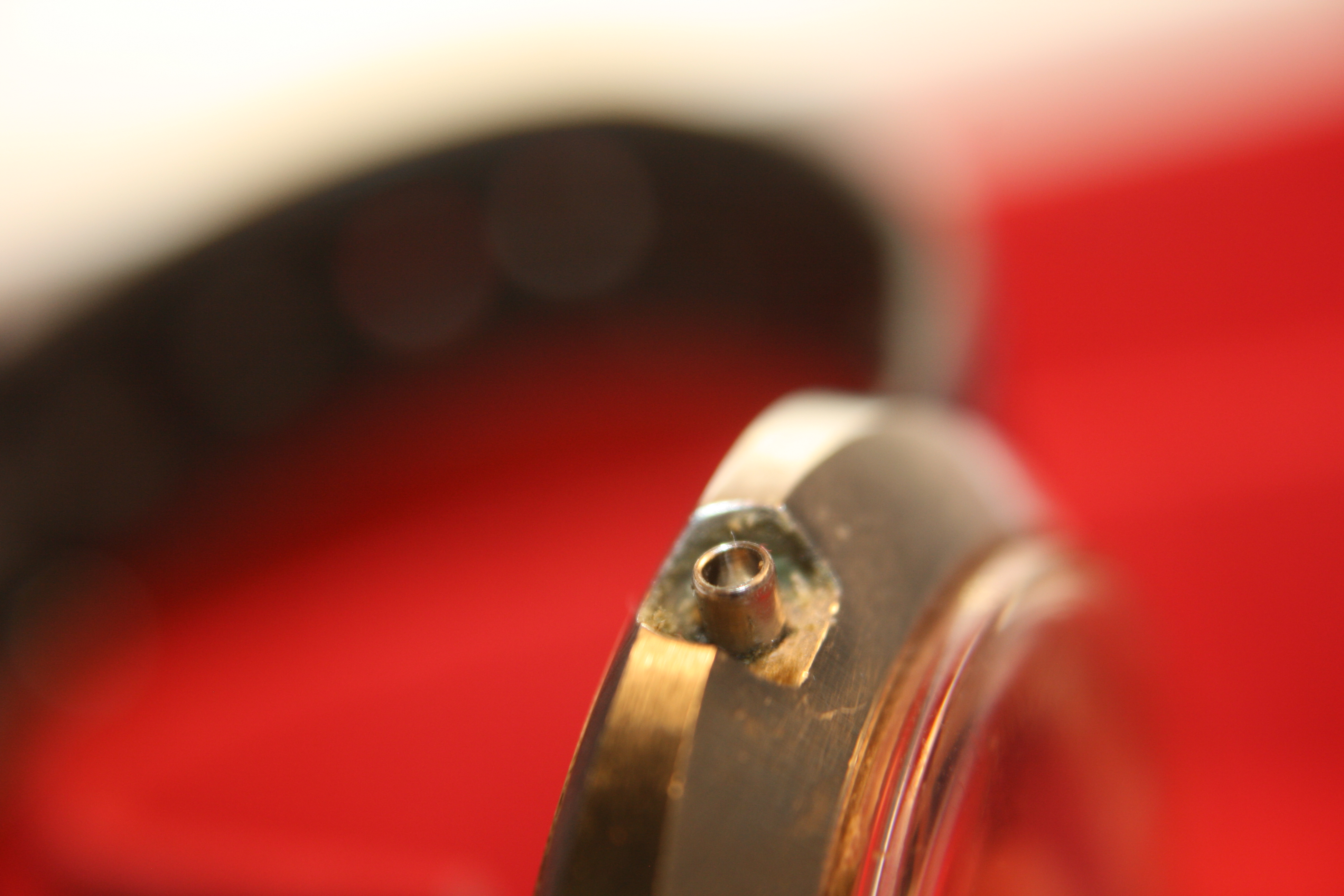

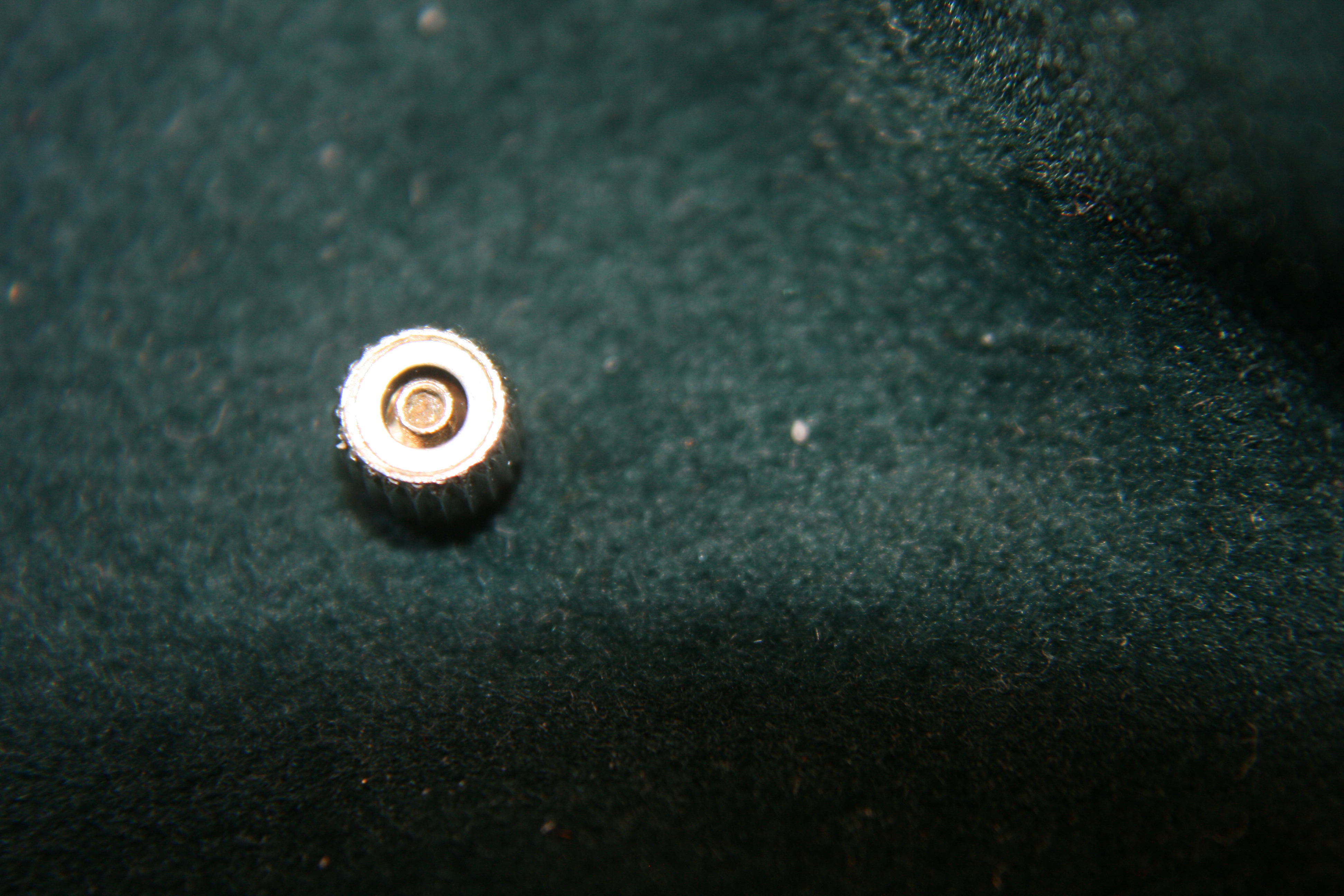

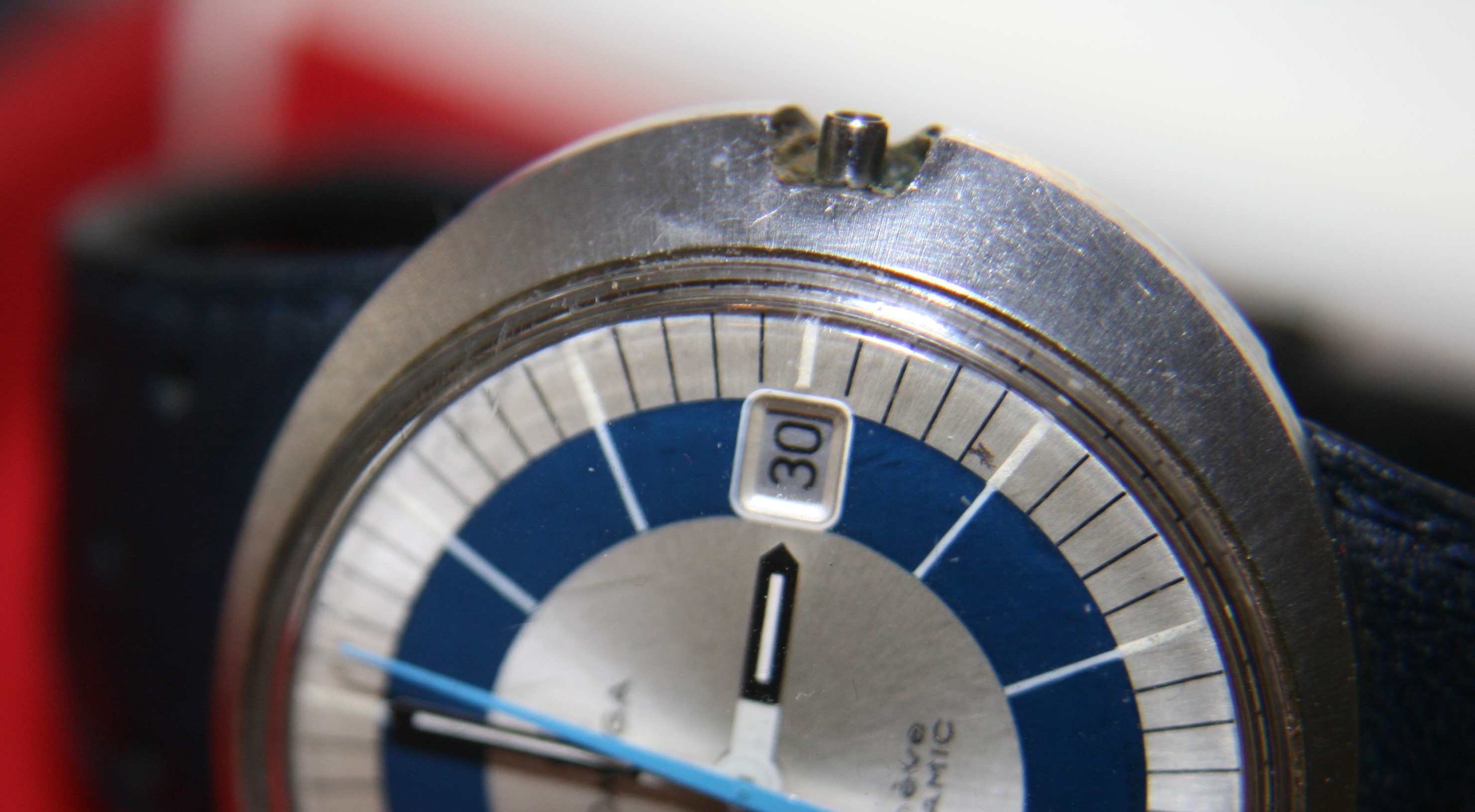

Hi
The crown has snapped off the stem and so it won’t screw back leaving the stem in the barrel without sufficient showing to get pliers around
Will try and get extension on it unless any other ideas
Thanks

Please post a nice clear photo or three.
30,276
78,129
It appears that you will need a new female split stem -
081ST9992 | 1/2 HANDSETTING STEM CROW D.0,90.
If you can't get the broken stem out of the existing crown, then the new crown for this would be 069ST42528.
