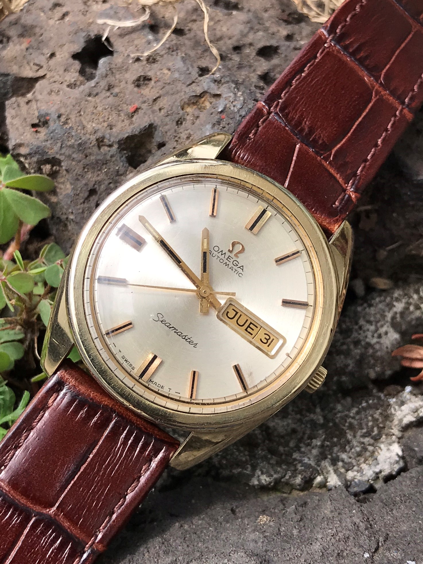

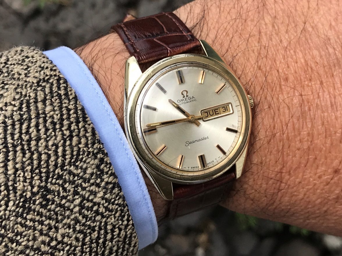

Hello everyone.
I write again looking for some help.

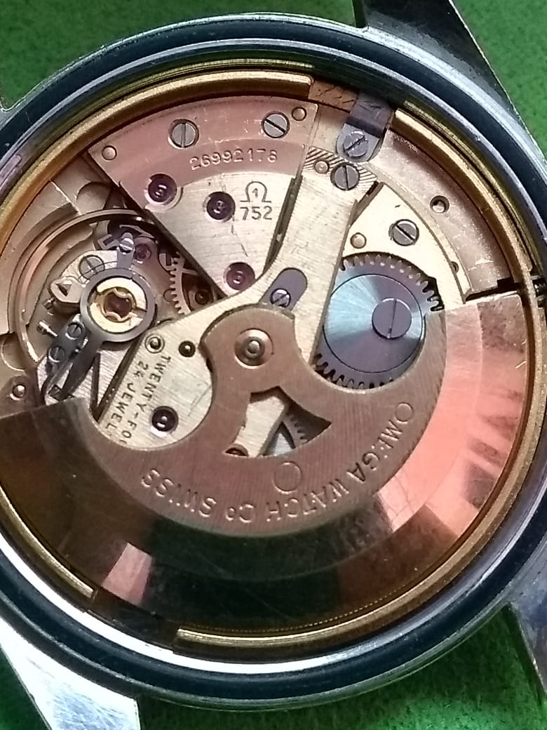

Recently, after a year of searching, my watchmaker can find the necessary spare part and we recover this piece:
This is a Seamaster CD 166.0032 from 1968, Caliber 752. It works very well after service with less than +4 seconds per day (in horizontal position).
But I'm not sure about the date change. I can change the day by pulling the crown, but to change the day of the week... I need turn hands until I reach the correct day. That's fine? It's the only way?
As usual I will appreciate your help and any comment about this watch.
Thanks.

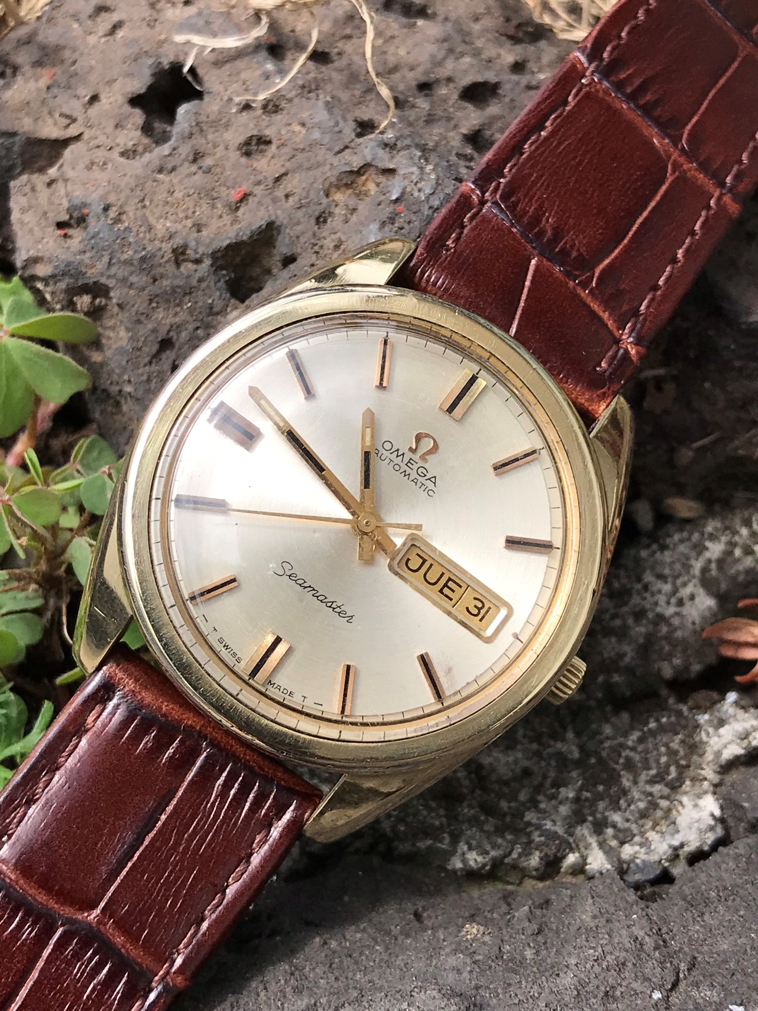

Hello everyone.
Thanks.

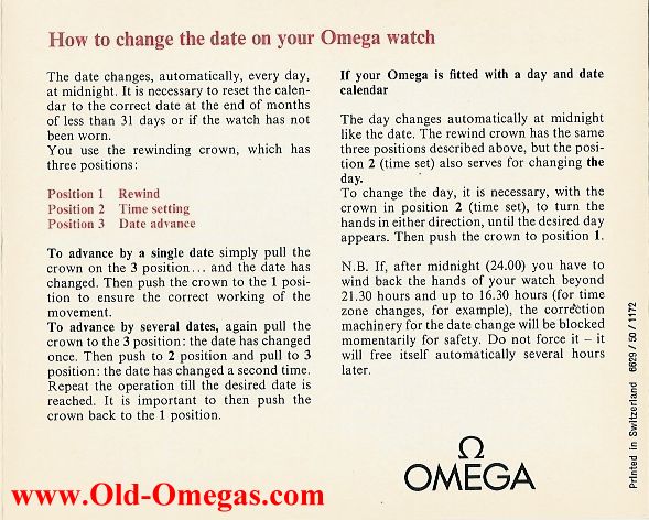

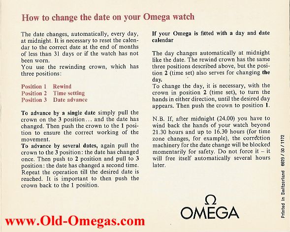

Have you tried setting the time to 2:00 and then back to 10:00? You repeat that until the day of the week is right. Always from 10-2 and back.
But you have to keep in mind that the time is 22:00-02:00 and not 10:00-14:00. After that you can set the date by pulling the crown.
I am curious about your feedback.
61
110
I just did it and it changes the day of the week but when I return at 10:00 it also returns the day of the week, however the day does change.
61
110
Wooooo That was fast! Thanks a lot, now Im sure about my watch functions. And the most important is the "blocked for safety".
