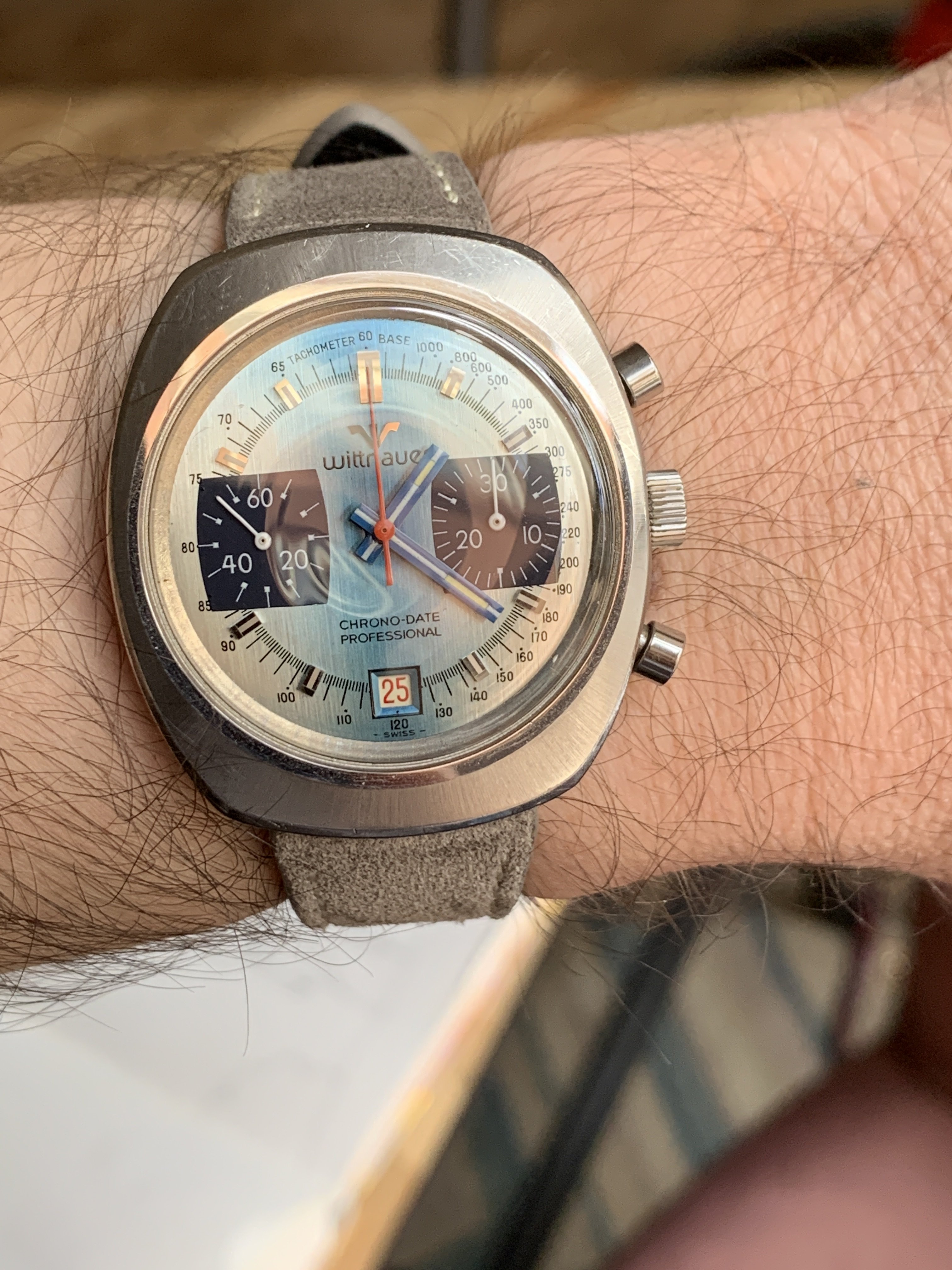

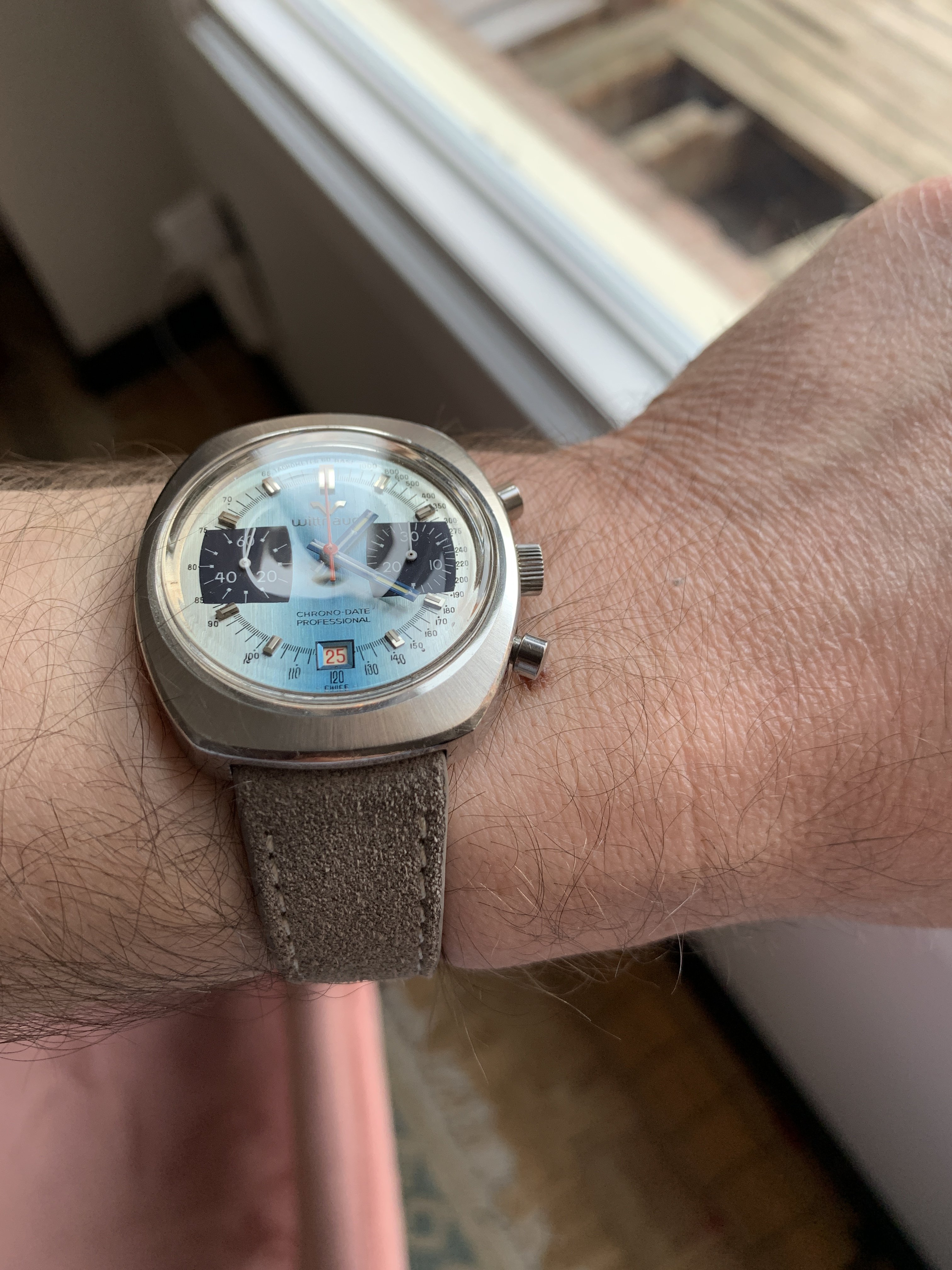

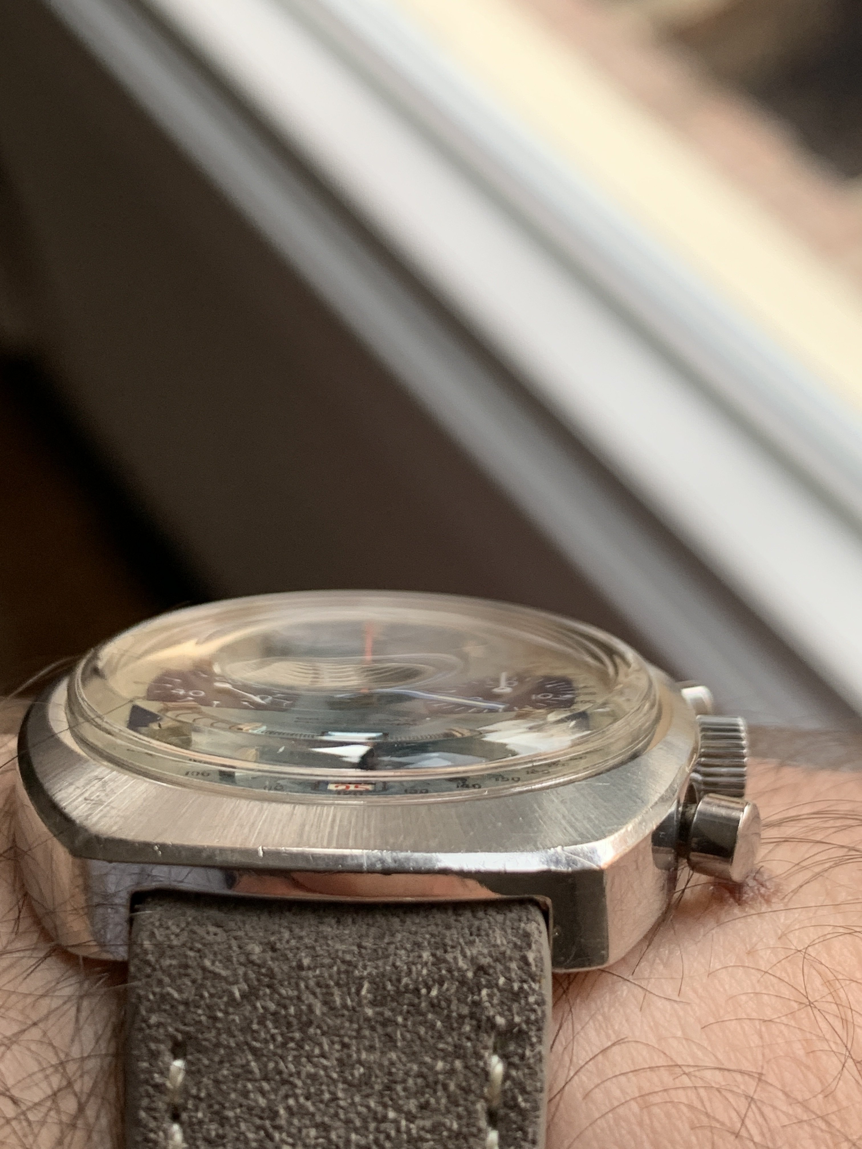

Hi. My Wittnauer’s acrylic crystal has round sort of effect when you turn it towards light. I’ve sanded it down a bit and polished it with Polywatch & Meguire’s #9 but it didn’t do much to remedy the issue. It kind of looks like the crystal is warped from the inside...is it possible? The outside surface is flat from what I can tell

Possible? You’ve shown that it is. Cause? Heat? Solution? Replace crystal.
238
852
Warped or stressed. When acrylic is deformed, even if it returns to shape, it can develop this property. It is called birefringence. This is a link to a Wikipedia page on the topic. https://en.wikipedia.org/wiki/Birefringence
That being said, there is no good way to fix it. You need to replace the crystal.
