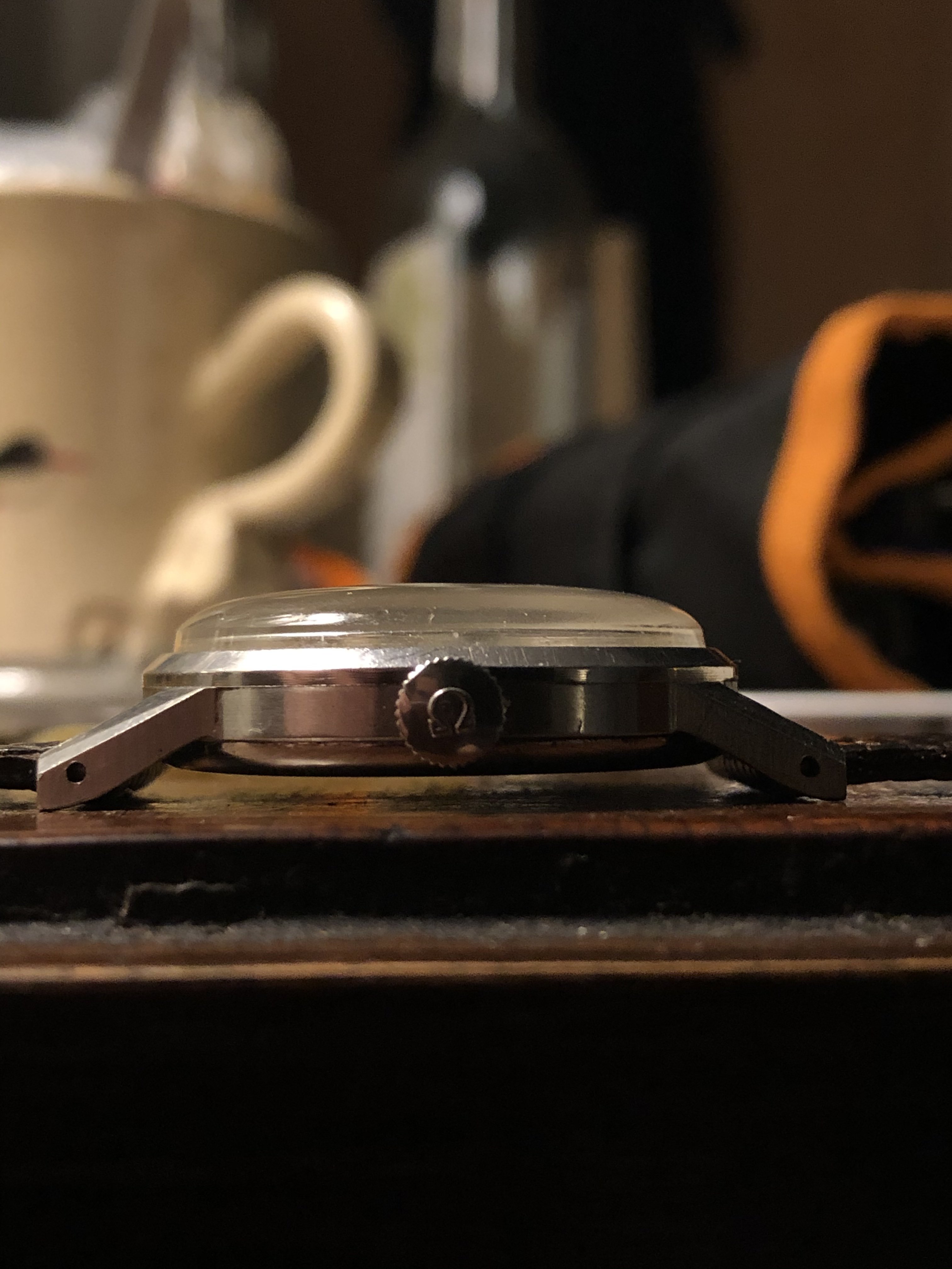

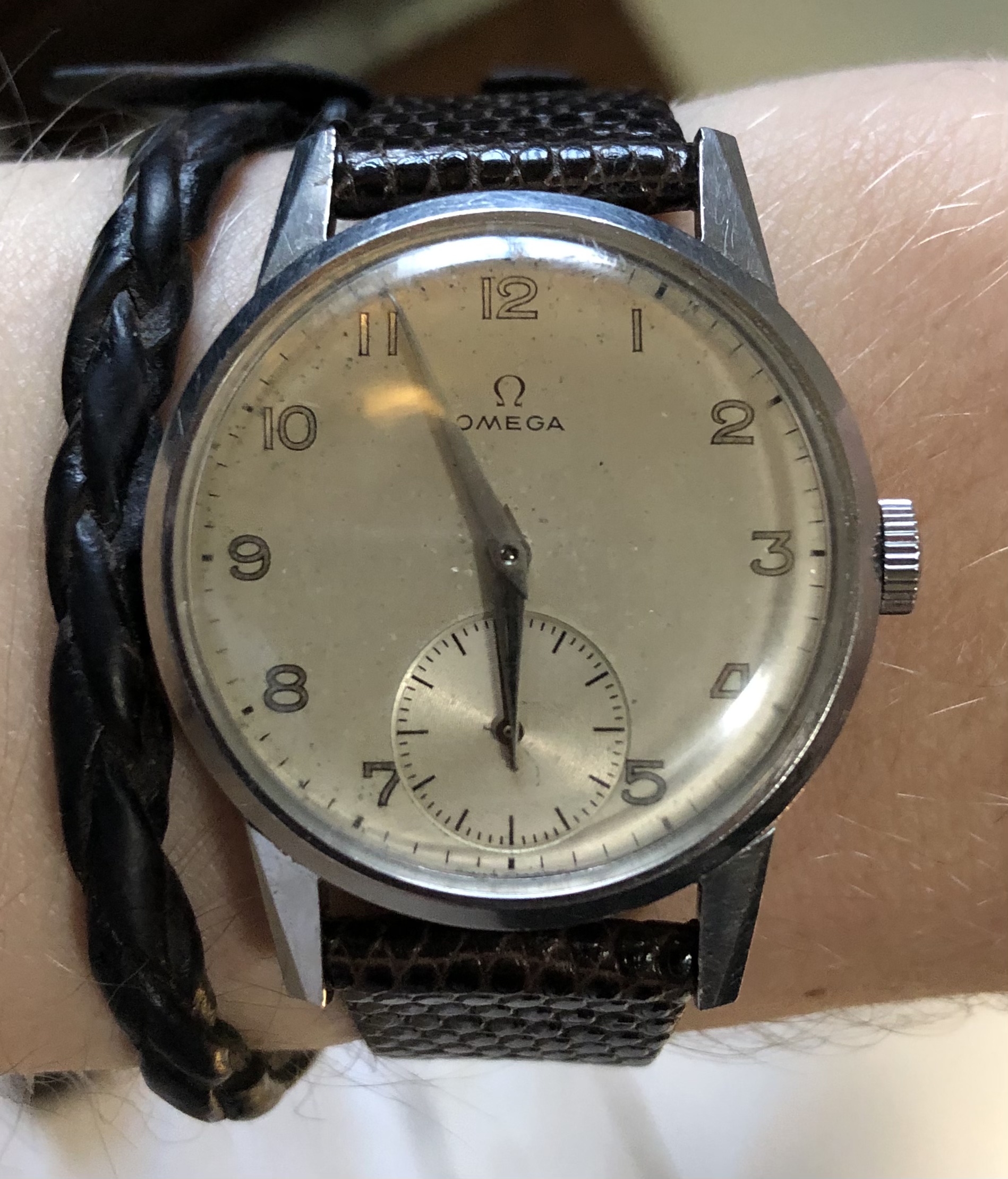

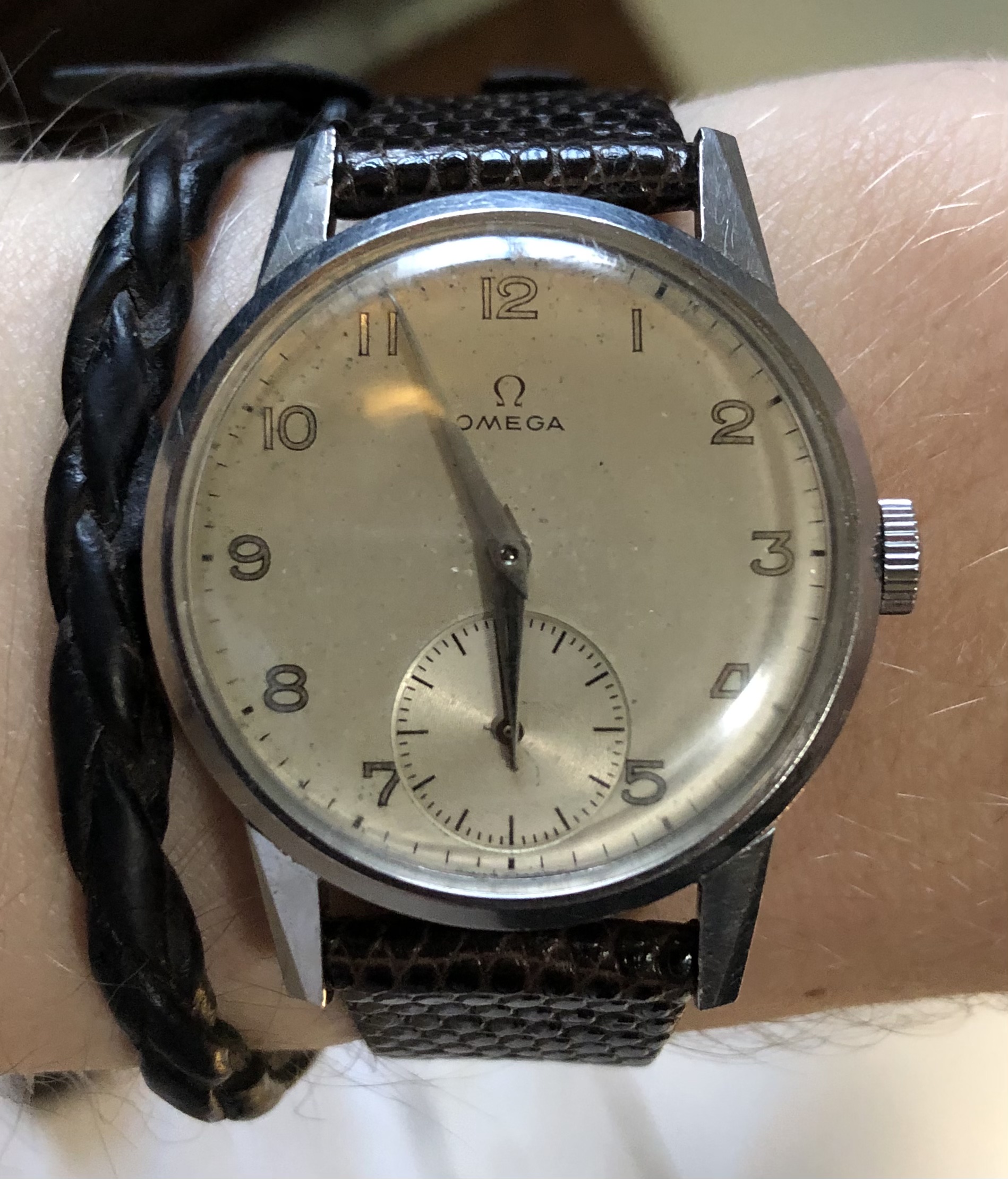

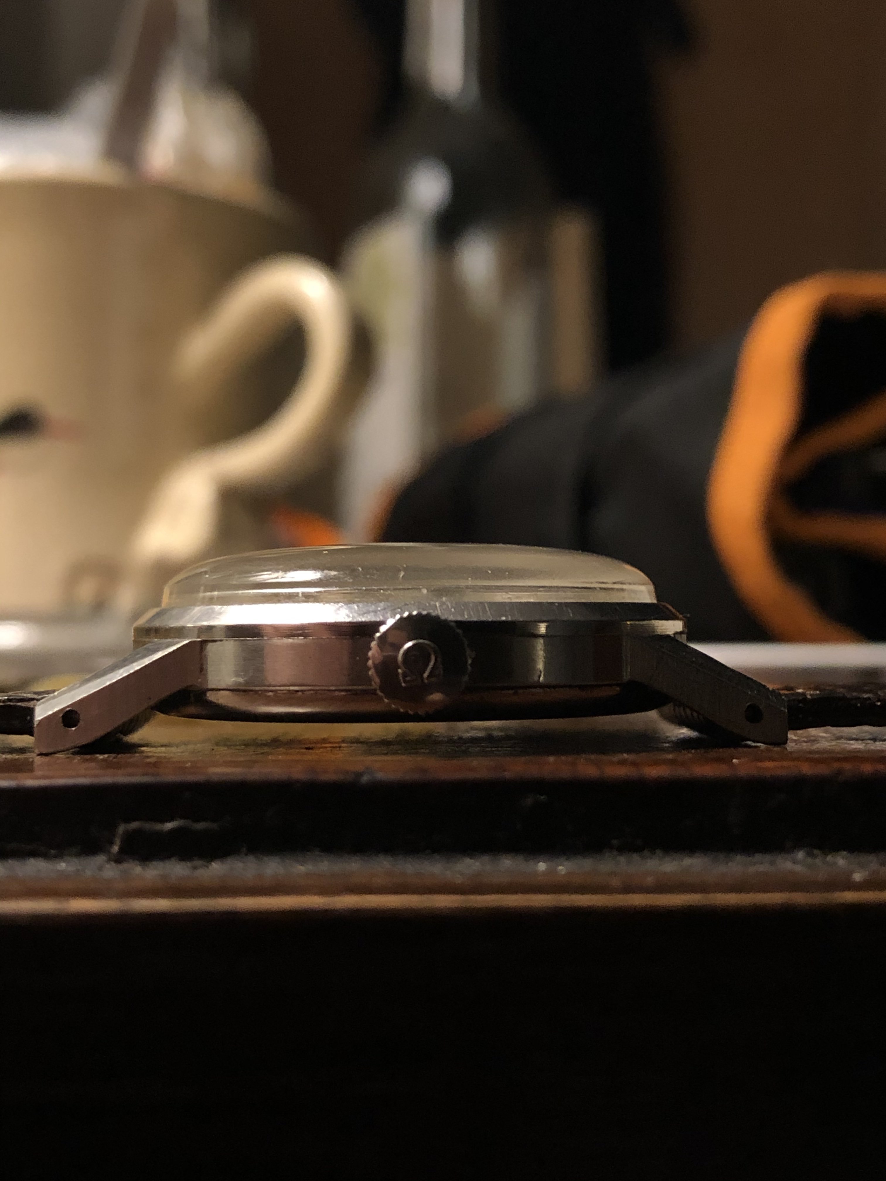

hi my 1940s omega arrived today and i love it. the crystal is a bit scratched up and i’d like to get a new one. i’d ideally have one without such a large dome on it. i was wondering if one can buy a replacement crystal that is shorter than the current one? i don’t know if it would interfere with the hands or not. i just prefer the way the ones that aren’t as proud look and would sit much better on the case. i’m not sure if this one is original or not. the case ref is 2495 and i’ve seen another thread that states the omega piece number: 062PN1043
hope someone can help thanks

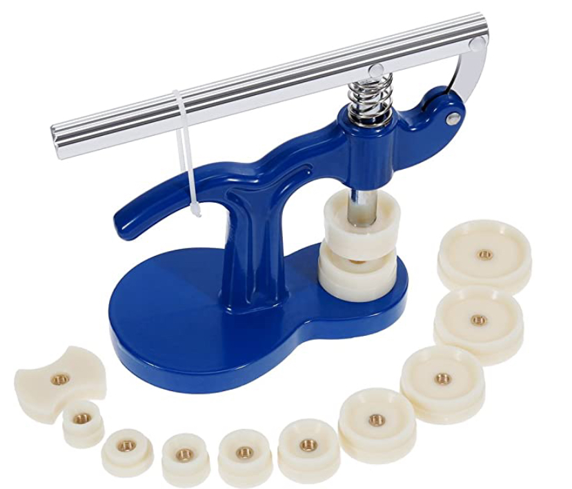

This does not look like a waterproof model that would have a tension ring. I might be wrong though. If it has a screwback case it will likely have a tension ring and this will need a crystal press to fit.
70
22
ok thanks it’s just a snapback case
609
789
Cousins has a number of low dome options, as said above. If you can’t fit it by pressing by Hans, you may need a watch press, which you can use both to fit crystal and to close push backs
70
22

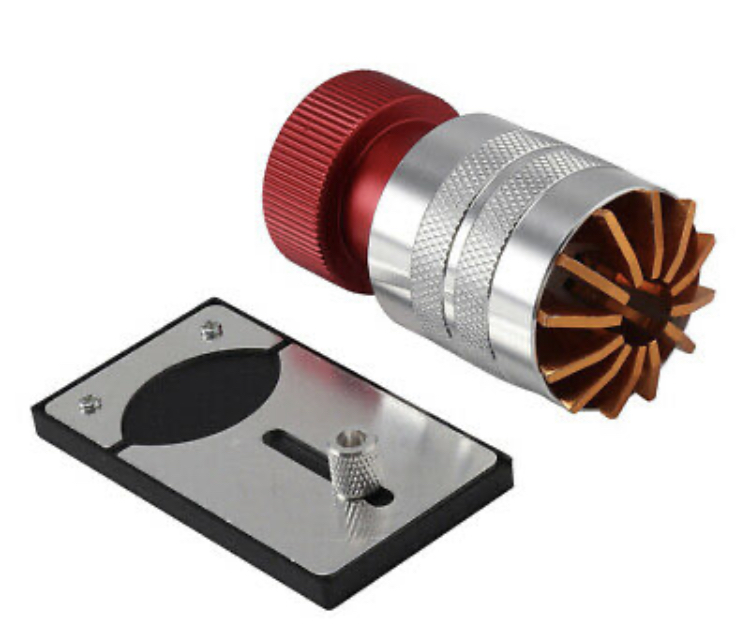

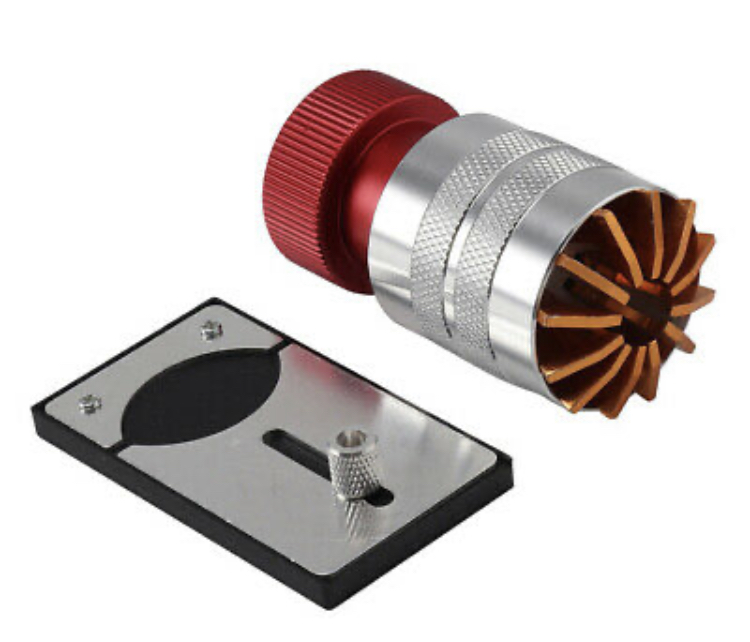

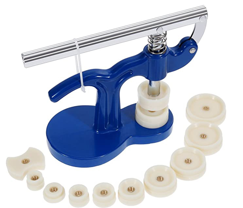

would one of these lifts work?
1,453
3,023
Because the current crystal is a high dome, there should be enough purchase as it were for one of these tools to grasp onto it to remove. It may not be useful to insert a low dome though because it would just slip off. I have a bergeon ones of these and they can be very useful.
But unless you’re doing this kind of work on watches all the time I wouldn’t bother buying these tools as it will be cheaper for a one off trip to your watchmaker and of course less risky. I generally have a rule. The more I love a watch, the less I “tinker” with it. ☺️
609
789
That one will work only if there is enough lateral to get a grip - and compressing then till dome up and get out. But if it is very flat, it won't grip:
70
22
ok i see thank you, so if i’m using a press will i need to get a crystal that is more true to size? since it is recommended to get a slightly larger one when using a lift. the diameter of the crystal is 30.35mm so i was going to buy a 30.4 but also a 30.6 to ensure a tight fit however if the crystal is not being squeezed by the lift tool should i just get a 30.4

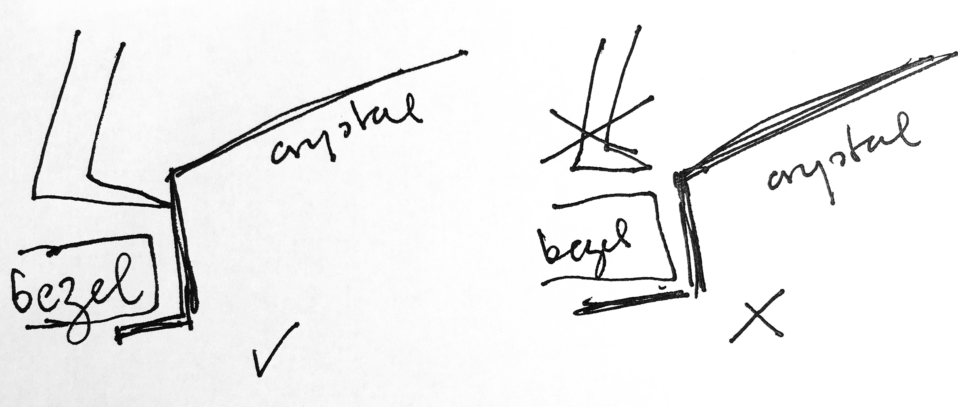

The reason why he wants to change it is because that crystal is too proud of the watch, not because it is scratched.
Have had watches where the previous owner had the crystal replaced during service, and the watchmaker used a crystal of the right diameter, but ridiculously proud of the watch, adding 2-3 mm to the thickness

yes exactly, ideally i’d have a nice low domed sapphire in there, flush with the bezel but that won’t fit
609
789
Sapphire would be not in the history of this watch. A low domed plexy is age- correct, sapphire crystals were not used in the 40s-50s
And, replying to Kaplan, these crystals have never been thick, nor is the one in the watch by the OP. It is just the wrong shape.
