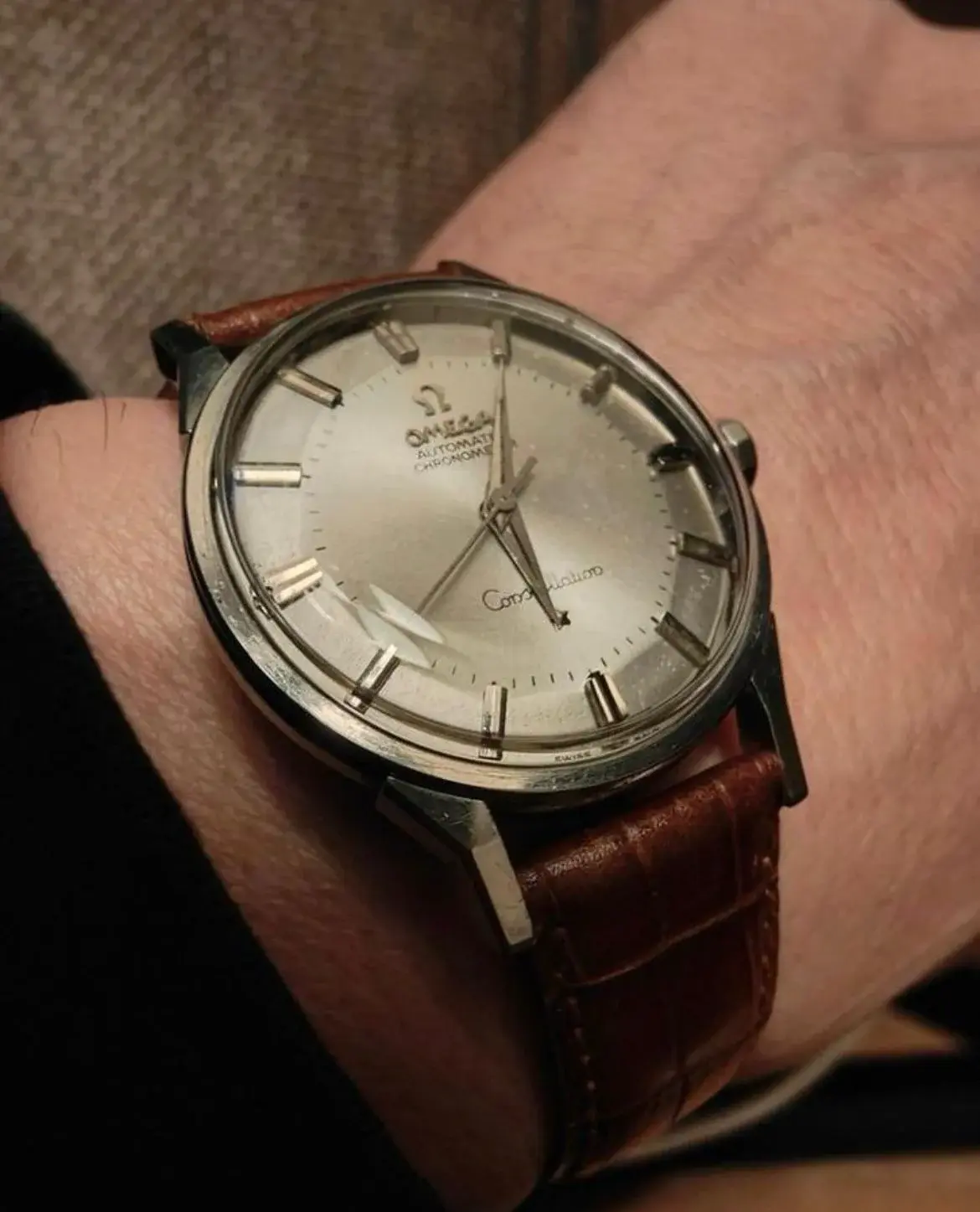

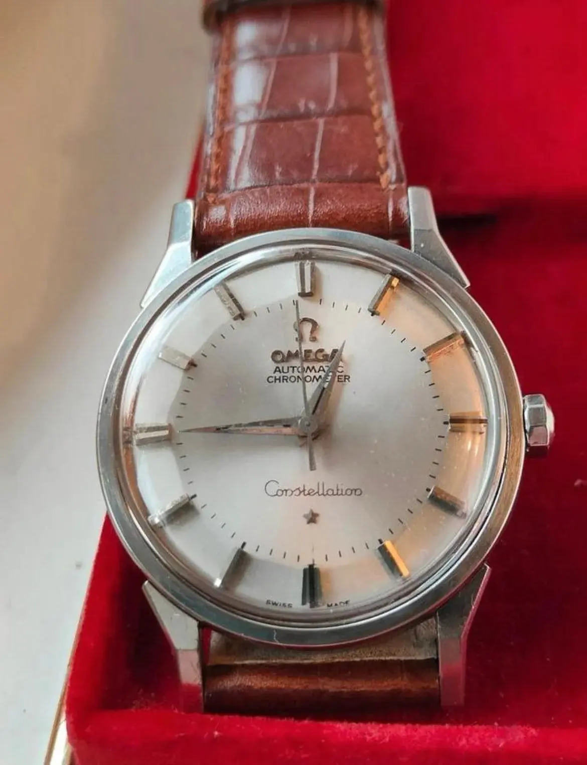

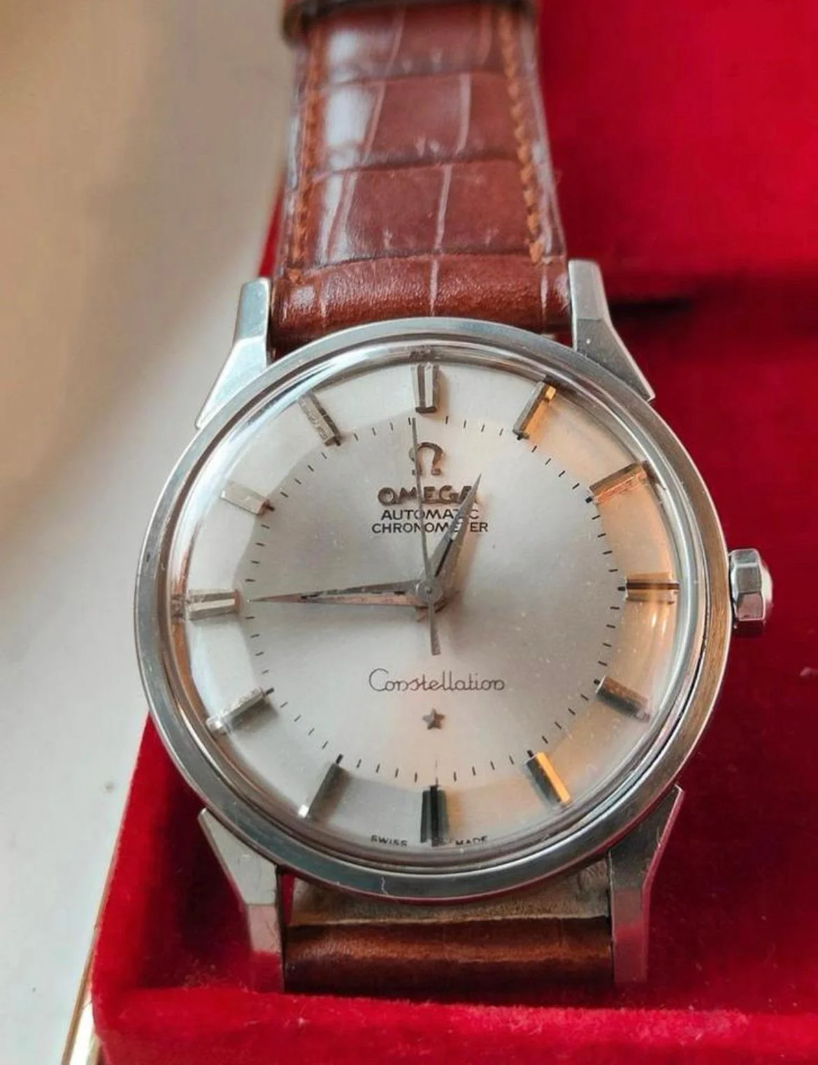

Good evening, came across a pie pan no date 'dog leg'
Has some patina on the dial, and has been serviced according to the seller.
No pictures available from movement.
Seems like an original crown from what is visible.
With a little experience in Omega's, not with pie pan's, thought I would reach out for some help for the first time.
Gonna take a look at the watch tomorrow, any tips on what I should pay extra attention to?
24,801
55,084
Don't waste your time with that one. Just start studying reference information and browsing the private sales section on the forum.
906
1,740
FYI, there are a number of issues:
The 3 and 9 markers are different
No serif visible on fonts
The n's are different
The first o in constellation isn't round
The s is not right
The 30 minute mark is misaligned
Likely more

Thanks Bruce, much appreciated!
