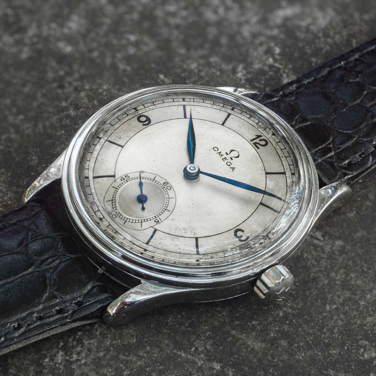

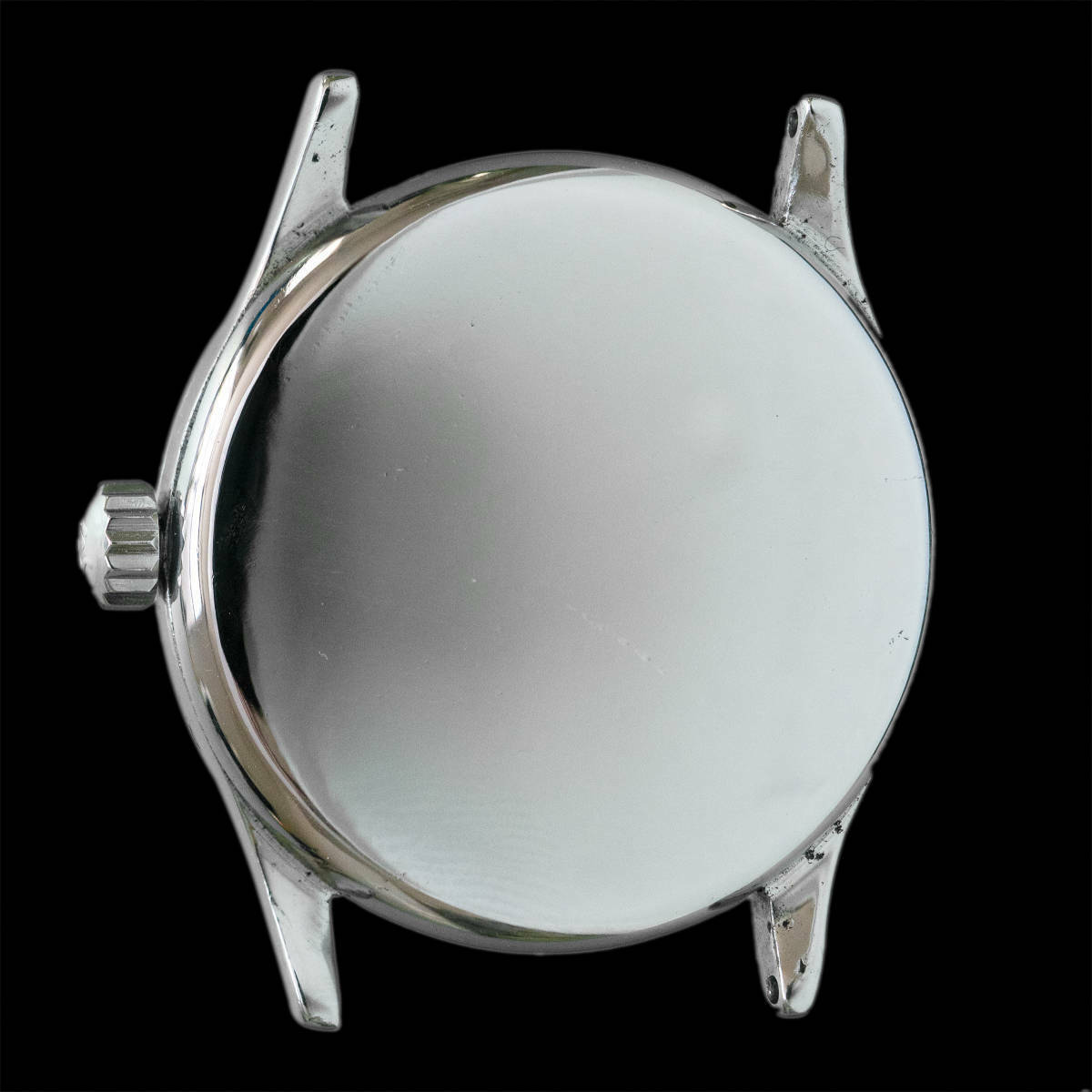

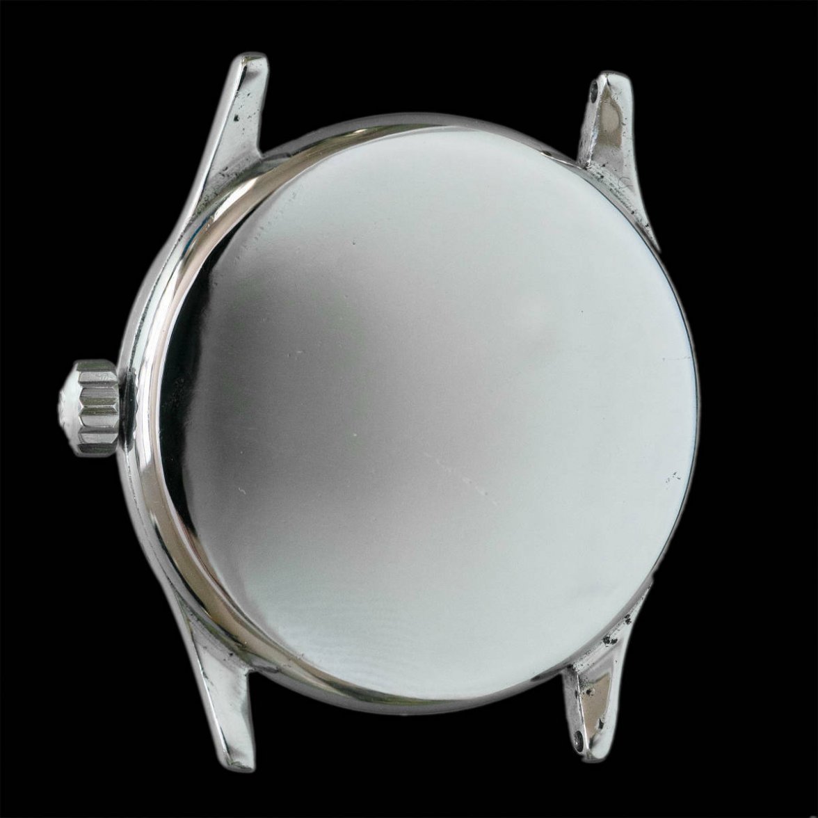

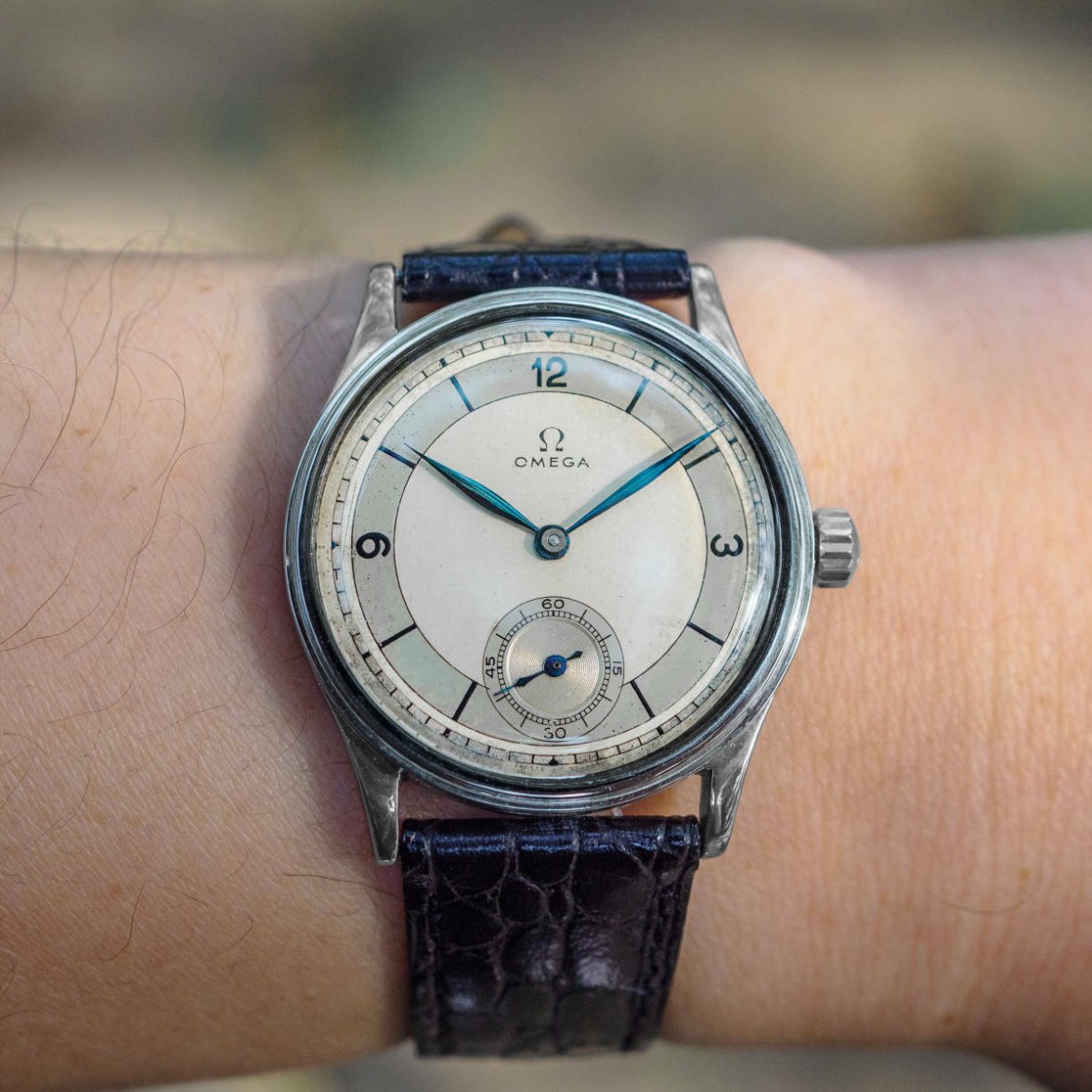

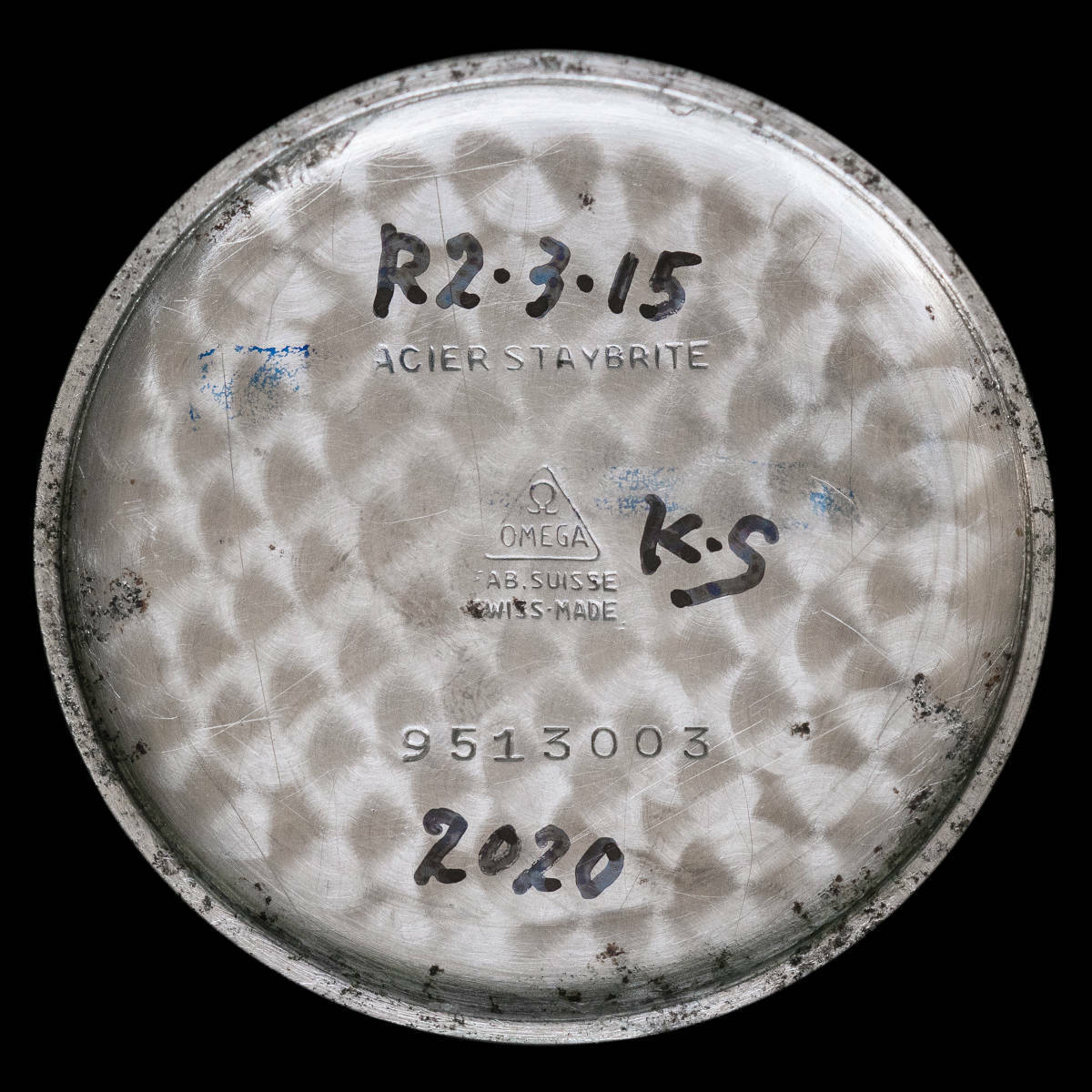

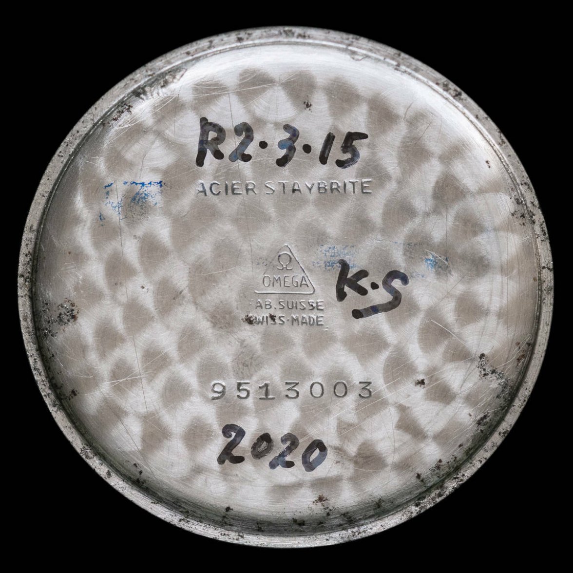

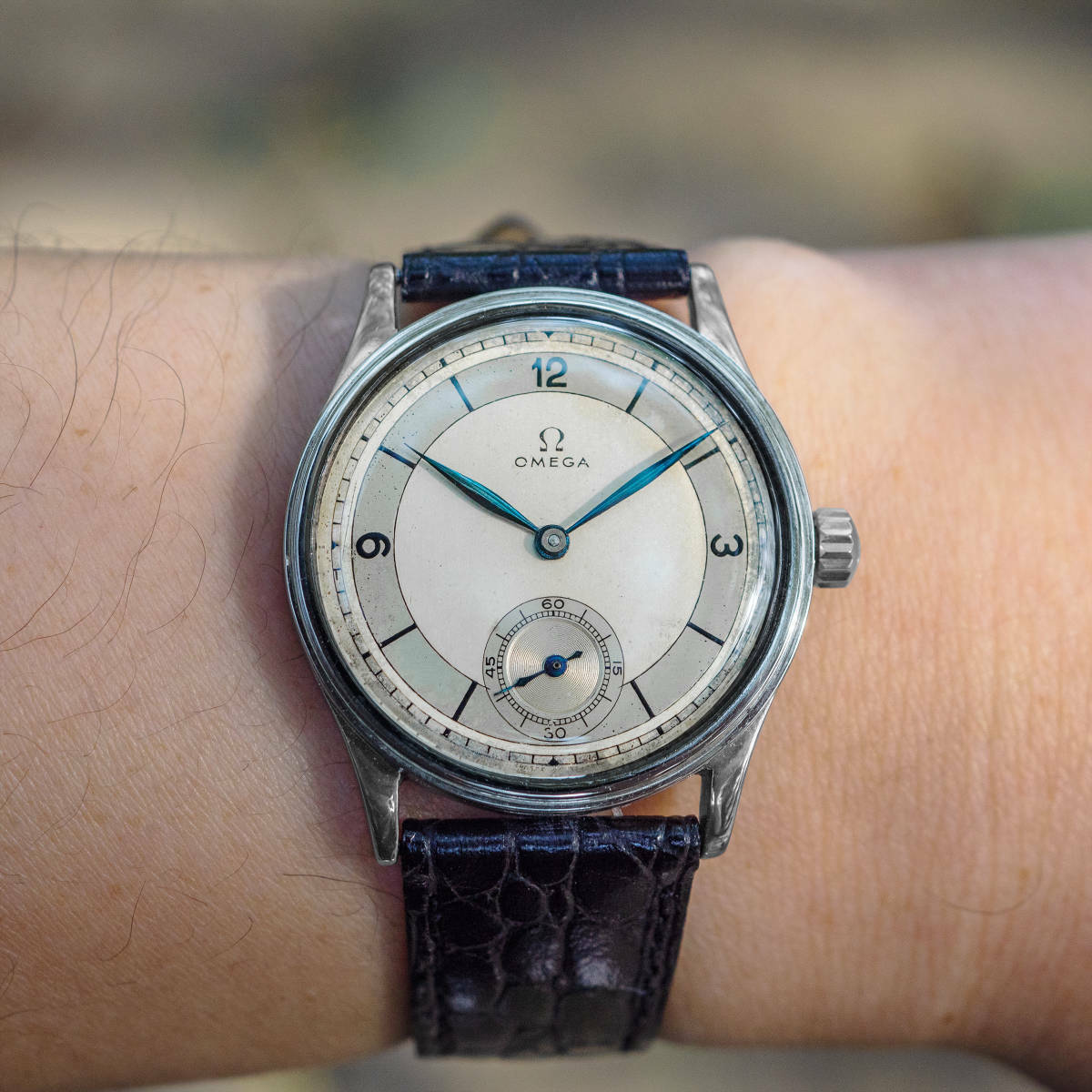

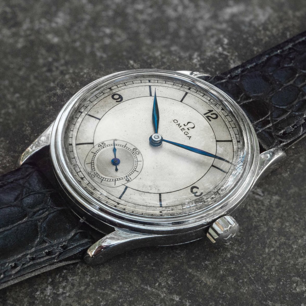

First time poster, my apologies if I'm not following the guidelines perfectly.
I'm considering the below 26.5 sector dial, but was concerned about the originality of the dial, hands and crown. I've only recently started to foray into smaller watches from the 30s and 40s and am still learning my way around and was hoping the experts here could help me with feedback on originality before I pulled the trigger.
Thanks!
2,454
9,974
Looks OK
Crown is not original, you’d want something with a flatter profile, not hard to find. It would be unmarked originally anyway.
